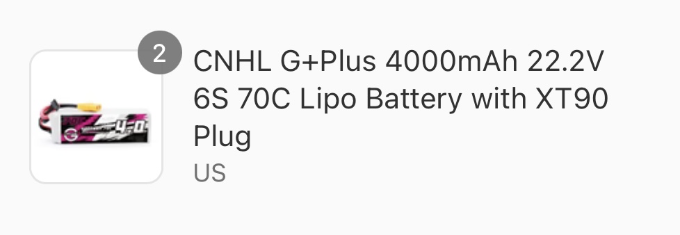

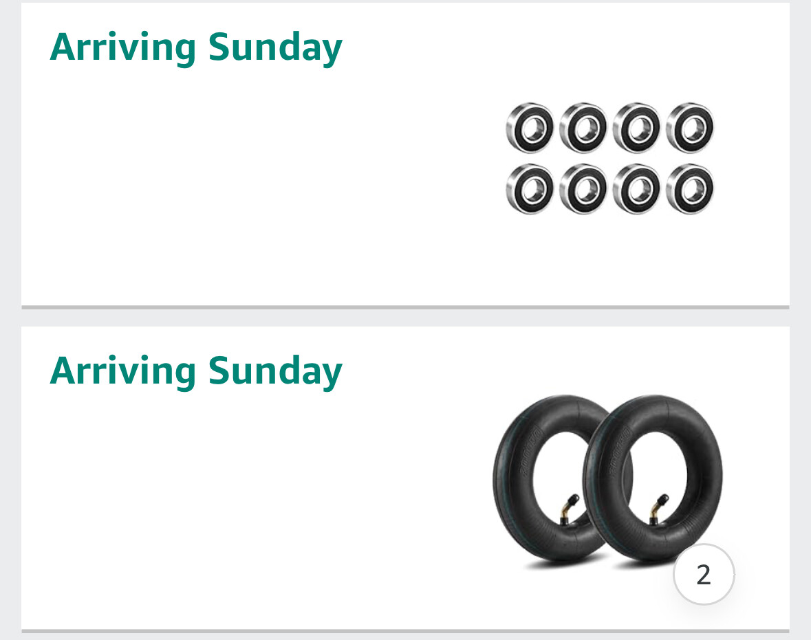

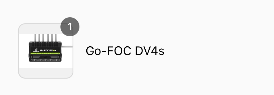

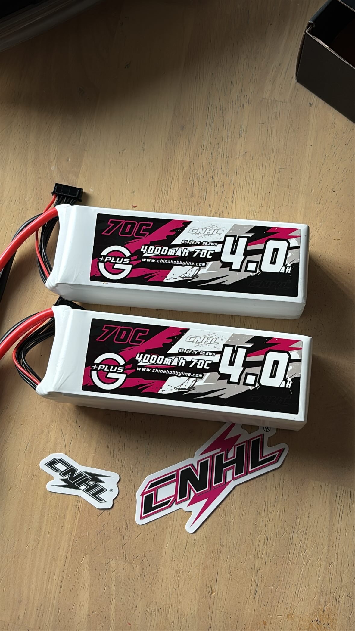

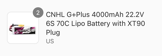

4/10/25: Just ordered 2 4000mAh 6s Lipo batteries, MakerX Dv4S VESC, I also got the tubes and bearings for the hubs and tires. Still need to get motors, belts and motor pulleys, LLT smart BMS and the box for the enclosure for the top. Very very small parts list which is weird cuz for the first build I had to get a lot but this time I already have the wires, plugs, charge ports, fuses

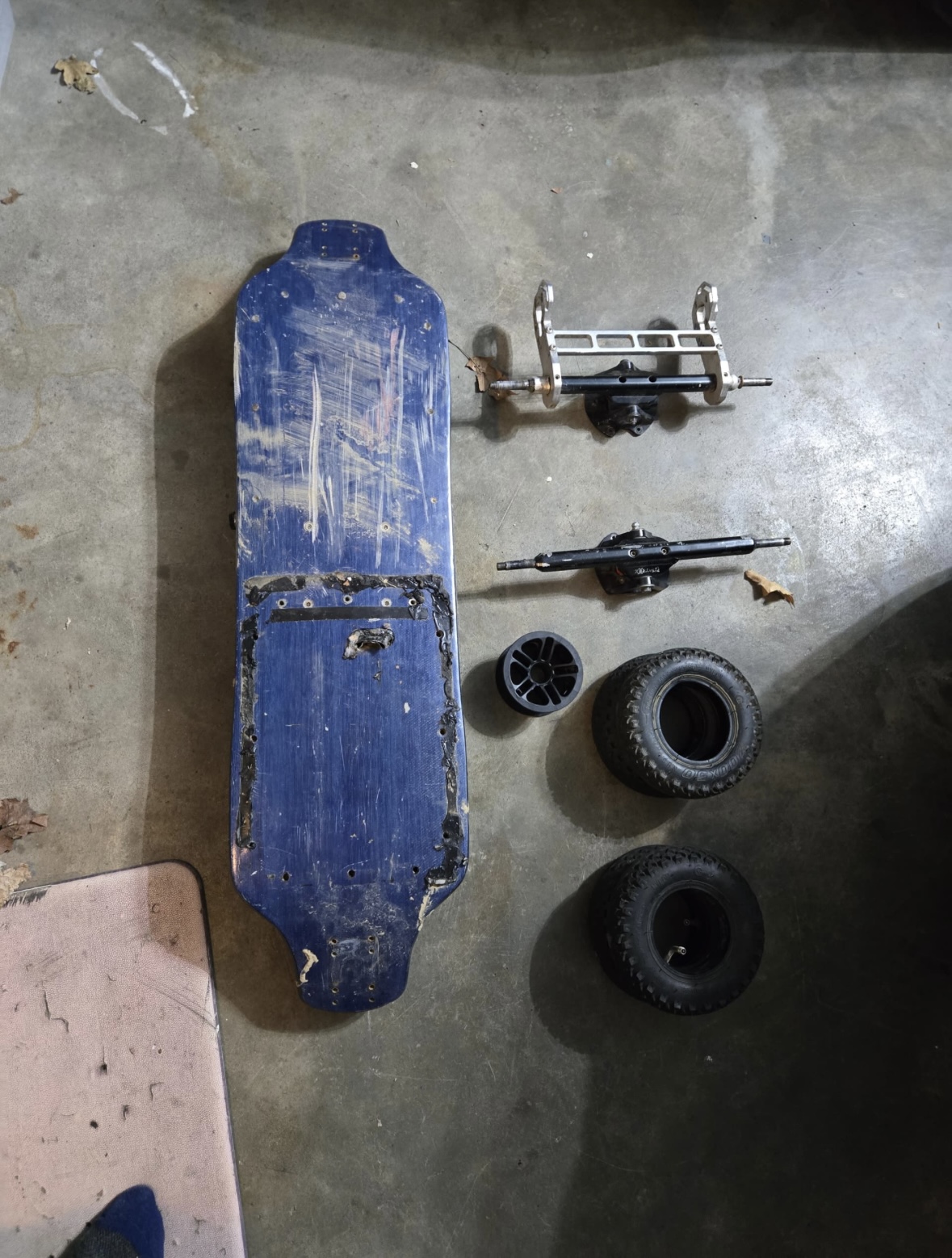

4/17/25: Some big things happened lately

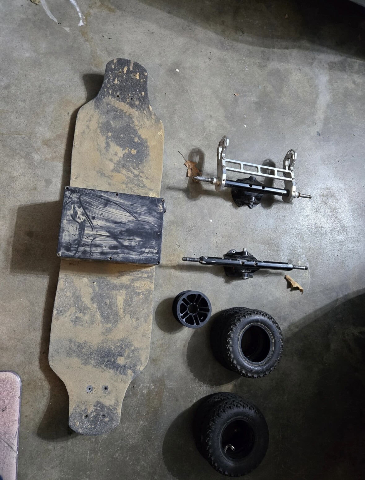

•The batteries and the esk8 bundle from @rafaelinmissouri came in today, VESC is still on the way but will be here soon

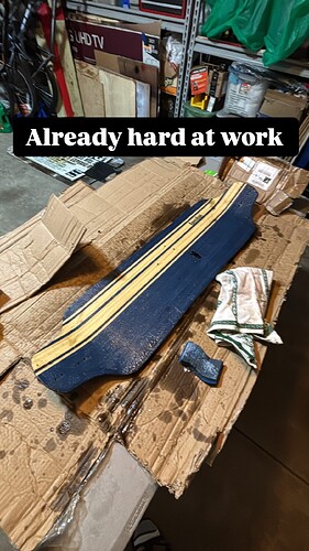

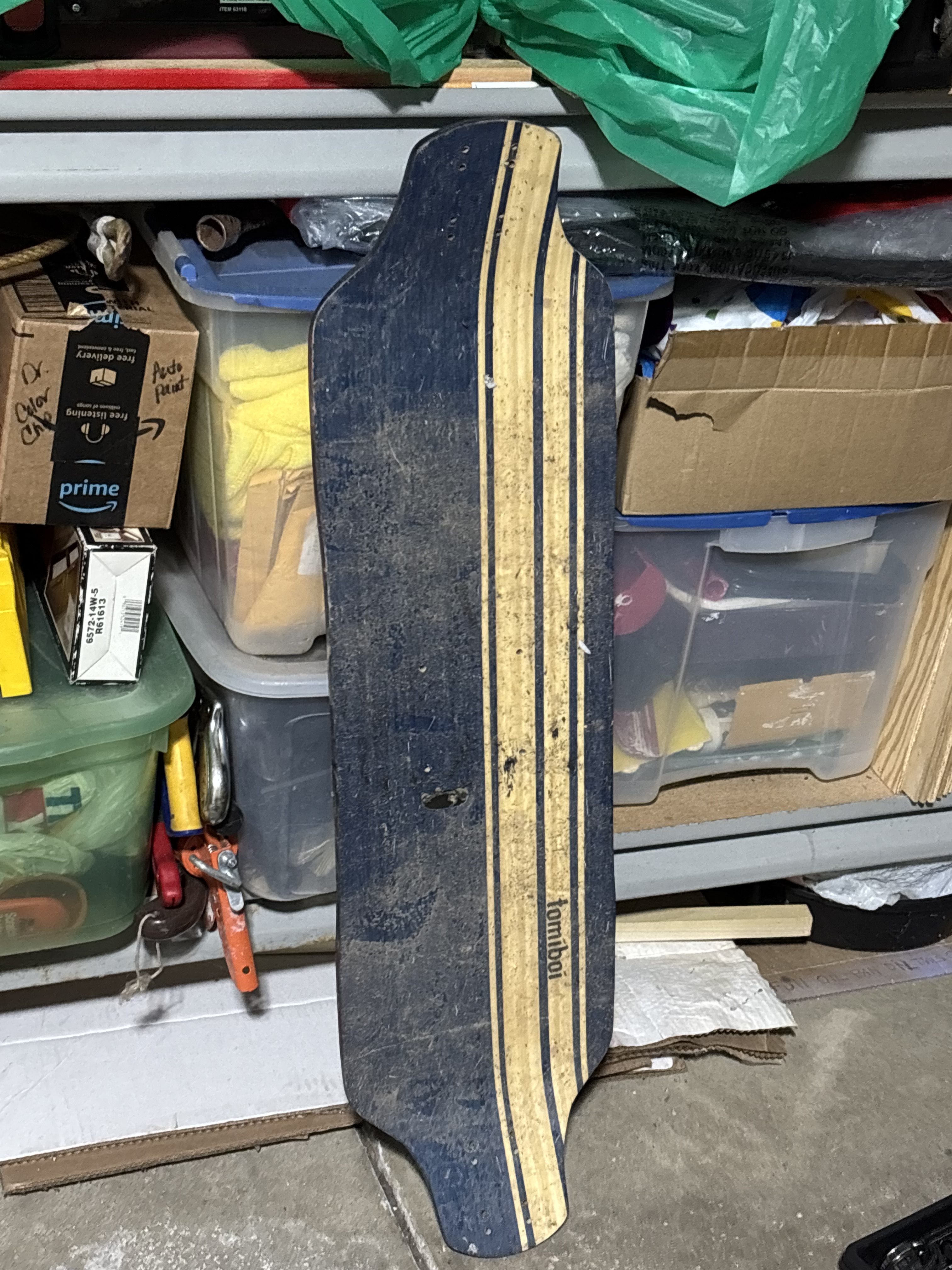

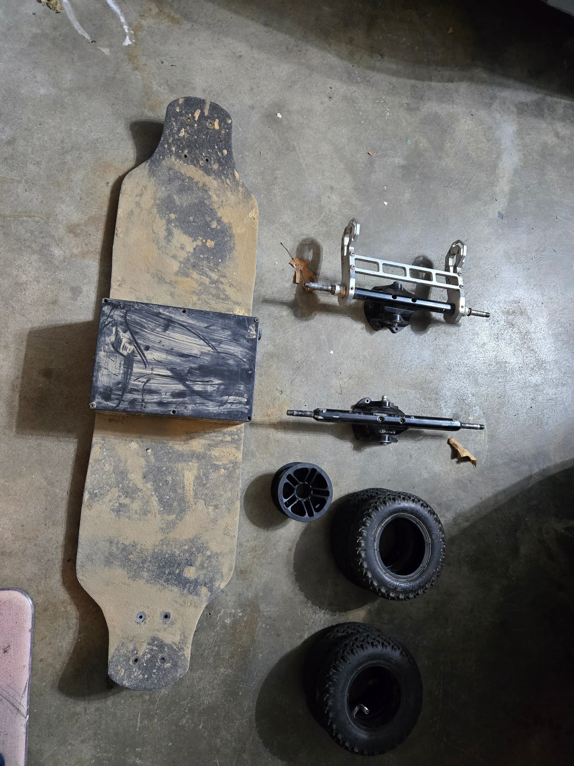

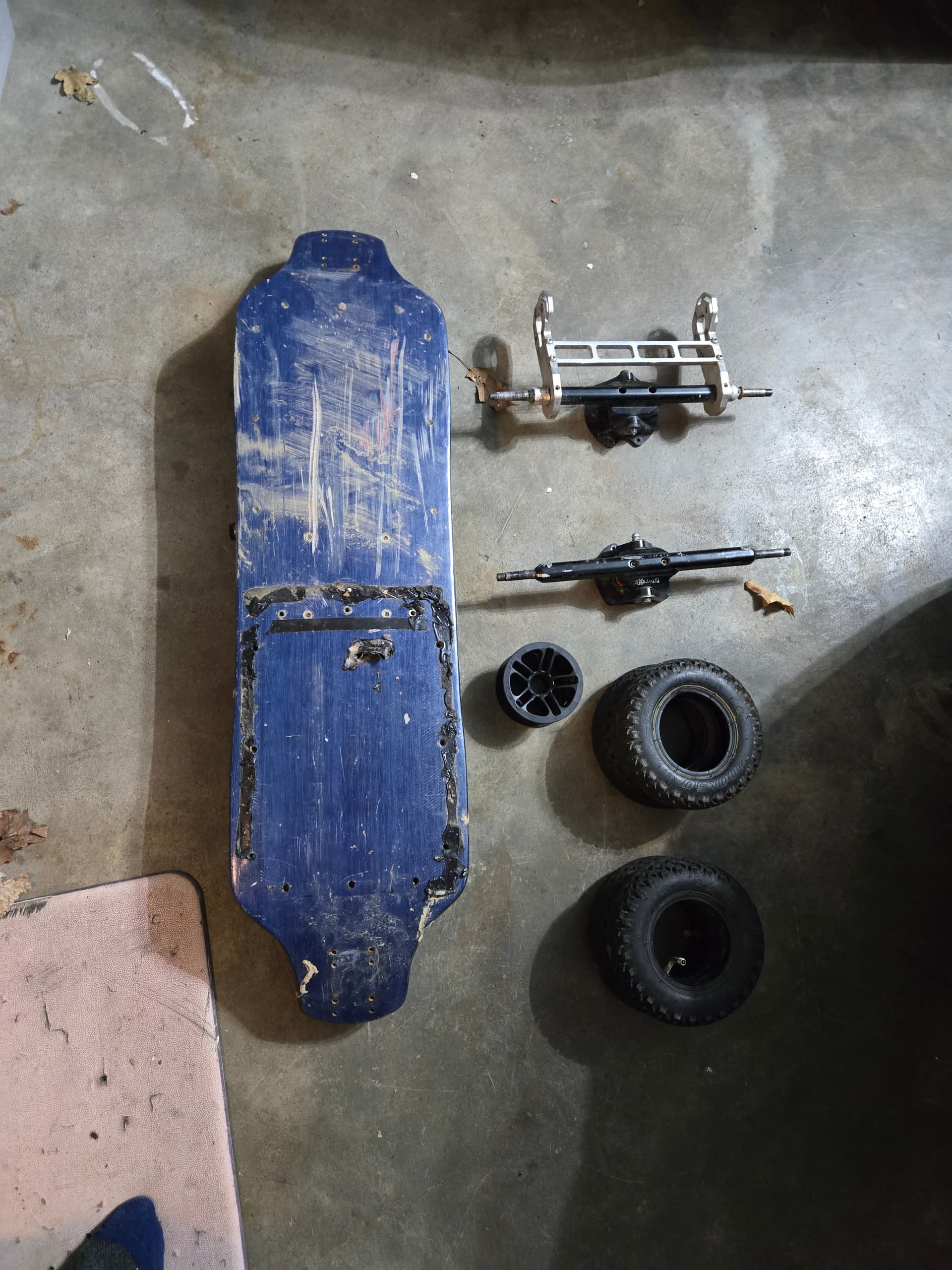

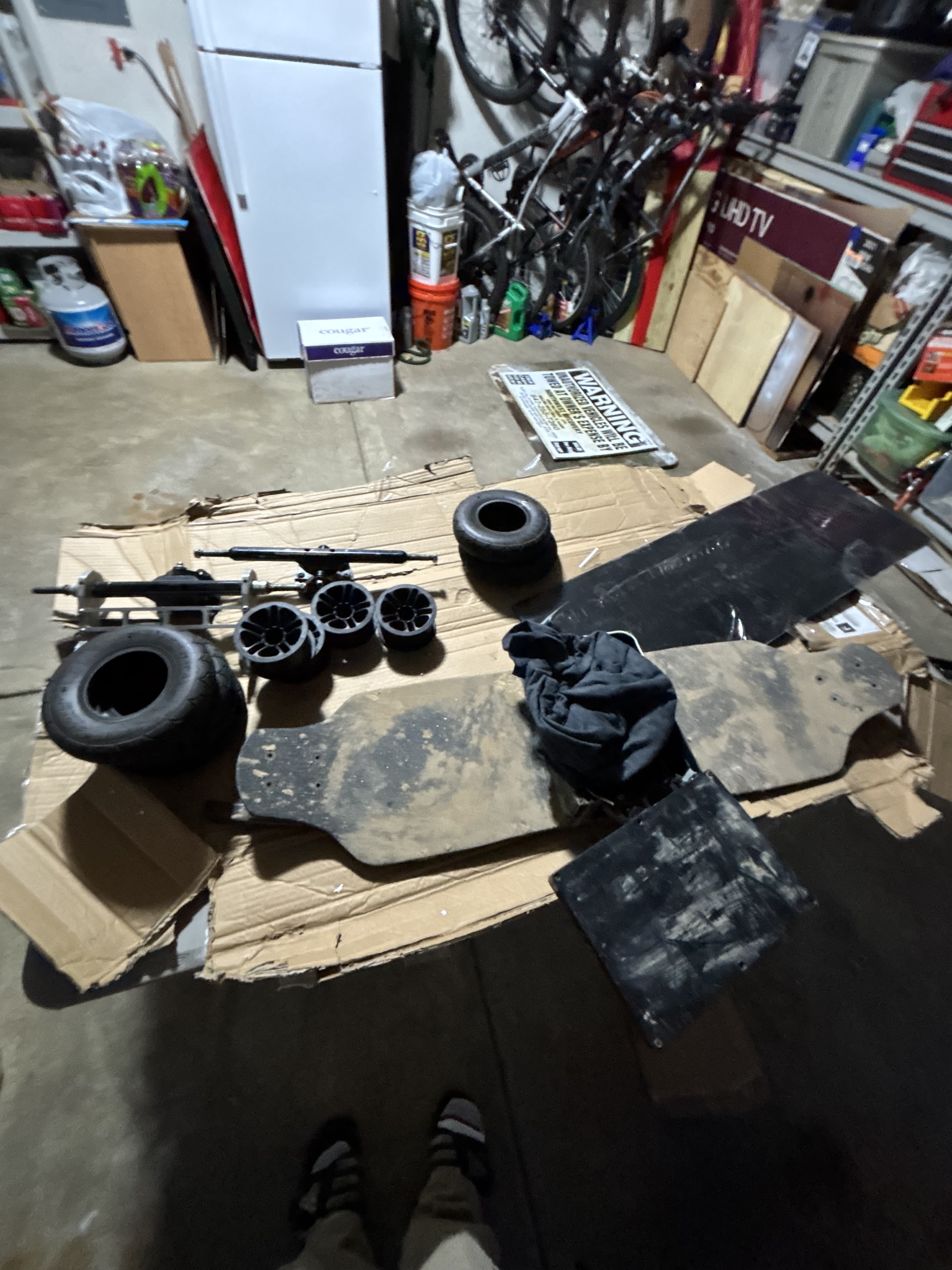

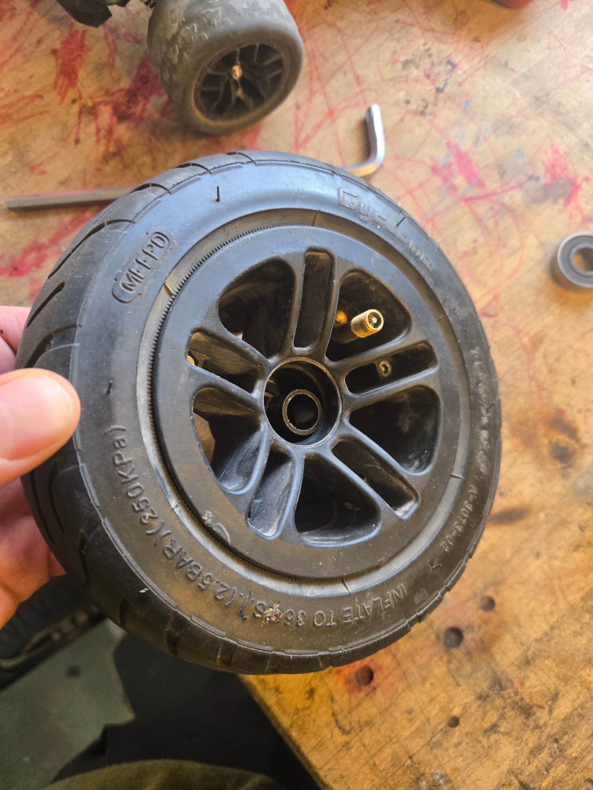

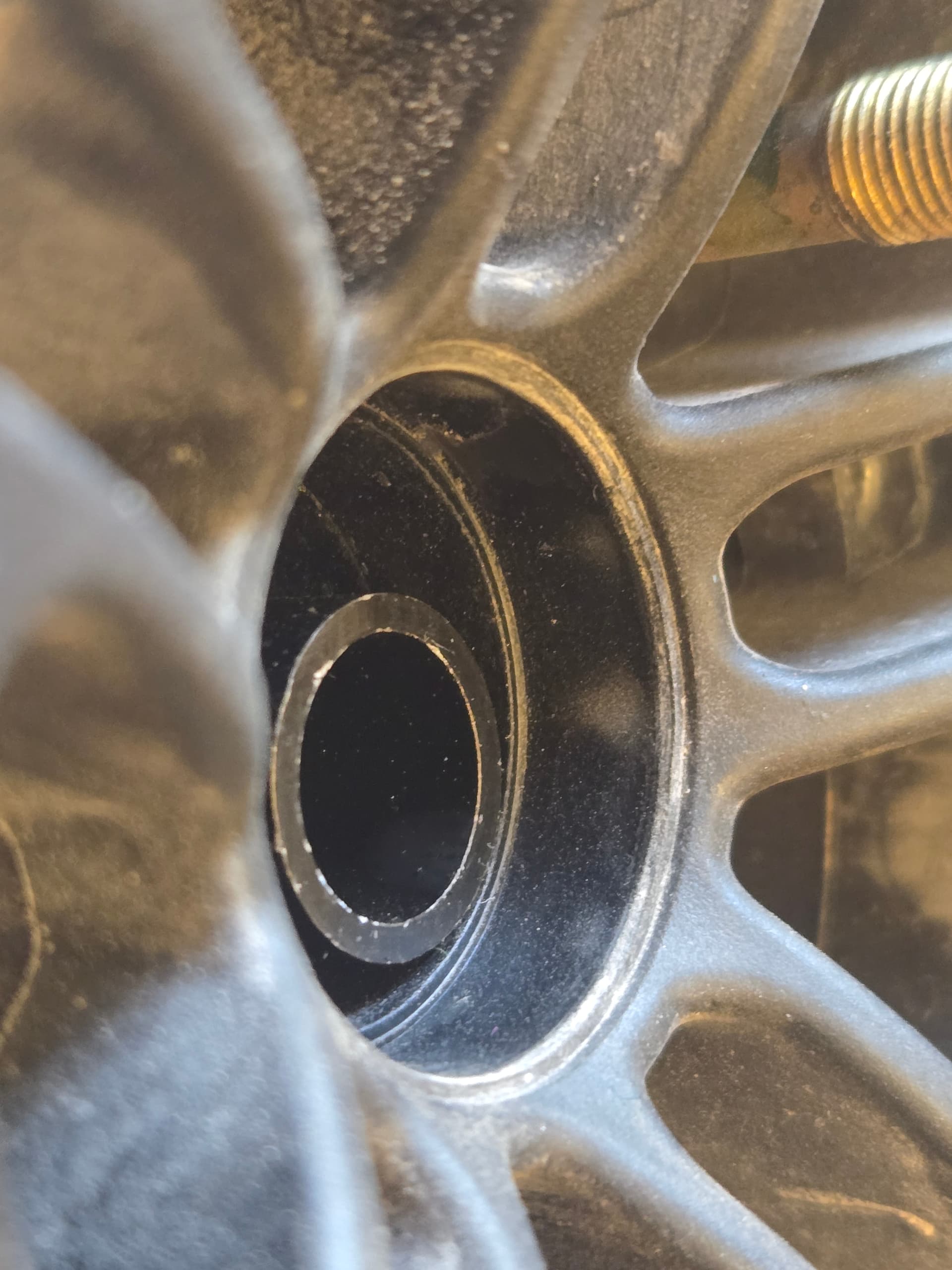

Today I didn’t waste no time, I got all the parts laid out, I first took off the enclosure box on top and shortly after the griptape, the bottom had some rubber left on from what I assume was a bottom enclosure looking at the screw holes, later today I’m gonna fill those holes up with wood filler and sand the bottom, prepping it for paint and as well the trucks, there was one wheel nut missing so I’ll have to get that along with some 12mm speed rings and maybe spacers for the hubs, I’m not entirely sure they need them. I did slap on the tires and bearings I got which fit perfectly and they seem to roll fine. I could be wrong on not adding spacers tho, the hard parts done and now it’s time for the fun stuff. More updates coming
Batteries
Unboxing
The board all sticky from removal of griptape
After removing the adhesive with goo gone
Deck all clean

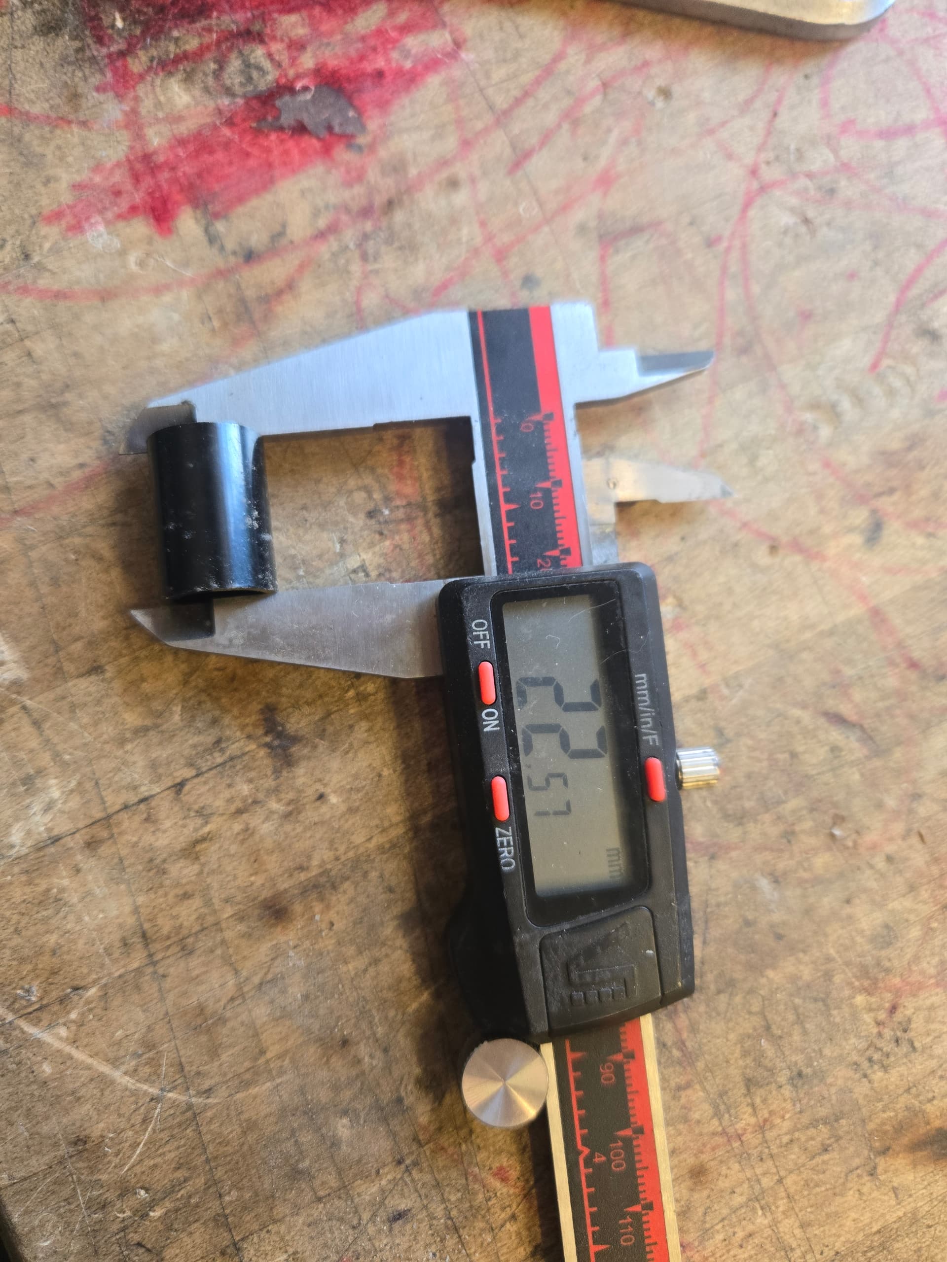

Definitely get spacers for your hubs, I’m not sure which hub you got so I can’t tell you the exact dimensions. You’re good as long as the spacers doesn’t jiggle around when the bearings are installed. Spacers are crucial cause when you tighten your axle nut, you apply the pressure onto the spacer instead of sweezing your bearings, which can cause them to blowout while riding.
These axle spacers from @mbs are a good fit on the Tomiboi Hubbas.
I figured I had to, I wasn’t sure, ik for thanes it’s crucial but since I’m new to the mtb stuff I didn’t know the hubs will need the same thing but that’s good to know, I’ll get those spacers
Thanks man, I wasn’t sure if the hubs needed spacers so thanks for sending the link, I’ll get them now
It’s not super critical.
But it’s best to run them.
