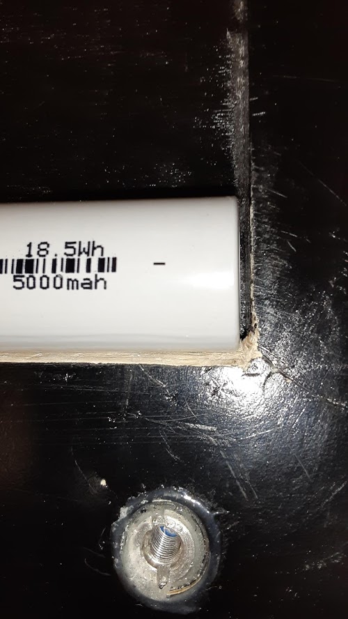

really just like 2mm each side but you have to get more than halfway down with the cut. The hand plane worked perfect because the blade was at the right height when the the tool rested in the cutout.
Perfect, looks like with those mods the deck is gonna be super sick with a 12s4p
are those tb110s?
Not to put fear into you, but my best guess is that messing with the corners was what made my hummie deck crack, keep a close eye on it
Yes
You and your hummie mod is exactly what I was thinking about the whole time I was taking a knife to my TB40.
I honestly took so little material out if that made a significant structural difference there would be a flaw otherwise.
The thing is that sharp corners are a big stress concentration factor that can start a crack, hopefully that does not happen
My cracked deck is still alive, every time it cracks I put a bit more superglue in it
perhaps a little cf/fg reinforcement is a good idea for the corner
I’m just gonna throw a glob of epoxy/jb weld into the corner to be safe
