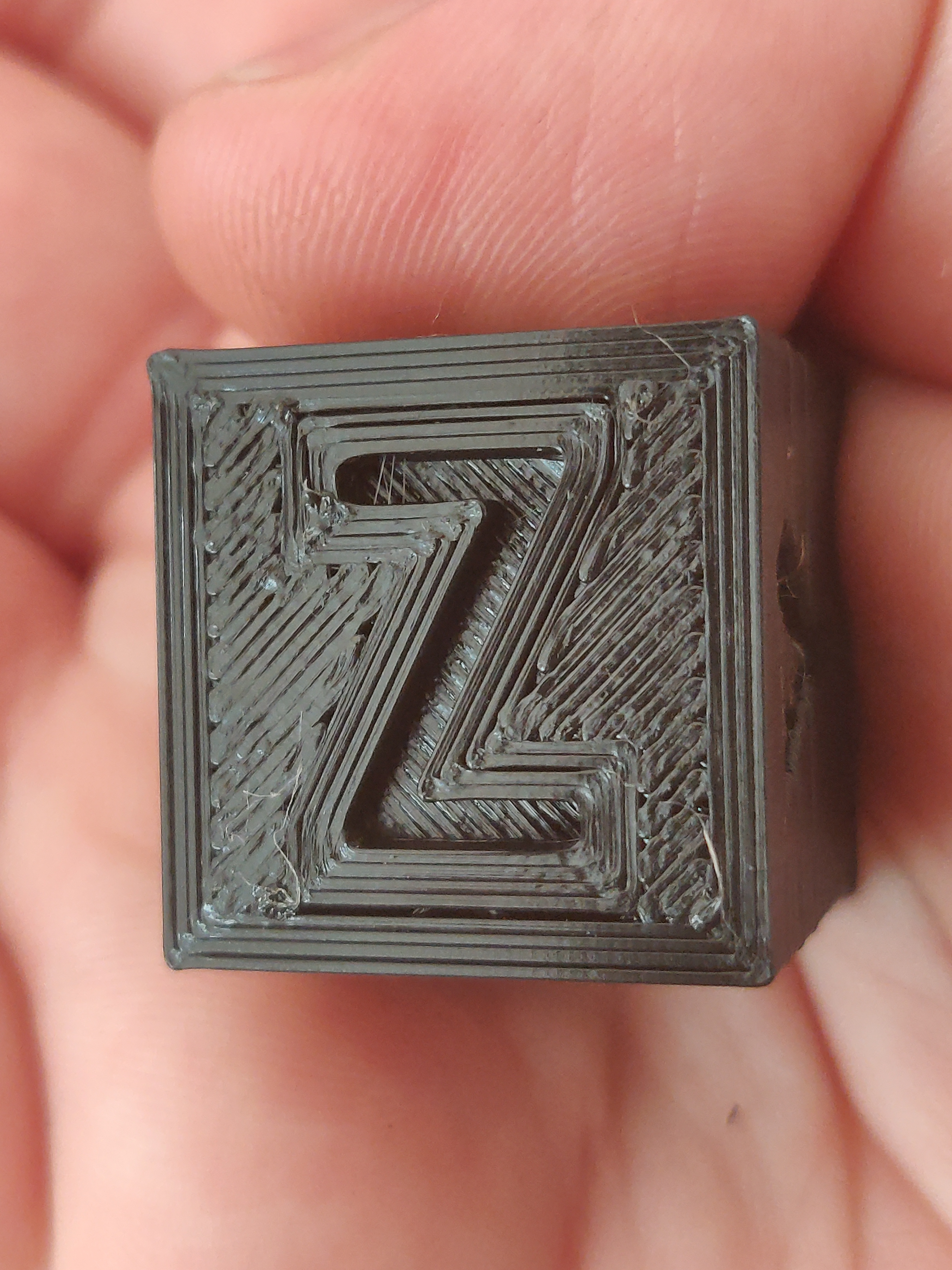

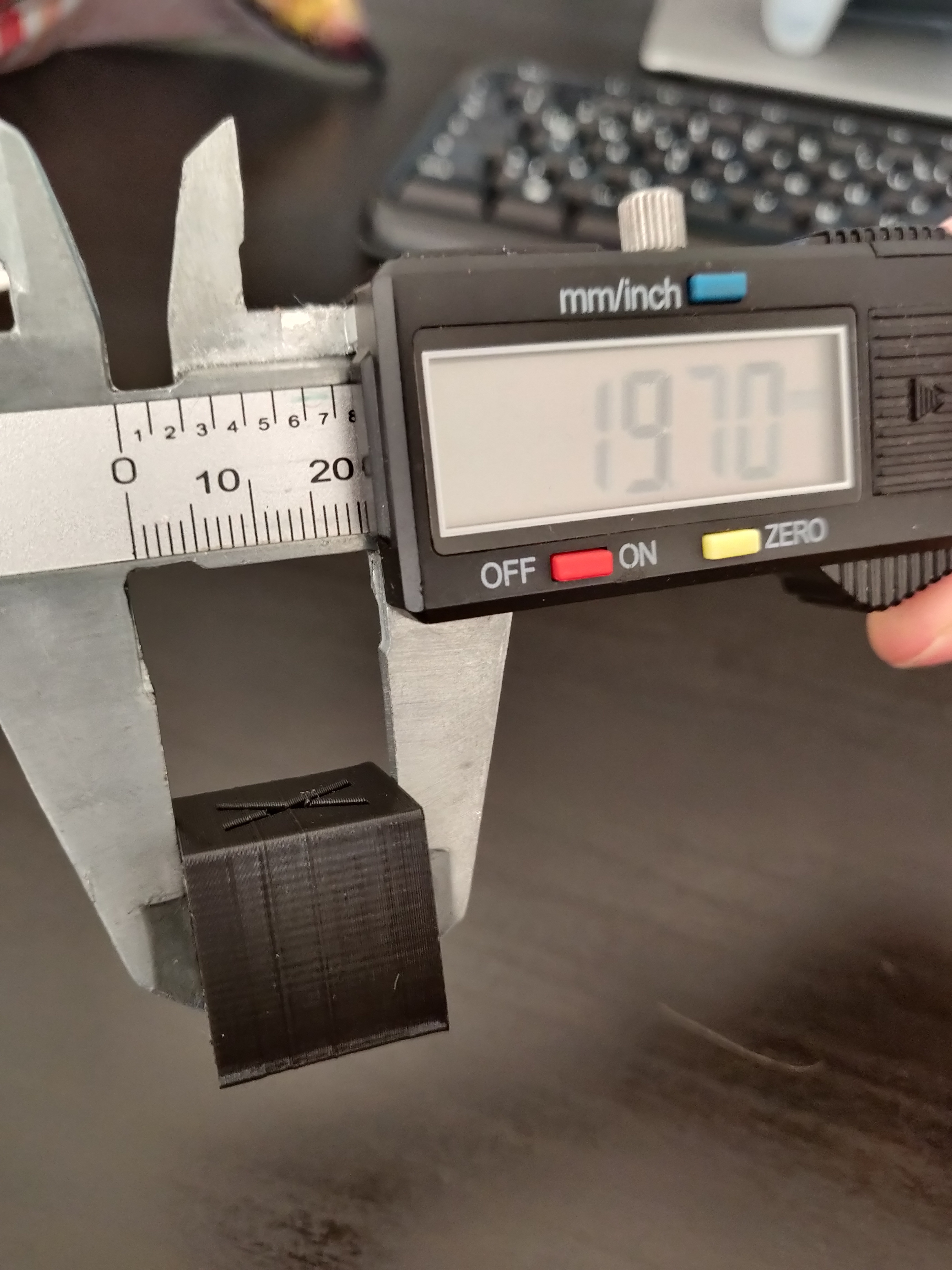

It’s not the “right” way to do it, but the way I fixed that problem in prusaslicer is to set the printer’s nozzle diameter slightly smaller than it actually is: For an 0.4mm nozzle, I have mine set to 0.35mm for nylon, and 0.38mm for PLA/PETG.
This causes the slicer to space all the walls ever so slightly closer together so you get good fusion without having to screw with the extrusion multiplier once you’e tweaked it for good dimensional accuracy.

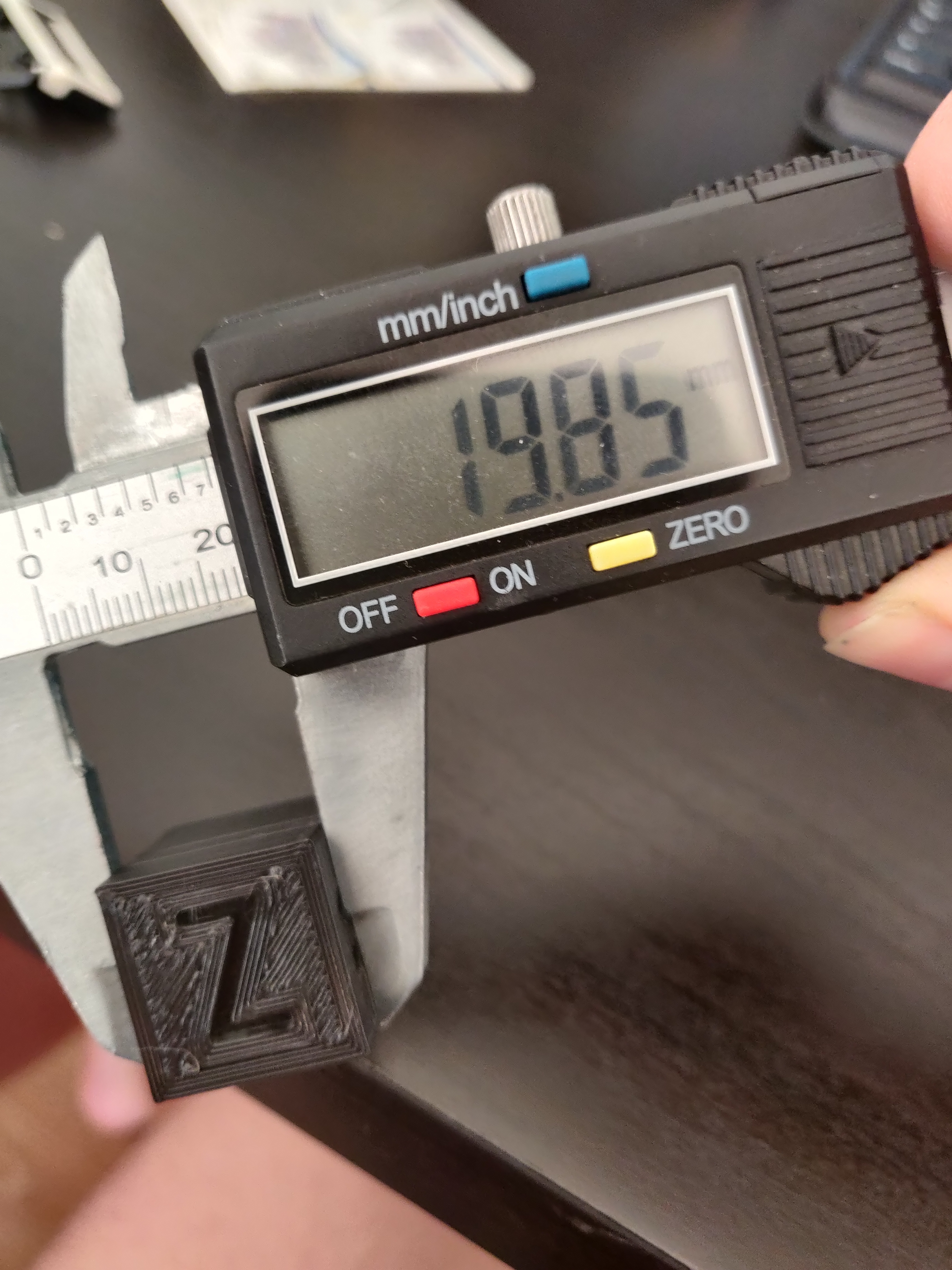

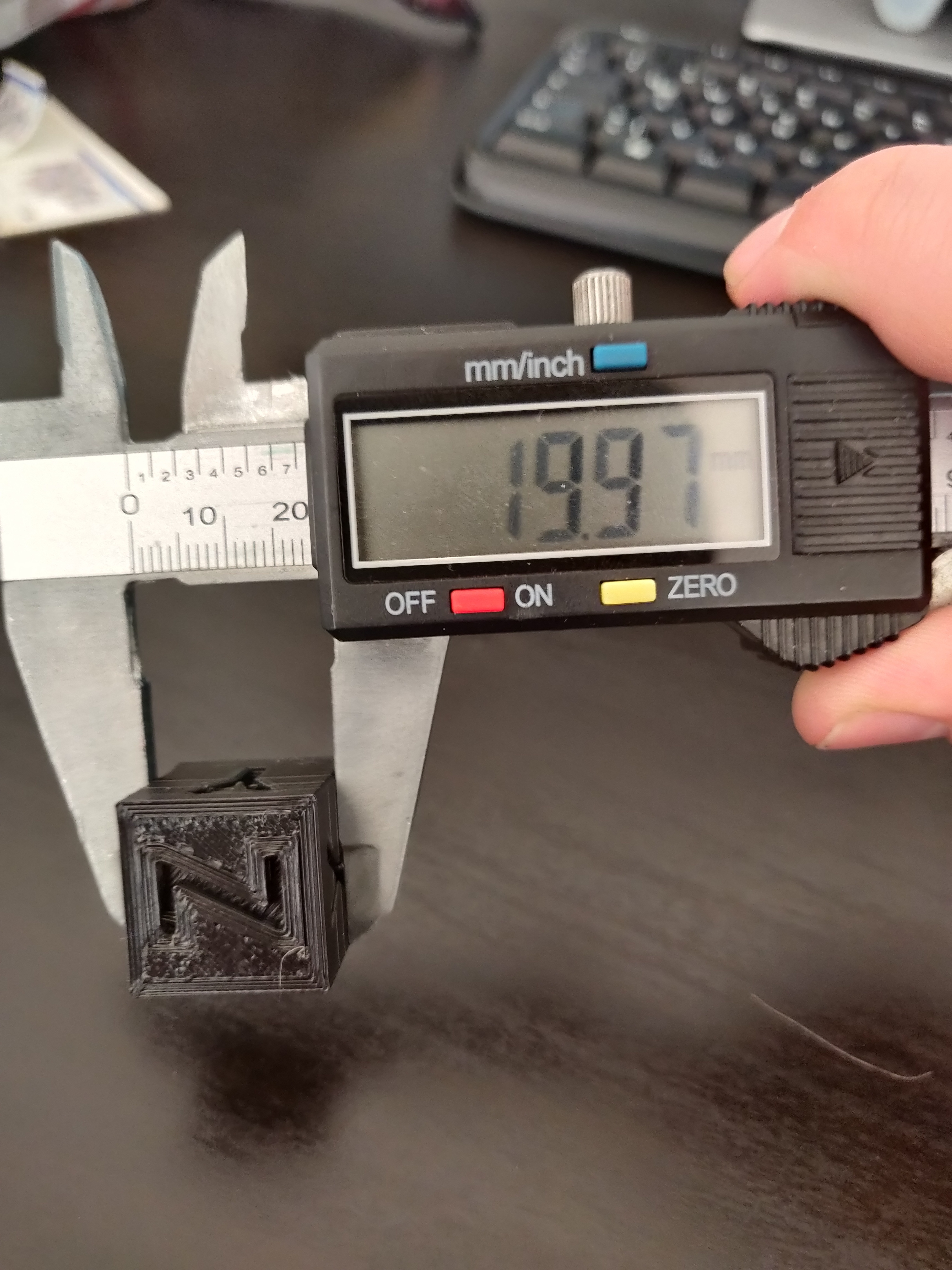

You want to get your extrusion multiplier dialed in correctly first, if you haven’t already: Print a small test cube with one wall, zero infill, and no top or bottom. Set your extrusion width to something nice and round, like 0.5mm, and then measure the wall when it’s done. Adjust your extrusion multiplier/e-steps/whatever to get the part to match the slicer setting, and only then should you begin fucking with other stuff.

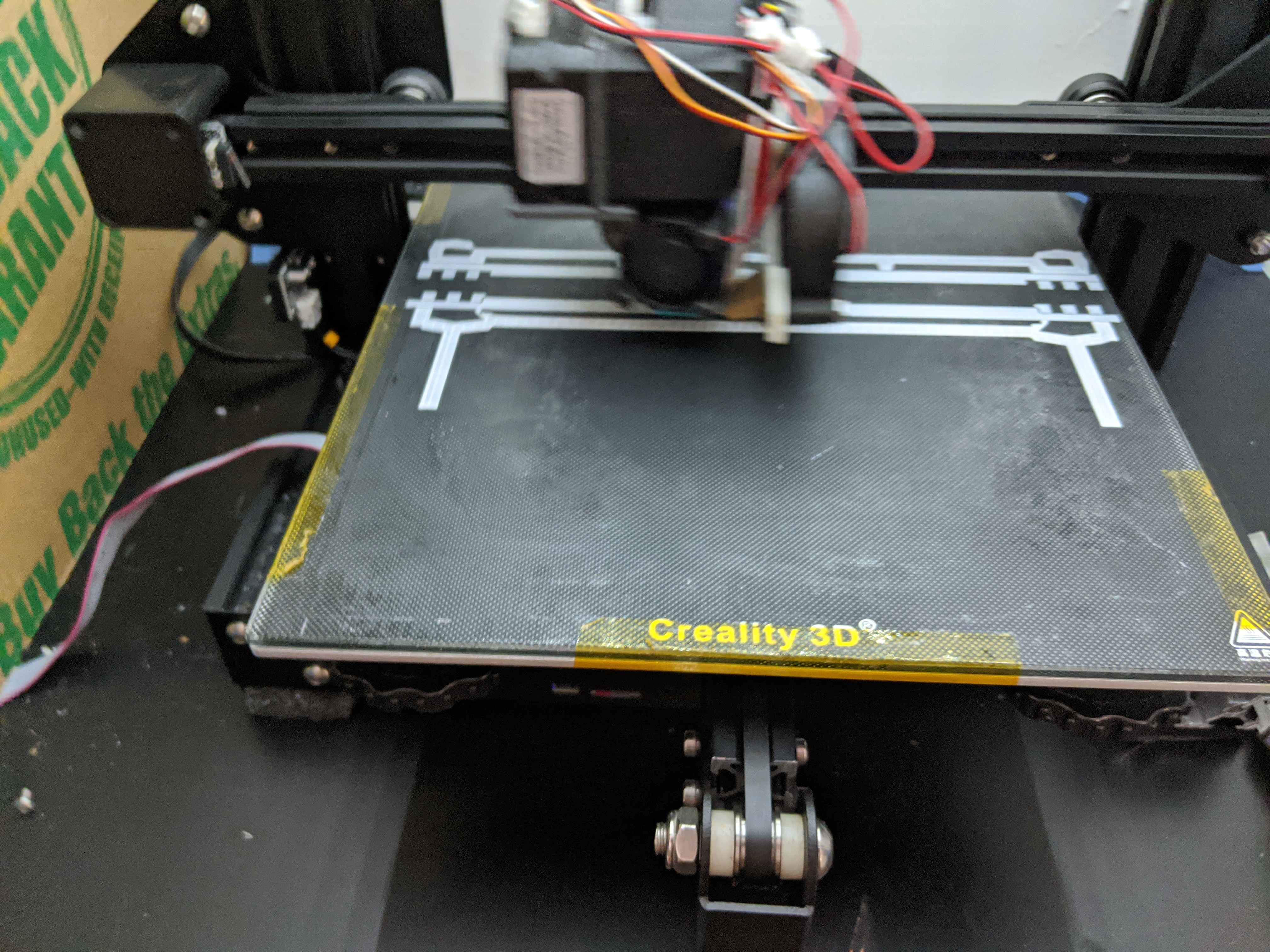

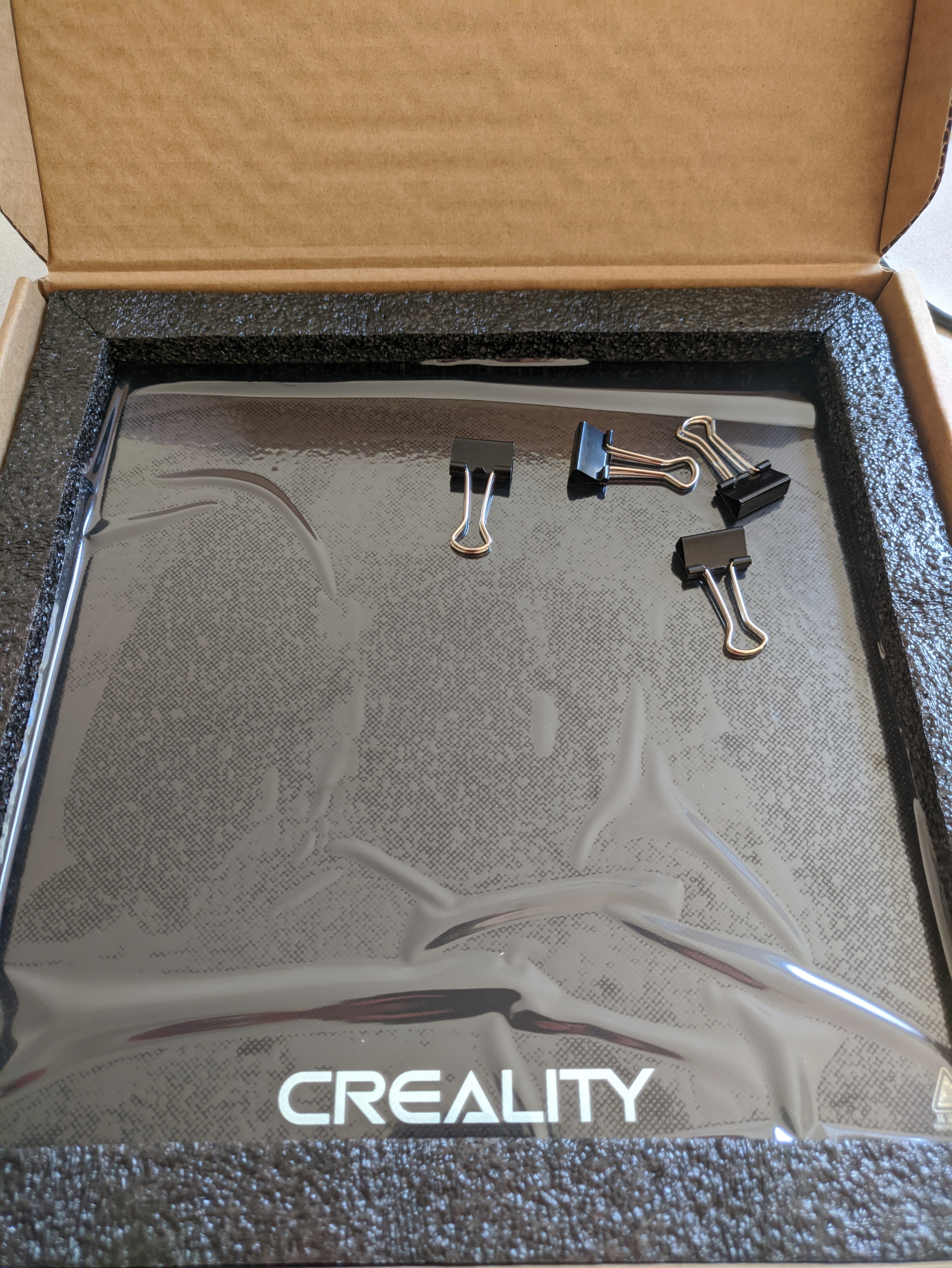

Lets see how much pain it is to configure it with the glass bed.
It’s not. Honestly the glass bed was thicker and it helps keep all my springs tight because I had to lower the bed more. You may need to move the z axis stop up a tiny bit.
And I attached the glass bed using kapton tape and not clips to have the entire are for printing…

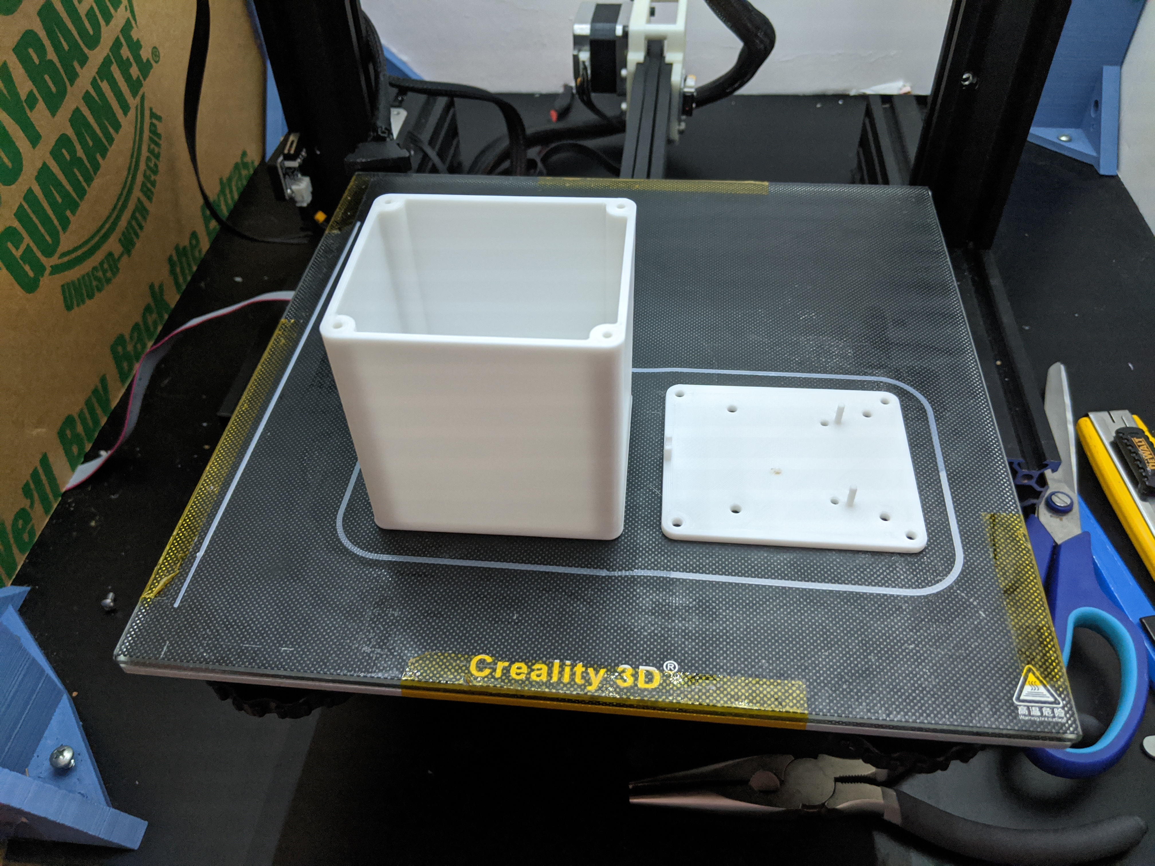

Has been like this for a year. To remove print I just use the chisel that came with it.

That’s a good idea. I use binder clips but remove the metal parts

I probably could print the whole 235mm

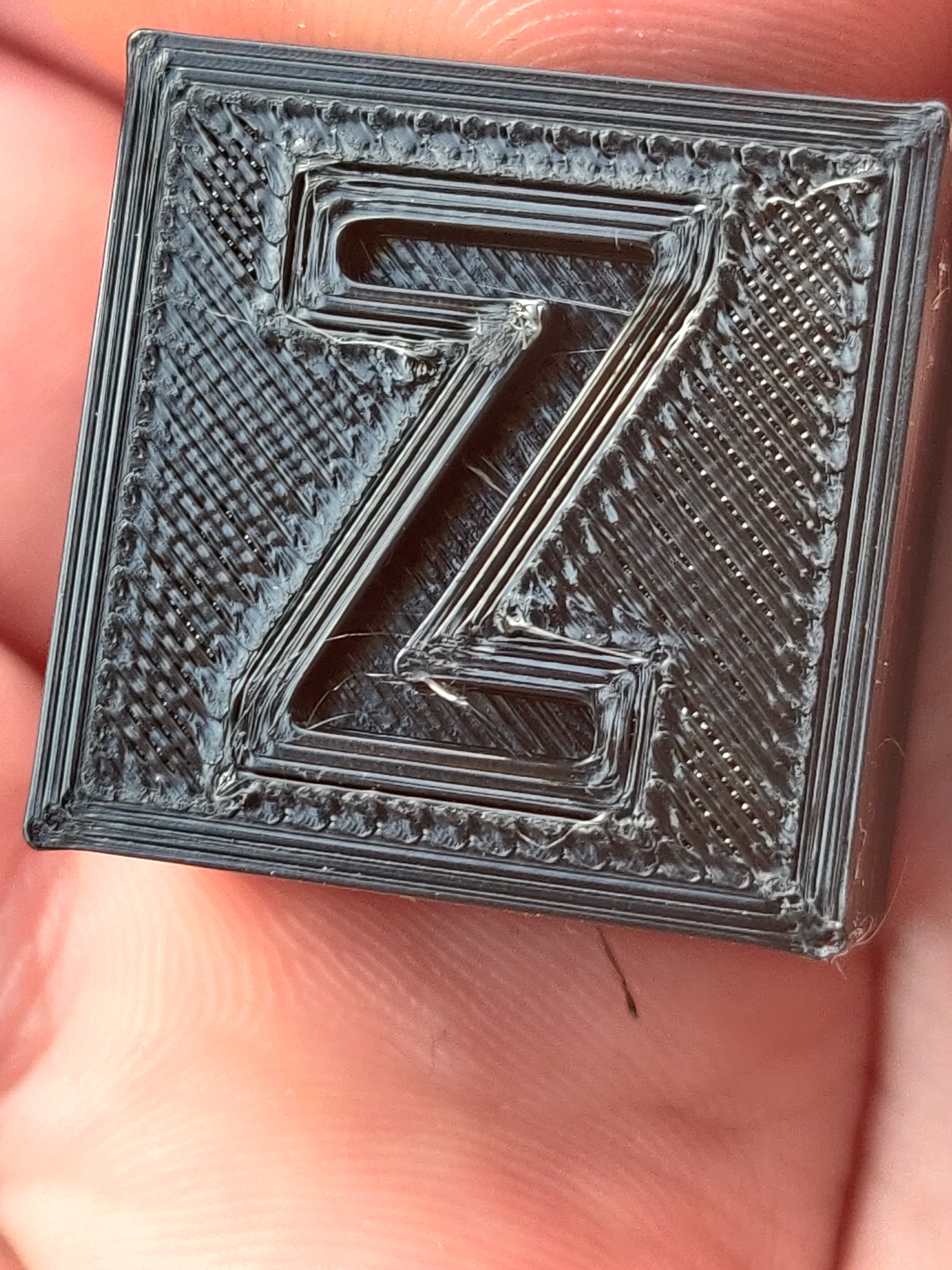

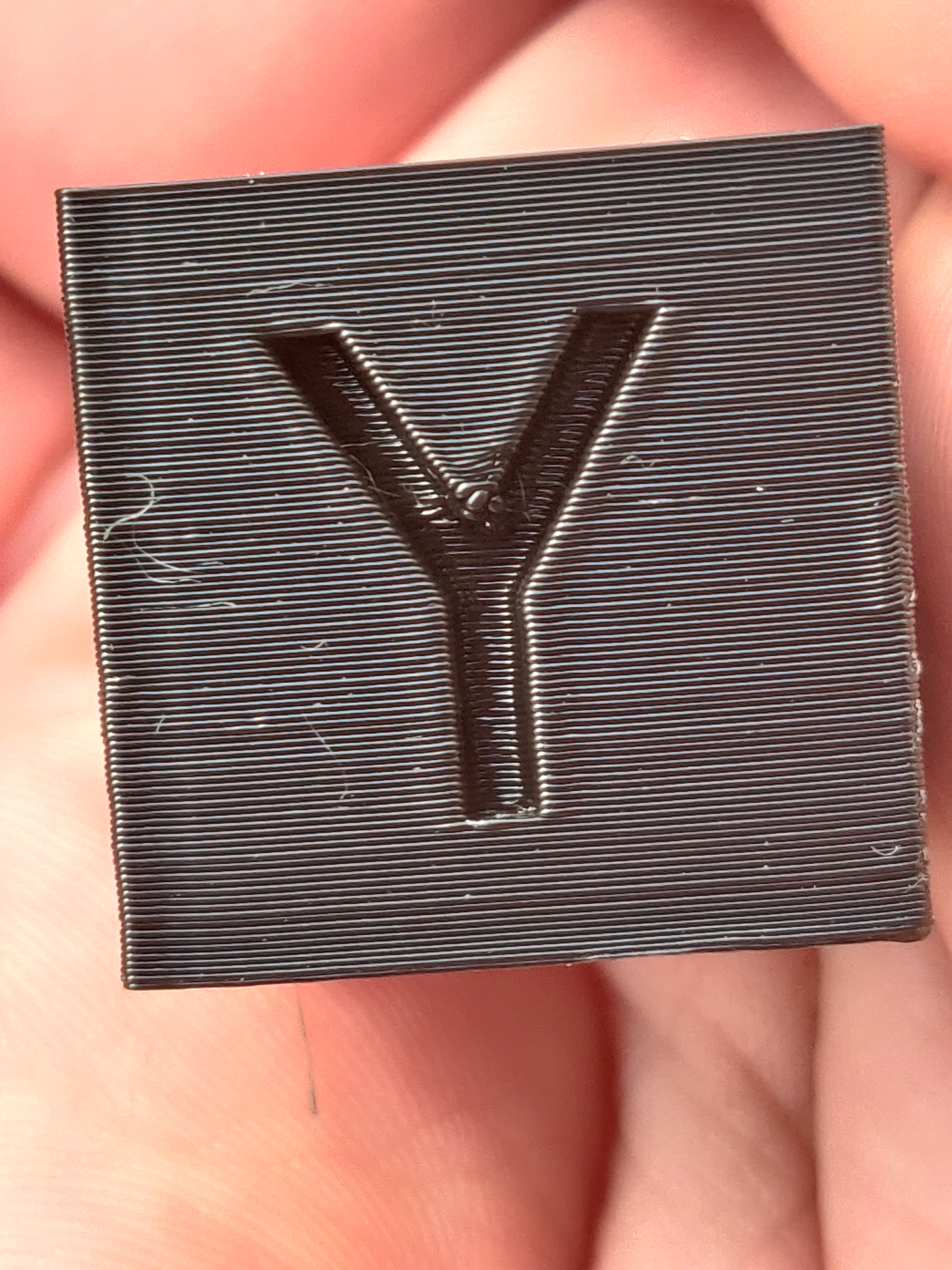

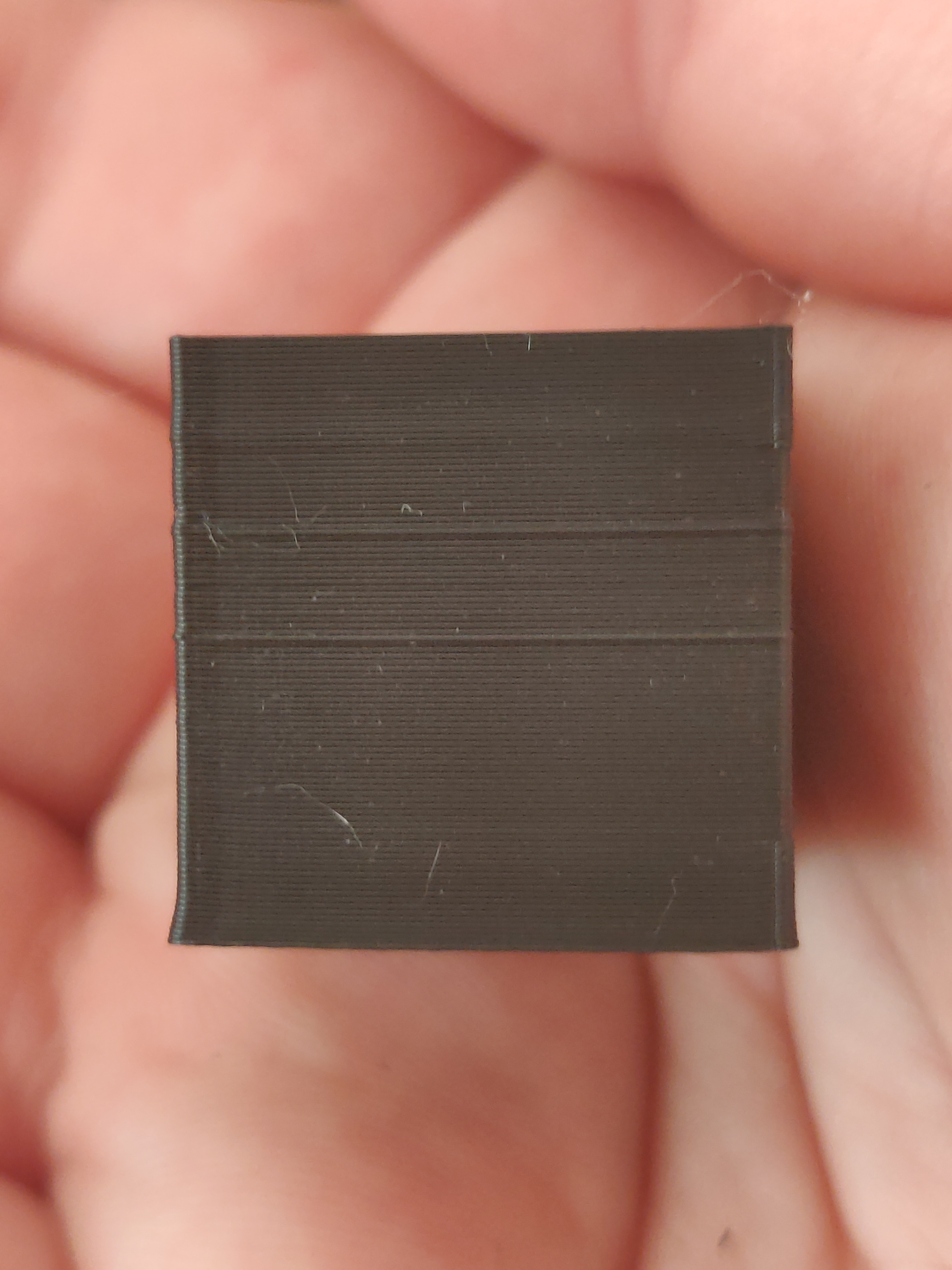

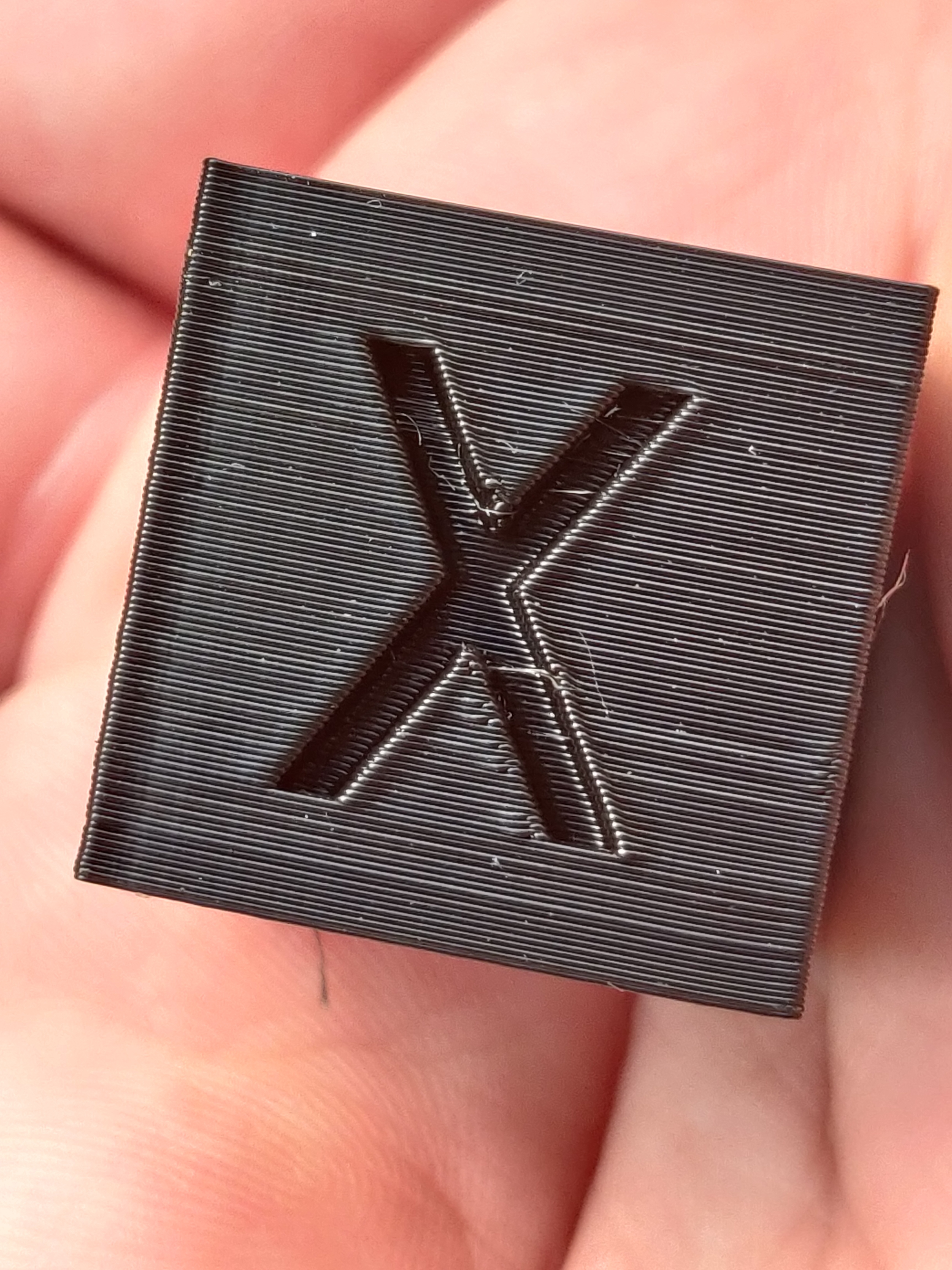

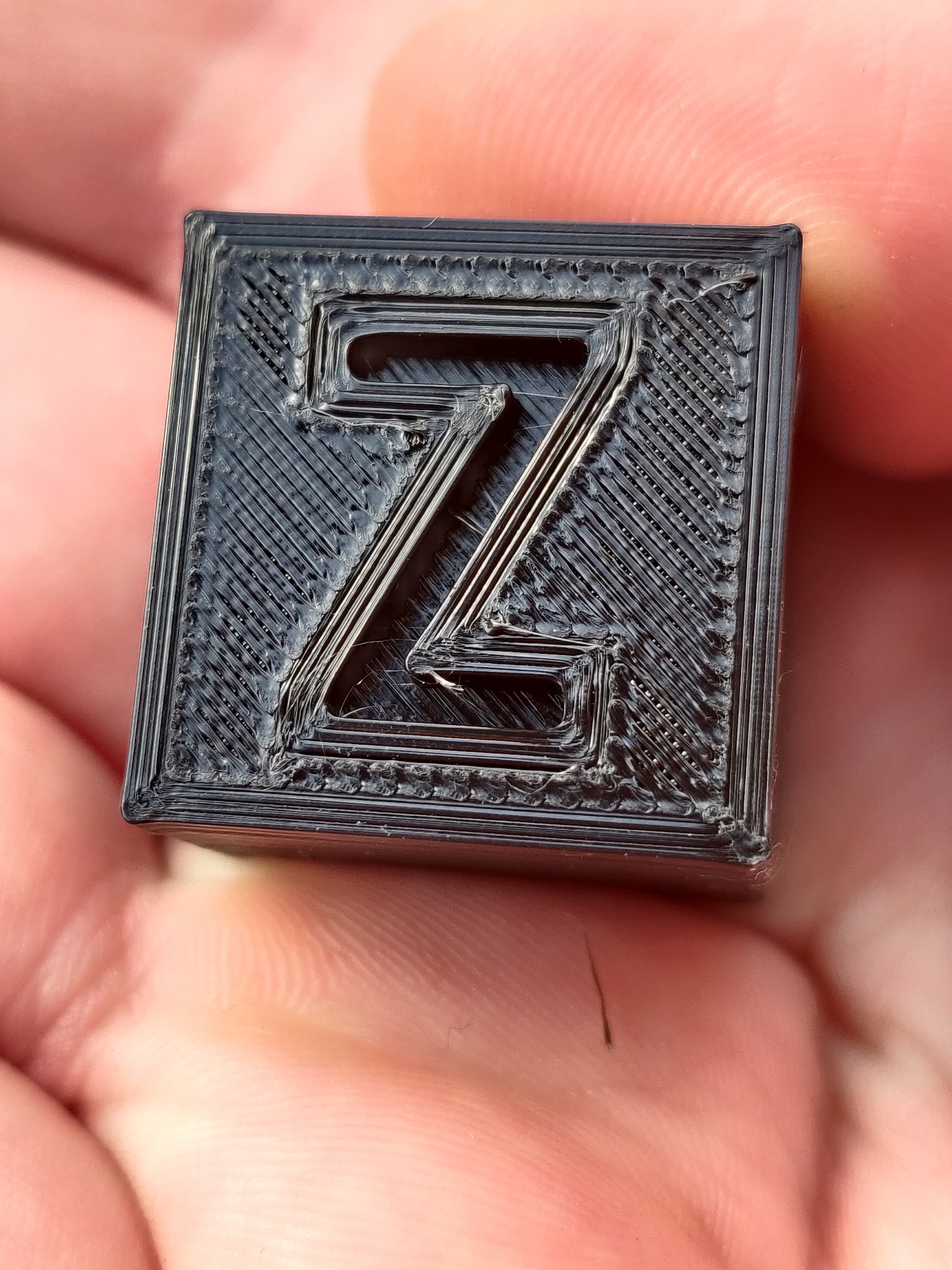

Not until now. This is straight after installing my glass bed. Man removing this cube even from a cold plate was super hard. Me not likey.
@mishrasubhransu

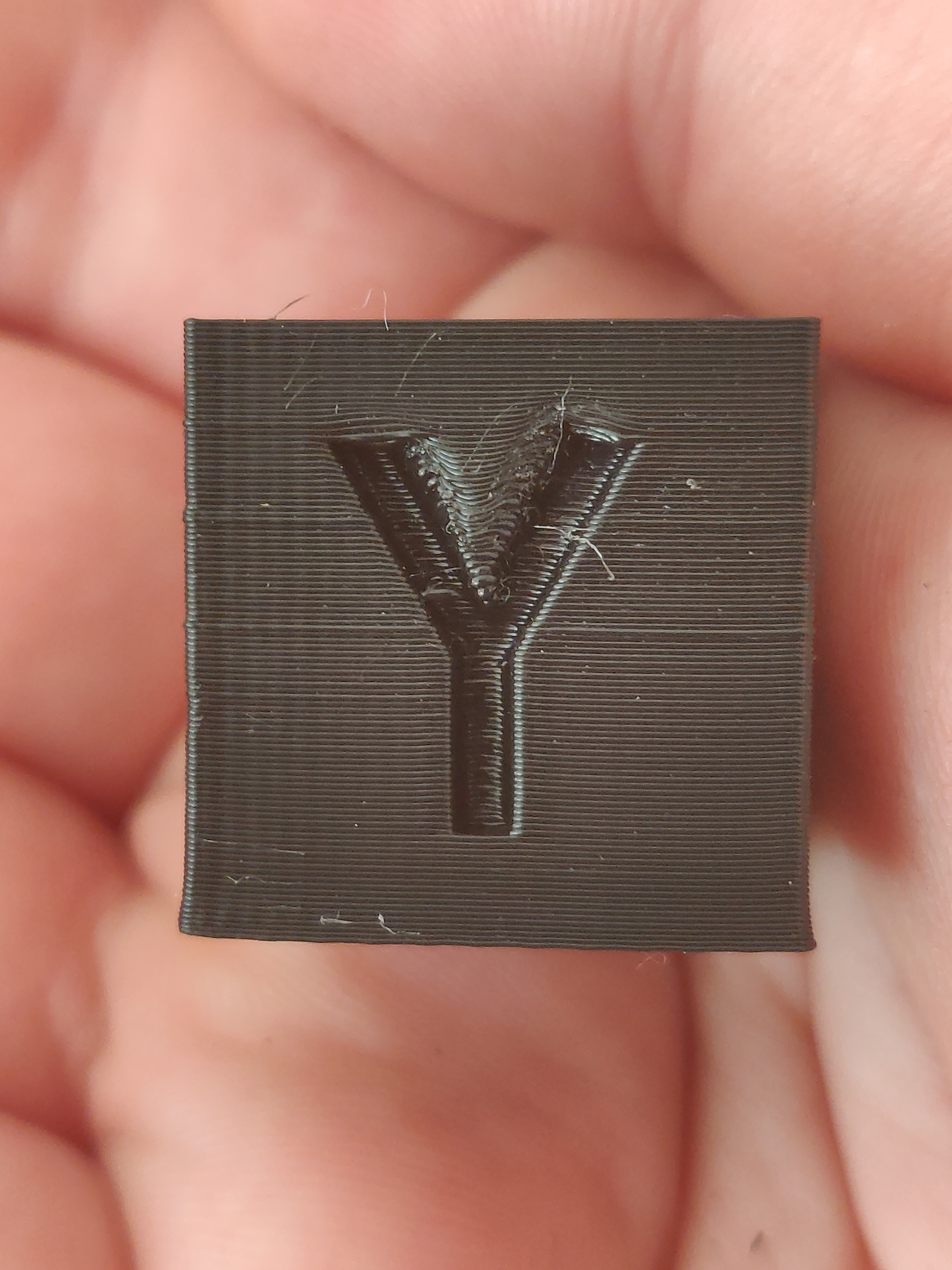

edit: cube v2 with a profile from CHEP.

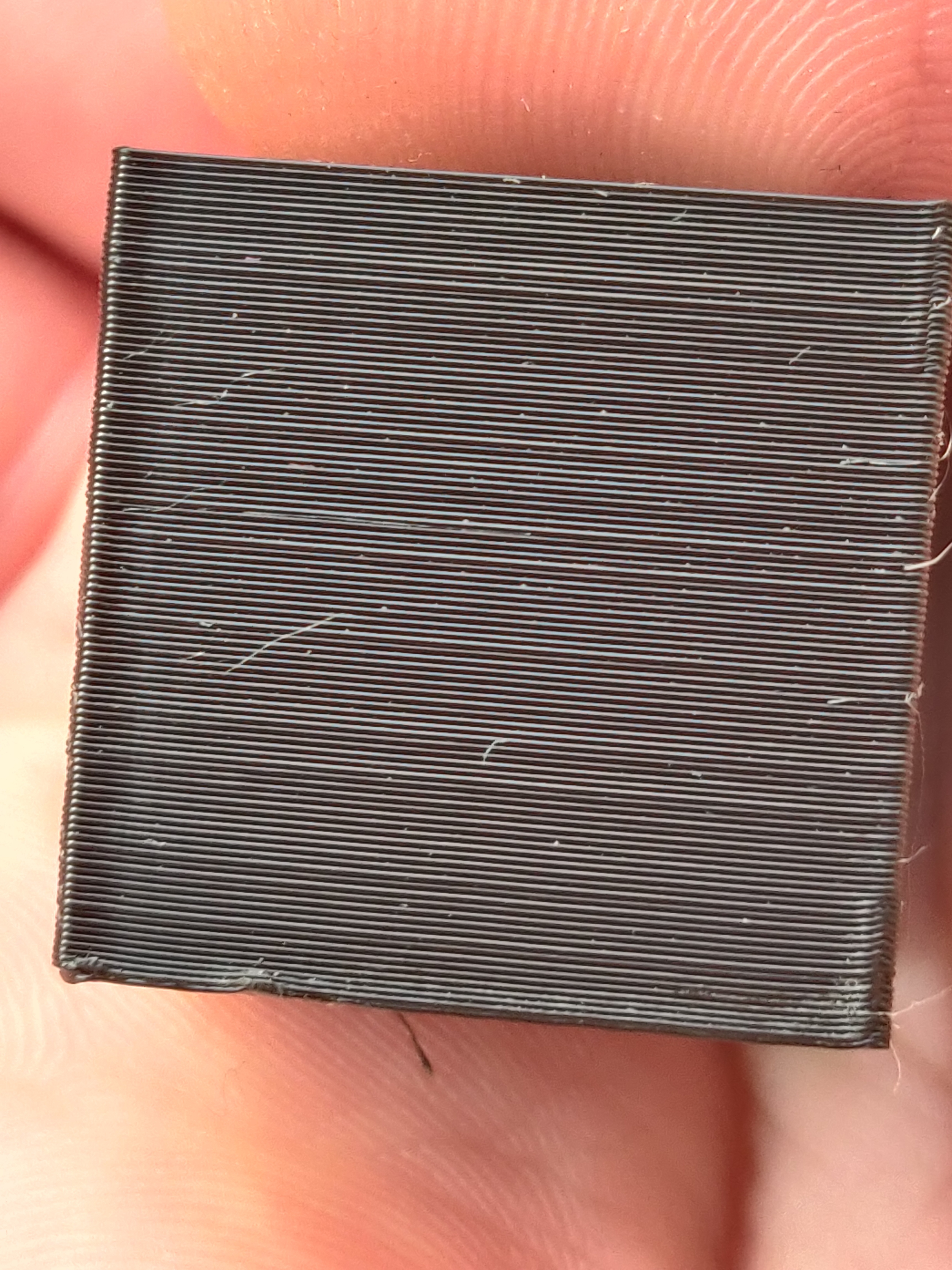

Looks like you have some elephants foot on the bottom of the cube.
https://all3dp.com/2/elephant-s-foot-3d-printing-problem-easy-fixes/#:~:text=Elephant’s%20foot%20most%20often%20occurs,bed%20and%20adjust%20your%20nozzle.
