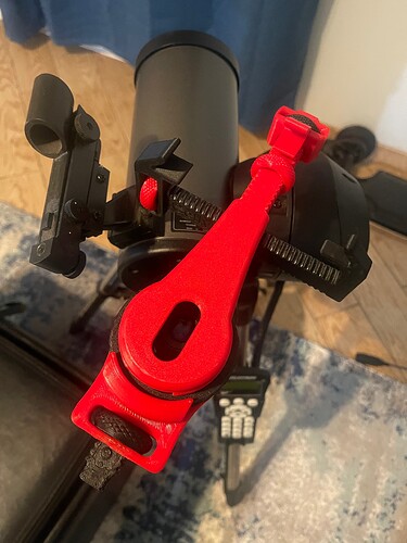

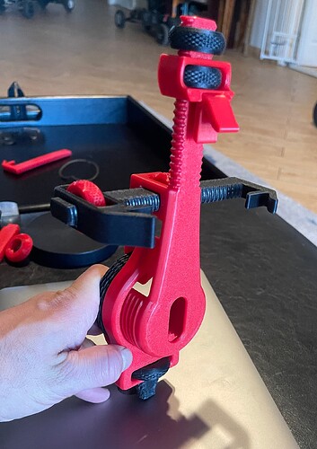

Check out this abstract art print of Gizmoduck (the patron saint of EUC and character on Darkwing duck)
Psych! It’s a universal optic mount for large phones with multiple camera sensors. Free in x y z r, optic diameter, clamps phone above optic red stage in pic, allows for protruding sensor bezels from phone.
I think it’s cool. I’ll take some nonpotato photos of the sky later.
Neat, show sky pics pls.
