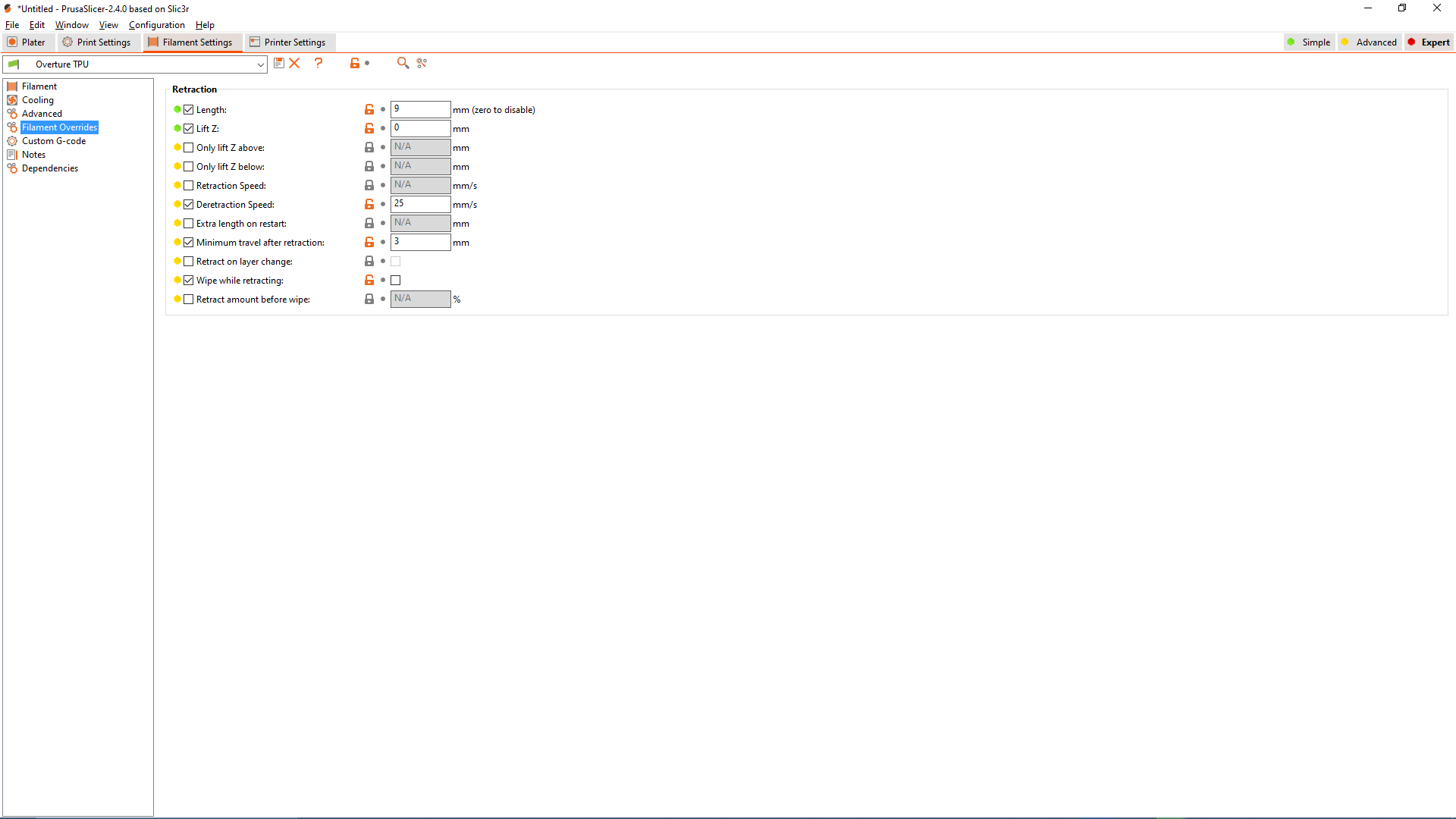

cheers I’m having a look at where to find them in prusa
Edit: coasting doesn’t exist, and I already have the equivalent of z hop off (I think anyway)
They’re definitely different settings but I’m not sure what prusa calls it. Coasting is great about hiding stringing even if it is still happening though because it travels over already printed areas instead of gaps.

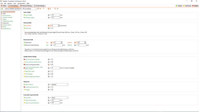

Oh yes I have that on, I’m a big fan. For prusa it’s called avoid perimeter crossings, and you can tell it to avoid crossing unless the alternative travel action would be X mm or Y% longer. Mine had it set to like 50000mm just so it never crosses if possible

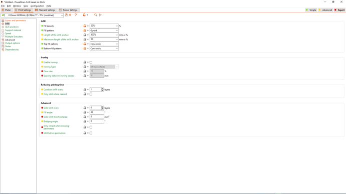

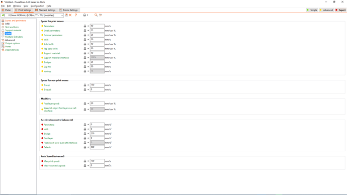

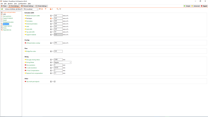

My CR-10S is pretty aggressively modified, so YMMV, but here
There’s low likelihood that plugging in all my numbers into your printer will actually work for you. A better way is to go here https://teachingtechyt.github.io/calibration.html#intro (props to @DeadLightning) and run a thorough calibration. Highly highly worth the time, and it doesn’t even take that long. Printer x filament combo is too unique to use someone else’s numbers in and go
Thanks, my printer print wonderfully with everything (I’ve been printing since 2015). My only problem isw with the tpu filament i have keeps getting stuck and not extruding. I’ll take a good look at these settings to see if i have something on that would screw it up.
Thanks again.
