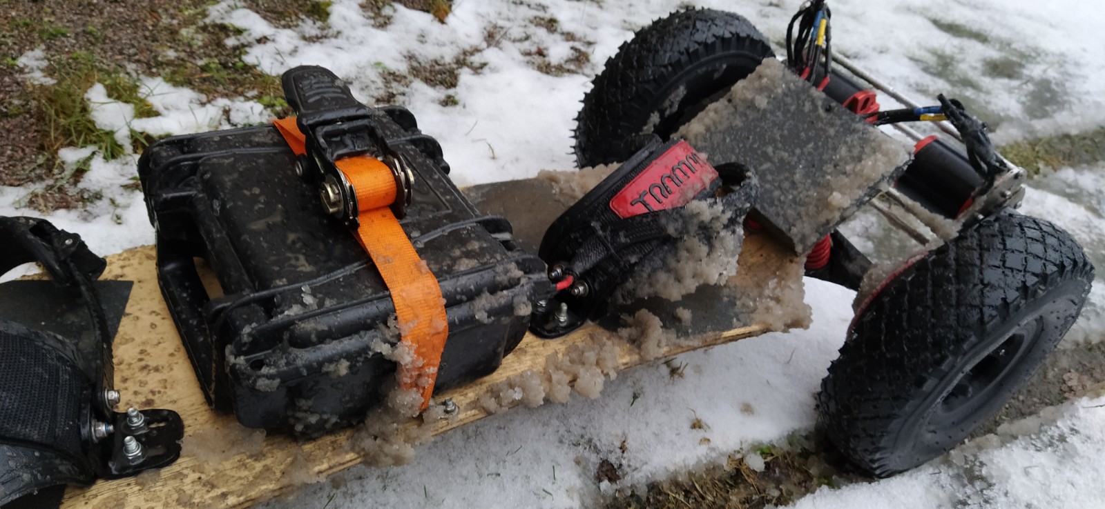

Test ride was a success, no rims breaking or wheels exploding. 17 km (10.5 mi), light snow, little slippy under braking and accelerating, avg. speed 25 km/h (15 mi/h), 22.4 Wh/km (36.0 Wh/mi).
Generally pretty smooth ride considering the riding circumstances, back tires not necessarily at a more optimum higher pressure for efficiency, but it was more a first field test for the wheels and rims.
The wheelbarrow tires are quite unbalanced, resulting in oscillations/vibrations at higher speeds (uncomfortable at long rides), but considering their original use-case and the maximum speed of couple km/h at that use-case, I’m not super-surprised that they aren’t necessarily suited for high speed operation. Maybe see if I can source a better quality outer tire, but same size inner tube.

Excellent weather on Saturday to have a test ride… Thick, wet, slippery, slush…
Got about 1 kilometer away from the front door when I started to feel the wet starting to come through my pants (to clarify, the wetness was cold and coming from outside my pants).
Higher tire pressure was used at 1,5 bar and the rims held up for the short 2 km test ride.

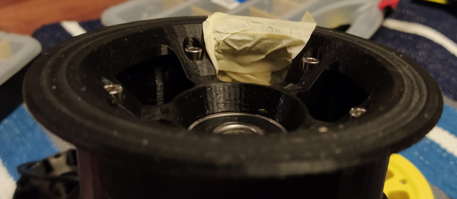

This is very interesting. Im wondering if reinforcing the inside of the rim with fiberglass or carbon fibre and epoxy would make any sense, to keep this from happening.
It would just be one layer and be used to distribute better the forces. Maybe carbon fibre makes more sense hera as it is more directional, and you could apply it in perpendicular to the print layer.
Edit: i dont know how to write.
I’d say anything that helps eliminate the stress on the 3d-print in the non-planar direction of the layers and/or adds strength axially, is gonna significantly strengthen the durability of the rim.
So you mean having a single layer of carbon-/glass-fiber like this? (tape used for demonstration purposes)
Or did you mean on the inner side?
Yes, like the first picture. In the inside of the rim.
It would have to be very well sanded down so it’s a perfectly smooth surface.
Also, if you look at carbon fiber, you can see it’s composed of several small strands. If you make them perpendicular to the layer direction, you would be optimizing it’s strength.
To apply it, as the rim comes in halves, you would have to apply it to each half separately.
Glass fiber would probably work for this also but I think carbon fiber is more suited for the job.
I don’t think trying this would be very expensive as you would need small quantities of it.
Lastly, you may want to look into the epoxy you use, just in case it melts the plastic or something. I don’t really know if epoxy contains dissolvants.
