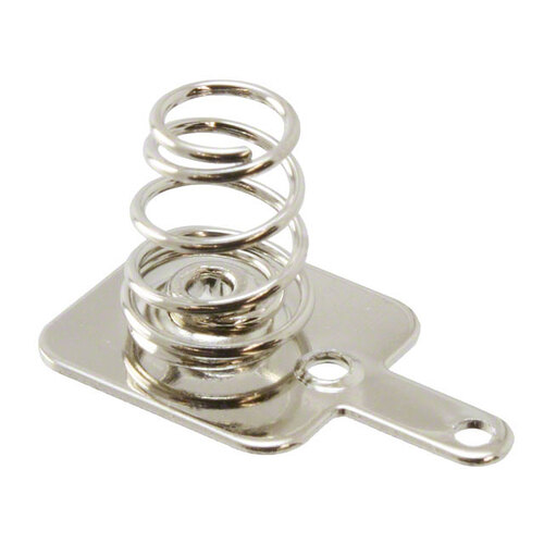

Using the original springs which were these ones
I saw a signs of arcing, but with the new contacts on the few packs that I’ve disassembled I’ve found no signs of arcing.
So that’s good and bad. It means that arcing can occur, but it also means that with the right connector the chance of it happening can be reduced or eliminated.
In another project that is very high vibration but very low current draw I use these
on both the positive and negative side. Because the force required to compress the springs is very low I can bring them closer together, completely eliminating the chance of disconnect regardless (up to a point) of how hard they get hit.

Not that I have seen. The particular contacts I use are quite high tension and have a good amount of travel. So if you tension them carefully I think the chances of arcing are very very low.
I actually think the chances are zero if you tension them to just over half the travel distance of the contact. Then there’s no way they can physically disconnect. But i don’t do that because it is a tremendous amount of pressure and I never bothered to look up the maximum compression a cell can take.
Ok, but now that I think about it if the arcing is caused not by momentary disconnect but by very high current demands and the connection between the cell and the contacts heating up that could be an issue.
These contacts are gold (flash), and the surface area is pretty good, maybe as much as if you added up all the spot weld points (unless you lost your spot welding mind)
But as I said, I top out at 60A which across 5P is 12A per cell. If you’ve got a 45A cell and you’re dumping the whole thing then you should probably bench test your assembly with a firebox handy.
