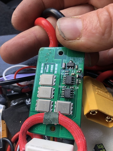

Ok so I’ve been trying to have a chat with kugliss about this to try and analyse what’s gone on but in the absence of that here are the preliminary findings…
My anti spark was charred as was the enclosure foam that was touching it. Unbelievably the anti spark still seems to function normally. Kugliss thinks that something conductive found its way into the shrink wrapped antispark initiating the short and shutting off the board. This fragment would have been vapourised so who’s to say
what if anything did this.
What I’m trying to work out is if there is any chance that the burned anti spark is a secondary effect. Now bear with my idiocy here and put me straight where needed… if my battery became disconnected briefly and shut everything down could the speed I was going generate enough emf in the system to initiate an arc in free air across the anti spark and therefore the damage? I’m hoping the answer is a resounding NO! so that I don’t have to open up my extremely heavily wrapped and sealed battery and can apportion blame to the anti spark.
No matter whether it was the antispark or not you are still going to have to strip that battery heat shrink off and inspect the battery. If only for peace of mind.
Like I mentioned in DM problems was that something got inside anti spark case and shorted output to ground the trace on the left is output and right is ground and something managed to make an arc strange it didn’t vaporized track on the left (still can’t find my head around it).
So my assumptions that then shorted voltage dropped enough to shutdown power to logic and switch restarted to off state (consider as turn off power and plugged back in) but this small arc shouldn’t have caused it in my assumptions. Everything else on switch looks pretty good and if it works then I am don’t know what caused that burn.
The culprit in my thoughts is that power went low and it reset switch but I can’t figure out what managed to kill power to so low. (Also don’t know if its good to in future design make a change to keep previous state before power reset)
EDIT: Just for guys who compare their own switch this is first version of this switch and DIY. Design since then has changed later on…
EDIT 2: Regarding generating enough EMF to cause arc that would need few kV to make this happen but then everything would had fried…
I’m bypassing the bms so that shouldn’t be an issue for me… @Kug3lis the main damage to the board is on the buzzer side where the ground plane got very hot over about 1cm2, I think the scorching on the fet side is from that heating. How about I send you the switch to diagnose?
Full autopsy completed and board up and running again.
No visible faults anywhere other than the anti spark. The buzzer was loose on the anti spark which may have created a conductive solder flake… who knows. The anti spark was compressed which added a slight bend to it which may have caused a crack in a trace… again, who knows?
Replaced the anti spark and made sure it was not squashed in the enclosure and all seems well… very nervous to push the speed now however!
