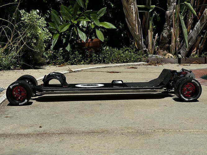

Yah my suspicion is that the shaft collars that hold the links (one or both) may have been loose, which allowed the entire axle to turn, its very weird for sure
Did you make any changes to tour settings? Or it just went berzerk out of nowhere?
the shaft collars were stil tight.
the radius rods jam nuts were still tight.
it’s the main heim’s jam nut that was loose. allowing it to rotate around the axis of the spine.
that’s what i’m suspecting got the leverage to break things. less scientifically the bend directions in the radius rods appear to follow this twist.

red wheels look ![]()
