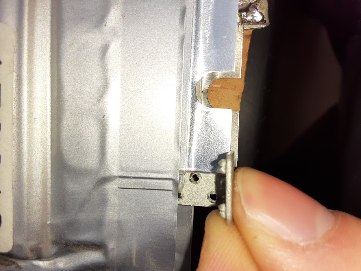

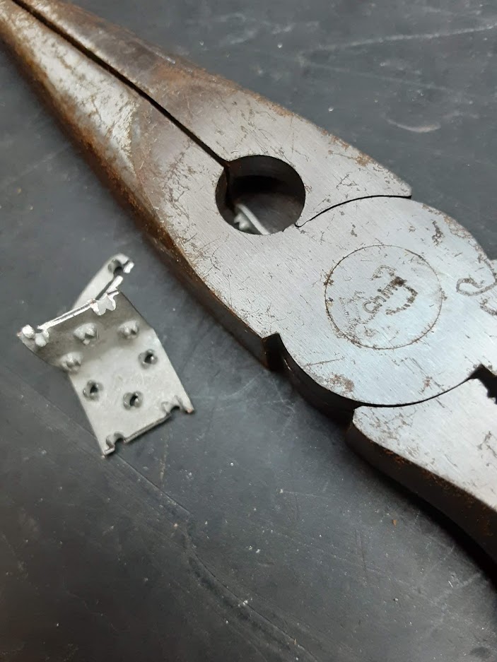

I’m having an issue where the foil clamps are too deep and would punture the cell foil if I pushed them in so all the teeth go into the tab. I don’t think you mentioned anything about this, did you crimp them so only 3/5 of the teeth were in the tab? (see pics)

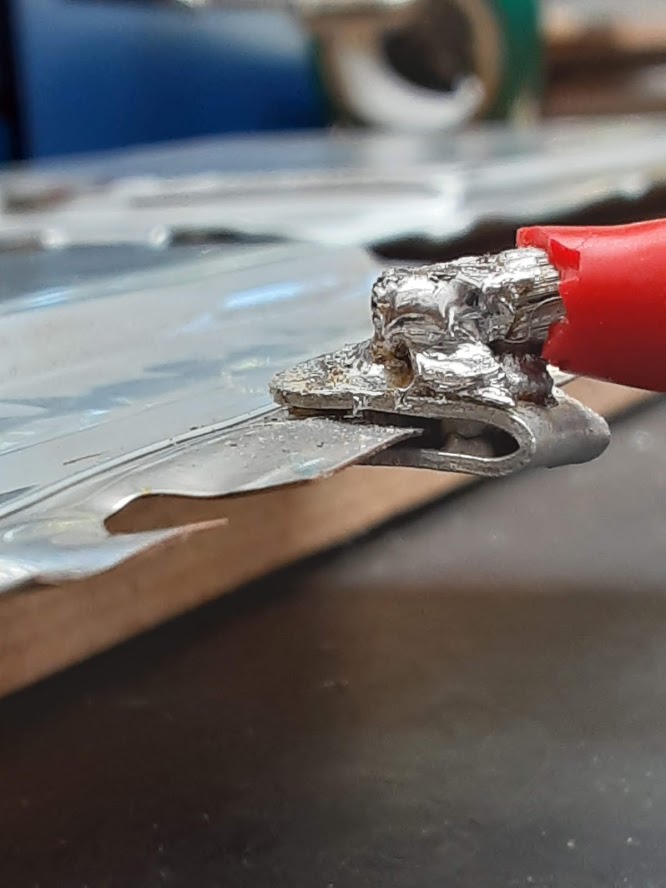

Well, first you gotta get more heat into the solder Joint prior to crimping.
We might have ordered different crimps.
damn, I ordered the ones you linked, I should have done my own measurements to check.

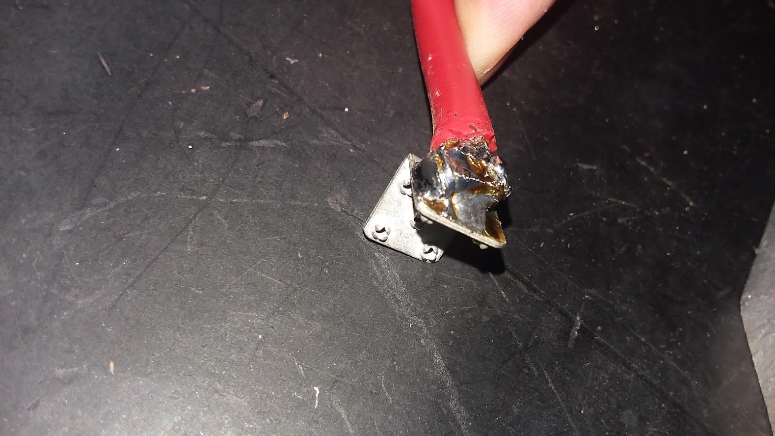

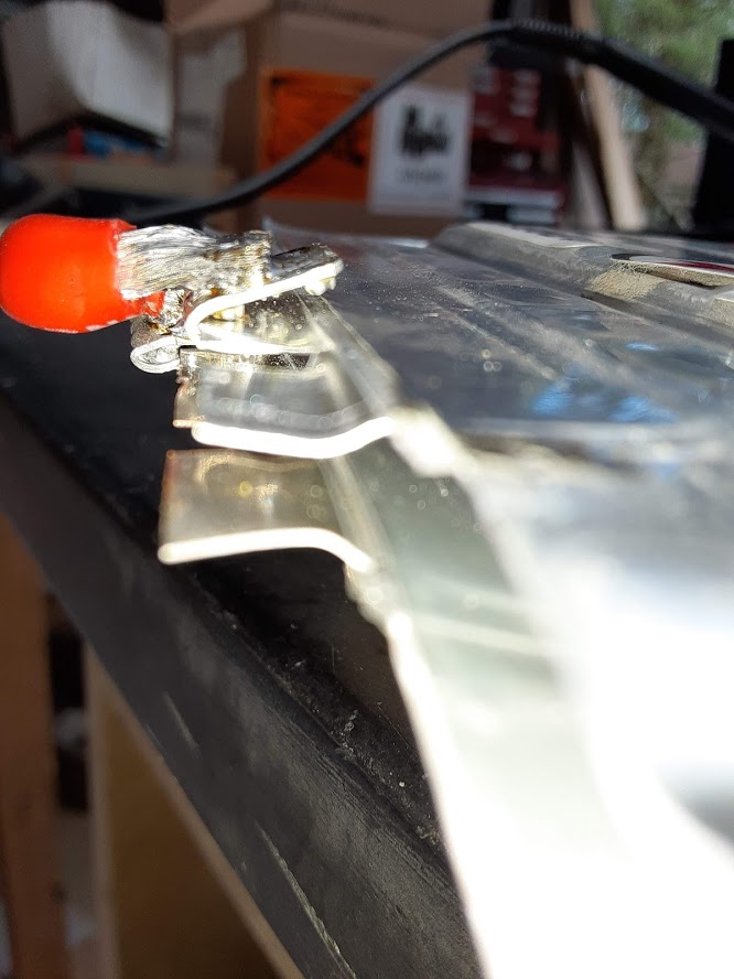

That first one looks little rough, it has good contact I tried to add more solder on top and that got cold because of the copper wire taking the heat away. The last pic shows the much better second one.
haha gotta tear that first one off anyway so don’t worry.

just a tester, I think this method could work for me.

I realize of all the people who should have known the clips were the wrong size… was me and my cad models haha
I did not get detailed enough with the tabs (I didn’t take the tape off the cell I measured and made the drawing from)

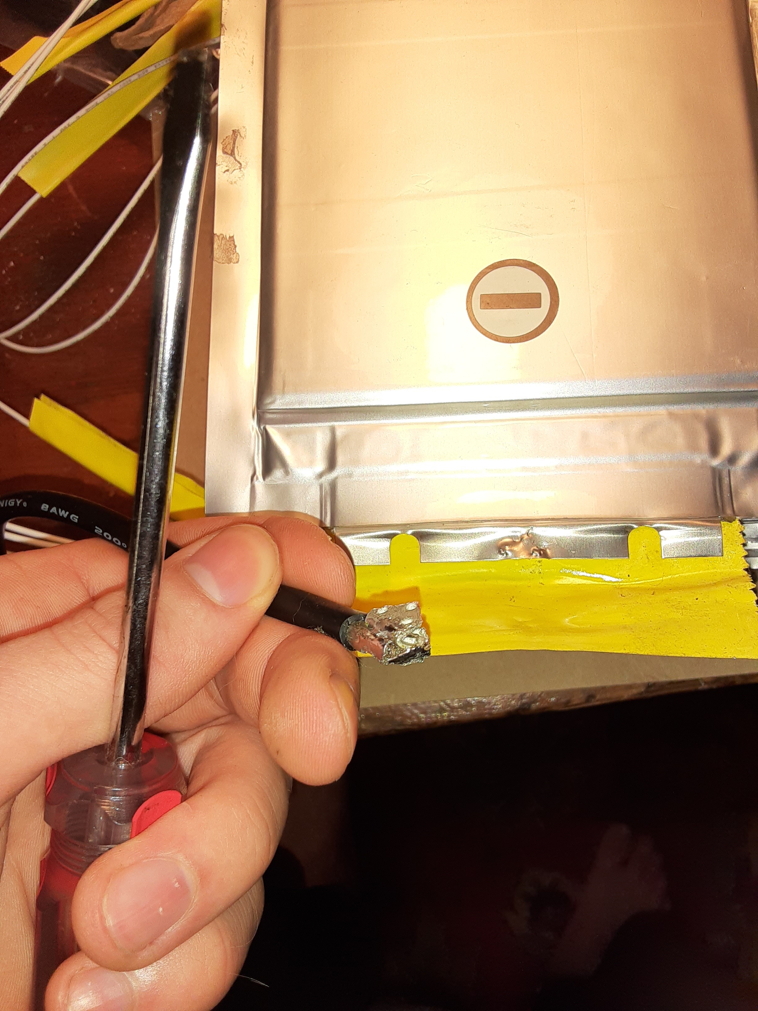

I seriously recommend the aluflux. hold your breath when soldering and its nothing to it. So much easier.
late night struggles with my last cell
