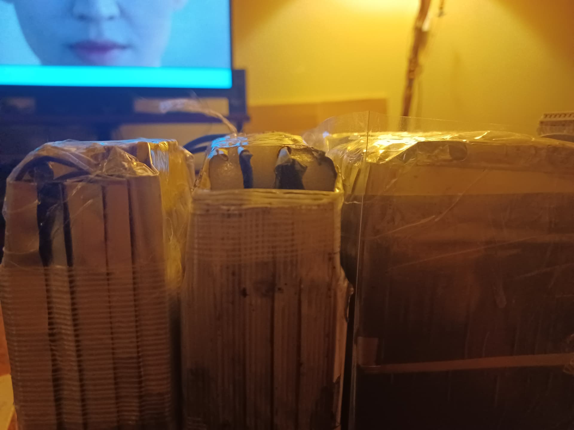

Small ammo can fits 10 cells exactly with no room for any foam at all, so good thermal conductivity I guess?
On either end you can shove a VESC6 also a 10S3A charger(case is too tall) and a Xenith on top fits nicely.
Ok I haven’t made the 10S to fit that metal ammo box above funny enough the case I’m about to show also fits 10S exactly so that is next for sure.

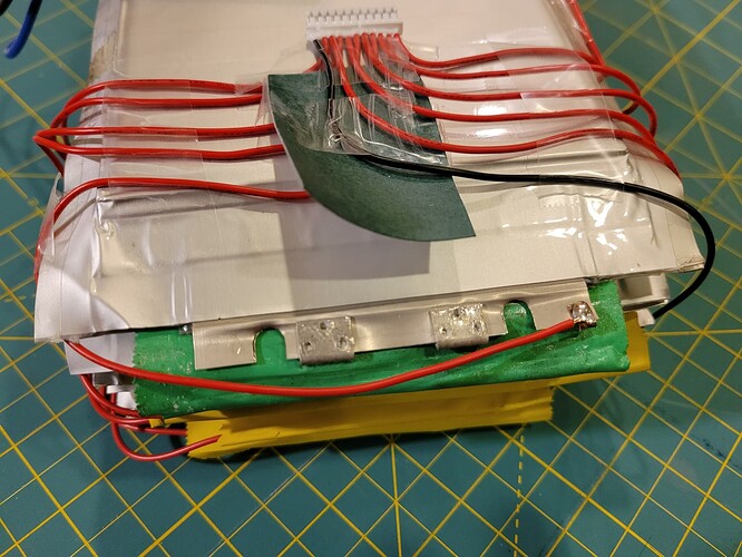

Thing is the cells fit so tightly in the long dimension there wasn’t a single millimeter spare for how these foil crimps normally poke out on the top and bottom. So I had to trim the tabs so that dimension would stay at 210mm or whatever.
2 hours later, cells I actually tested and matched for the first time. Idk the time to make the harness but 1-2 hours as well.
Just barely squeezes in without bending the ends.

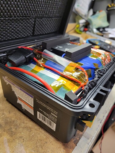

Harbor Freight Apache 1800 fits 10 spim08hp 200A pouch cells, idk if room for a BMS even.
I wanted to add that while cutting the tabs and putting that last pack together it occurred to me that using screws and busbars would fit just fine in this cases close dimension… guess I should try that for one.
Dude, I happen to be doing the EXACT same thing…
10s1p using the foil crimps in the small HF Apache case. Debating about stuffing a Daly BMS in there too, or to just add the harness to enable balancing “occasionally”.

Here you can maybe see how I cut a few mm off carefully aligning before crimps and tape. Also I finally tried heat shrinking these packs with 220mm clear PVC, that size just barely fits 12 cells but also shrunk down enough for 6 cells. Nice that I randomly picked that.

@Fosterqc , just following up about the 10s spim08 pouch cells in HF Apache 1800 case. It came together for me as you described… tight fit particularly in the long dimension. Daly BMS just fits on top. Here are some photos. It’s been in service for ~4 months.
