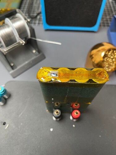

So the pack seemed to be in good health. All the p-groups measured 3.95 except one was at 3.6. I found that some cells in that group has broken spot welds and had separated completely.

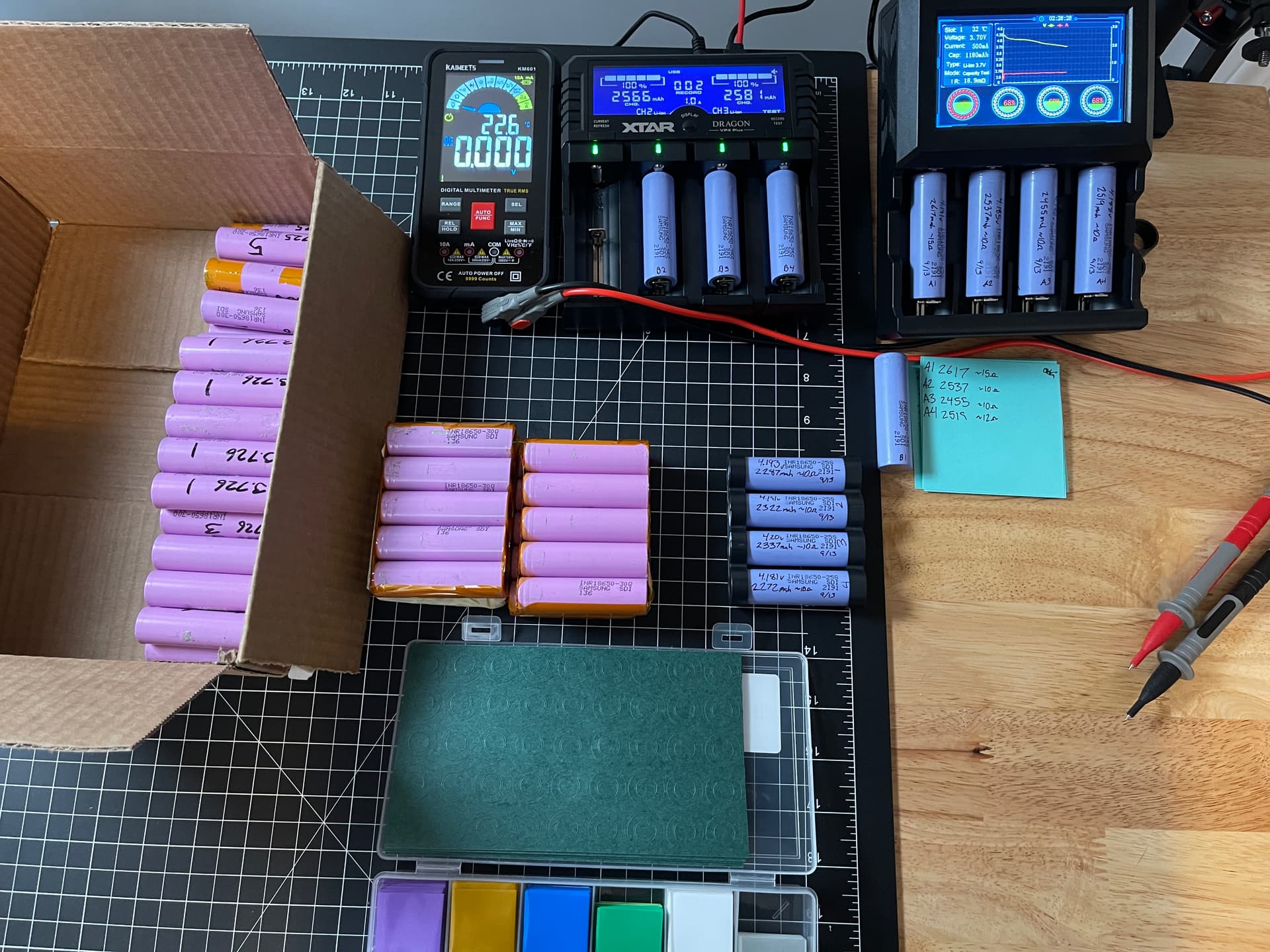

These chargers are hella frustrating though. The EBL is giving me very consistent and accurate capacity measurements. The ir readings not very consistent with 18650 because it sits so low that it doesn’t make solid contact (21700 is consistent though). I did some research and heard great things about the VP4 plus, but the capacity measurements are crazy. They’re way too high and half the time it gives the same capacity for both charge and discharge, which doesn’t seem right. But the the IR measurements using the probes are excellent for 18650. :expressionless:
I would love to have one charger/analyzer that just works. Any suggestions would be greatly appreciated. The only other solid option I’ve found is the mc3000 or the mega cell 16-slot from jag35, but it’s pricey and looks overcomplicated for my purpose.

That makes sense to me too, but all the tests iv’e seen always have a slightly different rating between the two. Over the past couple days it’s only been showing the same number on slots 1 and 4. This is repreatable whether I retest the same cells or different cells. It kinda feels like something isn’t being calculated properly on those slots. It’s also rating 3 year old samsung 25S over 2600mah. The other one is showing the same cells around 2250-2350mah.
I’d say go with the tool that can give you the good capacity measurements since you can’t as easily test for it yourself. IR are super easy to test and I did mine with just some diodes as the circuit load and then a multi meter.
I have only used a “dumb” charger though that can only charge cells safely but can charge many different battery types. Bought it for NiMh batteries originally but it works on Liion too. So I can’t give any recommendations on brands
Word. I’m probably way overthinking it. I got the second charger to speed up the process, but I guess I just can’t use different chargers to analyze cells that are going in the same pack.
I have a liitokala lii-s8 and an opus bt-c3100. I use both for cell charge and capacity testing and only the left most slot on the liitokala for IR if im not using my home gamer ir tester. Don’t mix testing apparatus for the IR test.
Every slot in your or any charger will give you different results and every little parameter change will alter your results. Temp, SOC, rest period, angle of the moon, mars in retrograde, all will change the IR reading so I try to test every cell at the same time and soc and know that the results are only good for relative comparison of the set that i test. Kinda drove myself mad trying to make a good consistent testing rig without success.
I test three times pulling the cell out of the test rig im using each time and take the average discarding any outliers that are probably caused by me not inserting the cell properly, or bad connection, or both.

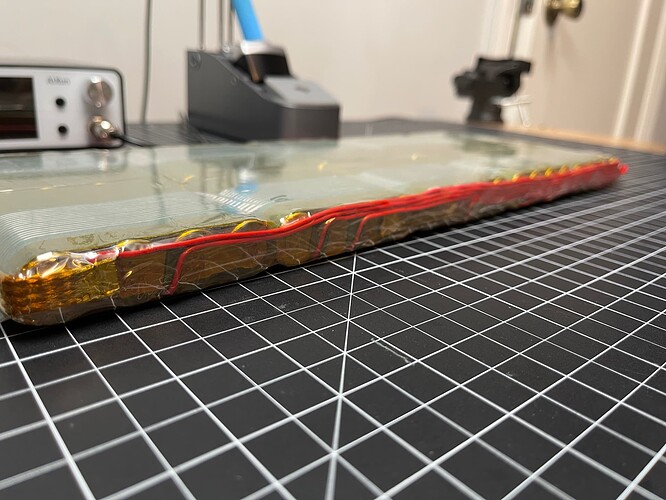

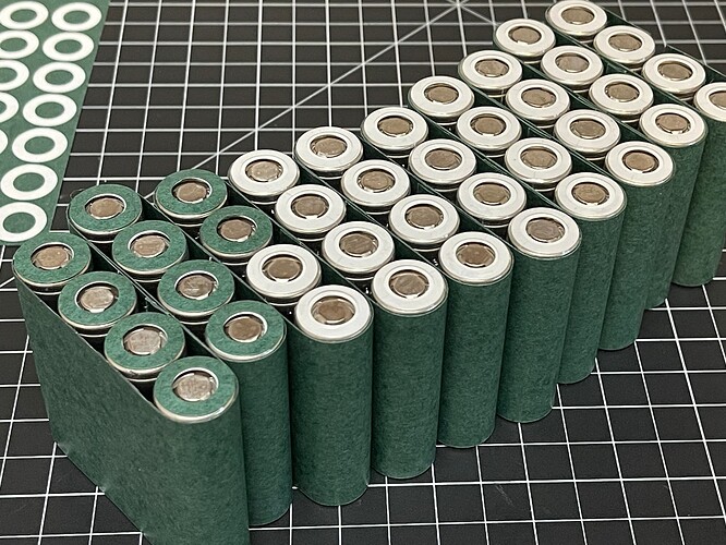

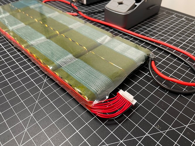

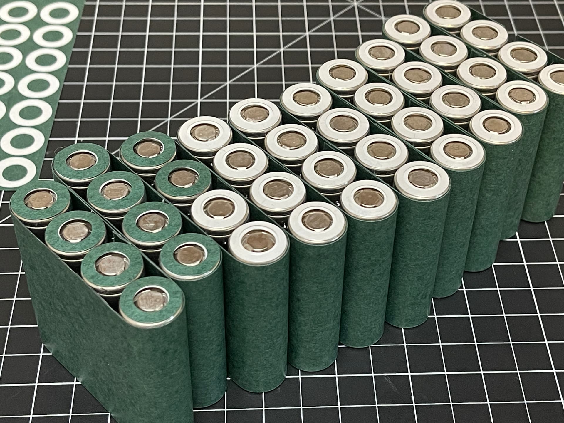

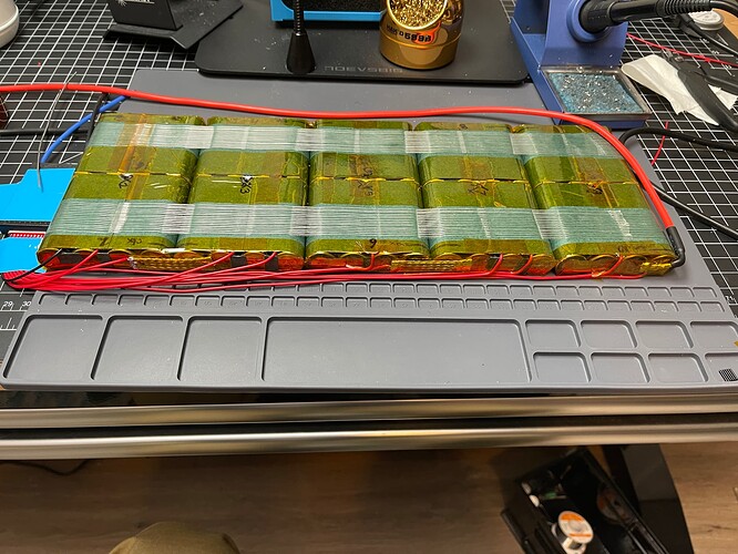

I tested all the cells. Tossed 7 that either had high ir, dents, and low voltage. Rewrapped the cells and used repackr.

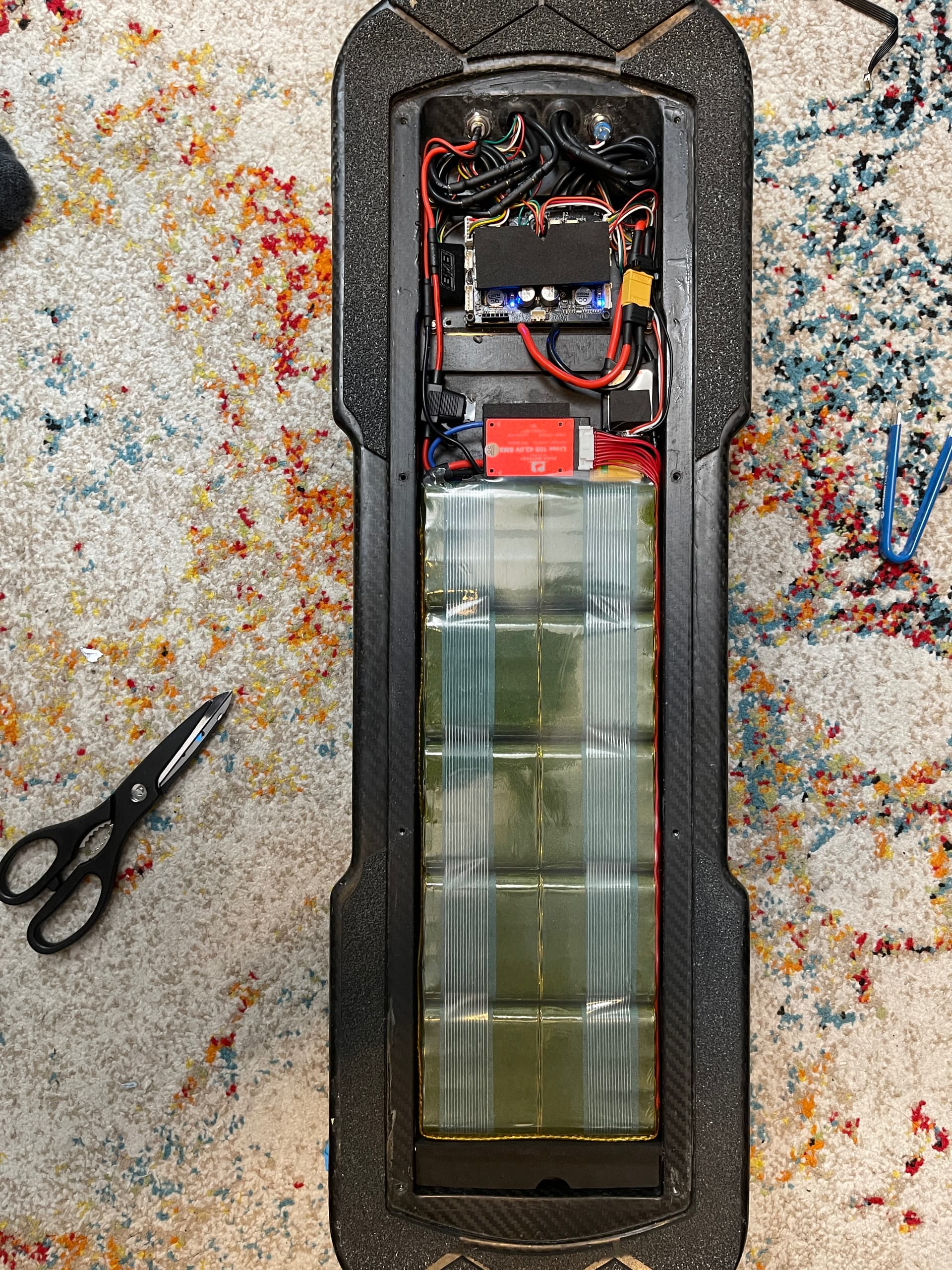

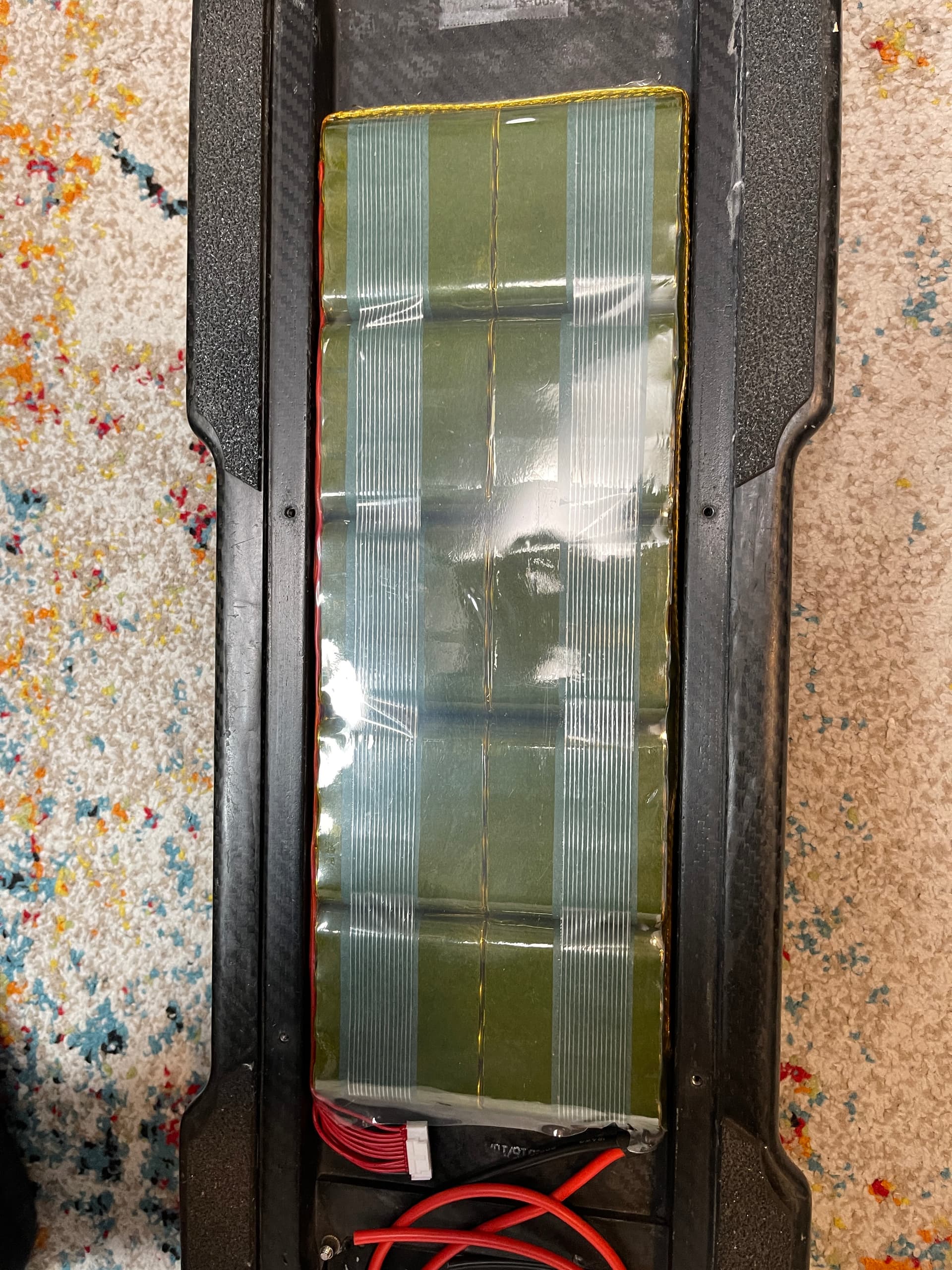

It was extremely challenging to make the pack slim enough to fit, but also really rewarding.

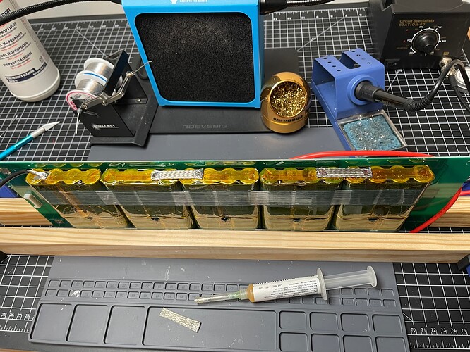

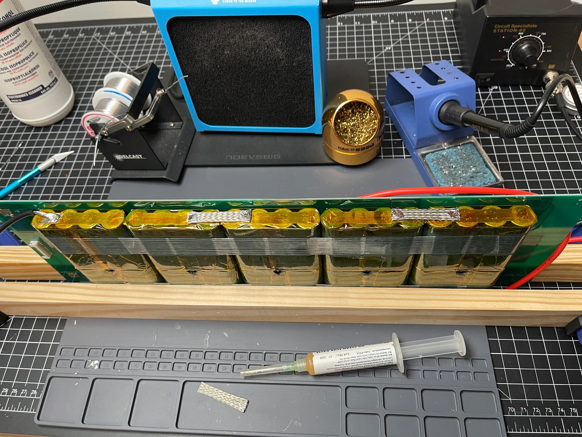

It was a little too tight with the 12awg wire so I used a long piece of braid instead which made it fit perfectly.
Finally upgraded my old soldering iron. I should’ve done this a while ago, it’s a game changer.

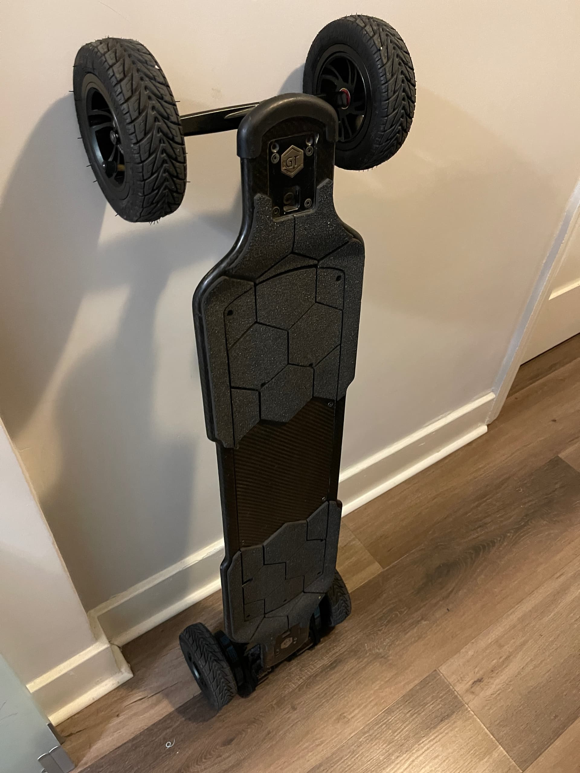

I just found a mint gt deck and trucks for 150.
I’ll be swapping them out as soon as they arrive.
