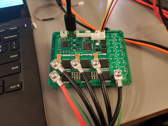

Highlights: anti-spark switch, drv8353 95v tolerant, ipt012n08 300a mos.
IO: adc1&2, canbus, uart, iic, ppm, USB-c.
Power ratings: 24-78v, 160a
Dimension: 71x89x24mm
On the photo, caps were not soldered. To do the test, I use green wires to connect external caps.

Could we get a video of spinning up a motor?
could you elaborate on the adjustable current filter?
When measuring the R and L of the motor, a switch will disconnect a cap in the RC low pass filter for more accurate measurement.

what you see here is my first prototype. I designed this for my electric scooter. Now I am just sharing what I did. I haven’t thought about selling it.

I did some tests.
IMU works
66v 70a foc_openloop load test and the waveform captured.
without haetsink, fets are getting hot quickly.

Without a heatsink I don’t imagine the gets to be able to put out a lot of heat. Have you tried just sticking even a small one to it?

what type of battery setup are you going to run with this.

A 50v 20a lab PSU and a 4s RC lipo battery pack. total is about 66v.
