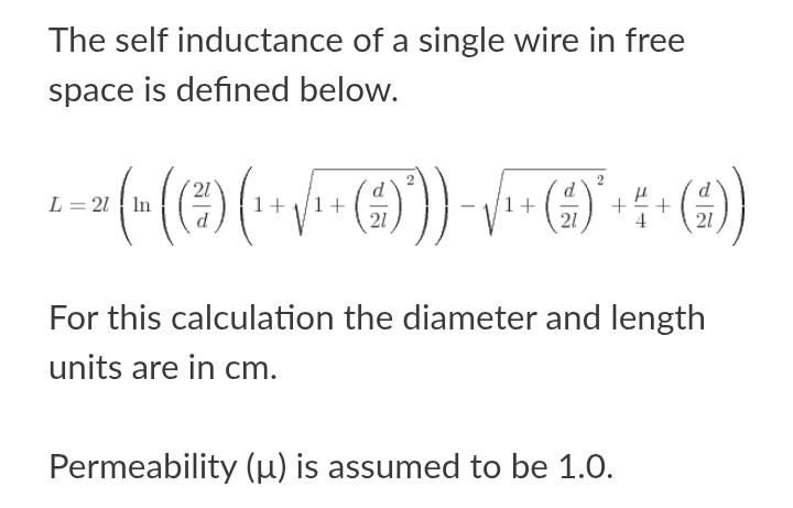

Adding more copper reduces resistance, not inductance. Inductance is determined by the amount of area between the two wires that are sending power. As in, if you imagine the two wires to be the perimeter of a shape. If you pull your positive and negative wires apart into a big rectangle or circle or whatever, it will massively increase the inductance. You reduce inductance by having shorter wire runs of course, but also keeping the wires as close together as possible and preferably twisted.
An extra long twisted pair of cables that have been coiled up in a storage loop, would probably have less inductance than if you ran your positive and negative wires across opposite sides of the enclosure, for example.

I thought I learned (many moons ago, so I could be wrong) the inductance equation and it had wire length in numerator and radius in denominator. Maybe that’s just for single wire inductance and not the effect between the two
Sounds like it, yeah. The inductance of a single wire is small compared to the interaction effect, so you can ignore the single wire stuff
You also may have been looking at magnetic field strength, which decreases with distance (usually labelled as r). The inductance formula apparently looks like this
