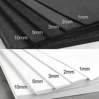

Normally i wrap my batteries in EVA foam sheets and then add a layer of EVA foam to by enclosure and deck. it can be found in the link below
EVA foam can be found almost anywhere. Another common source for it is foam floor pads for garages.

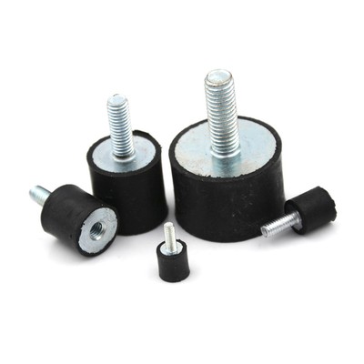

My favorite method for mountainboards is to use “rubber isolation mounts”
you have 2 screws going into a soft block of rubber that allows your top mounted battery or esc case to move several millimeters and resist the violent shaking of hard offloading. A link to the generic commonly found version is below

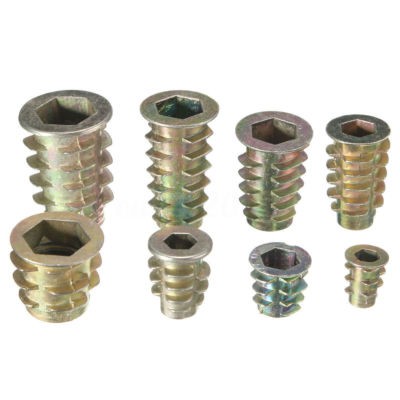

These works great for vibrations and are highly customizable. they can be mounted on existing enclosure holes by using all-thread instead of a screw of the end that goes into your threaded inserts. for example, these will work:
(ordinary m4 inserts)
