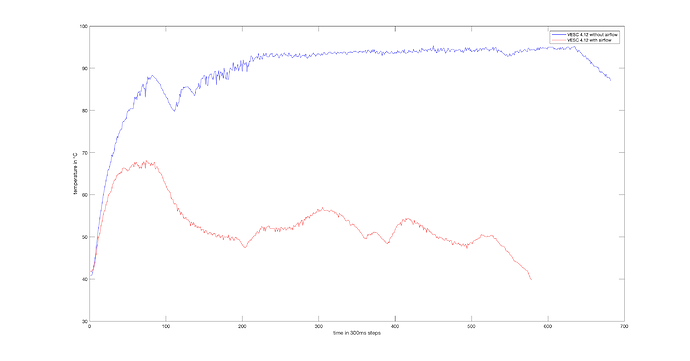

I have done a comparison how airflow is affecting the temperature rise of the VESC 4.12 hardware. You can watch the video here:

To give you an more detailed insight of my setup: The VESC itself is self soldered with a self build heatsink on top of the MOSFETs. I was aware, that the heat transfer between the D2Pak plastic housing and the aluminum heatsink wouldn’t be great but I did it anyways and also put thermal paste between them. The settings were at 50A max battery current and 120A max motor current. The MOSFET temperature limit start was set to 80°C and the end to 100°C.
I was running the test on my eBike with a MXUS 3000 v3 motor and 10000mAh Multistar 11s battery. I compared the temperatures when the VESC was inside my bike bag (so no airflow at all) and with the VESC + heatsink was hanging out of the bag.

I have also created two graphs of the two runs where you can see the different temperature rise better.
As you can see without air cooling I was hitting the temperature limit at the end.
You can see in that graph how the temperature of the uncooled VESC stays in the “temperature limit zone”. Because of that limit I reached the same location a lot later, while the cooled one stays under 70°C the whole time.
So lets summarize what I have learned from the test. It is very important to use the airflow when it is possible for you to mount the VESC where the air is flowing. When mounted correctly the VESC 4.12 hardware is able to take a lot of current without getting to hot. I was aware that the airflow has a big influence to the temperature development, but not as big as seen in the graphs. Impressive. A lot of builds of electric skateboards I have seen dont use the airflow from driving at all. When not hitting the temperature limit thats ok, but if you need more power you know what to do.
