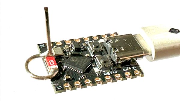

Salvation for bad RF:
And:
I bought one of these and the wireless reception is quite bad
