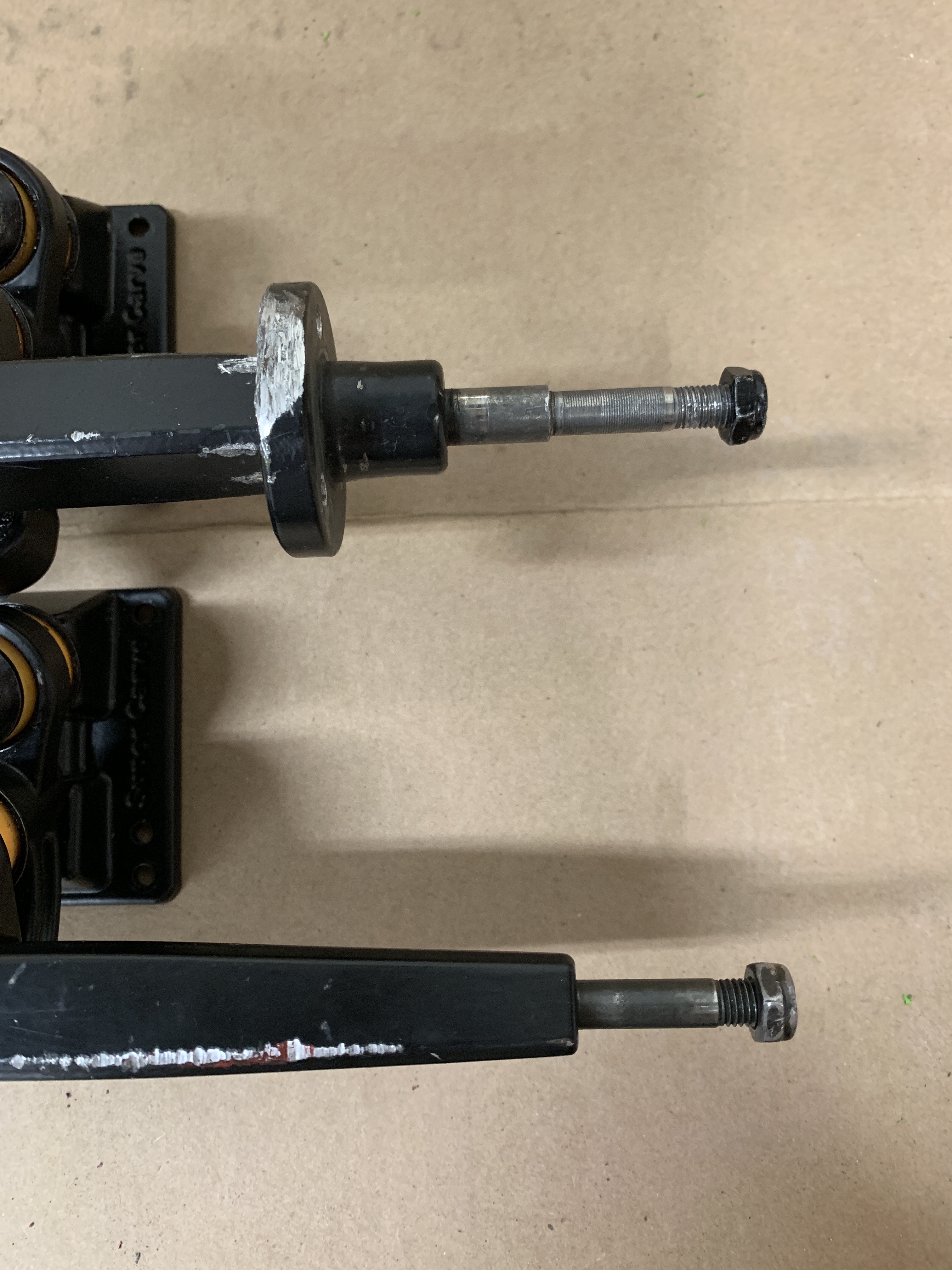

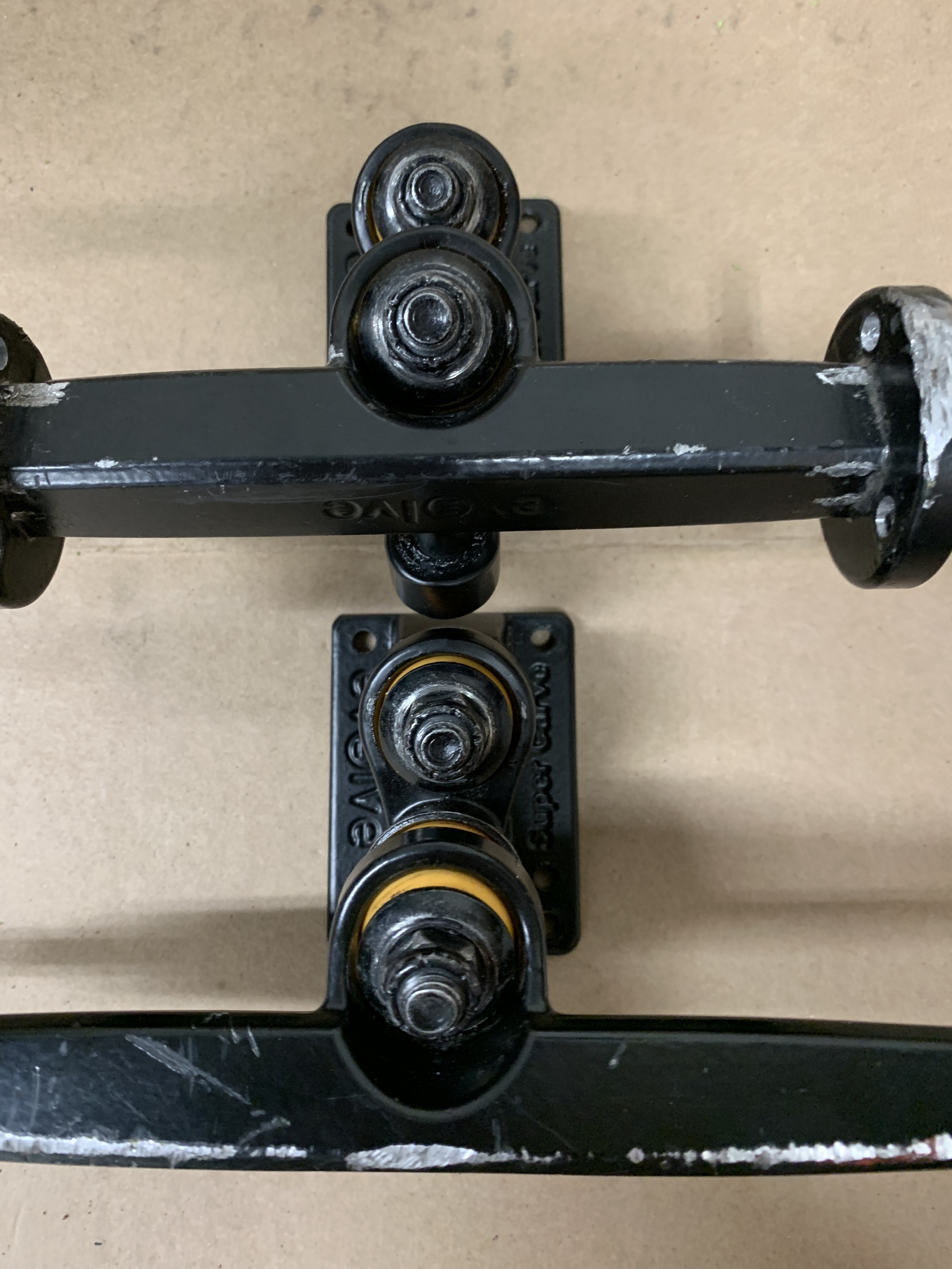

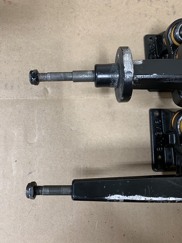

From what I can tell, these are $140 plus shipping on evolve’s site.

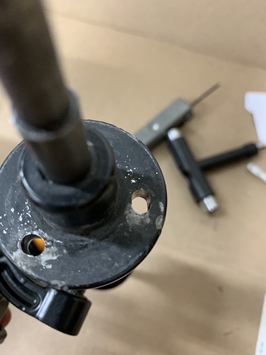

Asking $100 shipped in the US. The motor holes have been elongated slight to have adjustable angle.
Never tried those. Sending pm.
Are those bushings similar to caliber bushings or you have to buy from evolve?
