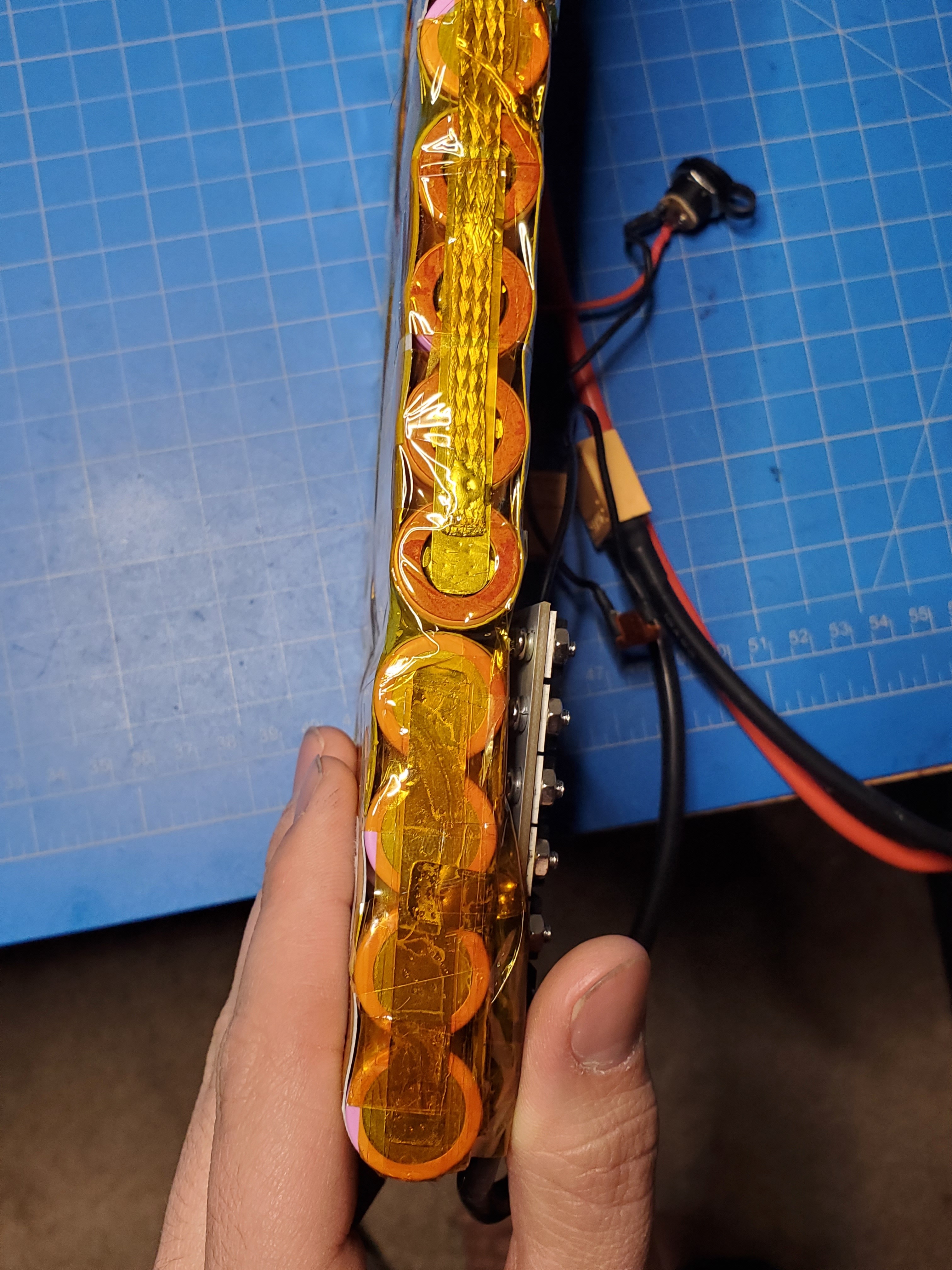

I want to ride again. I’m back at it, but I unfortunately forgot most of the information I binged over the 3-6 months that I read up on at the time. I’m trying to refamiliarize myself, but it’s a bit overwhelming. Learned the Unity, which I got in one of the first batches, is now defunct along with Enertion. I apparently fried it. So I got another VESC. I’m terrified of frying this one too, so I’m trying to be careful. I believe one of my issues is with the battery, more specifically my bms. I think.
Here’s where I’m at. With the Unity, I could power it up, but I couldn’t do anything. I couldn’t connect to the Unity via bluetooth or plugging it directly in. That’s when I found that it was most likely fried. So I’m getting that checked on, I got a new VESC because I’m impatient. It won’t turn on for longer than a second. So I take out my battery and check the voltages. Boy, the readings don’t make sense to me. Like I said, I think what I gather is the bms must have goofed? I know when I assembled it, I tripled checked that everything was good and even. Maybe I’m not measuring correctly, but I measured the voltage on the bms like this;

If 27v is total pack voltage, a balanced pack would have each group @ 2.7v. From that I can assume your pack is unbalanced. Your bms could very well be faulting due to low voltage and not allowing current to the ESC.
I’d start @ the battery and go from there. Either get the pack balanced or get a new battery. Theres a few battery builders here that could assist with balancing if you’re unable to yourself.

It’s 10S4P 30Q battery pack. I built it, didn’t really even go through more than a couple of charge cycles? before it broke. It would just be easier to say my friend is cursed and my board hates him, but most likely a fault on my end during my build.
Do you have pics of the battery construction?
With it working for a few cycles and then not, and seeing your groups voltages, I can assume the groups weren’t balanced upon building the battery or the bms went to shit on balancing and let them drift. Either way, the battery should be the first thing you look @. Once you resolve your battery issue (which I do believe is your overall issue), ESC will get power.
If you’re not that savvy, I’d say get it to a builder and let them assess it. Could be as easy as balance and done. Or it could be that those cells are just gone and a whole new pack is needed.
This is an issue. If this is a 10S battery there should be 10 numbers. The first step is getting all these CAREFULLY without shorting anything out.

Alright. I got the battery working again. Turns out the tabs for where the wires for B1 and B10 were loose. Attempted to spot weld them back but I never fully fleshed out my spot welding skills or have my settings tweaked. Instead of bothering with that right now, I just soldered them. I know it’s really not ideal for the battery but I just didn’t want to mess around.

Those weld do look a little weak. What welder are you using?
They are definitely subpar, but I think they will hold for now. With the series being reinforced with braids, lots of tape, and being heat shrunk. It should hold enough for some preliminary rides. I have a boss spot welder, iirc. The homemade Korean one?
