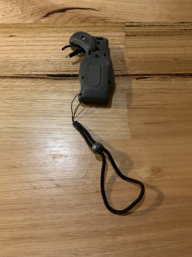

Also did this minor mod last night while tinkering with and surface cleaning my board. I’ll be building over the next week or so because it’s going to be miserable down here in wintery, rainy Melbourne. Plus, I’m not at Level 20 Mage waterproofing like @b264 yet.
