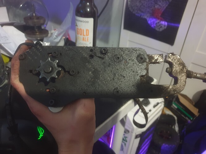

Ok so it is no secret that i have broken alot of different parts, i use my boards hard and in every condition and do near daily maintenance to keep em running good
i managed too torque this
@Trampa urban mount in half, not from the screw being too tight, but acceleration torque. so

if it ain’t broken you aren’t riding it hard enough and if it is broken either your maintenance sucks or the part is weak, i like to make sure it’s not poor maintenance causing the issue
so she is very ugly, but is a temporary fix until i get some new gear drives in, it’s made from 12mm steel so if it’s breaking i have bigger issues on my hands.
Onto the third scrub truck adapter, first one was 3mm 316 stainless and ripped in half, second was 3mm 7075 aluminum also ripped but lasted about 1200miles. And the third is made from 3mm 316 stainless again but is a place holder until i get some new ones from
