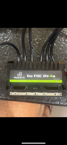

Alright so all I gotta do is switch the RX and TX cables, hopefully that does it. So it’s more of a mix up on the design part or other vendors remotes aren’t compatible till after tinkering with it? Also I noticed both sides are the same, it is my first time ever setting up a dual so does it matter which side goes where or it doesn’t, I have my receiver on the far left and my Bluetooth module on the right closest to the switch

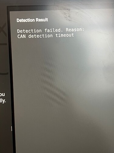

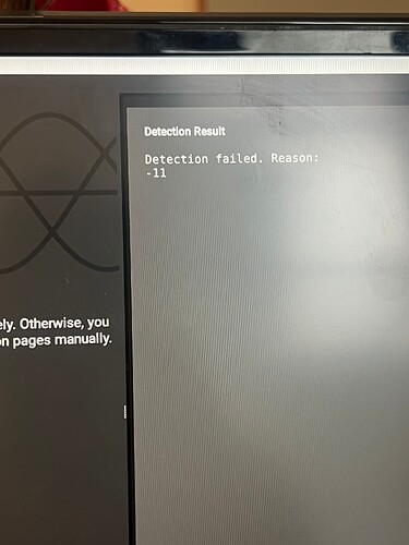

I’m having this problem with my DV4S when configuring the motors; during the verification process, only one motor spins, and then this message appears in the VESC. It’s running version 5.03.

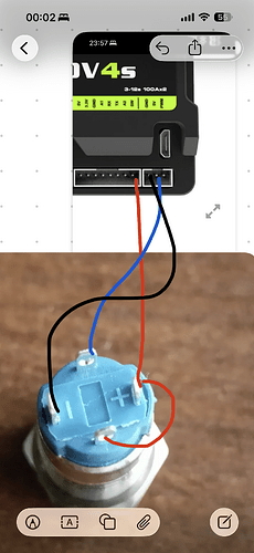

@everyone, does anyone have any tips for me? I only managed to get the power button to work on the 8-pin connector, but I actually wanted to make it work on the 3-pin connector. Does anyone have any suggestions? I used 5V, GND, and SW on the 8-pin port, but I wanted to use the 3-pin connector on my DV5s with GND, 5V, and PWM.
the sw pin (switch) is only on the 8 pin connector.
the three pin connector says PWM meaning it’s the throttle input (ServoControl/PWM/PPM)

Please can you share wiring diagram. Or take a foto
Quick google search brings up all the results you need showing all the ports and labels
i have it on my hands, but i saw somebody put switch button to 3pin connector (GND/5v/PWM)
Or I will put one wire right into 8pin socket(pic)
