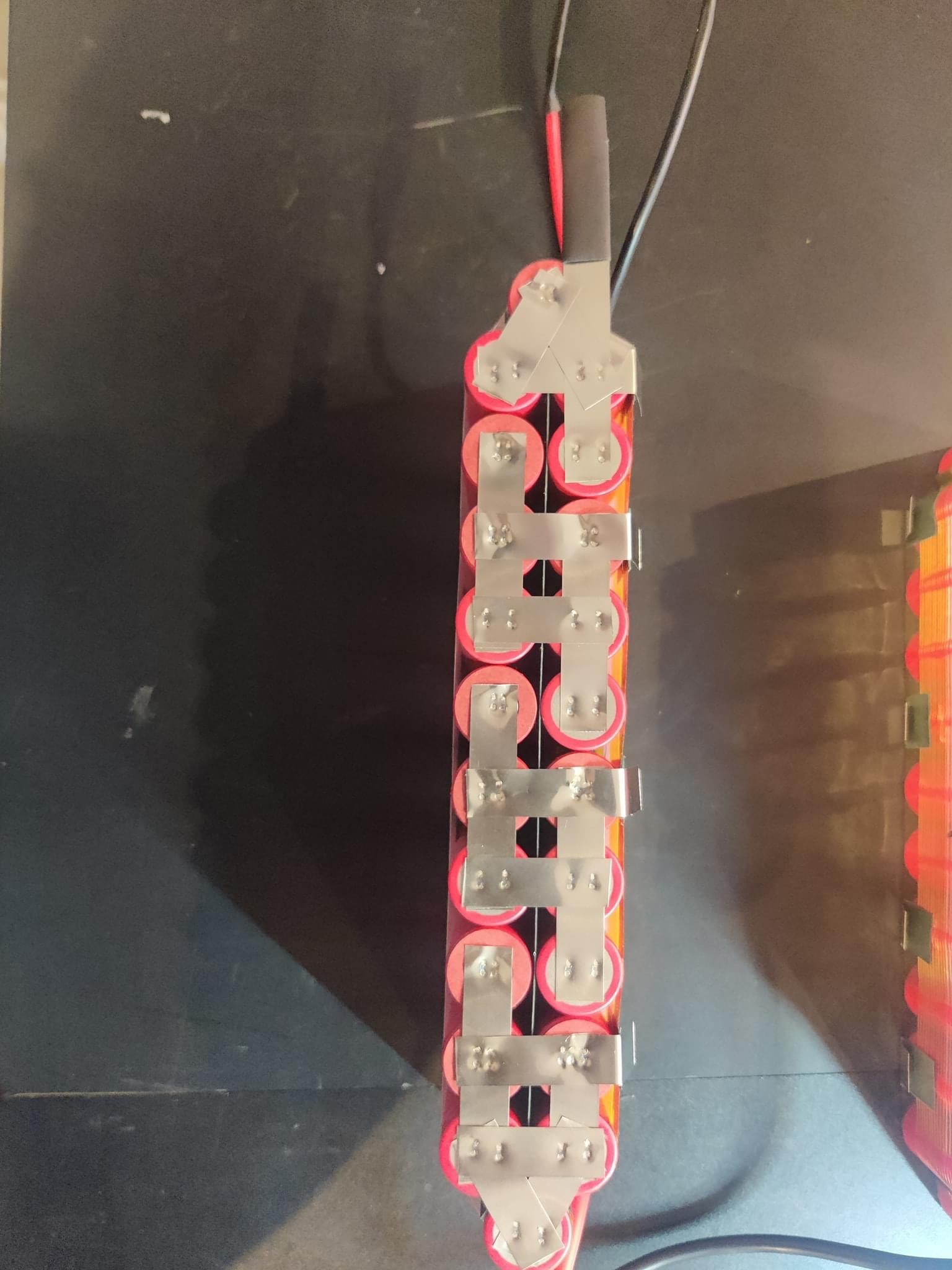

6S6P completed, now to finish the other side for my 12s6p battery. :sweat_smile:

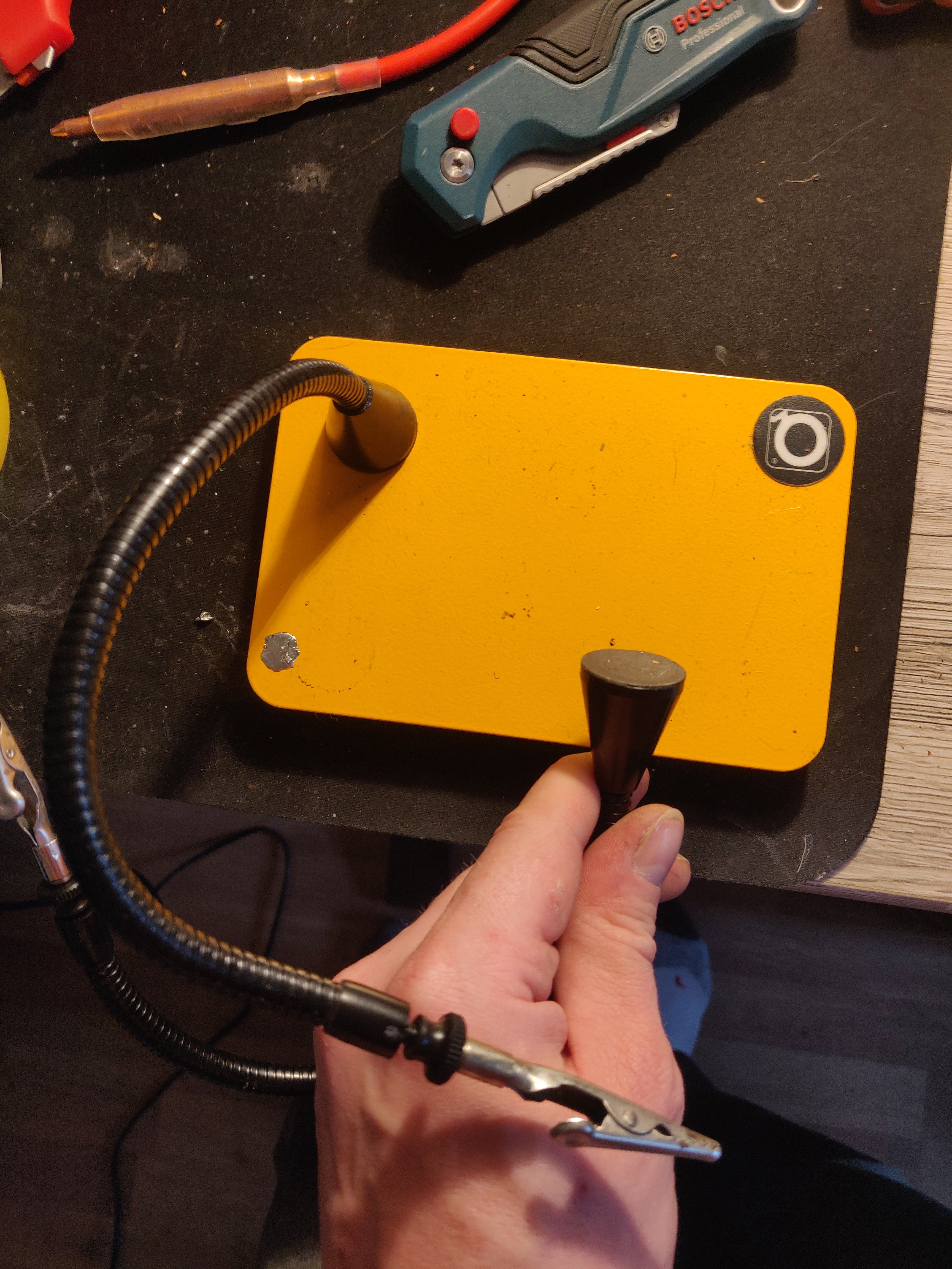

I made my own - You can get that blue/orange hose on Amazon (search loc-line or flexible coolant hose), and tap yourself some holes into a hunk of whatever to seat them in. I got some 4mm banana plugs with threaded ends that mate up nicely with croc clips, and threaded them into the ends of the hose nozzles.
The only thing I’d do differently is make the base wider/longer/heavier so it has less tendency to slide around or tip.
Yeah… checked aliexpress and it’s full of these things. I indulged myself with two sets of hands, after so much time with the shitty version.
“QuadHands” are pretty good, but pricey
Comes with a magnetic “hands”

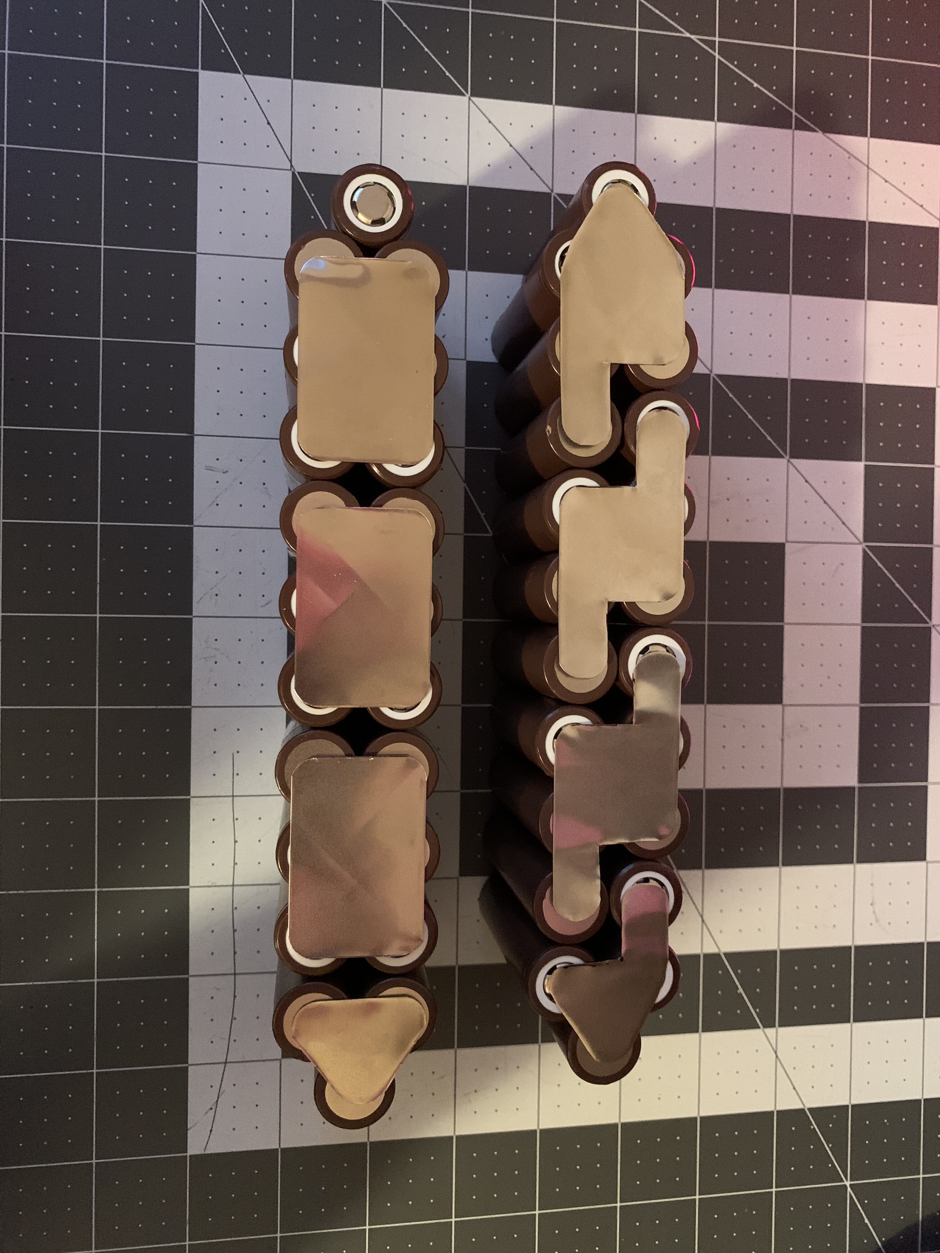

Doing some nickel shape testing, I’m working on designing a “proper” XR battery upgrade. I have an XR battery box coming next week.
JW:
Me:
Might make a few XR packs for some OW riders I know. I want make Chi and JW jealous :grin:

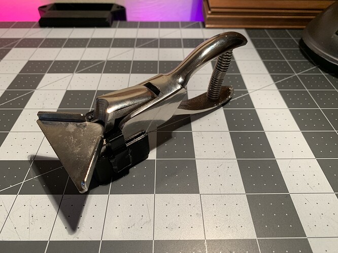

Soooo much better than the chomper! Thanks for the recommendation. I even made a little basket for the corners.
