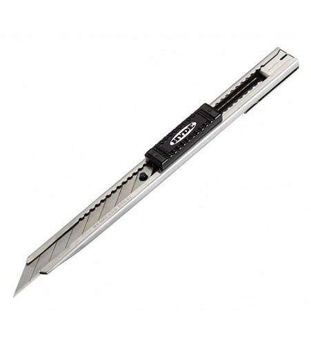

I use a box cutter/utility knife/snap knife (people call it different things) to hold down my solder joints while they cool. Works a treat. The super thin blade allows me to apply exactly the right amount of pressure exactly where I need it, so I can hold the wire in place without smushing it flat or sinking so much heat that I get a cold joint.

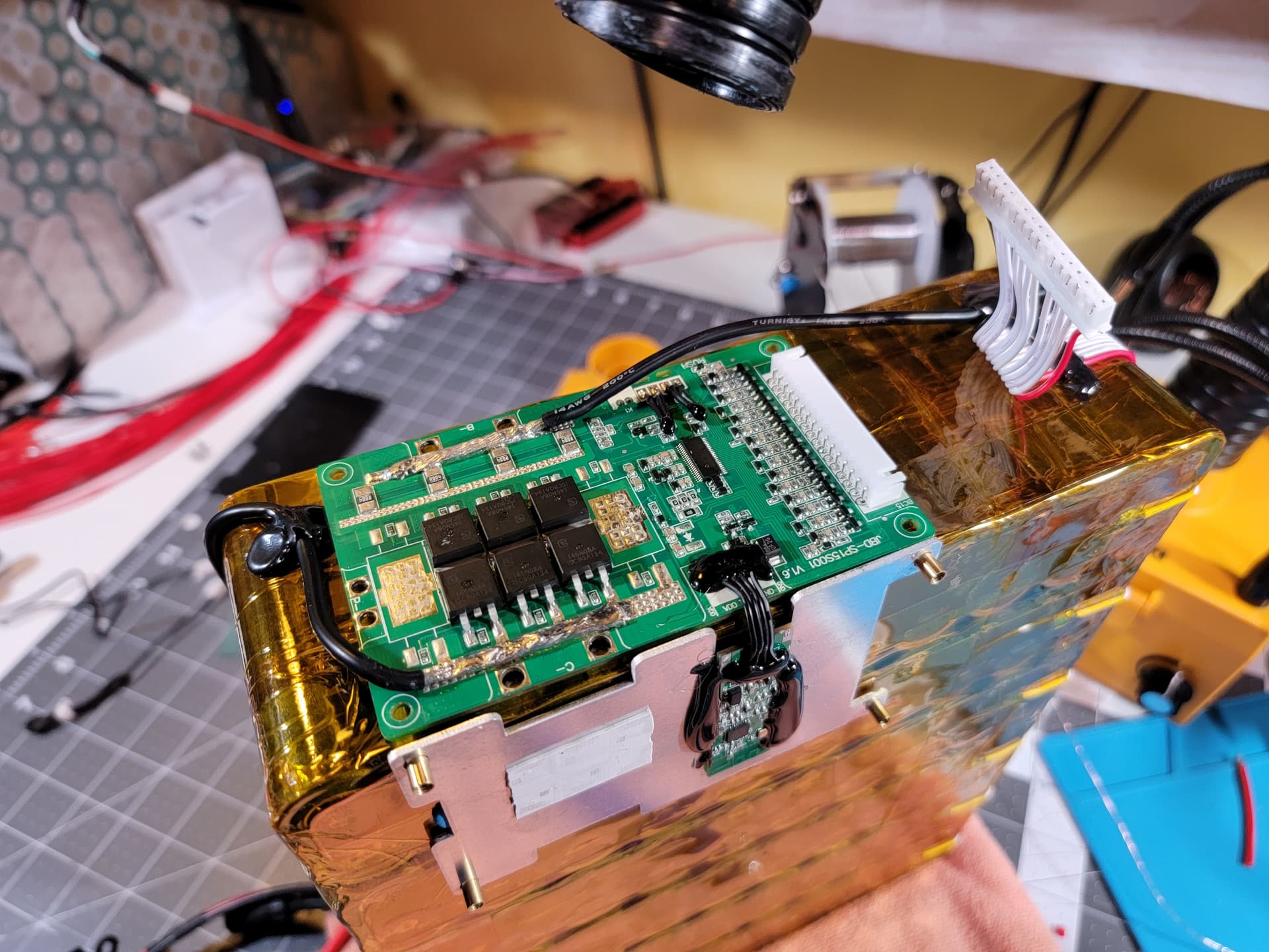

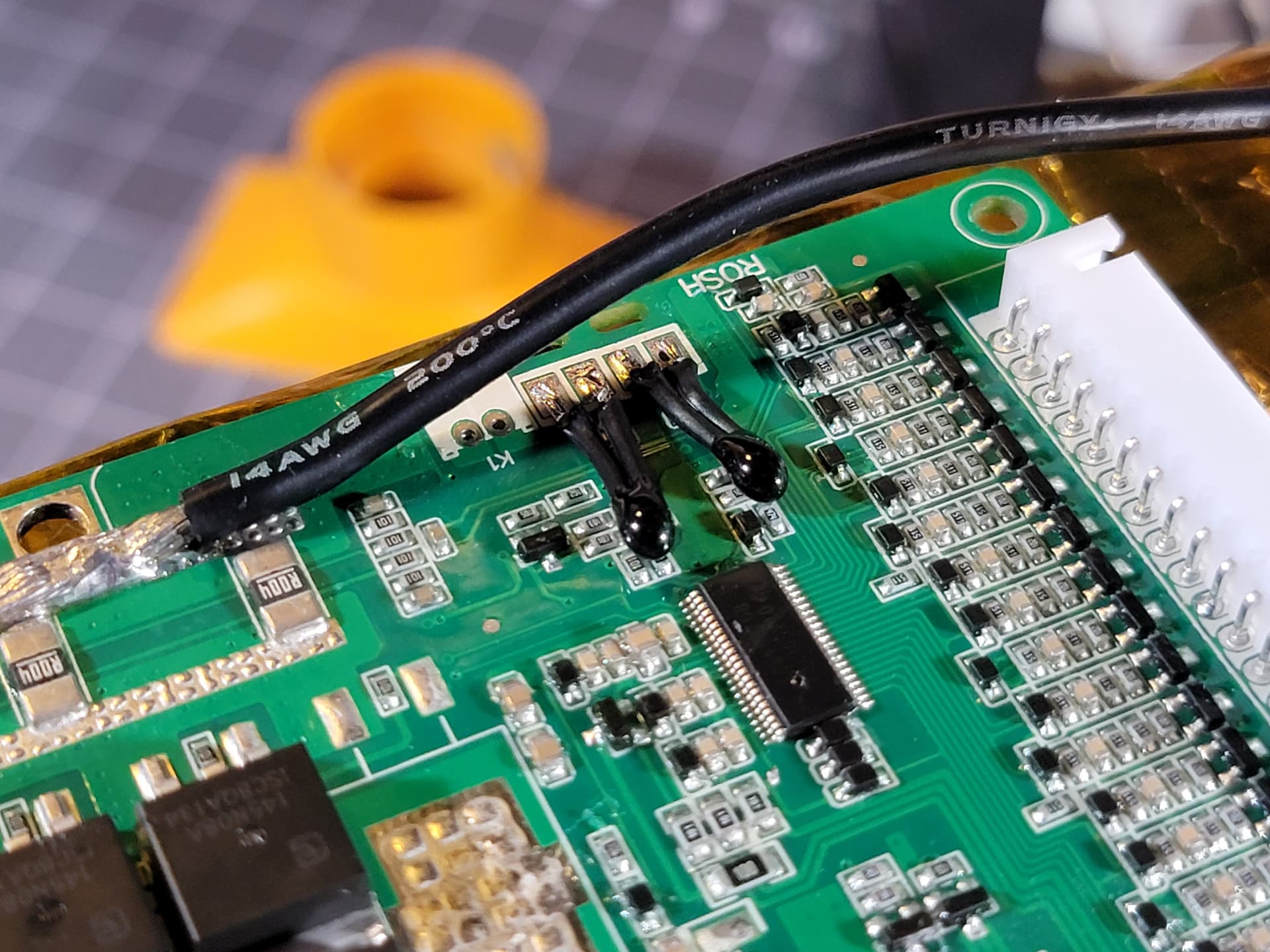

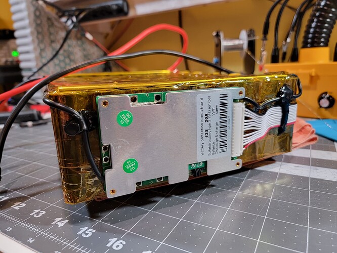

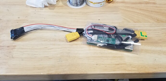

Modular BMS ftw. I did a thing:
I leave this strapped to my charger to charge my two different 12S NESE packs.

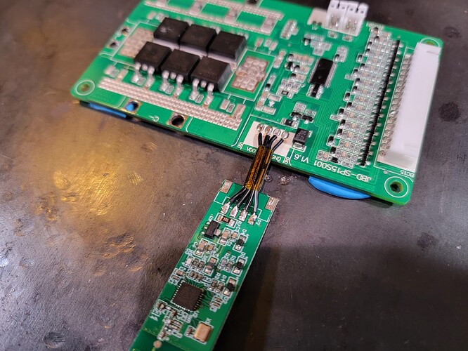

Question-
Anyone know if the capacity setting in the LLT BMS app does anything other than display % remaining?
Afaik, that’s the only setting I’d change between my 12s2p and 12s3p packs, and it would be great to not have to change anything at all to charge
The capacity setting doesn’t do jack in that BMS lol
Depends on whether you are using the iOS app or the Android app.
Android app:
Capacity meter is counting the mAh charged and discharged through the BMS, and comparing that to the capacity of the battery that you tell it. If you are not discharging through the BMS, then this number is going to quickly rise to 100% and stay there forever, since no mAh are going “out” of the pack (as far as the BMS can tell).
iOS app:
You can define several points of a discharge curve based on measured voltage, and it will use that to determine what % it displays. Much simpler, a bit less accurate, but it functions whether you bypass the BMS or not, since it’s based on pack voltage.
I don’t know man, I’ve never gotten it to function

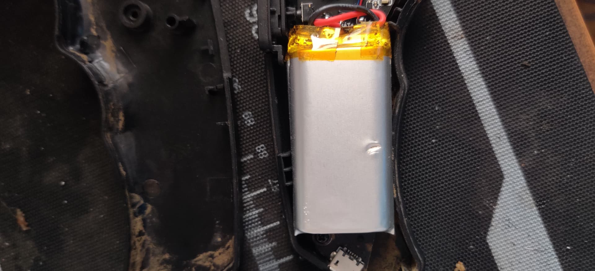

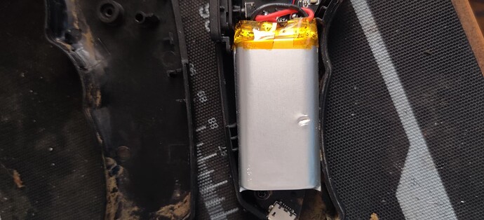

Just opened up a VX2 to clean it and because I like taking things apart, and noticed this divet in the battery, seems to be caused by a sharp plastic nub on the other side of the case that looks like a manufacturing artifact from injection molding.
Beware, this could have punctured the battery making the remote a fireball in your hand or pocket.
Check your remotes for this kind of thing, kind or crazy this can even be sold legally.
you’d be surprised how many things in esk8 are sold and are dangerous
after the injuries I’ve sustained over the passed 3.5 years and the things I’ve opened up I’m not really surprised anymore, I’m moving towards just disappointment.
