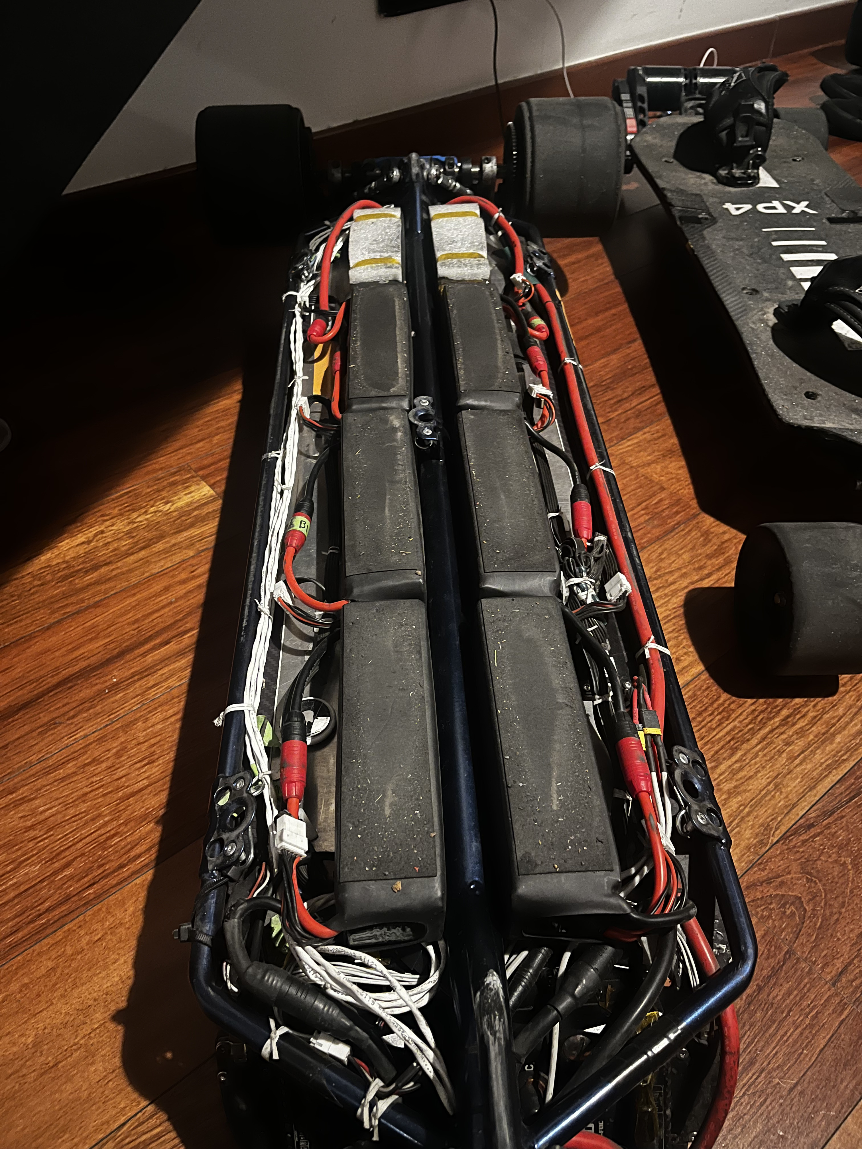

Packing For Prague (Batteries)

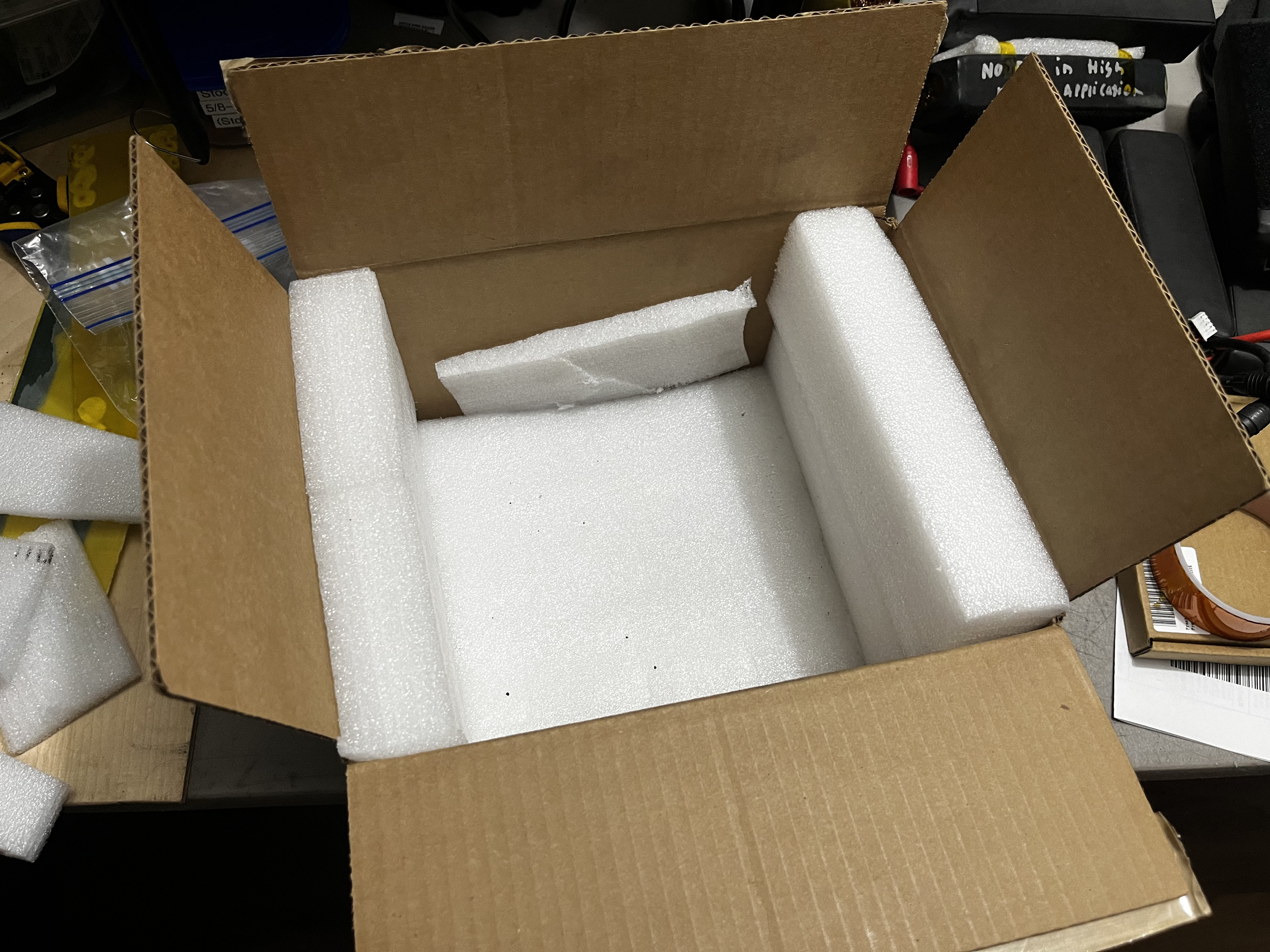

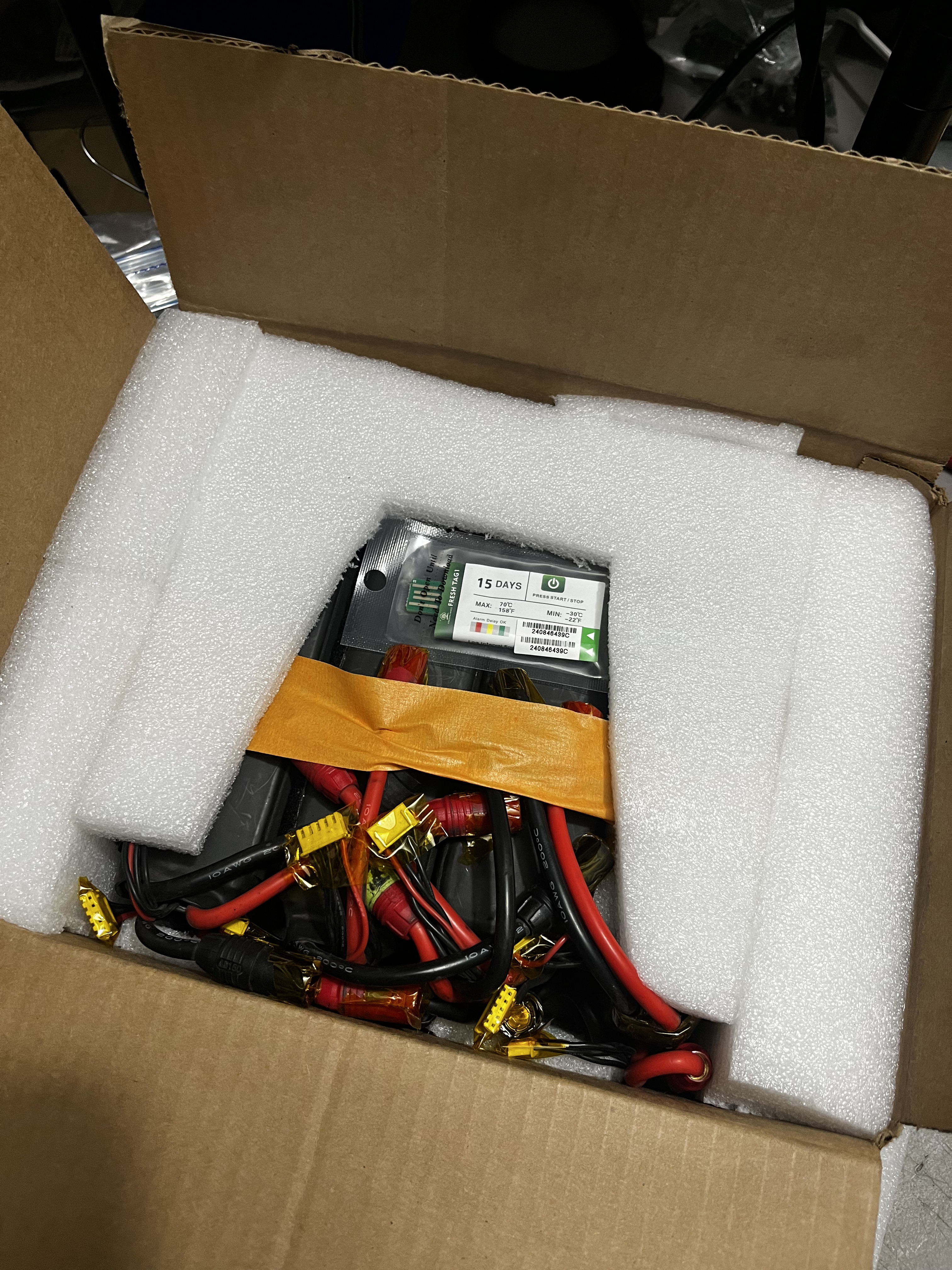

I shipped my batteries via fedex.
For the batteries, I made a box for them with foam on all sides, reusing the foam that my EUC came packaged in. Can’t be too cautious!
All connectors got Kapton tape. Also threw in this temperature logger (more on that later)

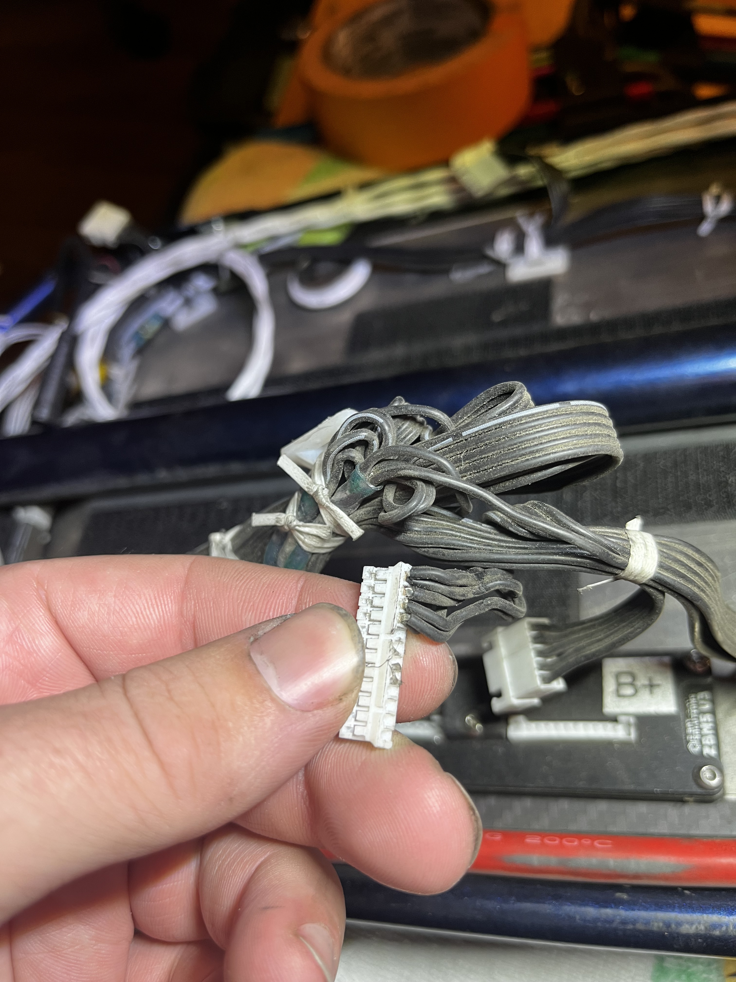

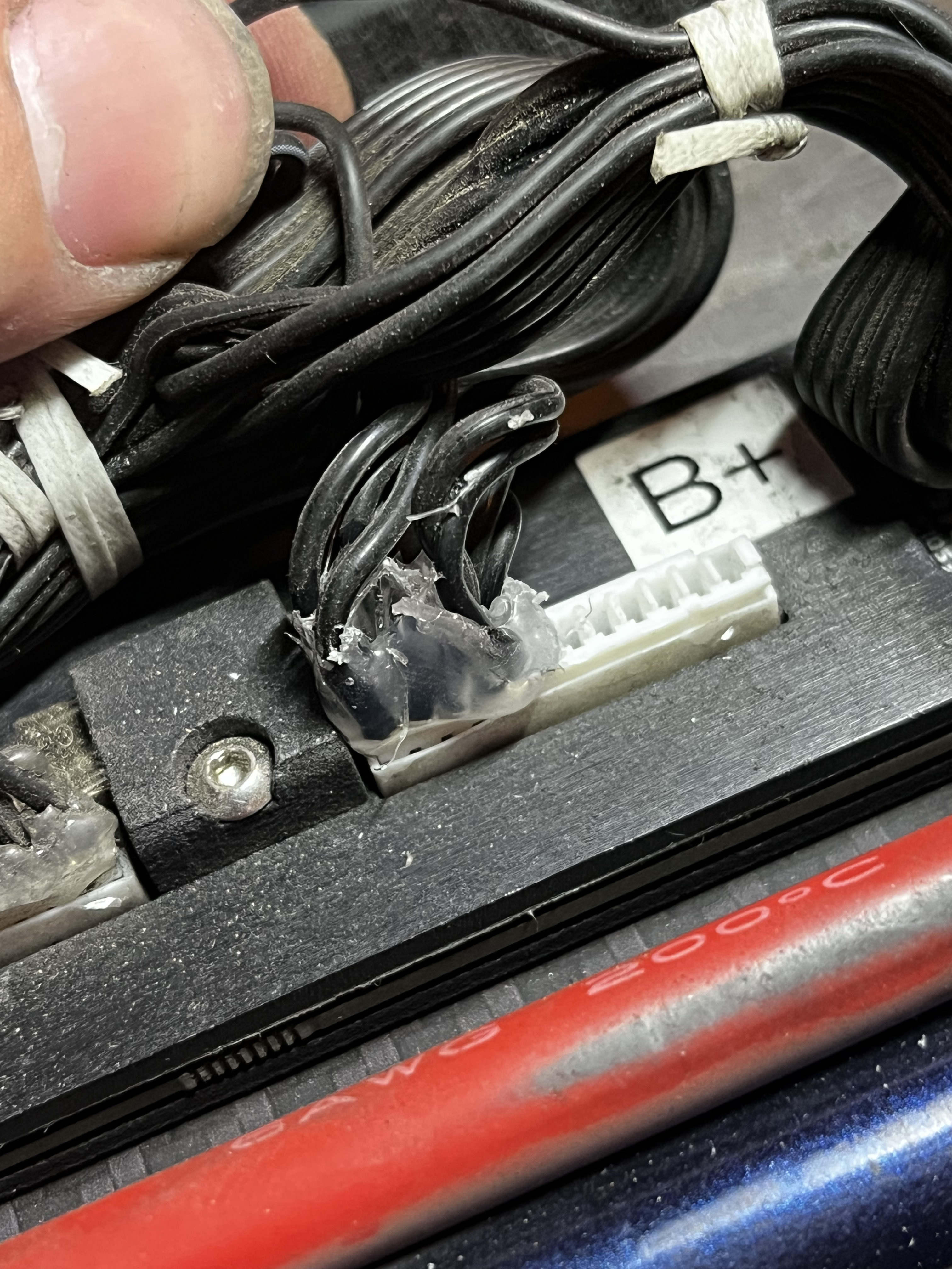

While doing this I notice that the insulation on my BMS connector had started peeling back. Not great
Cut and re-terminated them :slight_smile:

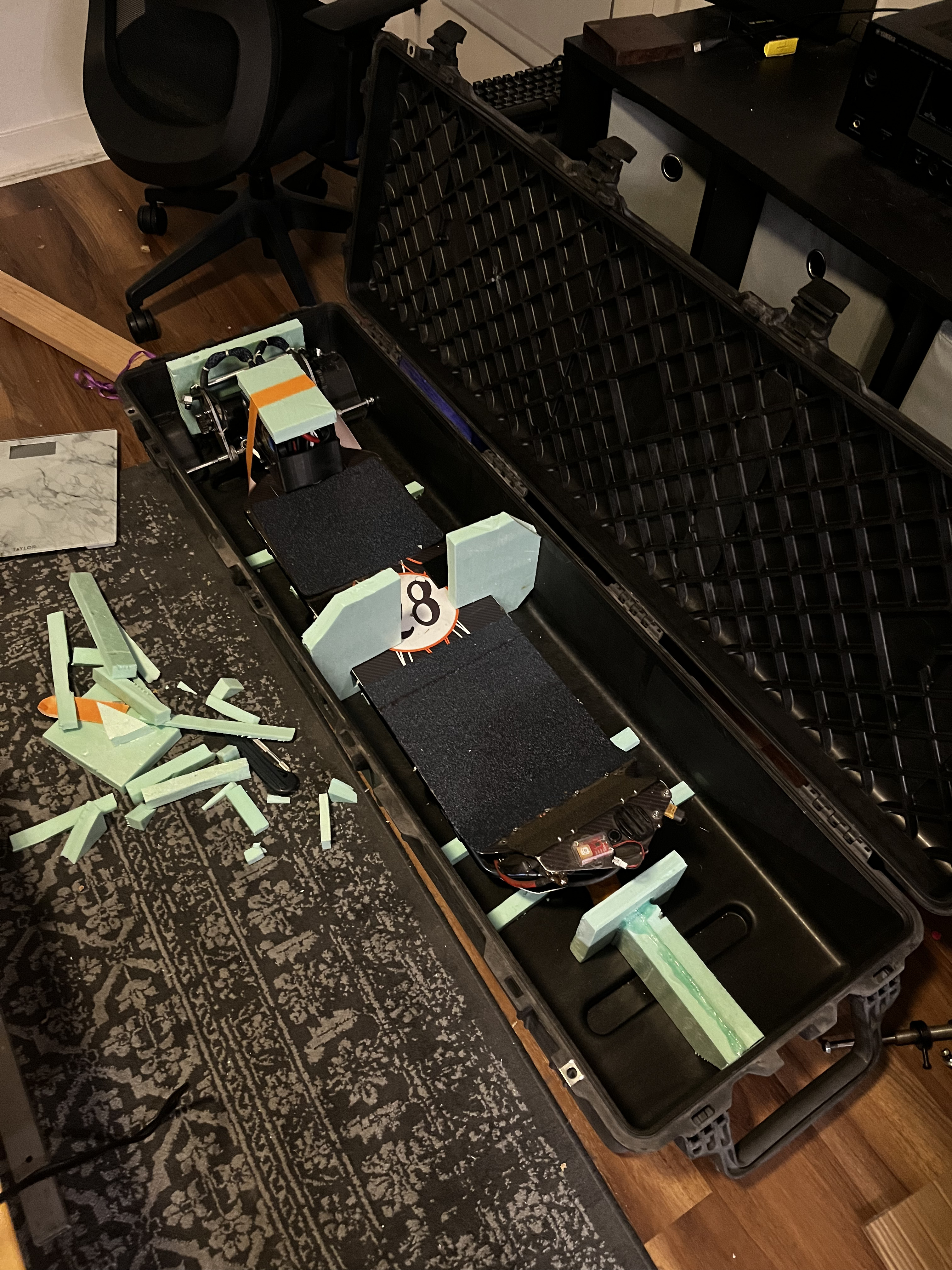

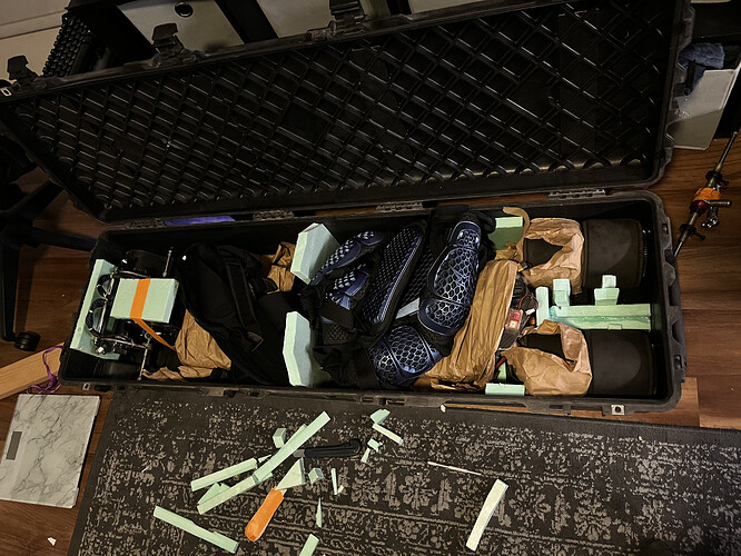

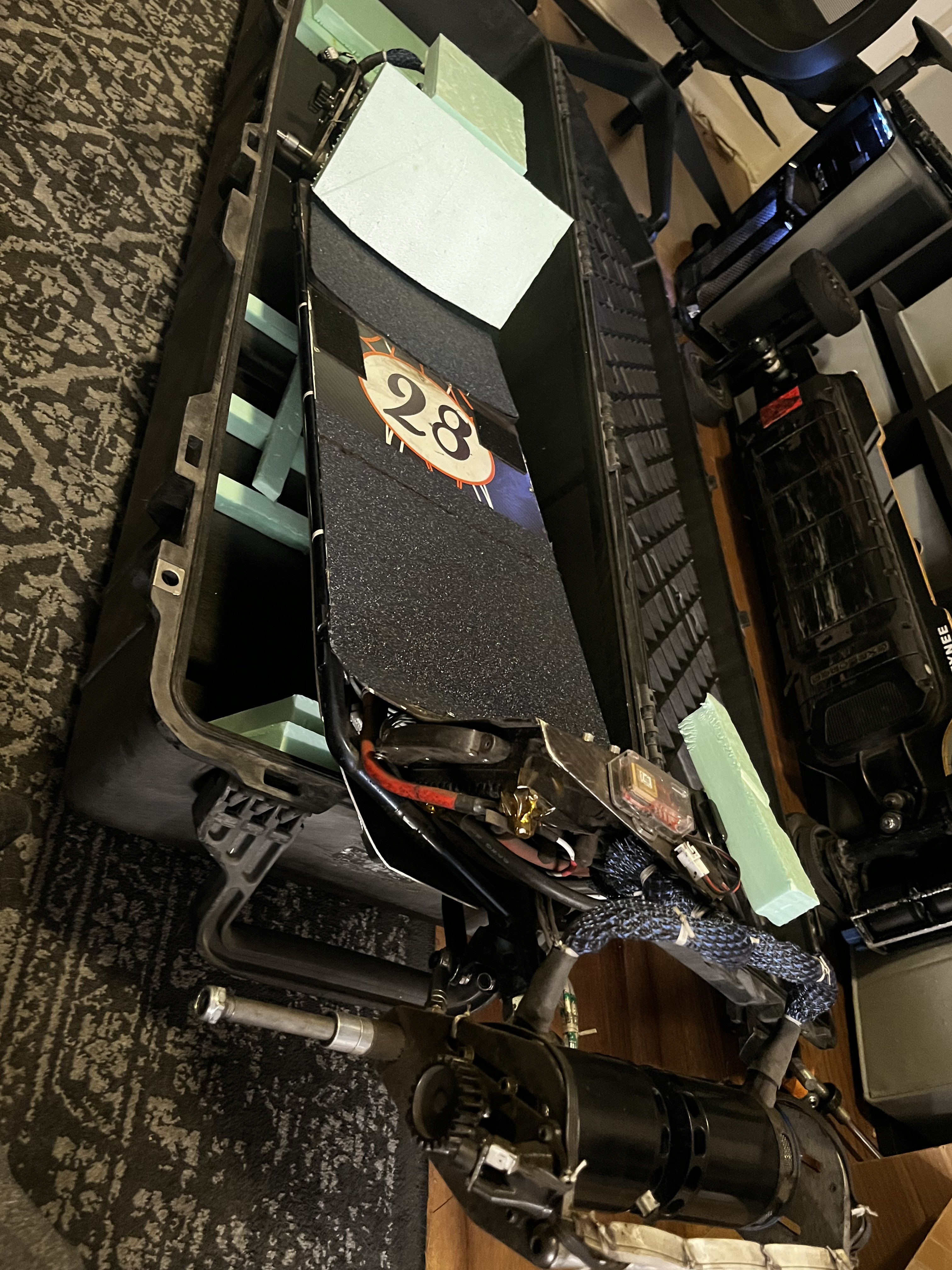

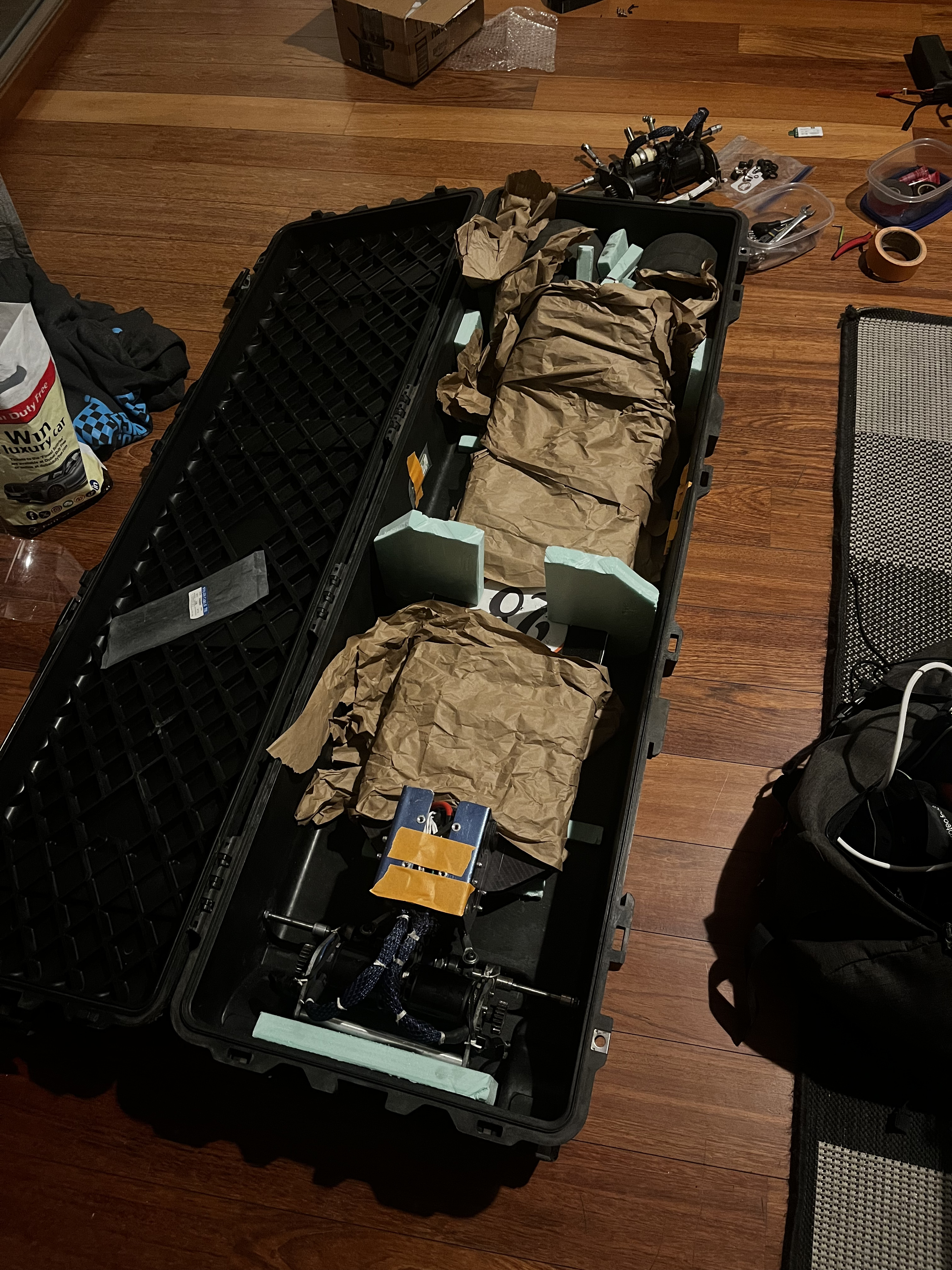

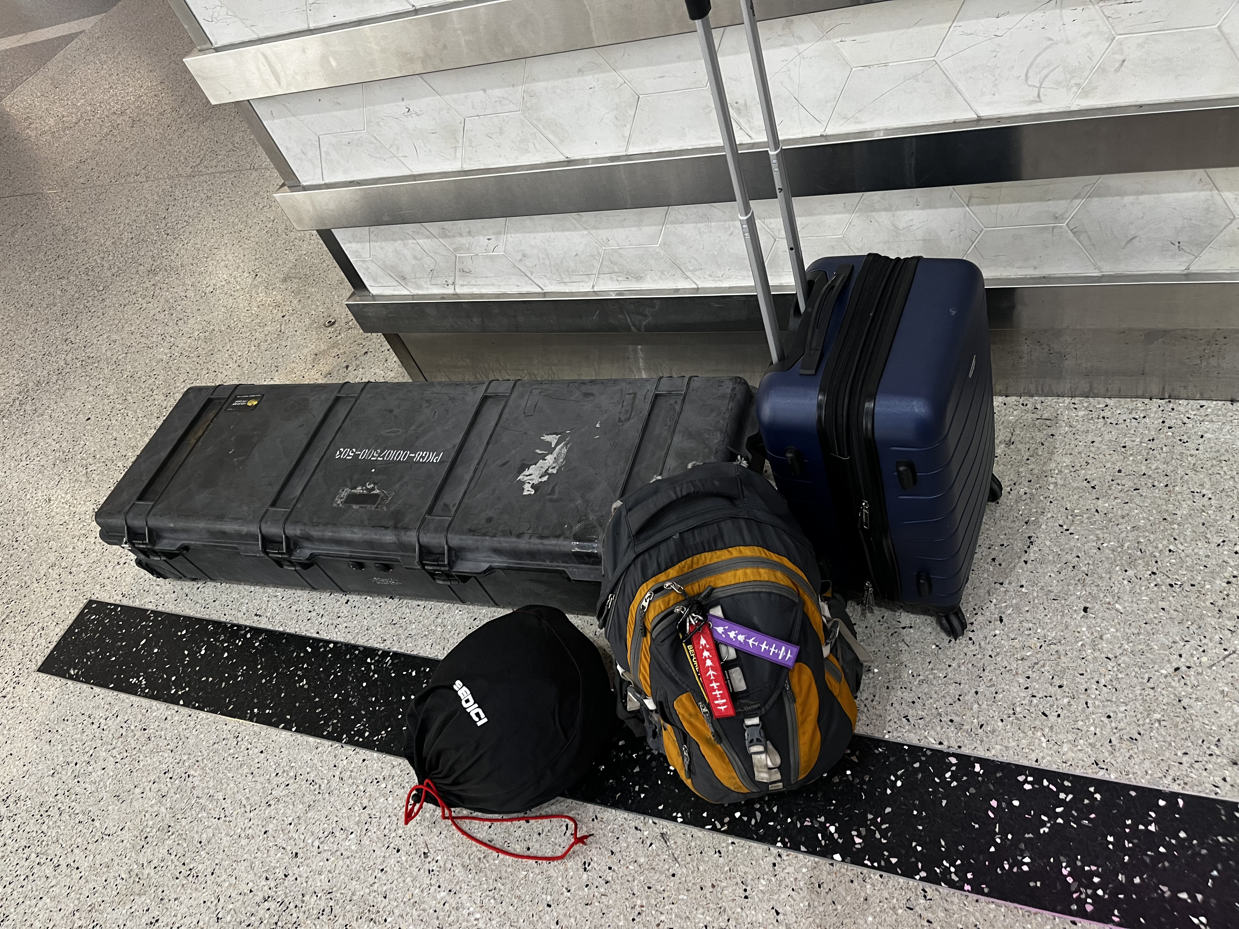

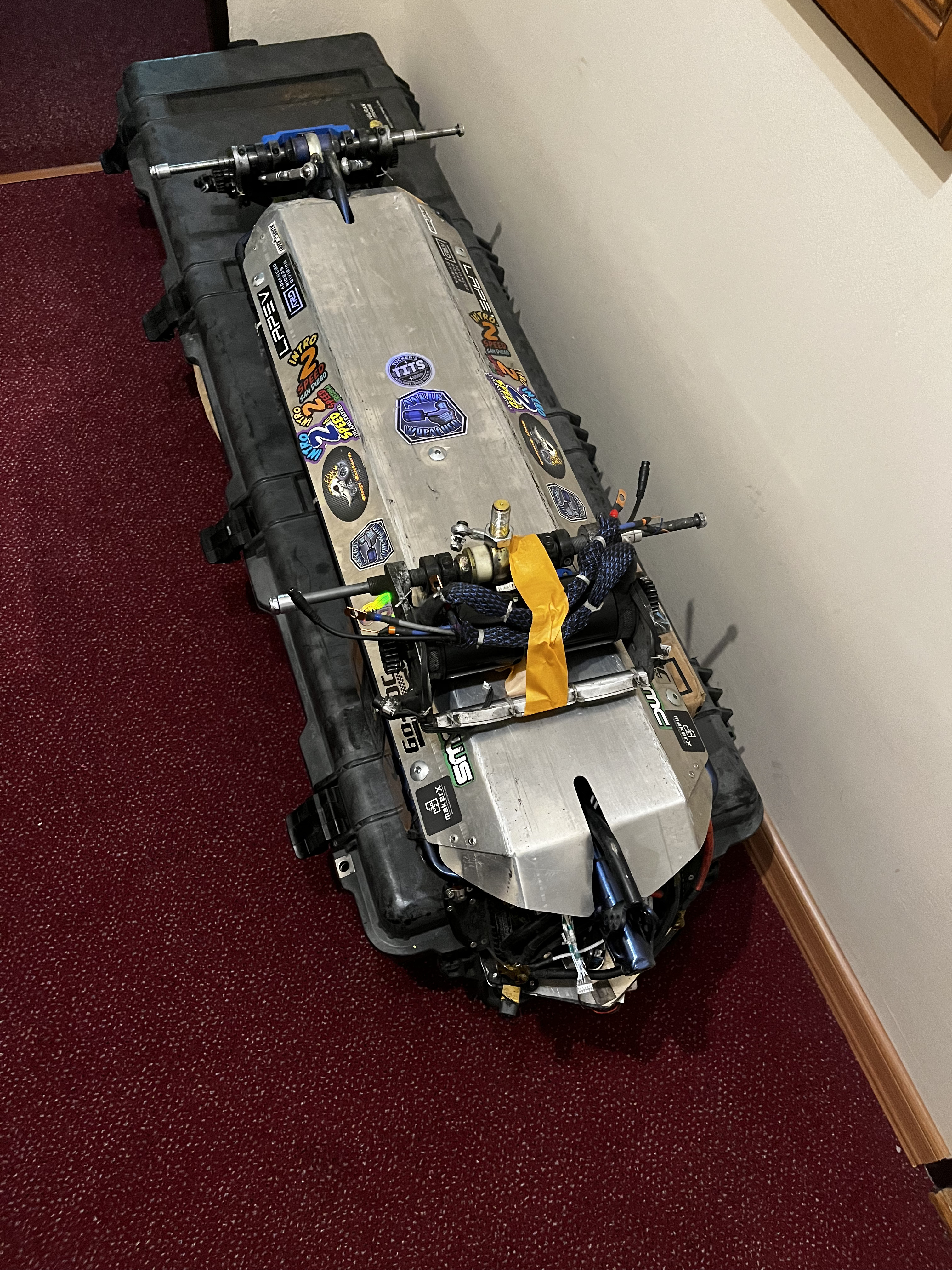

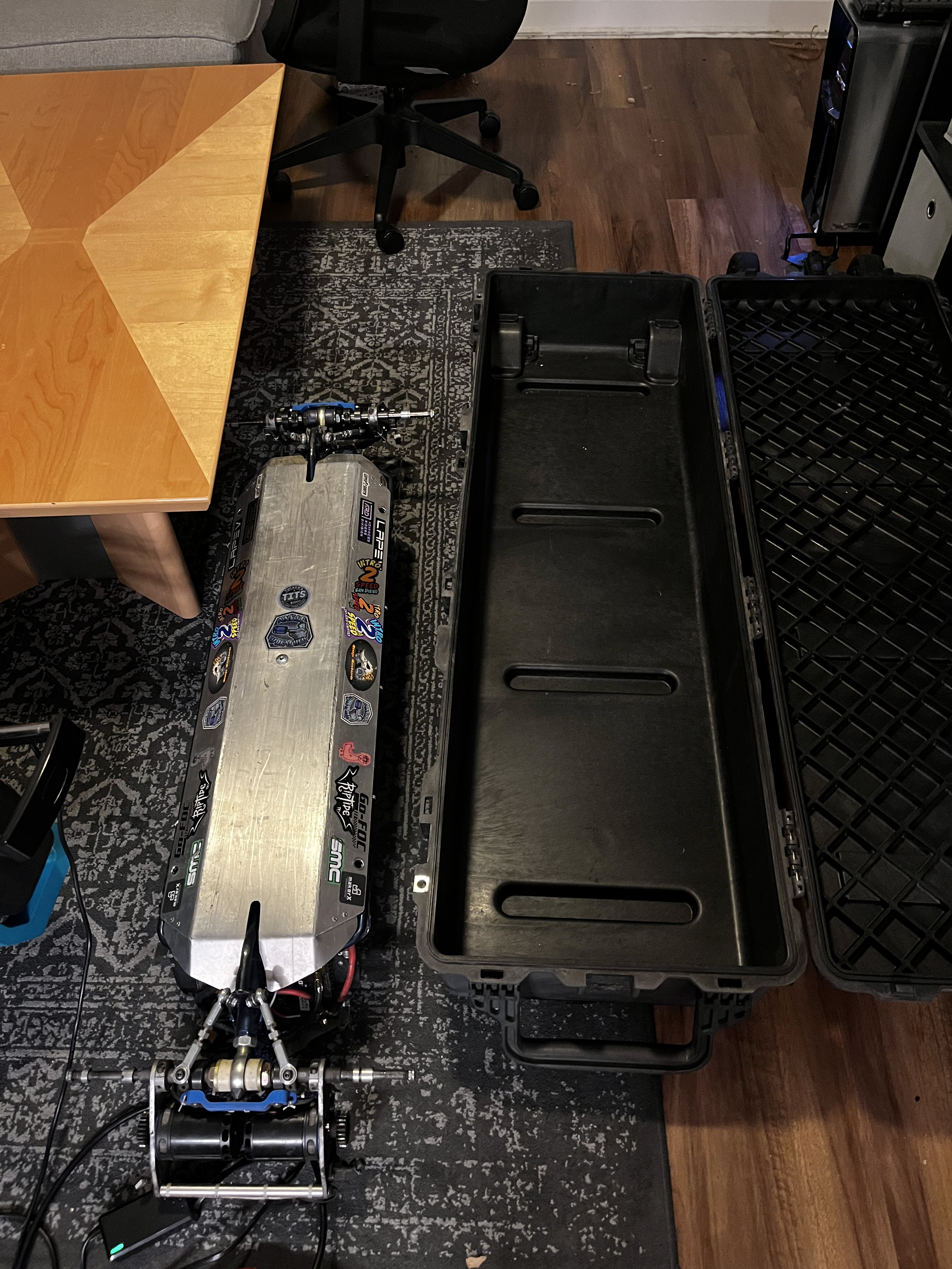

I bought a pelican case for $100 a year ago.
The plan was to build up a foam skeleton to hold the board firmly in the middle of the pelican case, and check it with the airline.
I had to take off my front box extension (Megan/TITS prototype) due to clearing issues (case wasn’t deep enough). Fortunately this was pretty easy, and I happened to have a perfect bubble wrap thing for it to travel in.
Unfortunately, reality derailed my plans. Even paying an overweight fee, the maximum weight It can be is 32kg (70lb). With just the board and tires in the case, I was pushing 36kg(80lb).

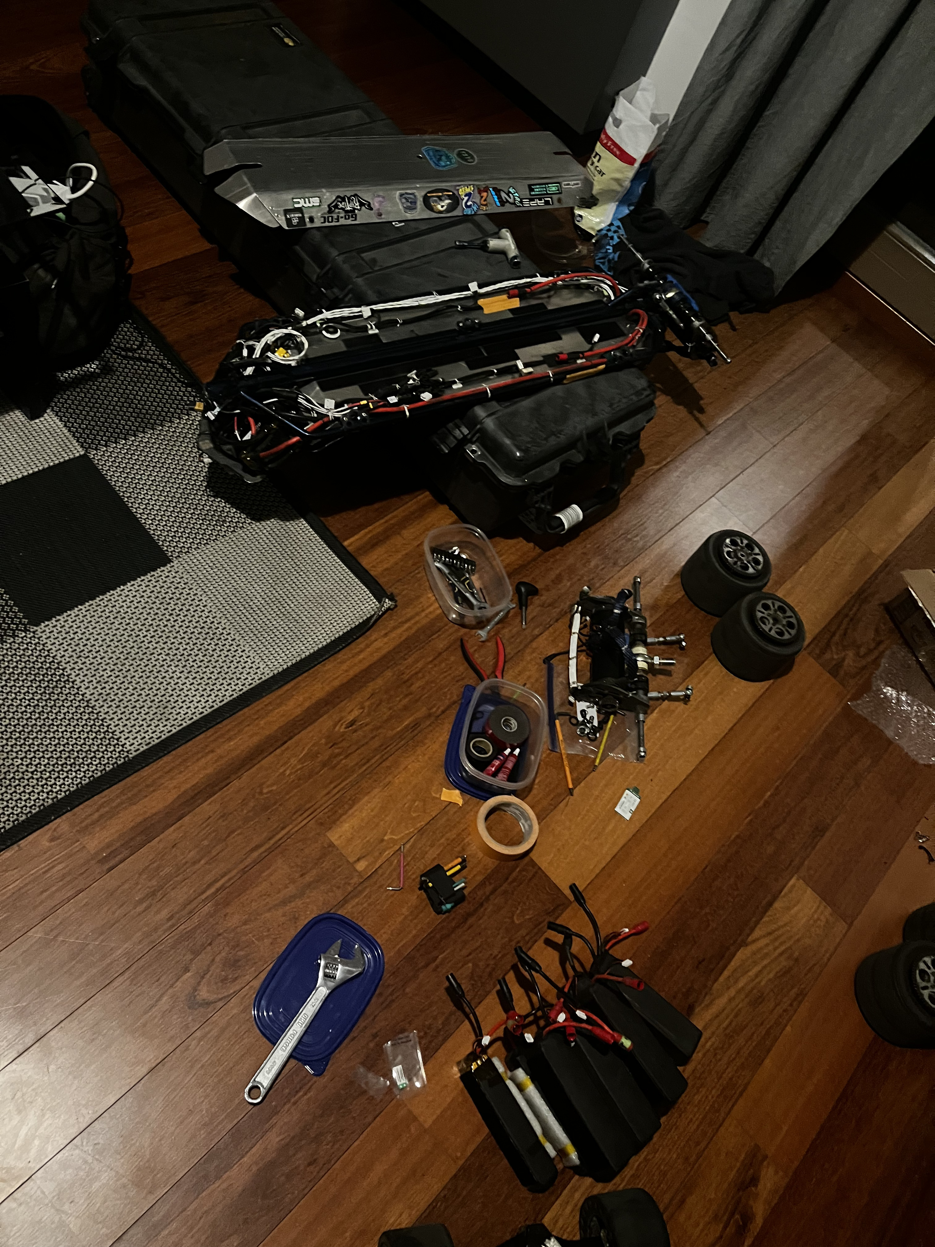

With only a few days to go, plane-checking was my only option, so I had to somehow remove a bunch of weight. The only way I could think to do that was to remove the rear truck/motors assembly. Undo the phase wires and the whole rear just rotates off at the hym.
I had enough “spare” weight to throw in all 4 wheels and my safety gear.
(turned out the scale I was using was quite inaccurate, and I was ~2.5 kg overweight at the airport :grimacing:. Fortunately the attendant was super kind and pretended it said 32kg :sweat_smile:)
I also through my larger tools (wrench, allen keys) in the pelican as well.
In my carry-on, I had my Roger Charger, rear trucks/motors and front box (Megan/TITS). And clothes. (which I neglected to pack ANY socks)
Bye buddies
I felt silly walking thought the airport with 100lb+ of gear

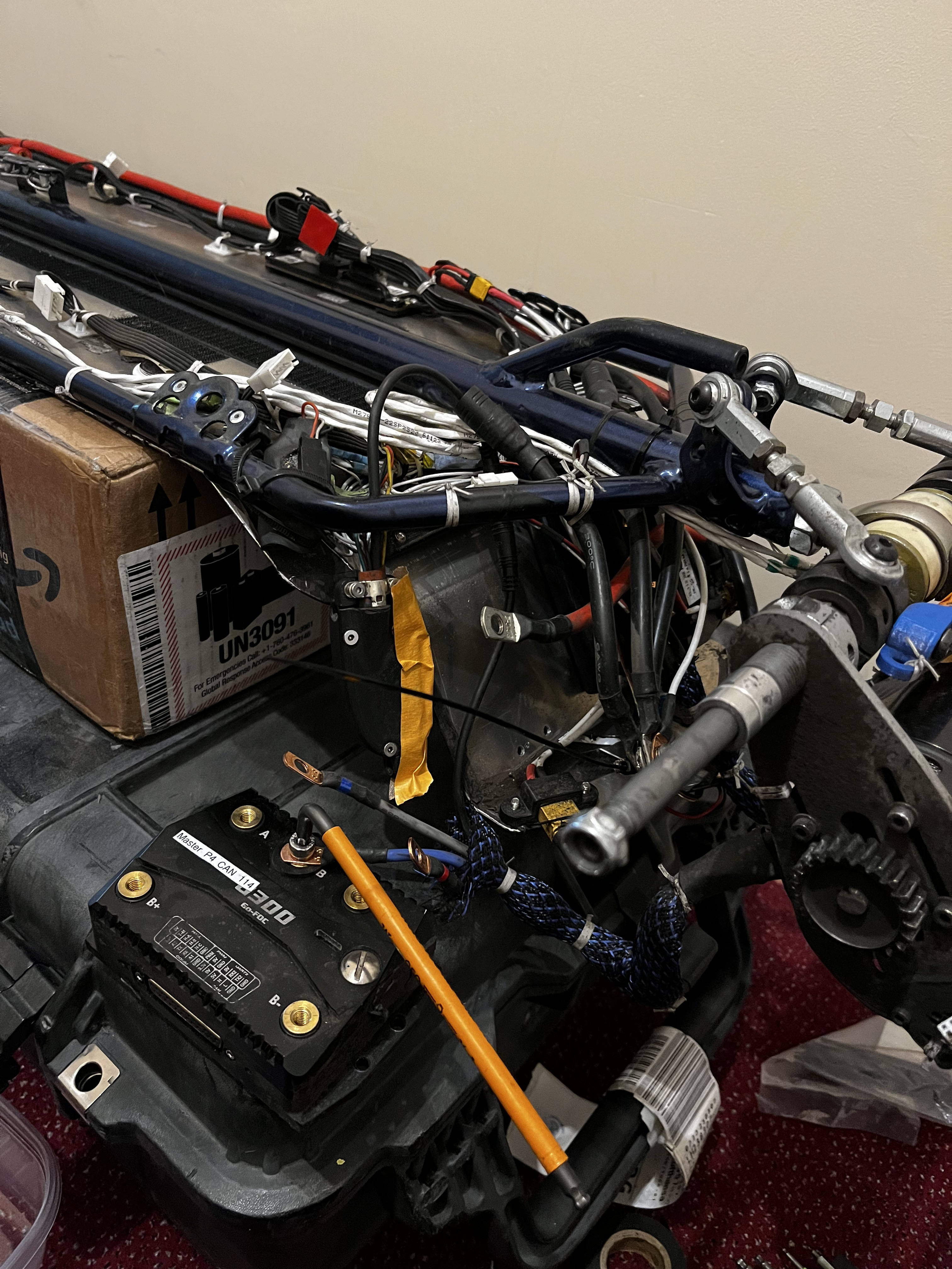

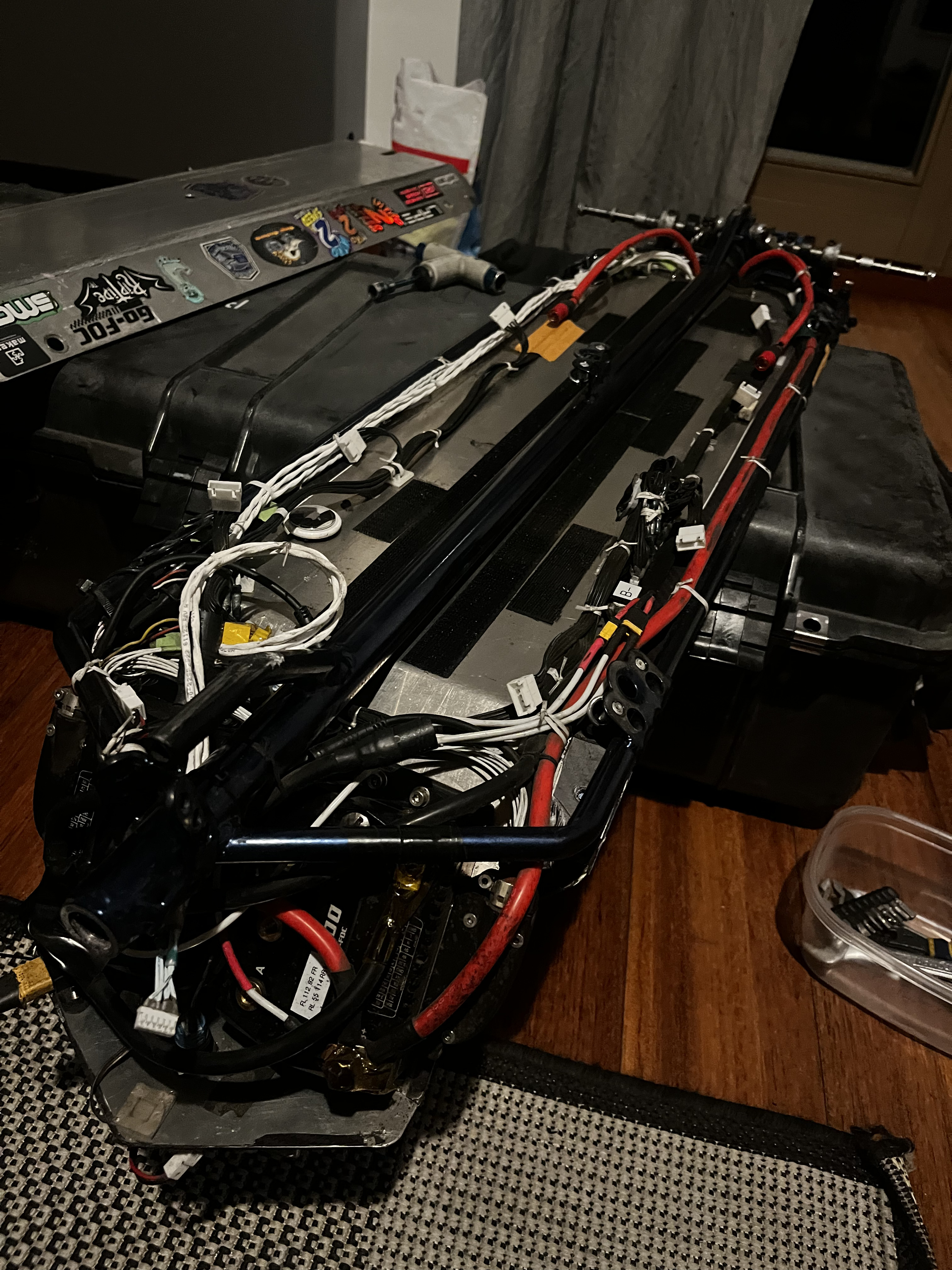

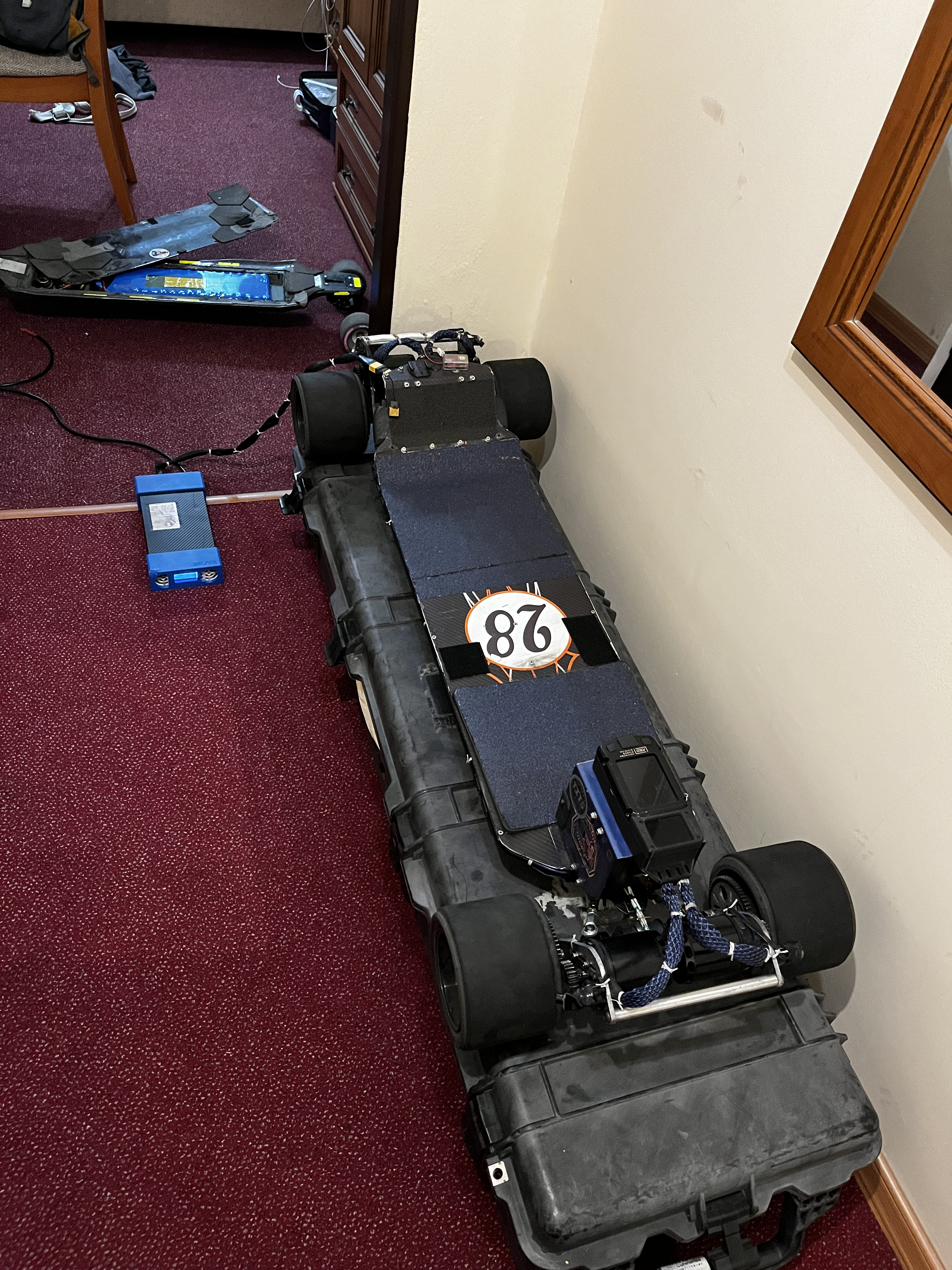

After a day of R&R in Prauge, It was time to reassemble the board.

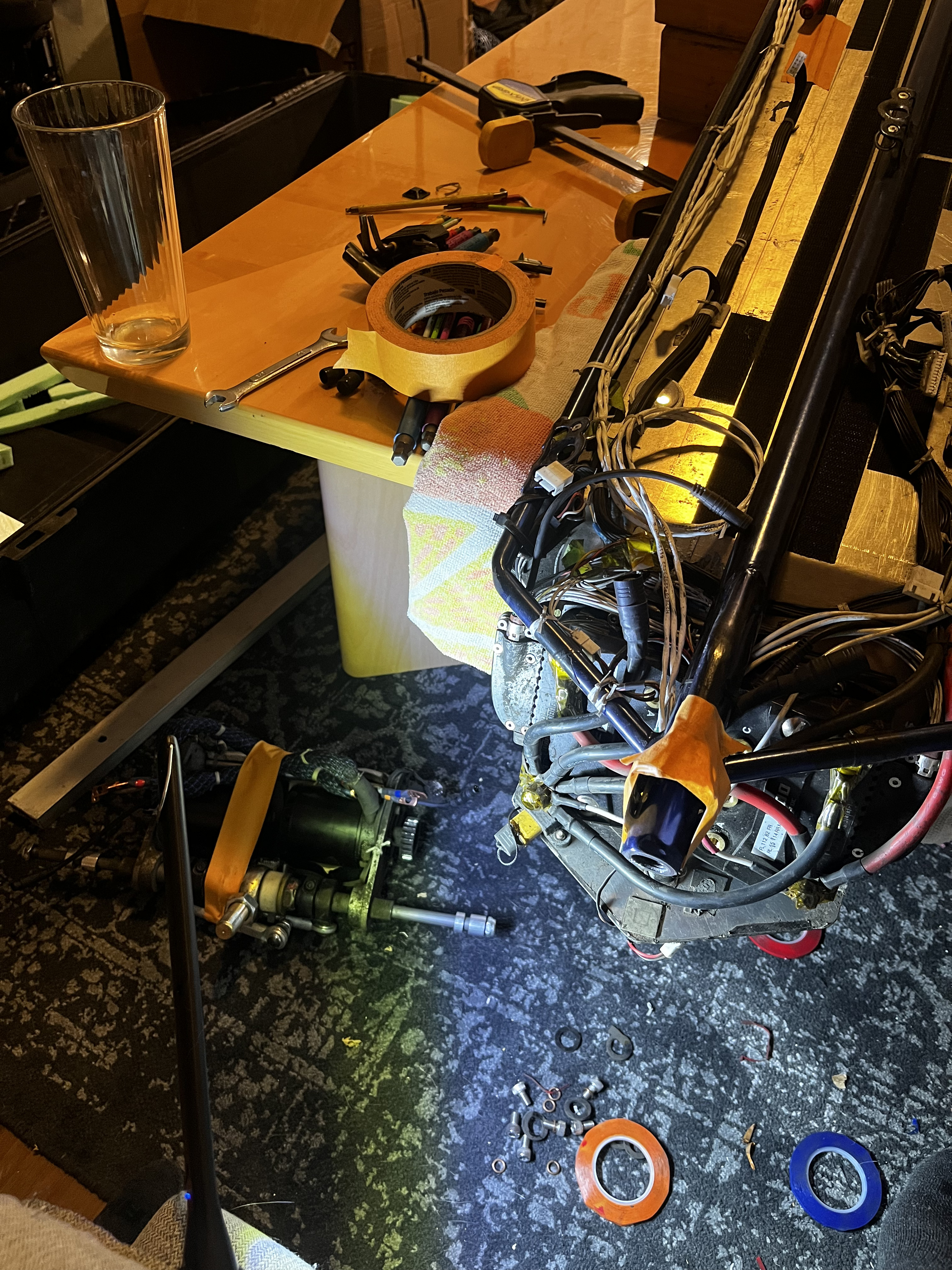

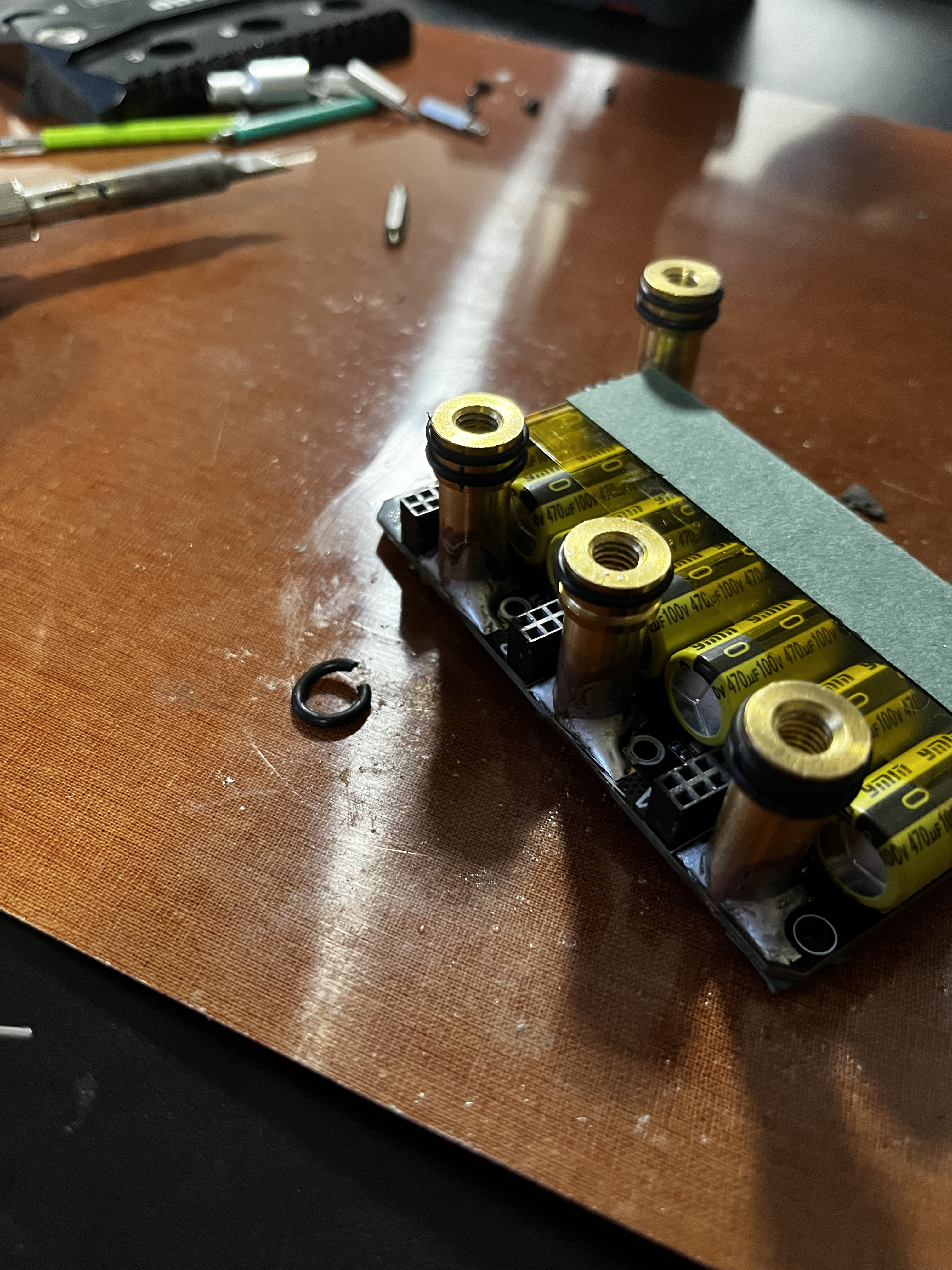

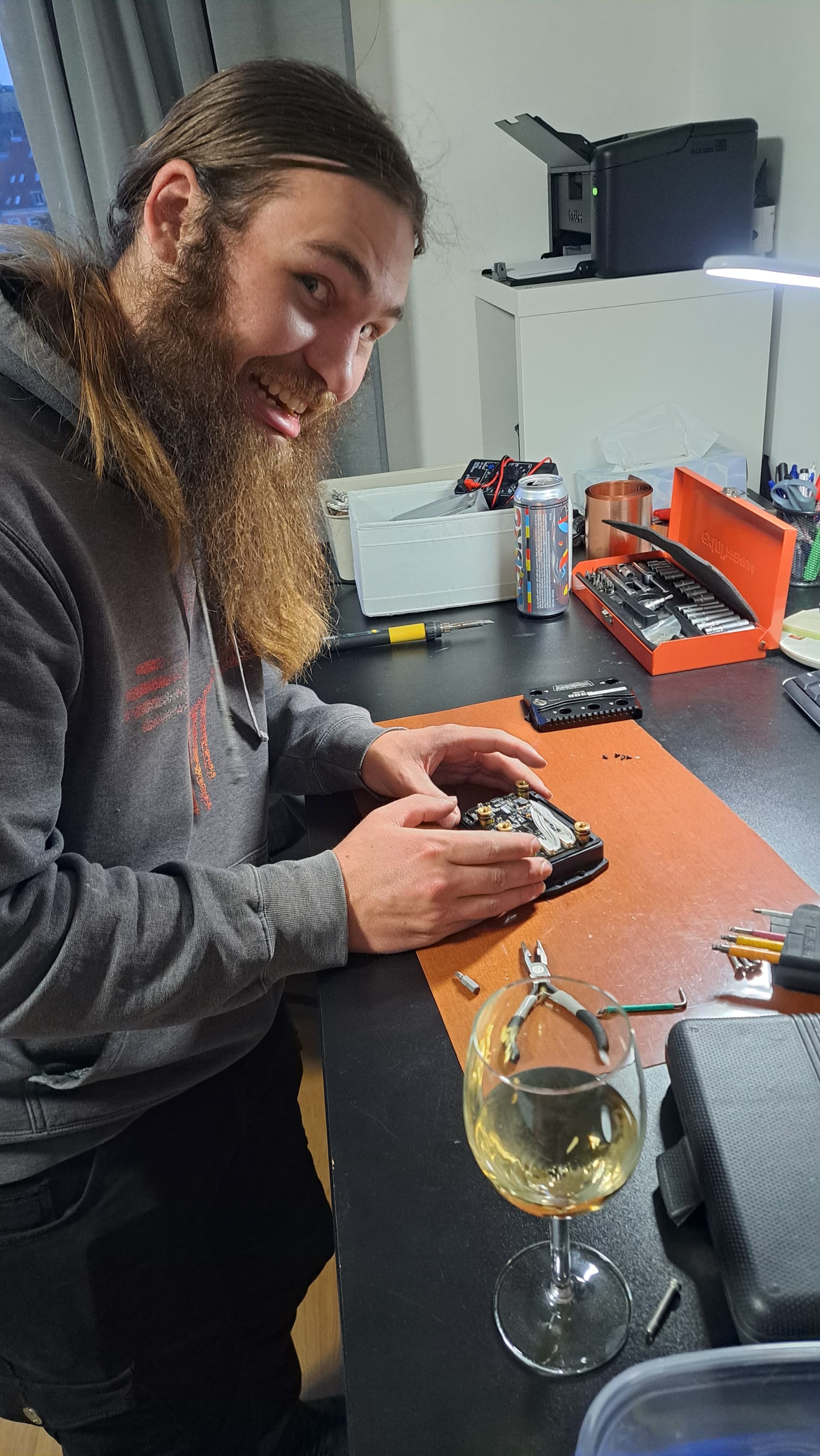

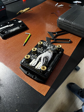

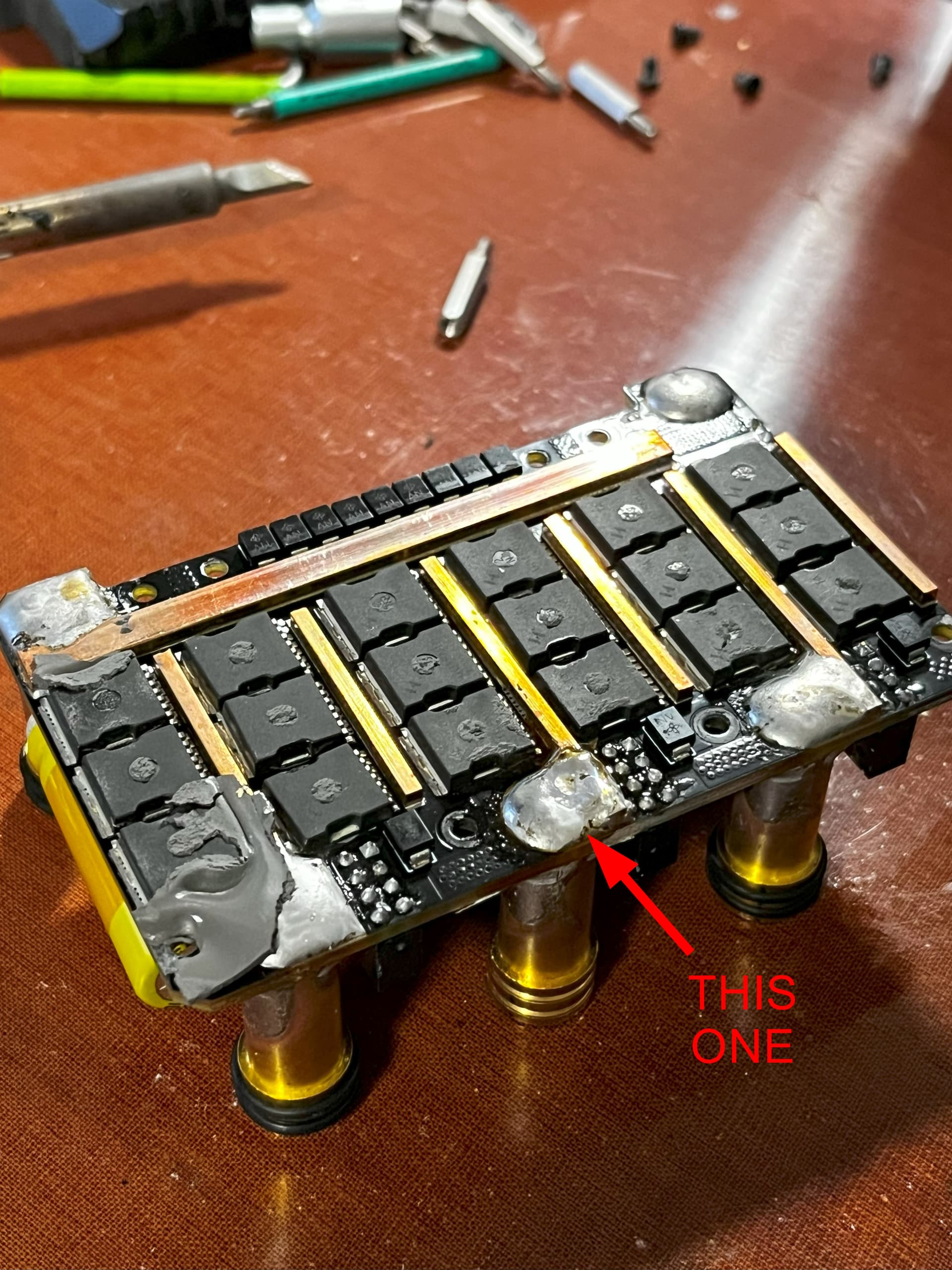

The G300s use Bolted Spade connectors for the phase wires.
As I was tightening the last phase wire down, it ROTATED.
I prayed that it was repairable, and asked around to see if anyone had a high-powered soldering iron that I could use , as I started pulled the G300 out of the board
@adrenalinskateboard responded to my call for help and invited me over for an evening of totally-not-stressful repairs and alcohol.
Disassembling the G300
I was feeling “great”
That said, could be worse?
We reflowed the joint on the backside of the PCB, and that seemed to work!
Not before we melted one of the rubber o-rings though. nbd, Ankle Wreacher was never going to be waterproof anyway :rofl:
Getting back to my hotel at like 2am, I got the G300 back on the board and working, ready to race. Lets Gooooo

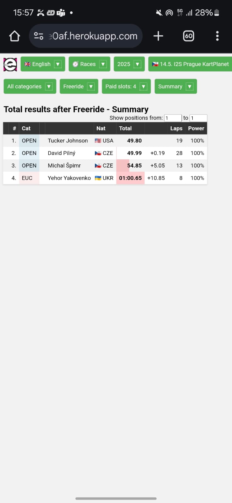

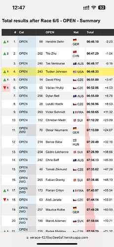

The Race!
What. A. Blast.
6 back-to-back races. I think we had ~12 minutes of racing within a span of
and hour of so?
by the end of it, we were all brutally exhausted. It was borderline an endurance event! I was just focused on not falling and crossing the line.

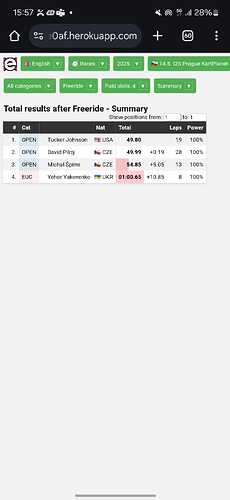

I was right on the edge of podium the whole time, and I wanted it.

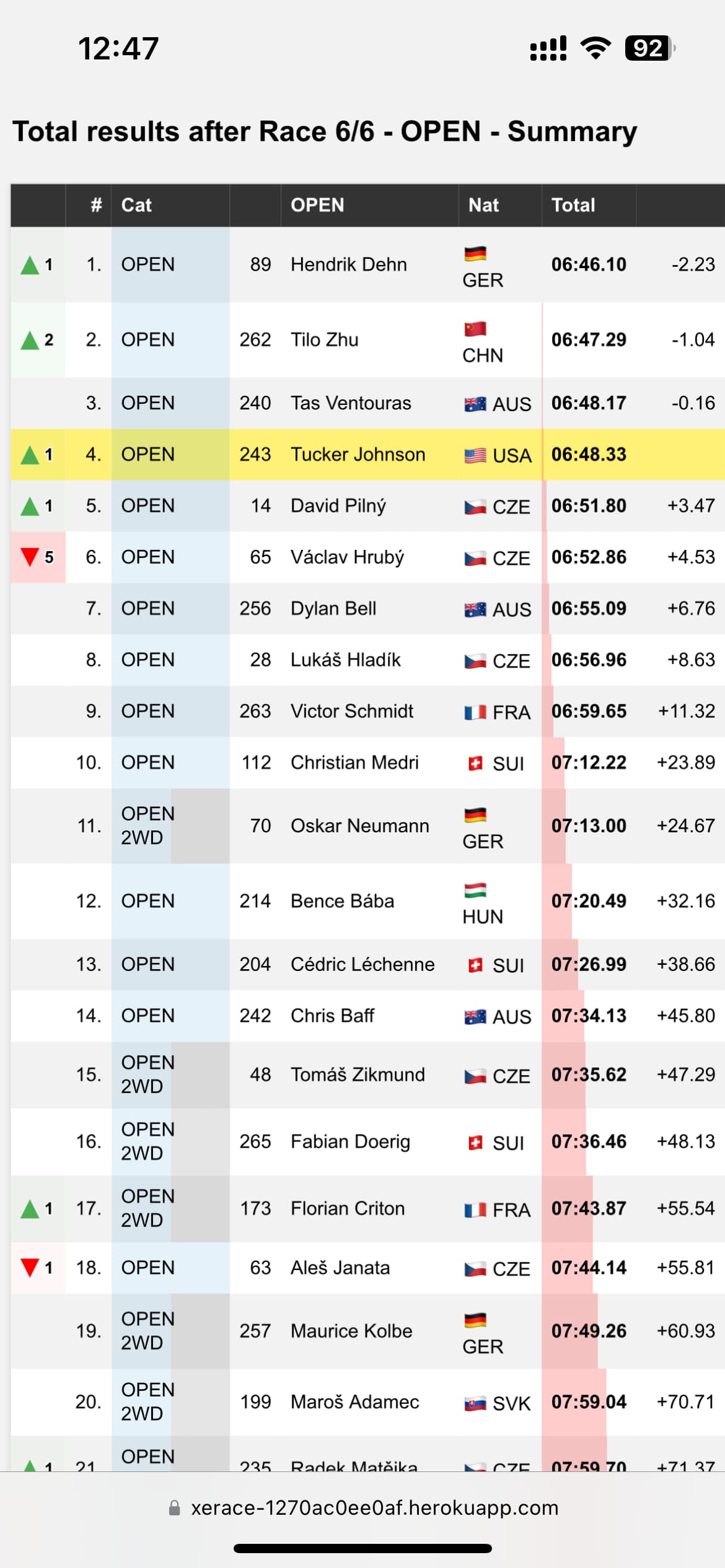

In the last race, Tas put down a great time, beating me to the podium by 0.15s
:exploding_head: :exploding_head::exploding_head:
Across 6 races the difference coming down to be that tiny?? I can’t even be mad. Great racing, everyone. Fucking fantastic time.
