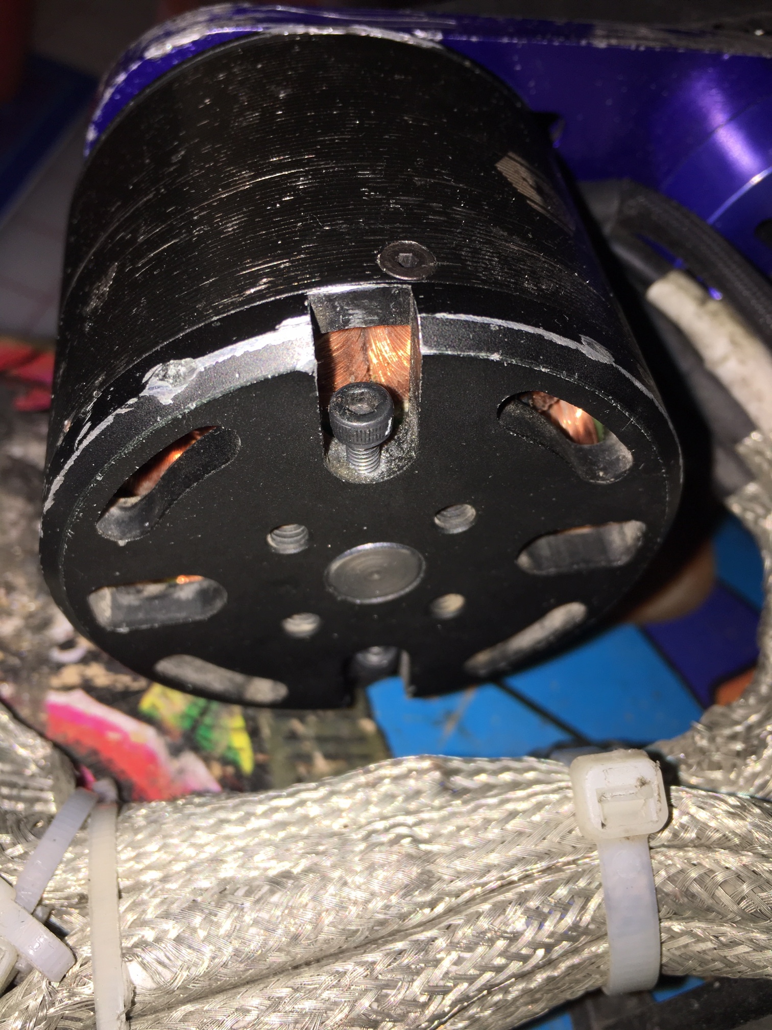

Well here I am again trying to diagnose a new sound. I just swapped over to these sweet new TB110’s and just drove out to my favorite night time spot to try em out and well, THERE’S A SWEET NEW SOUND. Sigh…any ideas wtf this is plz thank you all and I’m sorry to blow up the forums with my garbage.
As you can see, doesn’t make the sounds when upside down (non-weight bearning) but when it’s flipped around and pulling it’s own weight it’s there. Now when I stand on it and it tries moving 190lbs, you can imagine. It’s really loud and annoying. Belts are tensioned properly, running 16/36 gear ratio.

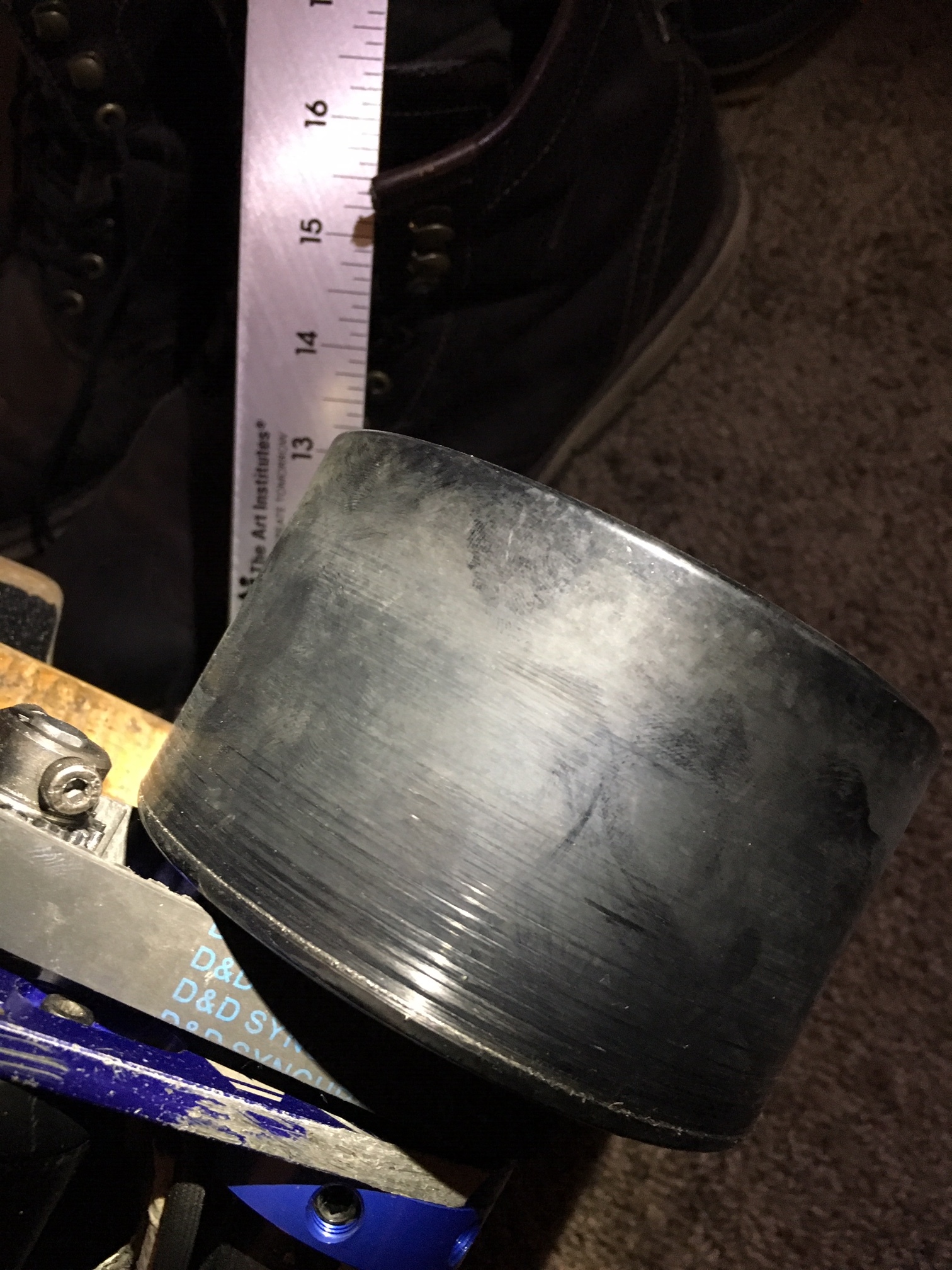

Something’s going on with the way the weight is bearing bore on the wheels. Check out the marks on the new wheels. Same as on my cags before this too, they are worn heavily on the inside. I feel like the back wheels aren’t sitting straight and IDK if that’s coming from my mounts or what.
The mounts are solid AF. These are BRAND NEW one piece clamps I got today with the 110’s and they are rock solid
Motor pulley shoulder is hitting your wheels then?
it’s very close, a few mm away but they’re not hitting. lemme make another vid for ya’ll
Yeah look at the bolt on your motor pulley in your pic. It lines up with the wear line o your wheels. Also makes perfect sense with the sound and “hopping” your board is making.
I know it looks that way but I swear that’s not it. Video coming in moments
100% sounds like wheel pulley hitting either the mount
It was grinding on one of my client builds against a screw head/mount, you can scoot the mount over a little

Did you check that it wasn’t similar to the problem you had before? Like with the shaft coming loose from the can?
Is the can of the motor loose or wiggly at all?

SO I’m running sensorless but now that I look at the can the 2 screws that running vertically are loose and I can’t tighten them! It’s strange, it’s like they’re screwed in most of the way and then they just keep spinning freely without threading all the way to the bottom.
Is the bolt supposed to thread into the shaft? Is there some sort of allignment I missed when putting my motor back together??
Try this. Remove the belt and try to pull the motor pulley to check whether the rotor has too much “play”.
