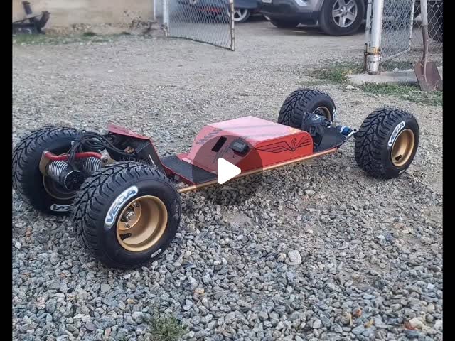

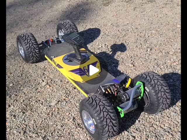

Castle Cobra 5hv
Castle 2025 560kv
12s 2p 19000mah 120c lipo
20a bms
Radiomaster erls controller

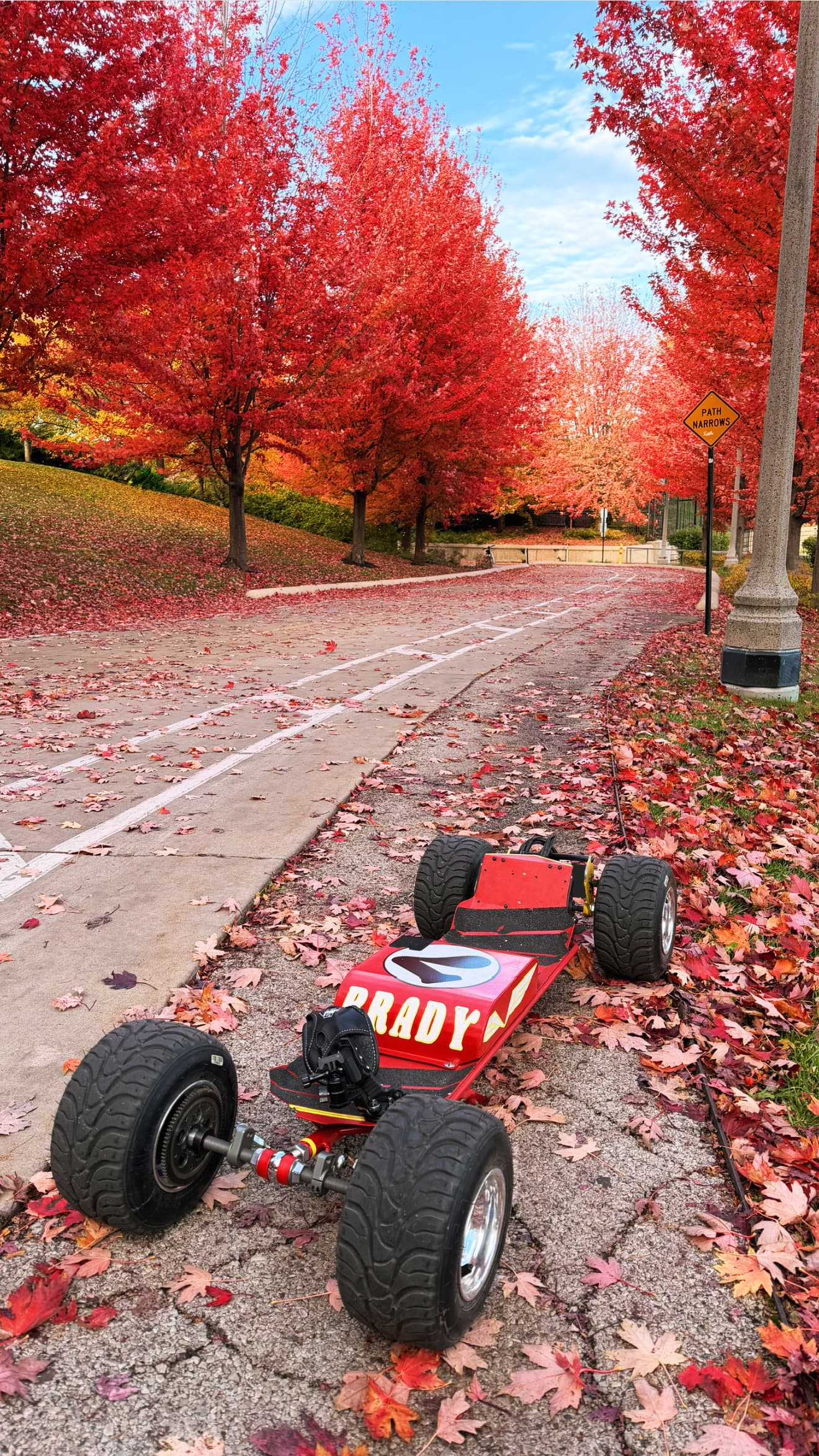

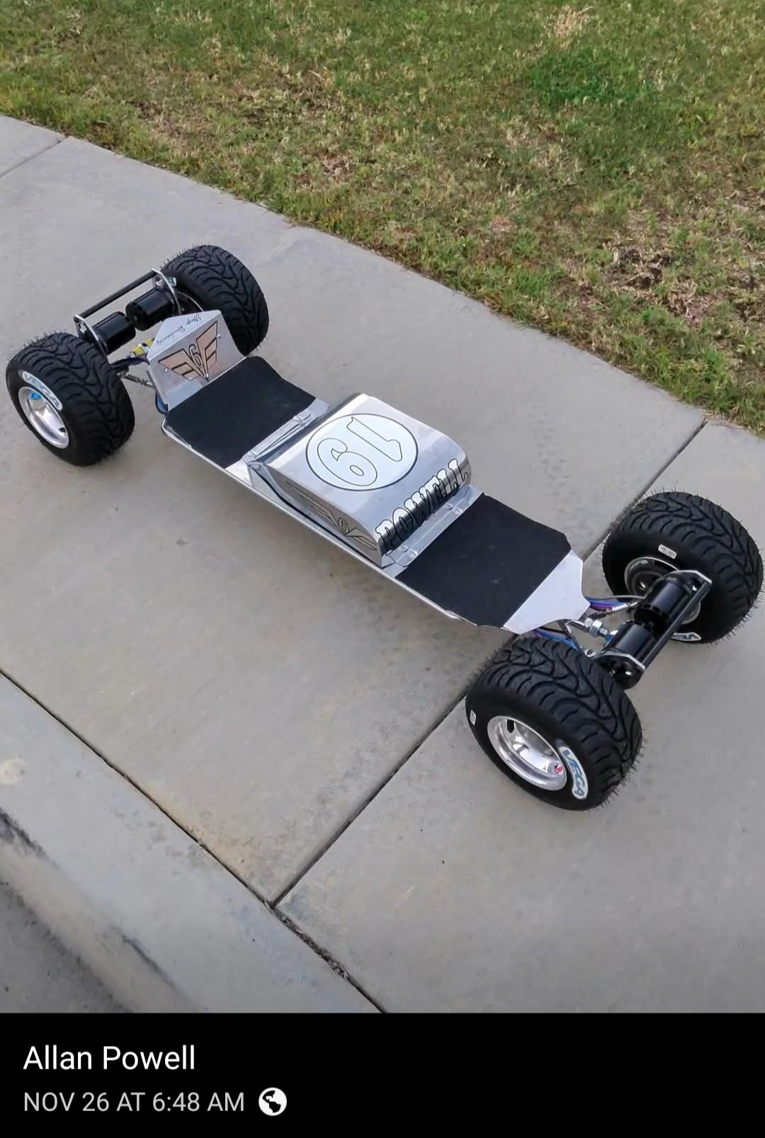

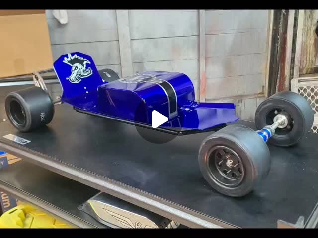

SuperSpine GTA big wheel conversion
Tall battery box added. Color change to Illusion Royal
#001
@tomiboi deck
@RipTideSports aps 85/90

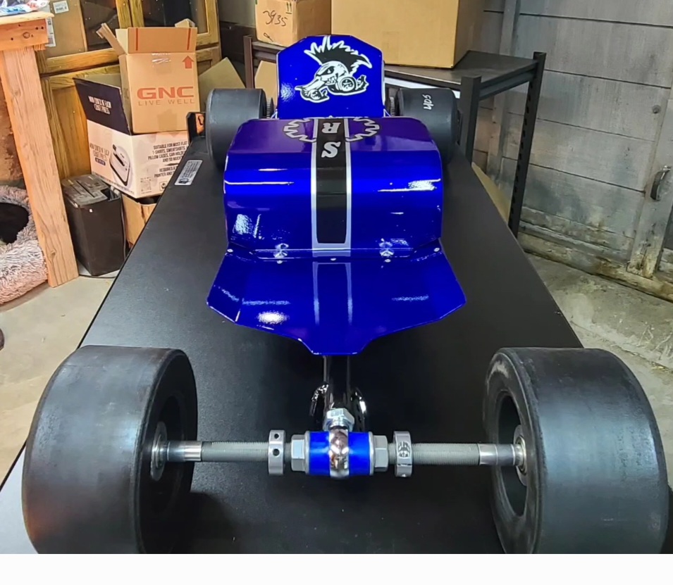

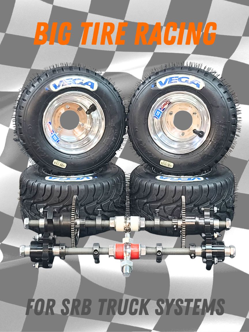

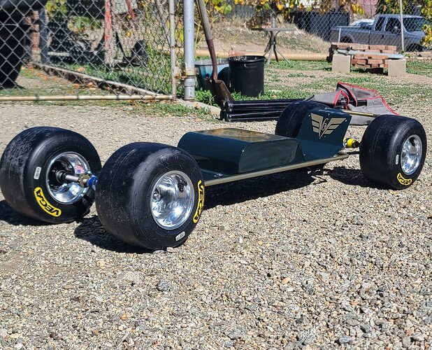

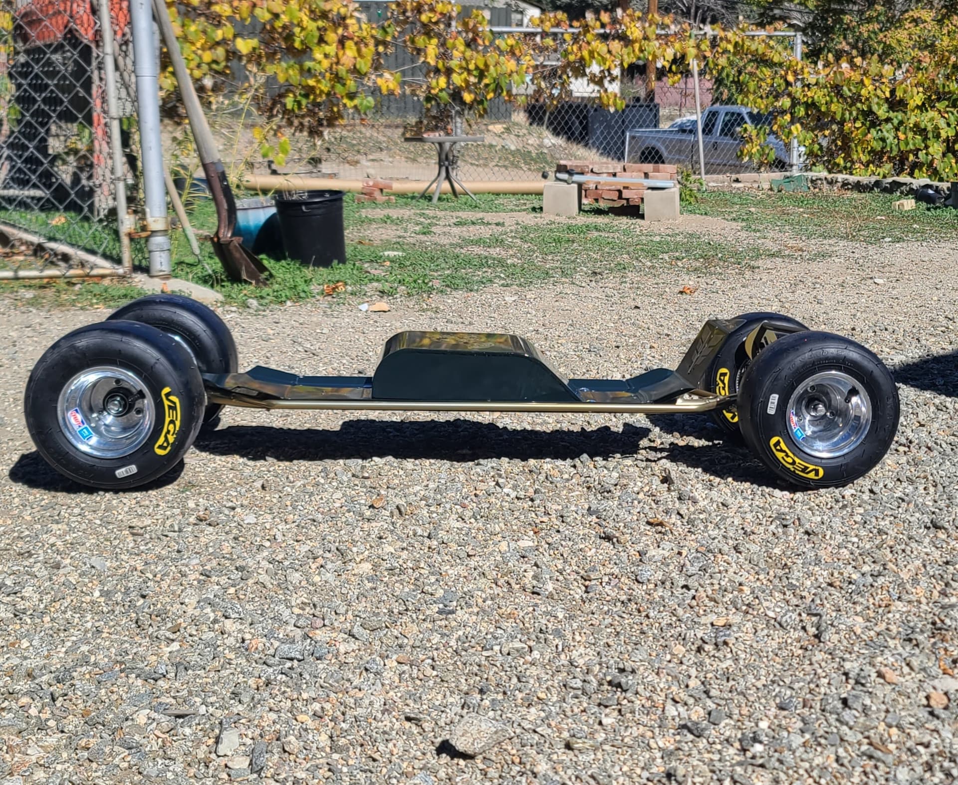

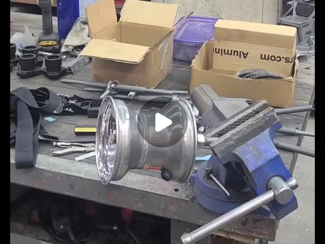

Big tire mounting on a 1 piece wheel.
Static balancing the big tire.

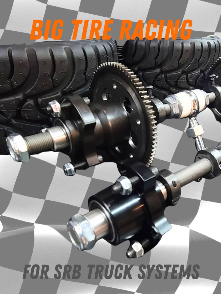

A big lever needs a big spindle.
Bearing placement behind the wheel load center increases hub leveraging on the spindle. A Narrow bearing spread also increases the wheels fulcrum over that spindle. A positive offset wheel also adds the this leverage on the spindle.
Match that with a standard size esk8 spindle size = an over levaged spindle.
The SRB big wheel front hub and drive hub uses the intended and proper bearing, bearing placement, bearing spread and spindle diameter that these Big wheels were intended to run on.
By having proper bearing placement (bearing under the wheels load center) spindle leverage is minimized on a straight and in a turn.
The result is the hanger has the best possible control over wheel function both in a turn and over rough terrain. :chequered_flag:

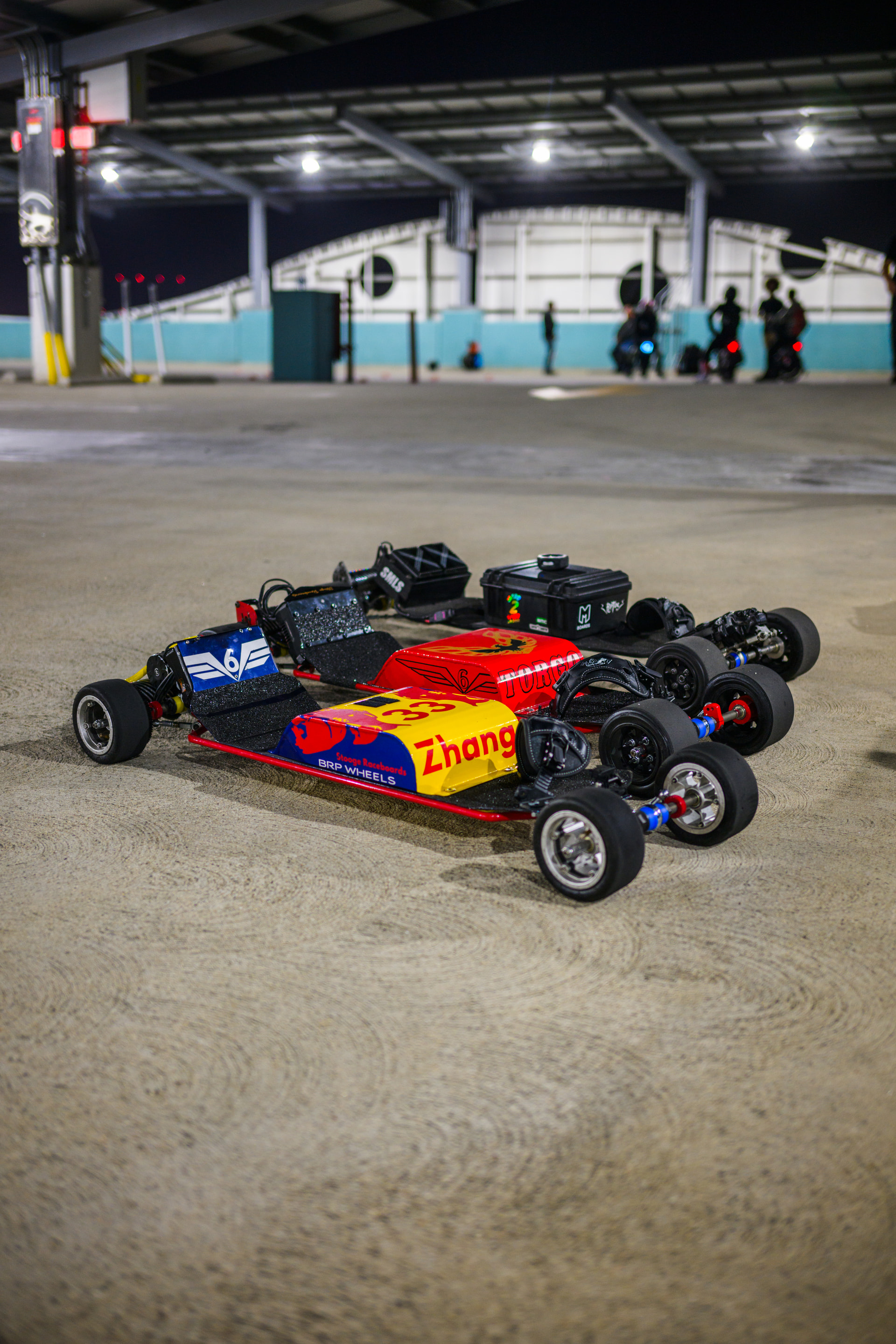

85 USA podium spots with SRB designed products for 2025.
Thanks, to all our family of SRB racers.
Big Wheel proving grounds are well on their way for 2026.
Merry X-mas and looking forward to a great New year.
Thanks to all who raced and rode our products last year.
2025 brought over 80 podium finishes with racers riding on SRB products.

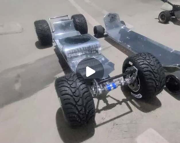

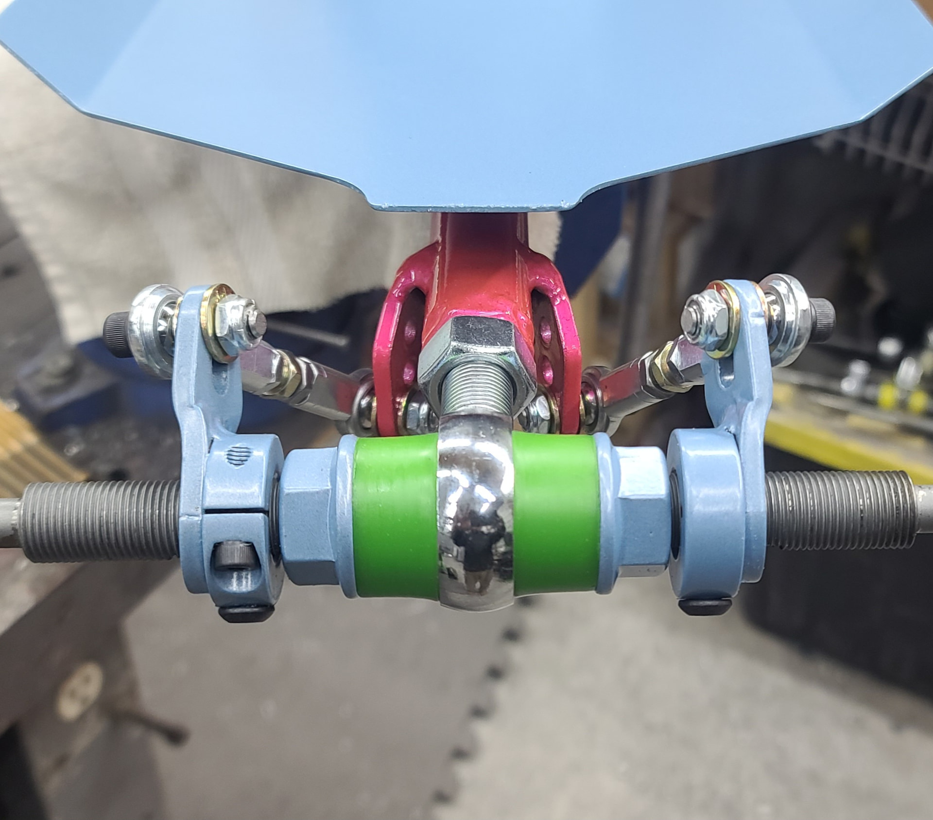

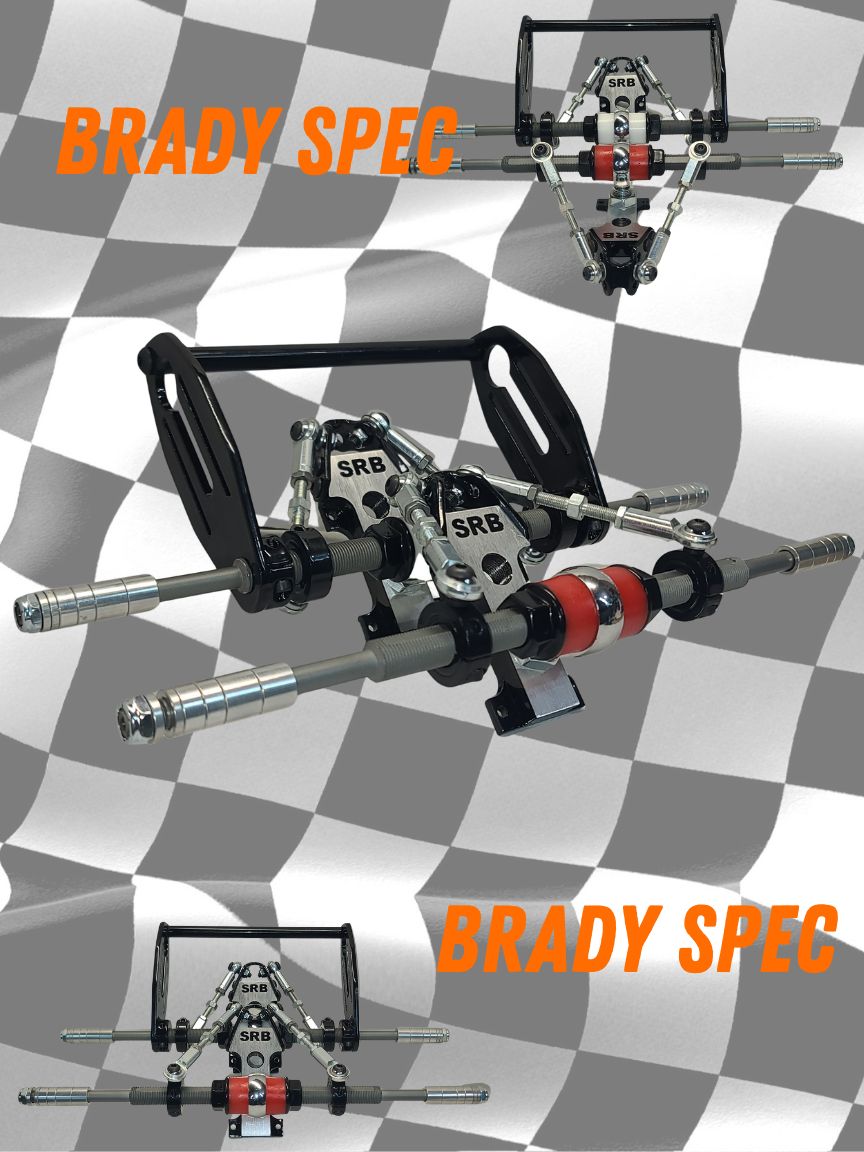

A new spherical truck is in the works for 26. The quick angle adjustment and user friendly traits make it more straight forward than our traditional precision 3-link.

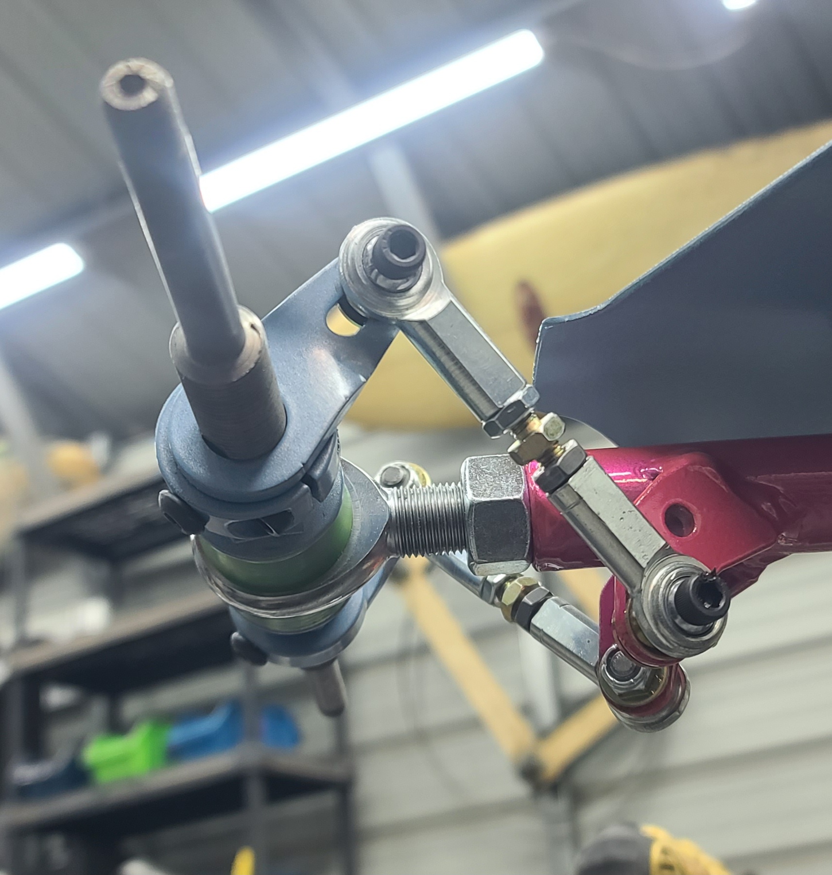

Our Big wheel V-6 program is dialed in and track proven. Having all the cold track grip allowed us to focus on the v-6 back-end steering geometry. The new rear adjustable hanger rod mount put the BW V-6 on a rail. It will work with both long and short rod trucks if you are looking for more or less angle adjustment. Spherical mount position allows for over or under clocking the rod length.

Do you have any pics of the new rod mounts fitted up?
