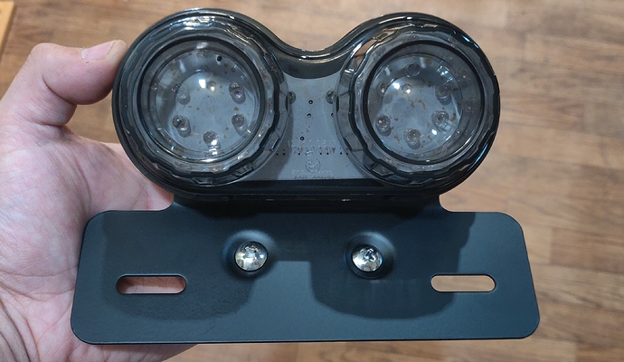

Brake and signal light

figured out lighting wiring, that was a headache, still need to get flasher for turn signal and dedicated switch for DRL
interesting stats, drl+high&low beam and tail light uses 40watt, drl + low and tail light 30 watt, drl and tail light 6 watts
