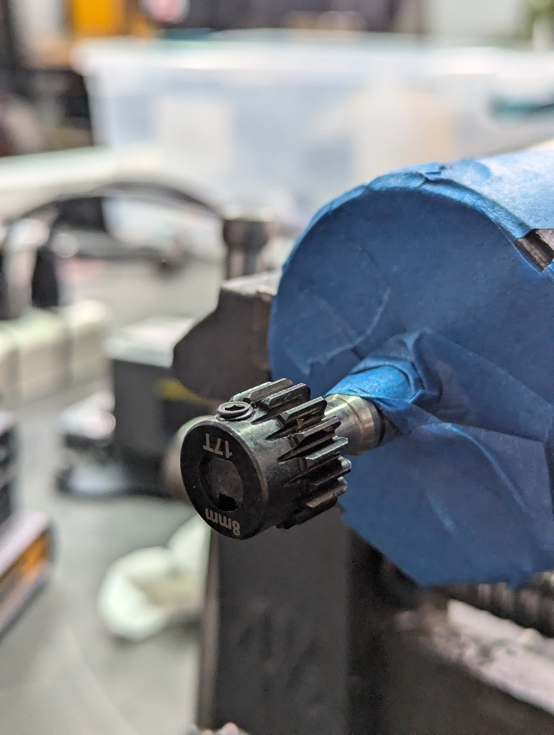

I’m starting to consider switching all my drives to use a d shaft 8mm interface. This would require me to grind a flat spot on the motor shaft. My theory is that this would be easier than broaching a keyway using hand tools and a bench vise. I tried that and broke a lot of broaches at ~$20ea.
I ordered 4x of each or these to test with.
These are $10ea with a flat $35 shipping to the USA. After $500 shipping is free.

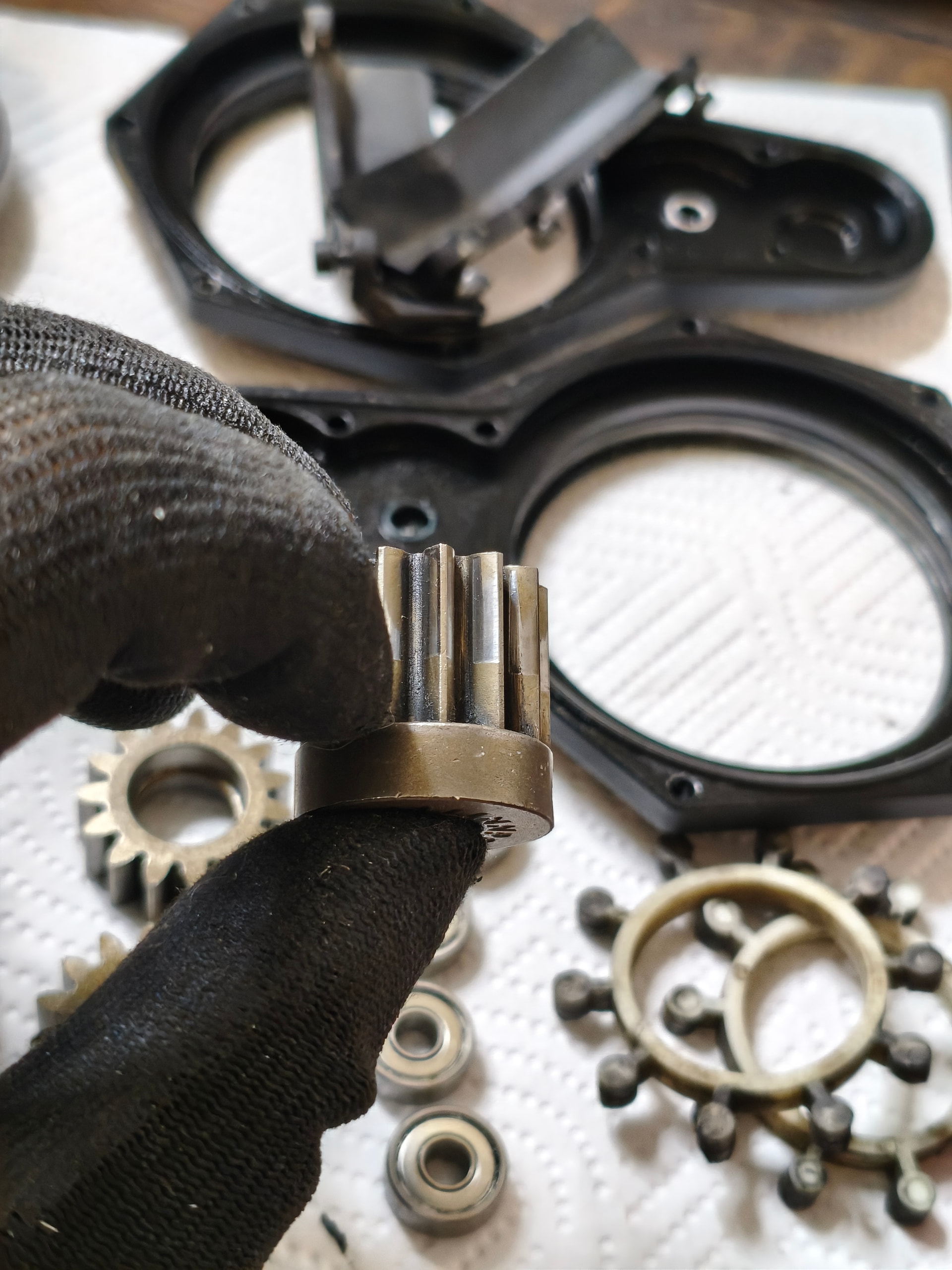

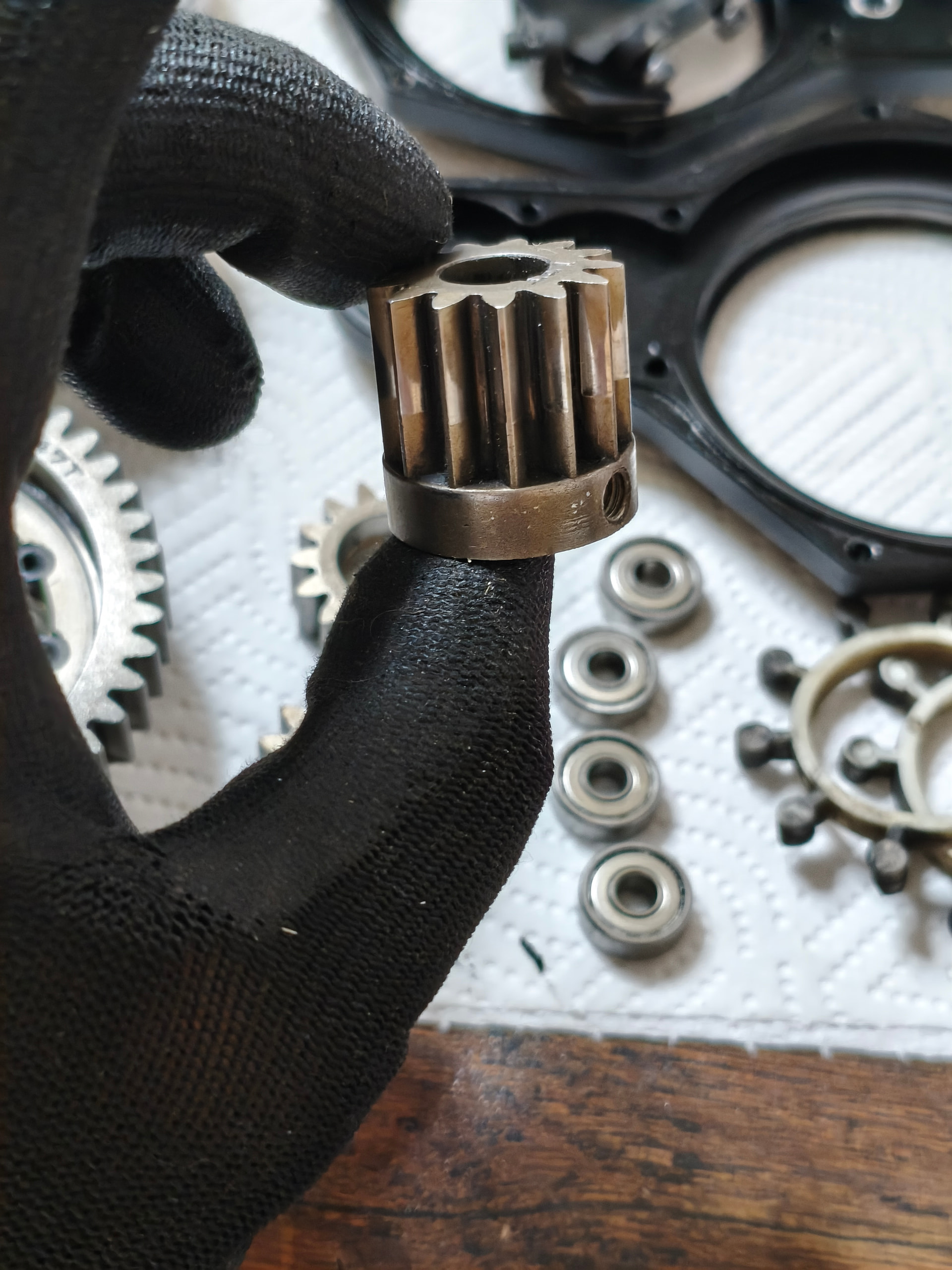

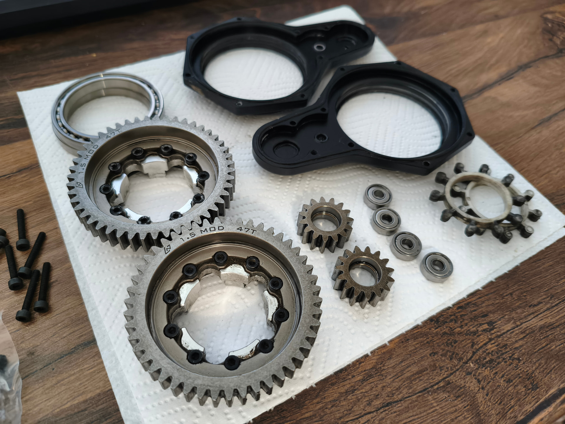

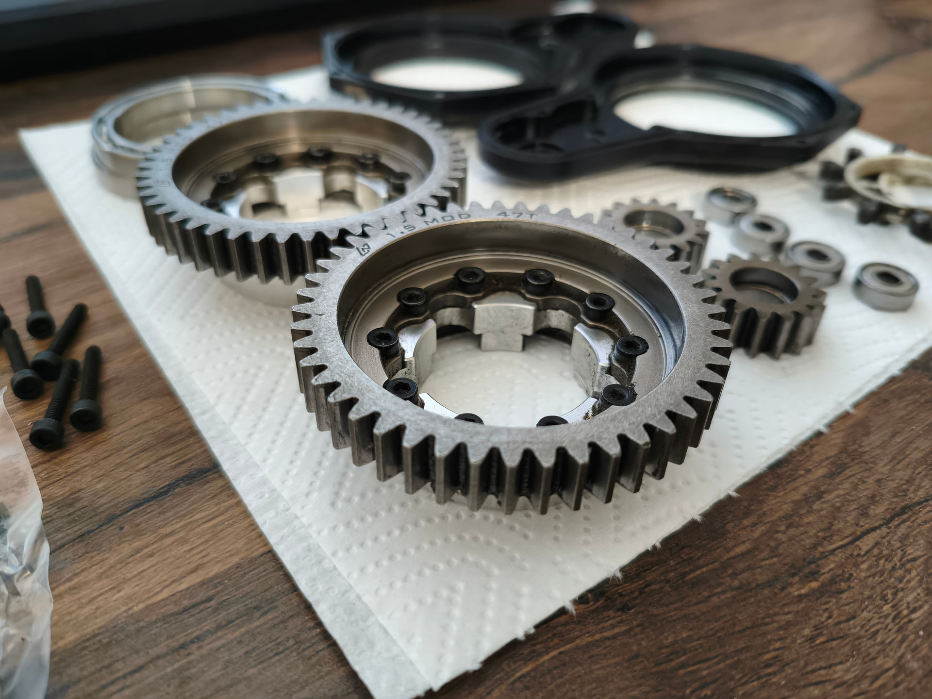

I already posted this in another thread, but I can mention it here as well. In my opinion, the Linnpower gear drive is the best. Here’s a photo after 5,000 km—it still looks completely new! Hardly any signs of wear. :slight_smile:

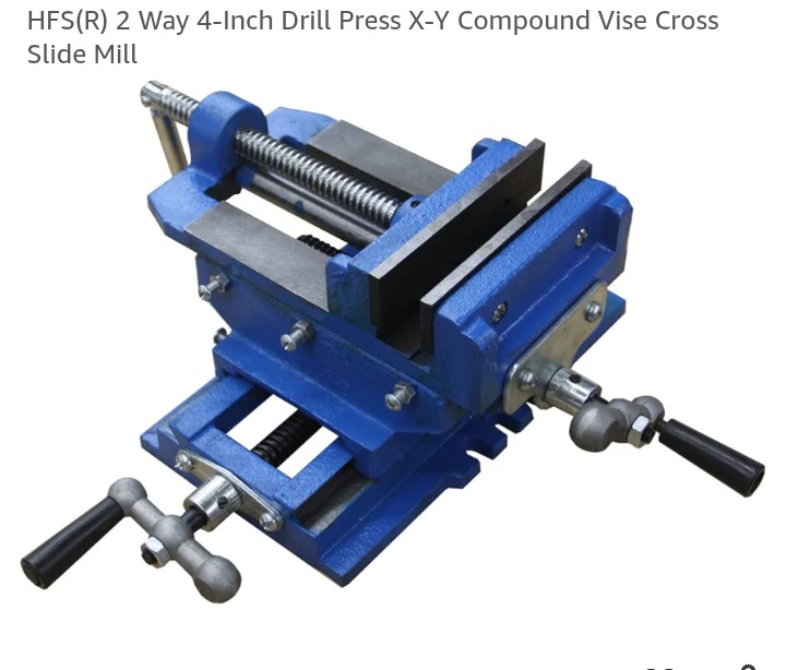

You can probably rig up a fixture to make the grind repeatable using one of these things and a Dremel mounted to a workbench.
Far too manual for ol’ CNC-cel over there

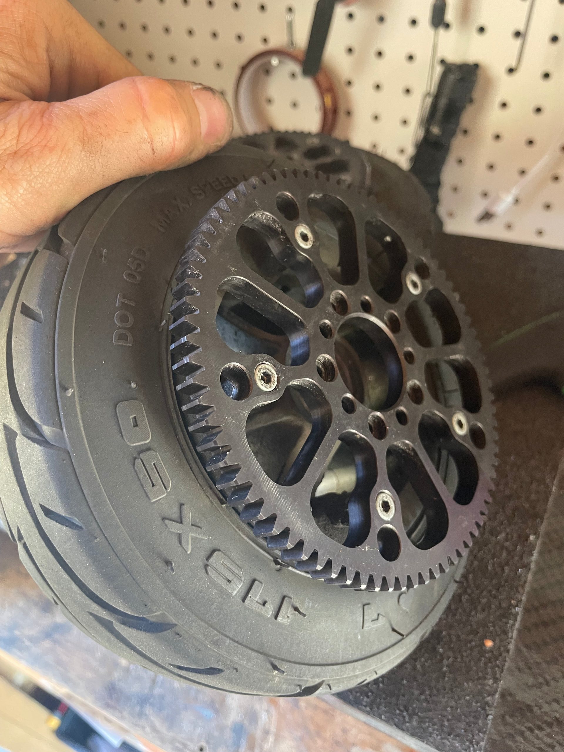

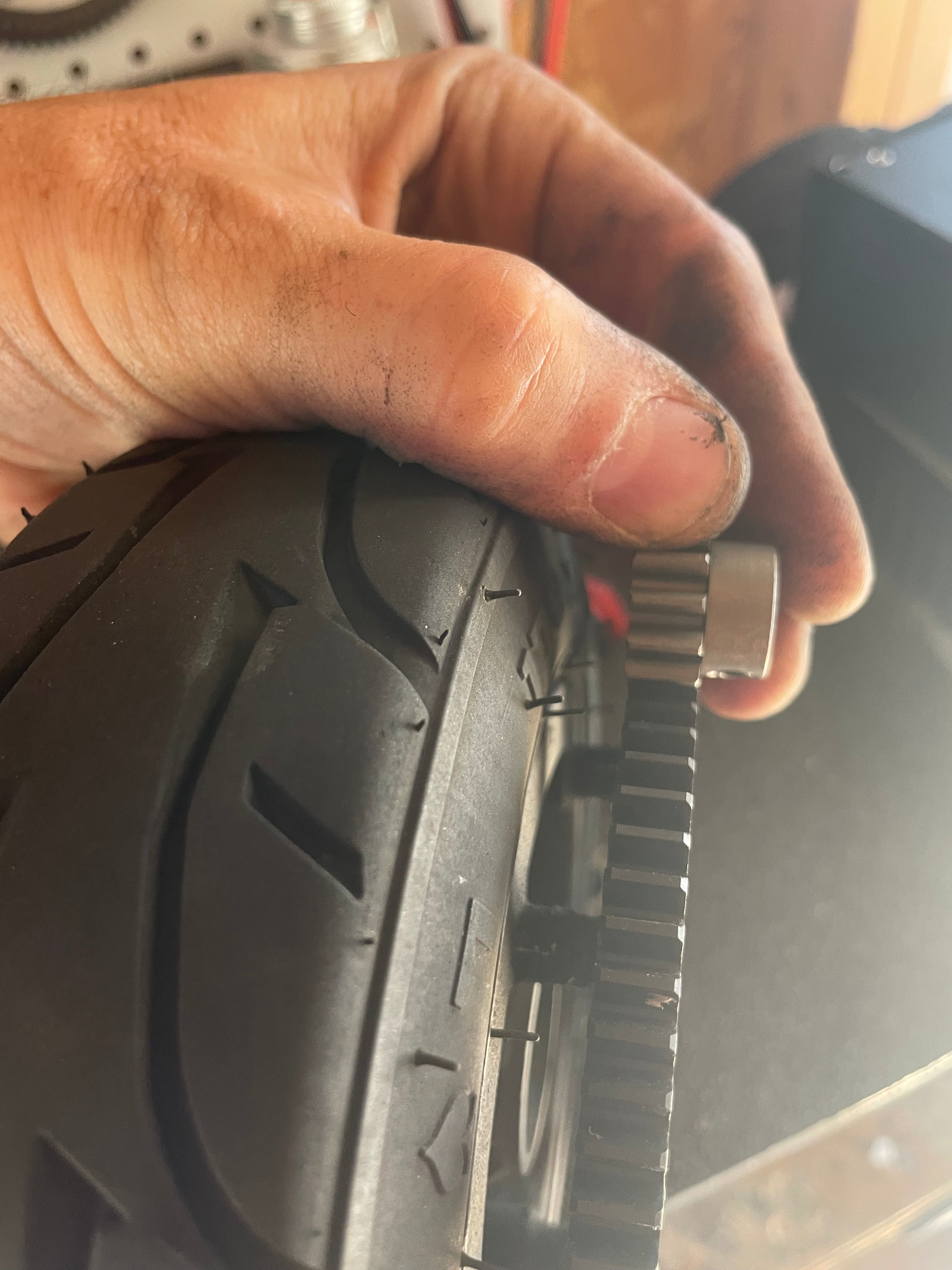

Got the new Tito 79t spurs installed. So easy to center with the counter sink mbs pattern holes.
They’re slightly wider than his 67t, maximum spur/ pinion contact.
How wide are they?
Ratio Maximum is 4,3 ?
Ratio 6 or 7 is nice shit.
I dont fint Gear withe this :exploding_head:
Ratio is 3,6 (13T pinion)
36 Nm isn’t much either. It would be interesting to see how it performs with, say, twice the torque. A gearbox running in oil should last at least 10,000-15,000 km, otherwise something is wrong with the design.

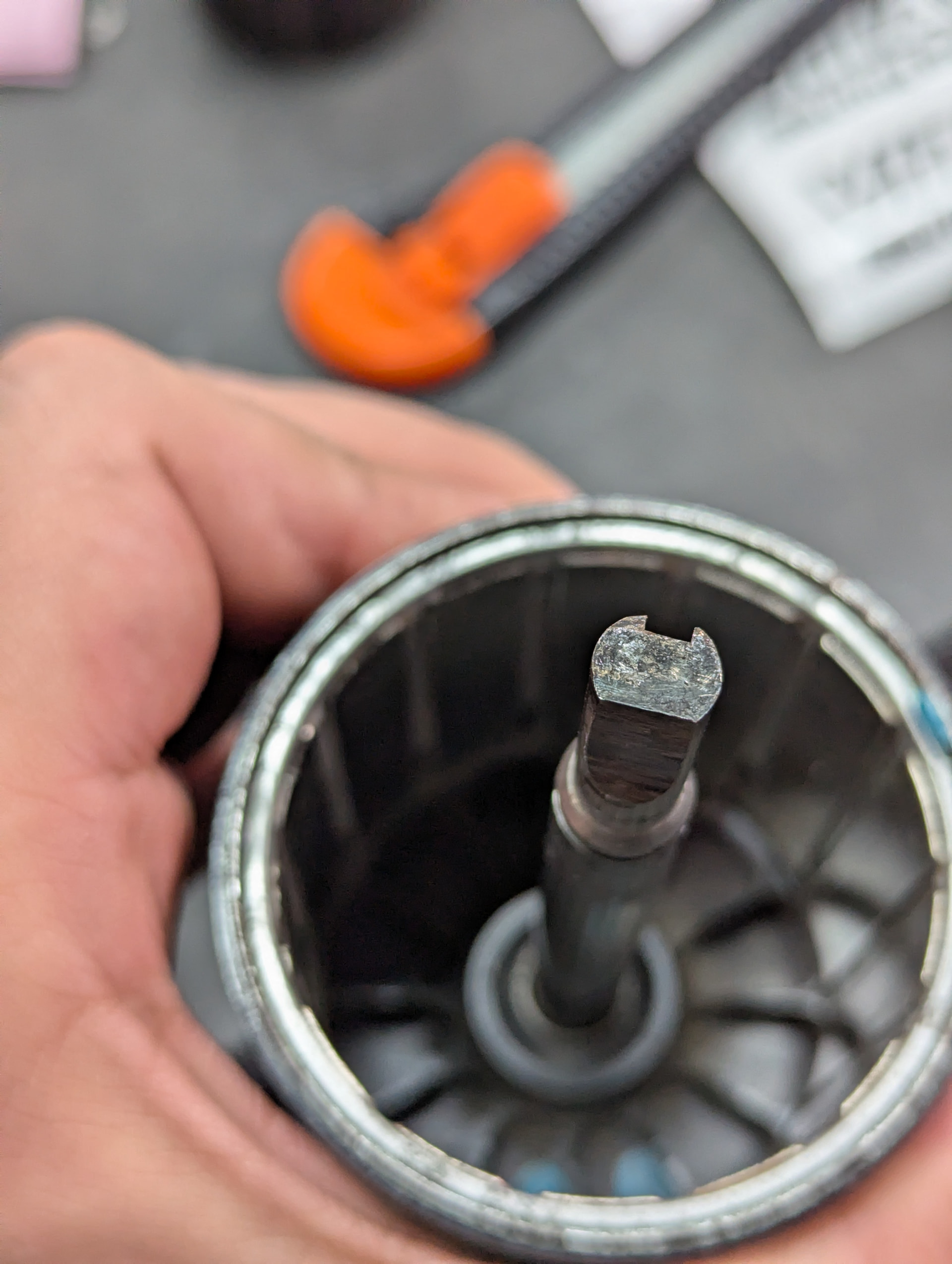

Why not just take a little more out of the keyway? This is rustic
My idea is that I can go back to using a keyway if needed.
I wrote these motors off already. They’ve donated their body to science.
B shafts for science.
I was thinking about laying a high speed bit in the keyway or sanding off the first few threads of the grub screw. For now i crank down the grubs with a pointed end and that works ok.
B SHAFT! HAHA that’s genius and what I will be calling it for now on.
Serious question. Why don’t motors just come with a B shaft, because then it works for either type.
