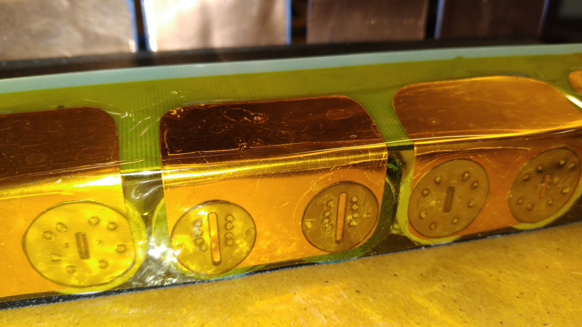

But I do not have those fancy round slotted SS pieces (where to get those?). For now I use SS strips to sandwich. From there it is easiest to have longer SS strip protrude the underlying copper and use this end of SS strip for connecting the balance wire to.
Nelvick hooked me up with those laser cut slotted SS circles.
I have gotten decent at cutting circles with tin snips but laser cutting just looks soothing.

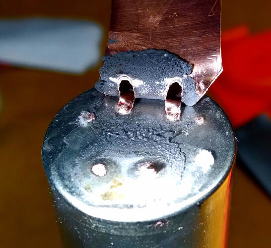

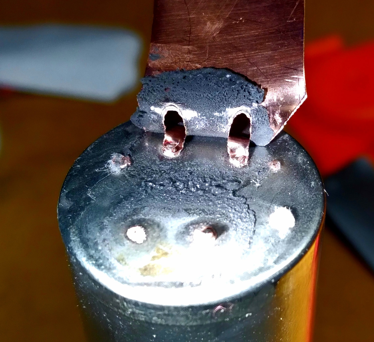

I have attempted to weld 0.25mm copper, under 0.1mm stainless steel, without flux, and set my AwZ p20B welder as high as Gear 930, 0.15ms preheat, 02ms intermittent, triple pulse with a 0.2 interval between weld pulses.
Rolling this combo off of a Samsung 50E can was deforming the can, but it did Not leave torn copper on the cell. There was some copper left on it. Enough that flush cut nippers were able to get it and shoot it across the room. It did take a lot of force.
It Did not feel like it hit hard enough to actually weld it, so I was surprised it was stuck so hard and deformed the can. Also, one weld was stronger than the other which I feel is another indicator that more power is needed. Would gear 990 do it? maybe.
Would this be strong enough of a weld for Non Esk8 applications. I believe so.
Will I max out the power of my machine every weld to forgo the flux in order to weld 0.25mm copper under 0.1mm stainless? No.
So I busted out the flux and went back to double pulse and down to gear 650. Not enough.
Gear 699. One great weld, one kind of weak, similar to the fluxless gear 930 welds.
Gear 739 two equal great welds on a JP40 can.
The stainless shears off when rolling the sandwich off, but both holes of the sheared SS are the same size.
I had expected a lesser gear to be able to weld this 0.25cu/0.1sssandwich with flux, as with 0.2mm copper under 0.1mm stainless steel with out flux requires gear 550, and with flux requires gear 385.
So if ā€˜gear’ is linear to actual power, then going from 0.2cu/0.1mmSS sandwich with flux to 0.25mm cu/0.1mmSS with flux, requires nearly double the welder power.
