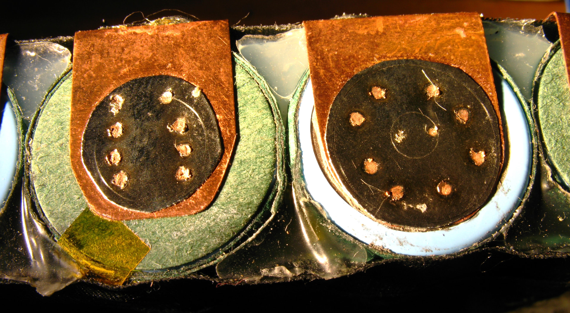

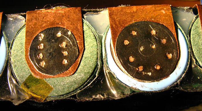

I have not been welding across the center spiral on the EVE 40PL’s. But doing 4 pairs of welds working my way around.
note the two smaller welds on top on the left cell are only from welding the Stainless to the copper with gear 008, before placing the sandwich on the cell and welding sandwich to cell at gear 385 and the same for the center of the cell on the left.
I have not yet tried to weld across slots in both copper and stainless.
But I don’t think there is much concern. I believe the area between welds when flux is used, that it is basically soldered between welds, not welded. I do not believe this could damage the spiral central weld.
I could be wrong.

There is just the slightest signs of the flux tinning the copper adjacent to the welds, So I believe this power level is just barely reaching the minimum required.
I just returned it to 2ms intermittent and 0.1 second, and the weld was weaker.
Rolling it off still deformed the can though( samsung 50E).
It Still took a lot of force to remove but no copper left on the cell. My impression is 4ms intermittent and 0.2 seconds between welding pulses yields stronger welds, if strength is determined by copper left behind on the cell. The force required to remove being able to deform the can might indicate the power is enough.

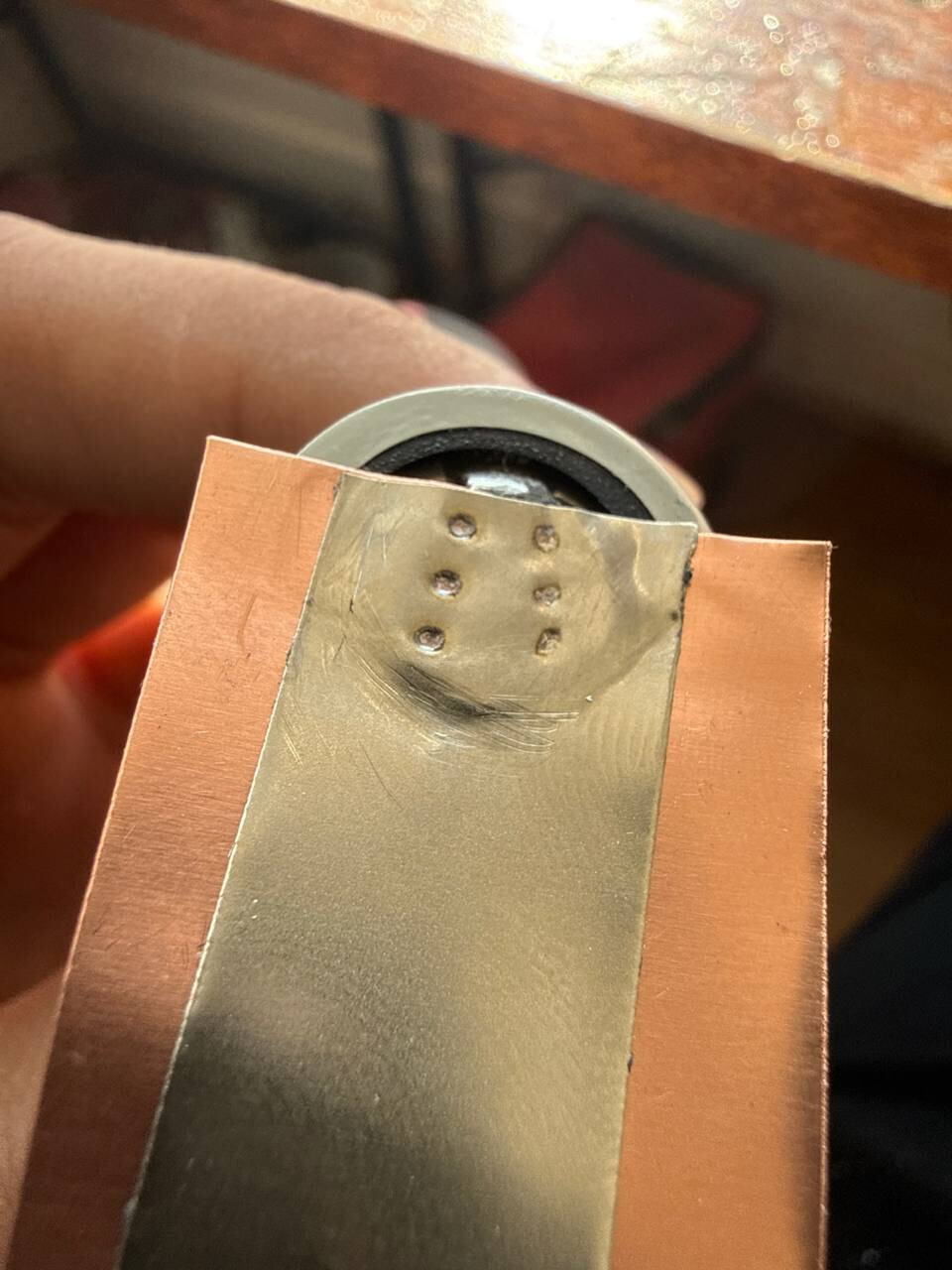

I tried to weld this on top of 0.3mm slot less copper stepping up the gear to 740, all other settings the same as post above
Not enough. Took considerable force to remove and then it popped off almost cleanly. two copper colored dots barely perceptible with a fingernail.
Gear 780 and one side tore the copper but the other side just a copper colored barely perceptible copper colored dot. So not enough.
The side which tore is not really big and wide enough that I would have much confidence in it, in an esk8 application, even if both welds were of equal size.
The tinning of the copper from the flux is almost a perfect 8, if both top and bottom of the number were equal sized
Stepped up to gear 830 and both welds same size and tore copper equally. Did not tear the NPS equally though. The copper is tinned in what looks almost like a perfect chain link around both welds. Very symmetrical.
I am not welding across a slot like I will be on Nelvick’s 0.3mm and the Kit’s 0.2mm NPS busbars when sandwiched, but it seems like:
AwithZ p20B
gear 830
Preheating 0.10ms
04ms intermittent ( pause between preheating pulse and first weld pulse)
double weld pulse
0.2 second interval between welding pulses, using flux, Is yielding Esk8 acceptable welds
on 0.3mm copper withg 0.2 nickel plated steel on top.

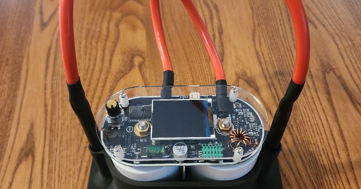

The cool looking capacitor powered welder on batteryhookup can do .3mm copper under .1mm stainless with no prep and no flux. Cheap.
Having some very good results so far with 0.1mm nickel over 0.2mm copper using the diy500amp flux. In this case I got good results with the p30c in gear 400, one pulse per weld, and 0.5ms preheat. Another benefit of the .1mm nickel is it looks to be thin enough that you can run a sharpie or other hard plastic tool around it to indent the pattern of the top of the cell into it for easier weld placement.
It can’t get better than that.
what percentage of the battery’s resistance is from the welds? I still am wondering the value of doing a couple more welds on each cell.

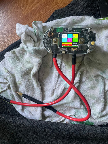

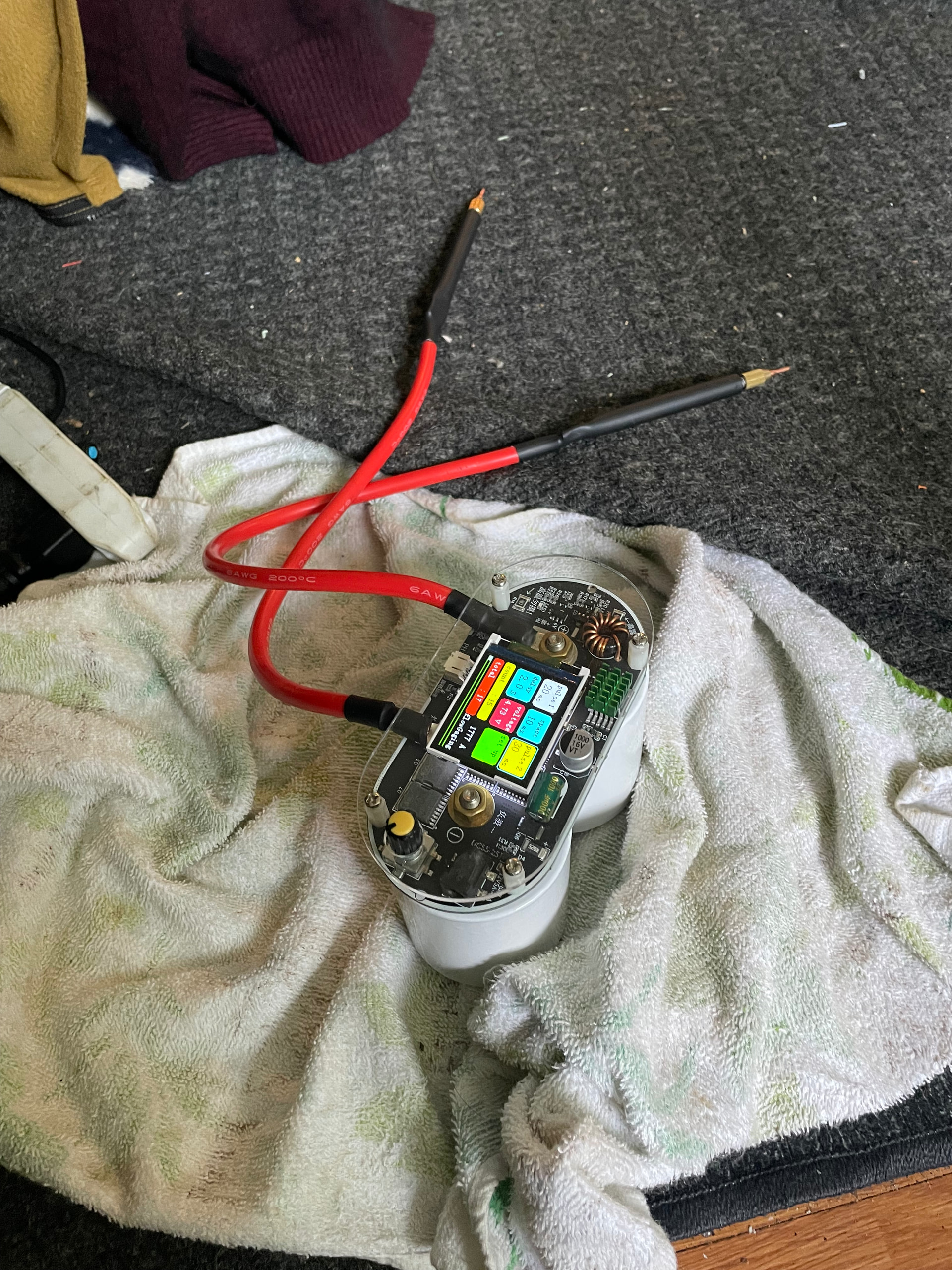

The batteryhookup welder rocks. crushes the Amazon black box I had. I’m freaked wondering can the probes short to the metal on the bottom of the big caps?
I have it wrapped in a towel after having two other welders short to electronics debris. Never again
Cool to hear this may be a viable unit for a reasonable price.

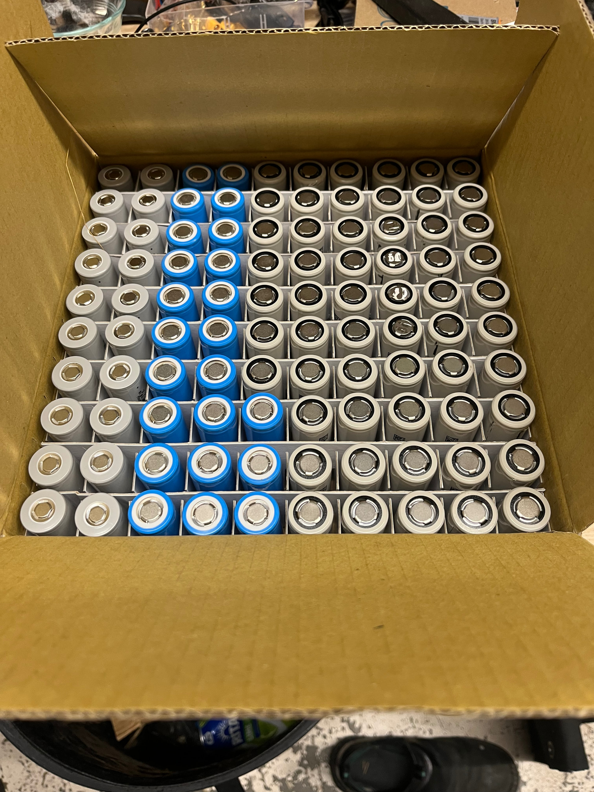

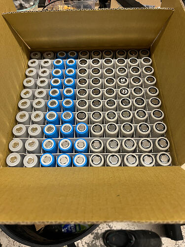

@BenjaminF got the loose cells and mis batched box! Thank you!
Going to start prepping for comparison tests for @Battery_Mooch.
Was thinking of doing 6 and 8 examples of each test i wanted all in .3 copper or .25 copper - but all the same. 4 welds. Two tabs per side per cell. So depending on how consistent they feel 3 or 4 cells for each weld process.
  • clean copper
  • With flux
  • With ss sanwich
  • Both ss and flux
Recording the settings for each set so a good reference for how much energy is getting pumped into the cells per each method.
Then i wanted to do nickel at 2,4,6 and 8 welds. weld comparison with nickel as i want max contact area on each and 2 tests per cell or three cells per weld set. So 12cells of weld tests to see If how area of contact and weld count affect the resistance.
Any suggestions for things to test or try let me know. Ben was very generous with extra cells to test with so there’s a few more than needed at present.

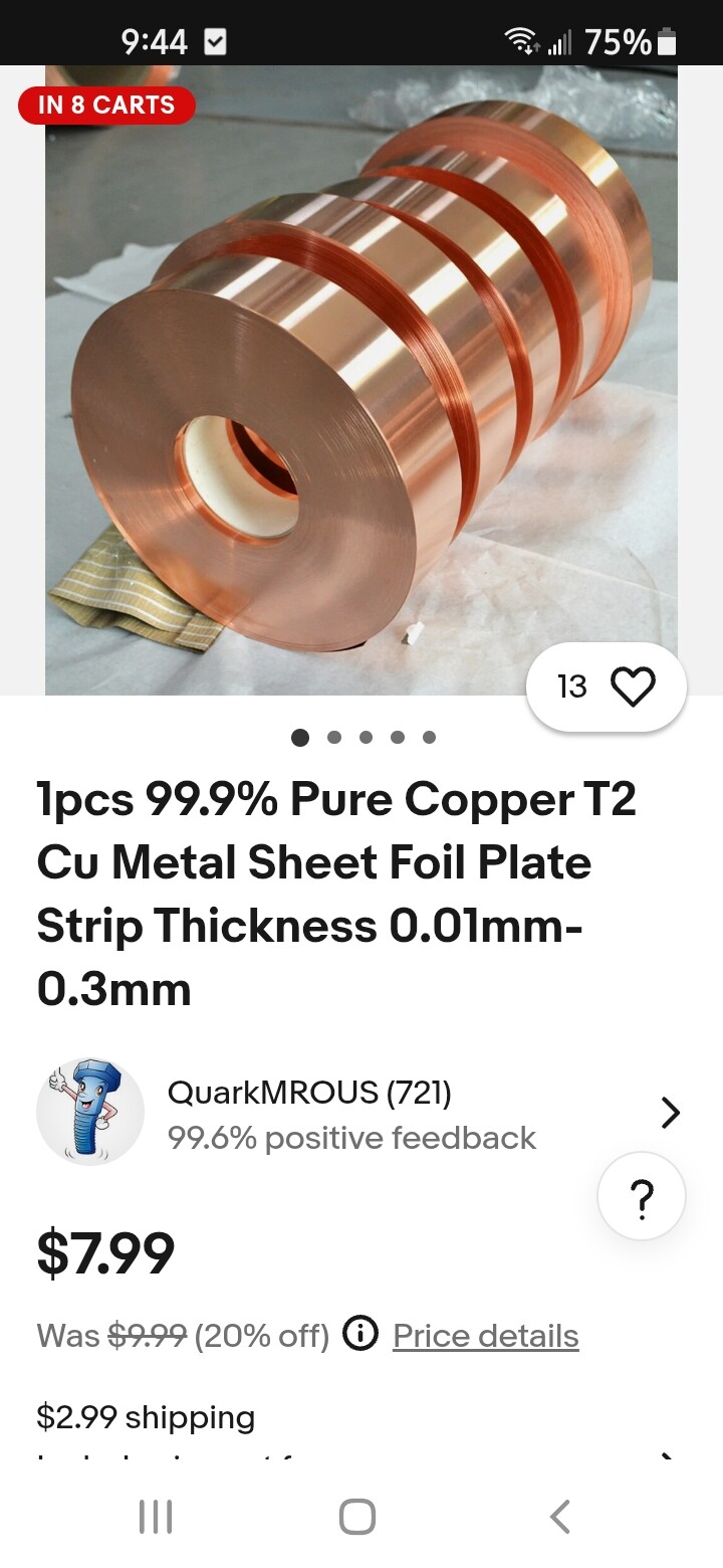

I just ordered a meter of 0.25mm thick 100mm wide copper, from ebay.
I cut my own busbars with tin snips.
Perhaps it is cheaper on aliexpress.
