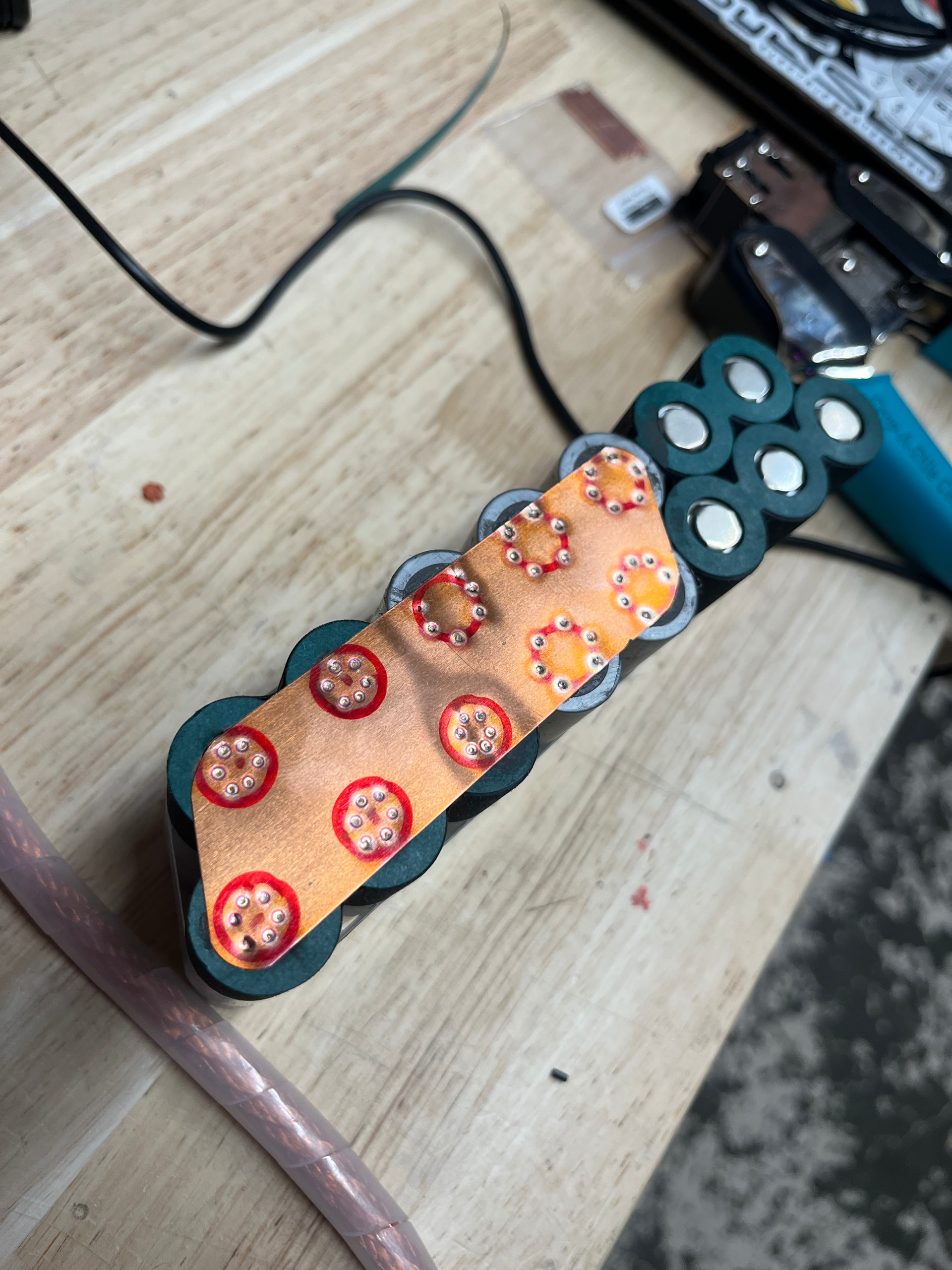

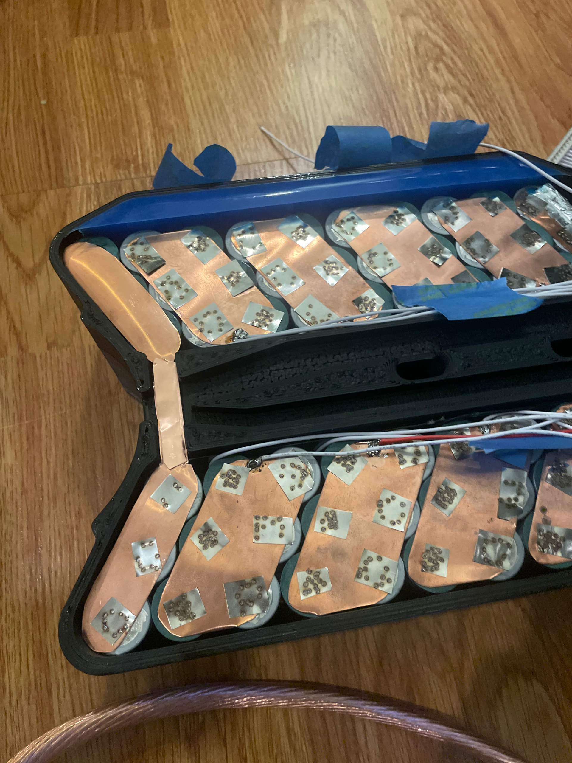

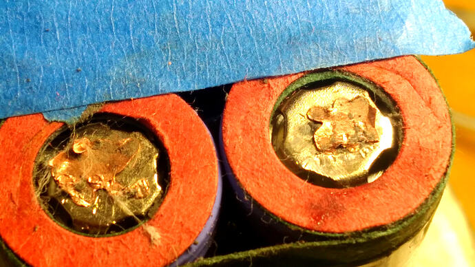

I recently rebuilt a 7S2P DMEGC20P prebuilt battery, with 0.2mm copper under 0.1mm stainless.
I screwed up the busbar between PGroup 6&7, and was able to use a 4mm sharp low angle chisel to wiggle pry lift the stainless steel off of the copper surprisingly easily, and cleanly, and then weld more 0.2mm copper on top of the 0.2mm copper.
Then, made the same mistake again.
I decided that both 0.2mm copper layers, under 0.1mm stainless, needed to come off.
I was impressed with the wide flat width of that lowest layer of copper strip.
No more chisel prywiggle possible.
I had to use dremel and grind the copper off, and it was still well attached to cell between the welds, dare I say flux soldered?
Yes, I am using 3 pair of welds on an 18650 Cathode even though this pack will likely see no more than 8 amps per cell in its intended application, and also added a second fishpaper ring.

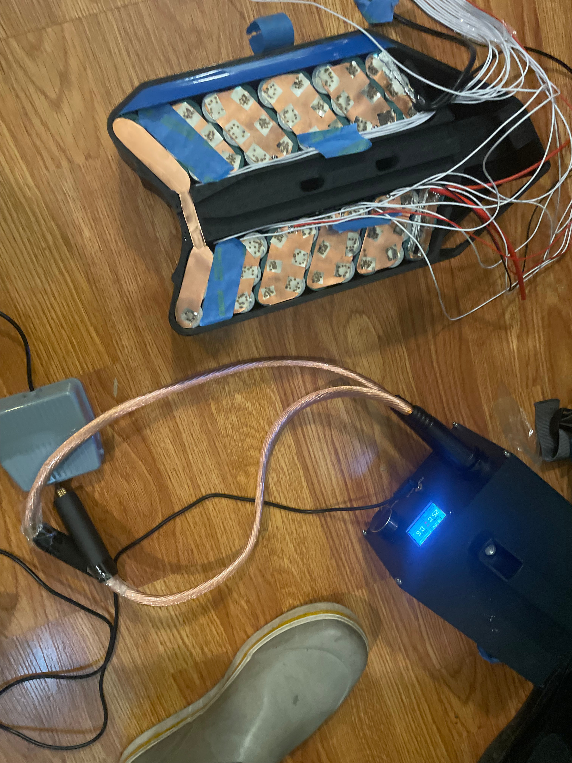

I did have one alarming episode of an unintentional welder double fire.
But my foot was still slowly lifting from the pedal.
I started being very deliberate in lifting my foot instantly…a quick stab of the foot, and did not experience a second double unintentional pulse.
For reference
I am welding 0.2mm under 0.1mm stainless, using Nelvick’s Flux.
AwithZ P20B
Gear 389
0.10 ms preheat
4 MS intermittent(delay before first weld pulse)
Double pulse
0.2 second interval between weld pulses.

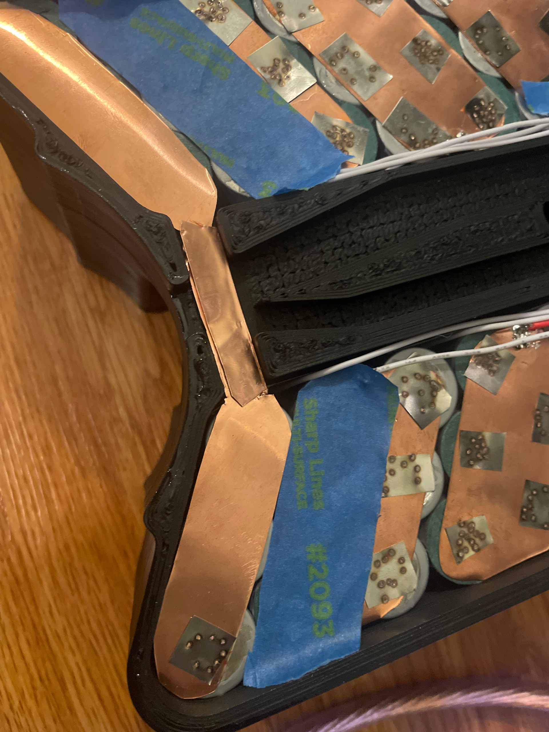

The relative ease with which the 0.1mm stainless could be chiselprywigglelifted from 0.2mm copper below was interesting.
I used the same welder settings as above to weld more 0.2mm copper on top of the destainlessed 0.2mm copper.
That first layer of copper strip seemed to be pressed extra flat and wide to the cell, similar to the 0.5mm Stainless experiments.

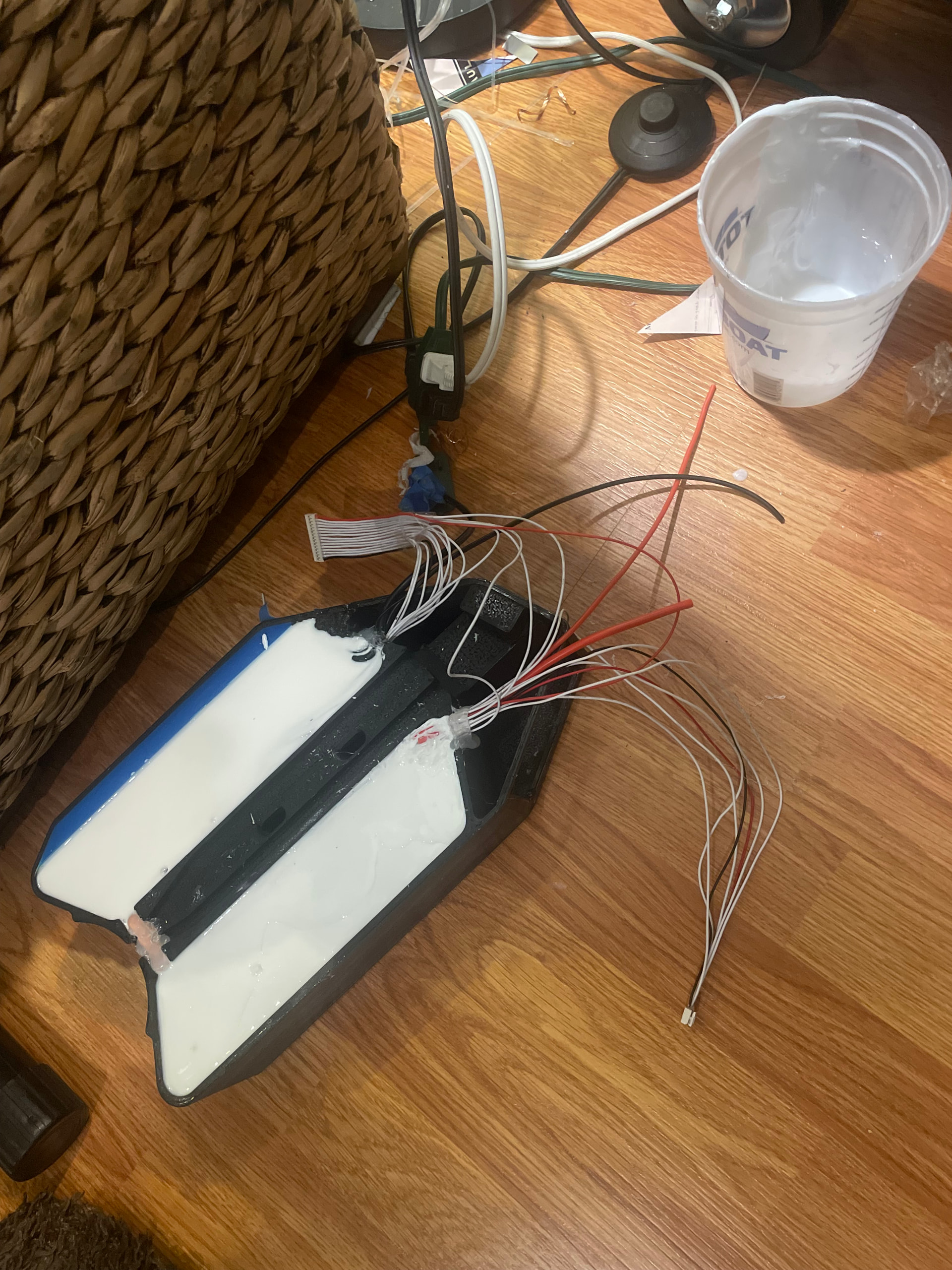

.2mm copper under .1mm ss w/ no flux. Potted in 60d polyurethane.

I noticed this same tendency when I welded 0.2mm under 0.1mm stainless( with flux) , removed the stainless, and welded more 0.2mm copper, 0.1mm stainless sandwich to that original 0.2mm Strip. When I tore off all three layers. That copper on bottom was wide and flat and adhered to cell as if soldered between the welds.
Tearing off just 0.2mm copper under 0.1mm stainless with flux, the copper does not appear to be attached strongly anywhere but the welds, but the 0.5mm stainless seemed to press and hold the copper flat and wide and perhaps even solder the the copper to cell between the welds.
If this is happening then the resistance between cell and strip should be lower and measurable with the quality instruments Mooch has.
