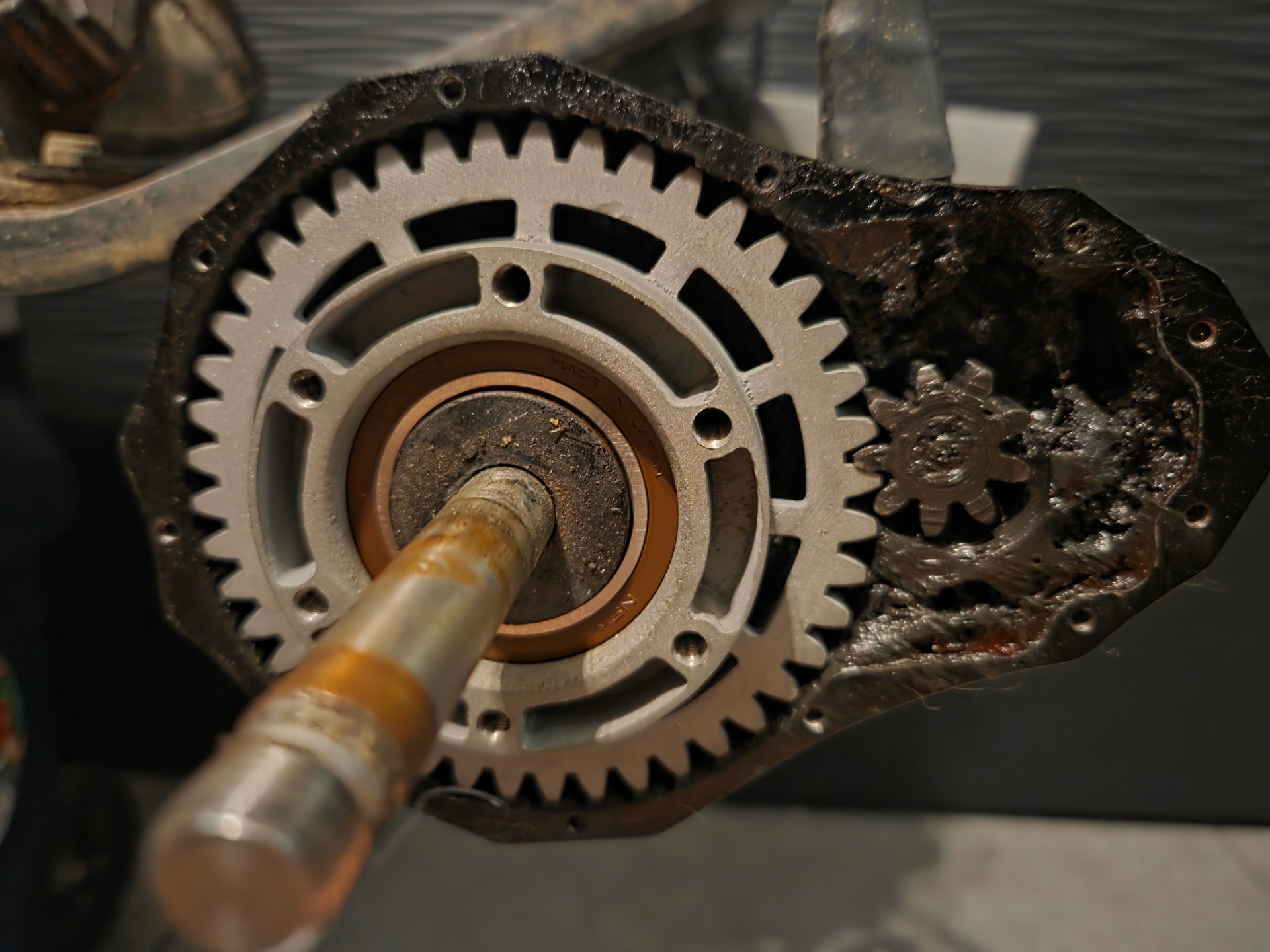

👾 Space Invader - Venom's 4th Build

We’ll see if the weight reduction on v2 changes the pitch at all

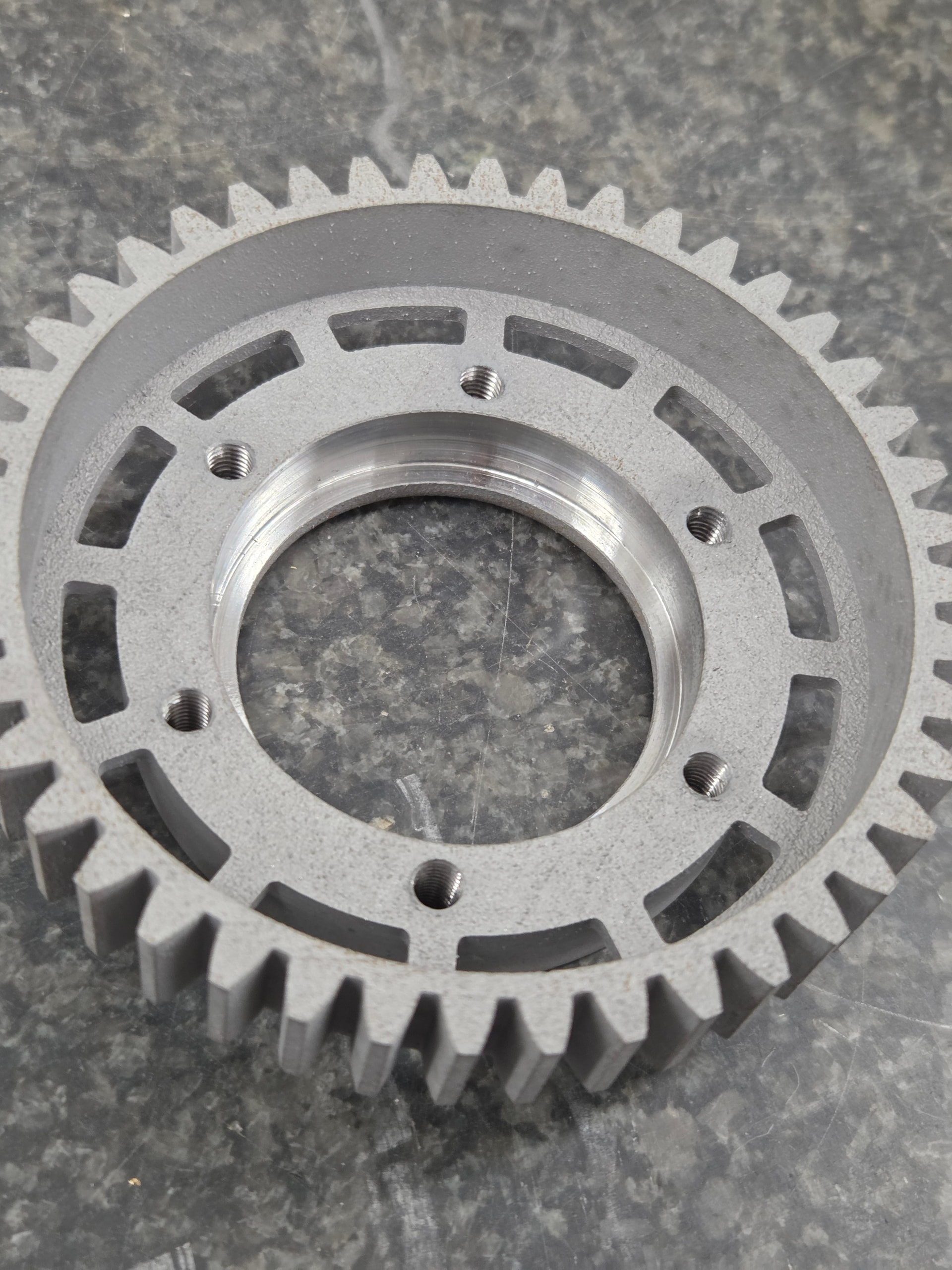

V2 has arrived! They are much lighter… coming in at 226 grams this time around.
$175.30 total with shipping
$20 for tapping
$21 for import duties
So $108.15 per gear all in

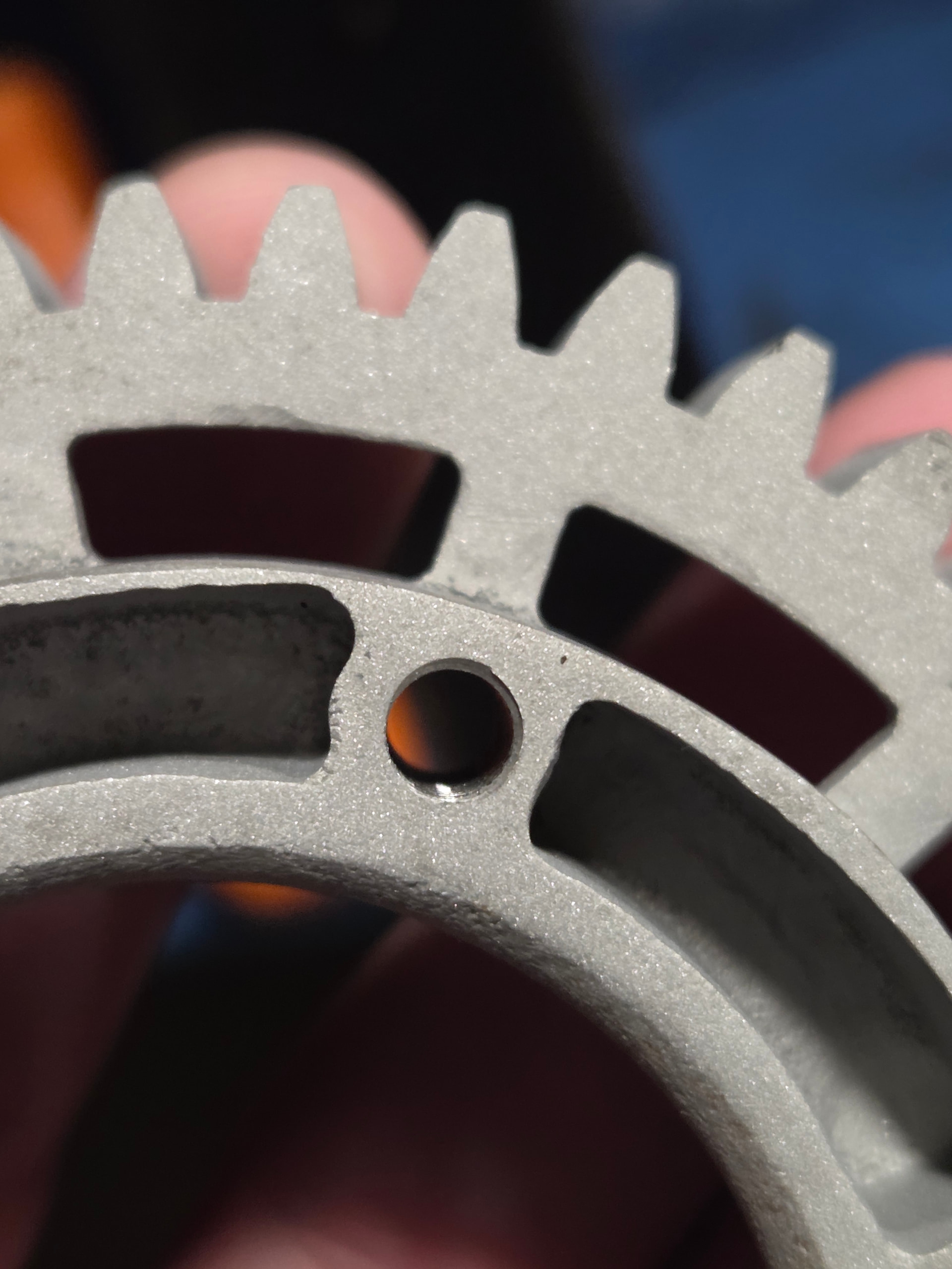

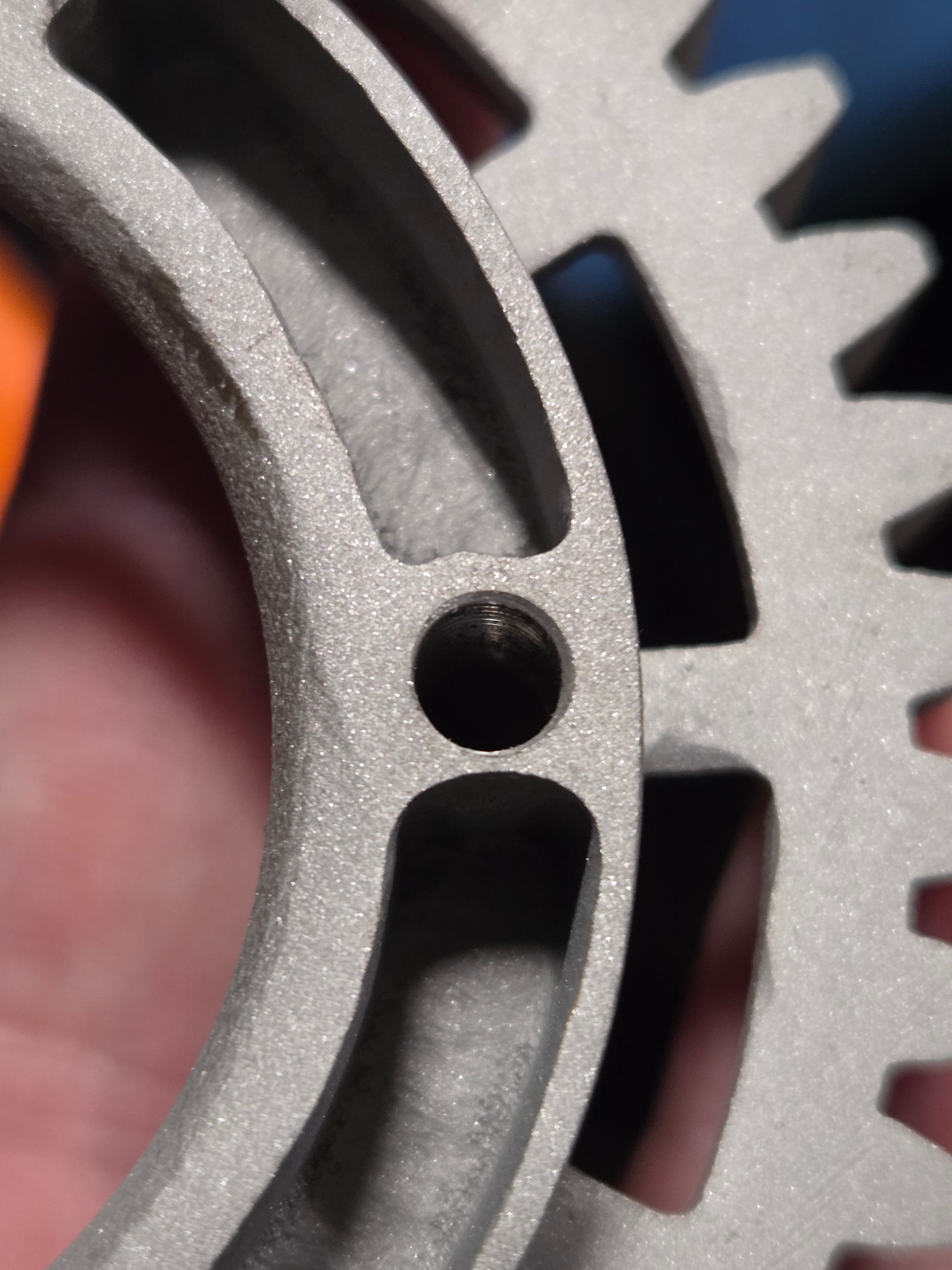

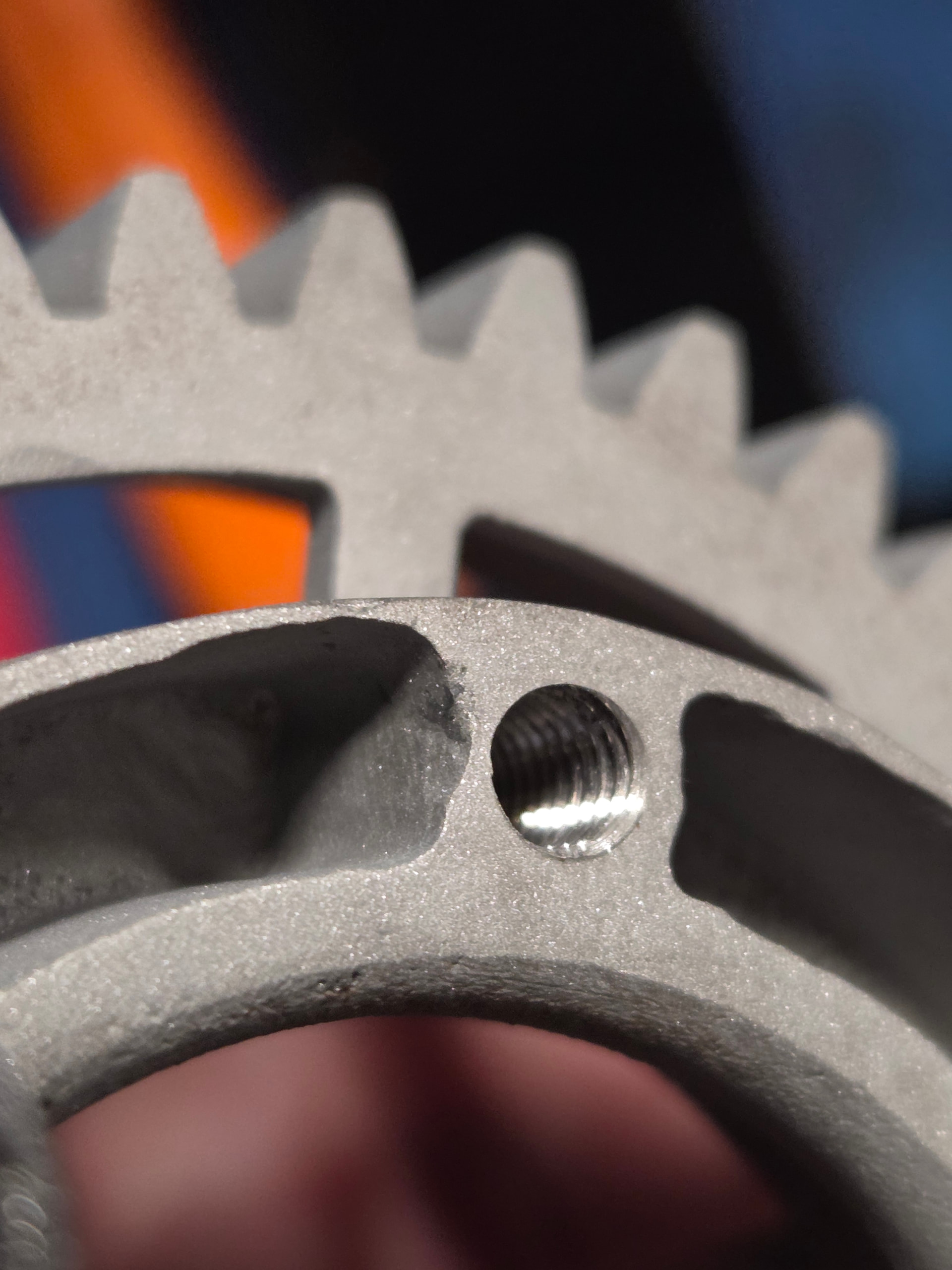

I did notice some imperfections this time around to consider. The hollowed out areas around the threaded standoffs are varying in thickness at the tips. I’m not overly worried but worth noting.

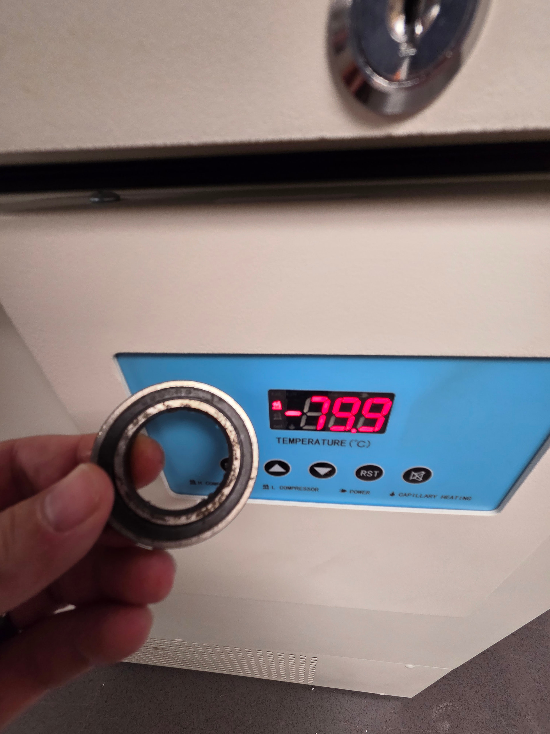

Bearing seat is still too tight to hand press in so in the - 80 C freezer it goes
Freezing at that temperature actually solidified the grease :grimacing:
It made a ton of frozen droplets on the outer surface of the bearing as well. It went in but when it equilibrated, the bearing was rolling crunchy.
So back on the lathe it goes to get that rough finish cleaned up. Took off just a hair (less than a hair to be technical) and we’re golden
No rattle, just a bit of pressure to seat correctly. Should be back rolling in no time. My deadline is still a few weeks out:

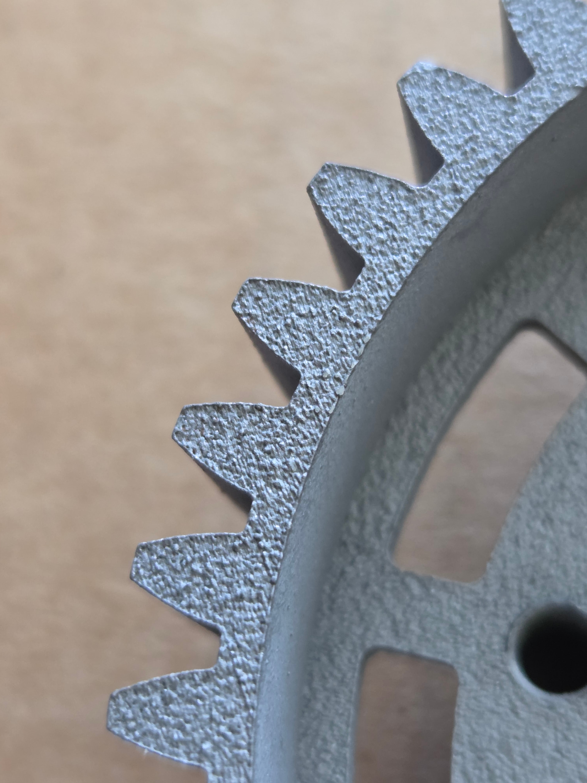

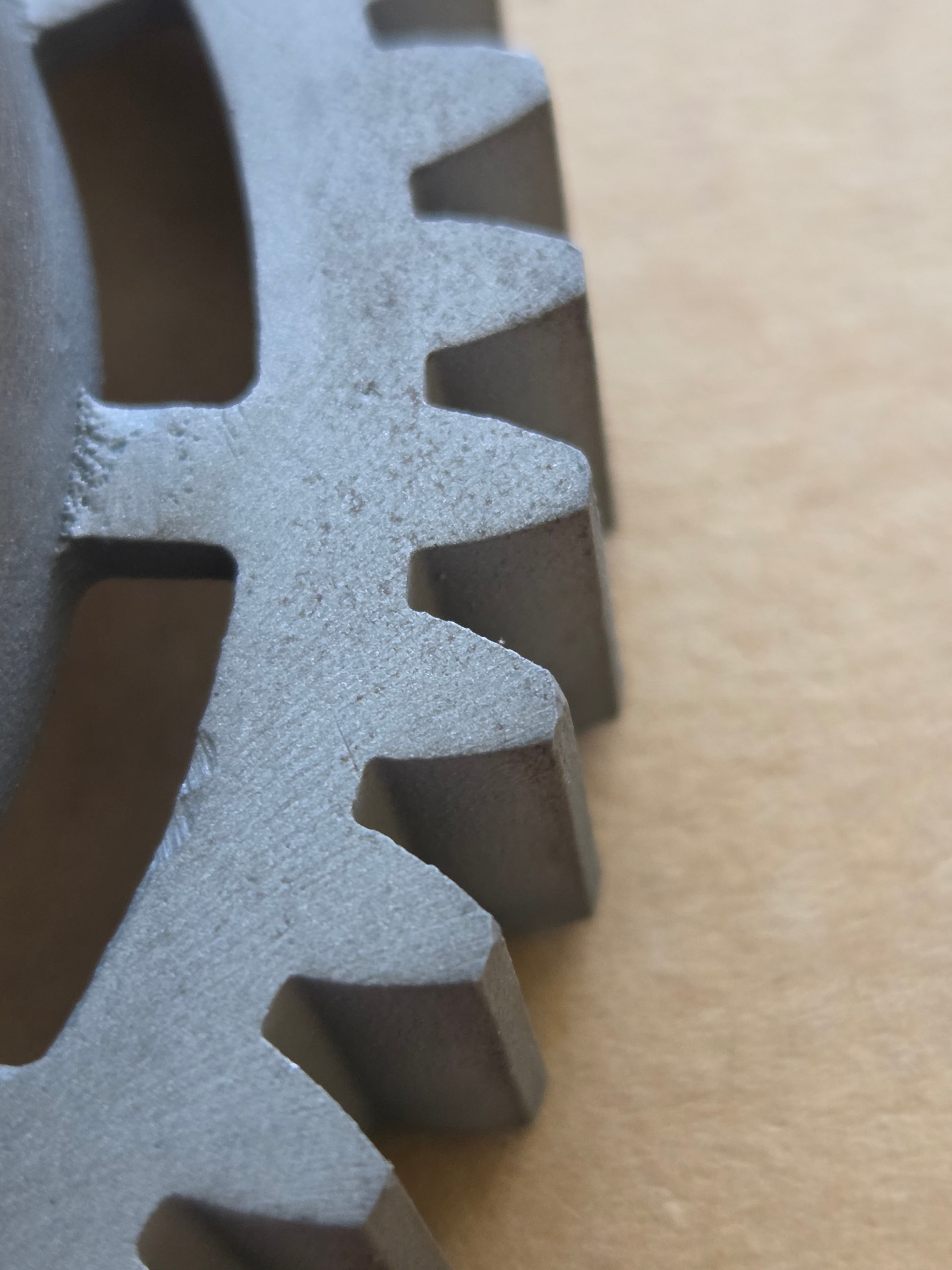

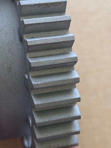

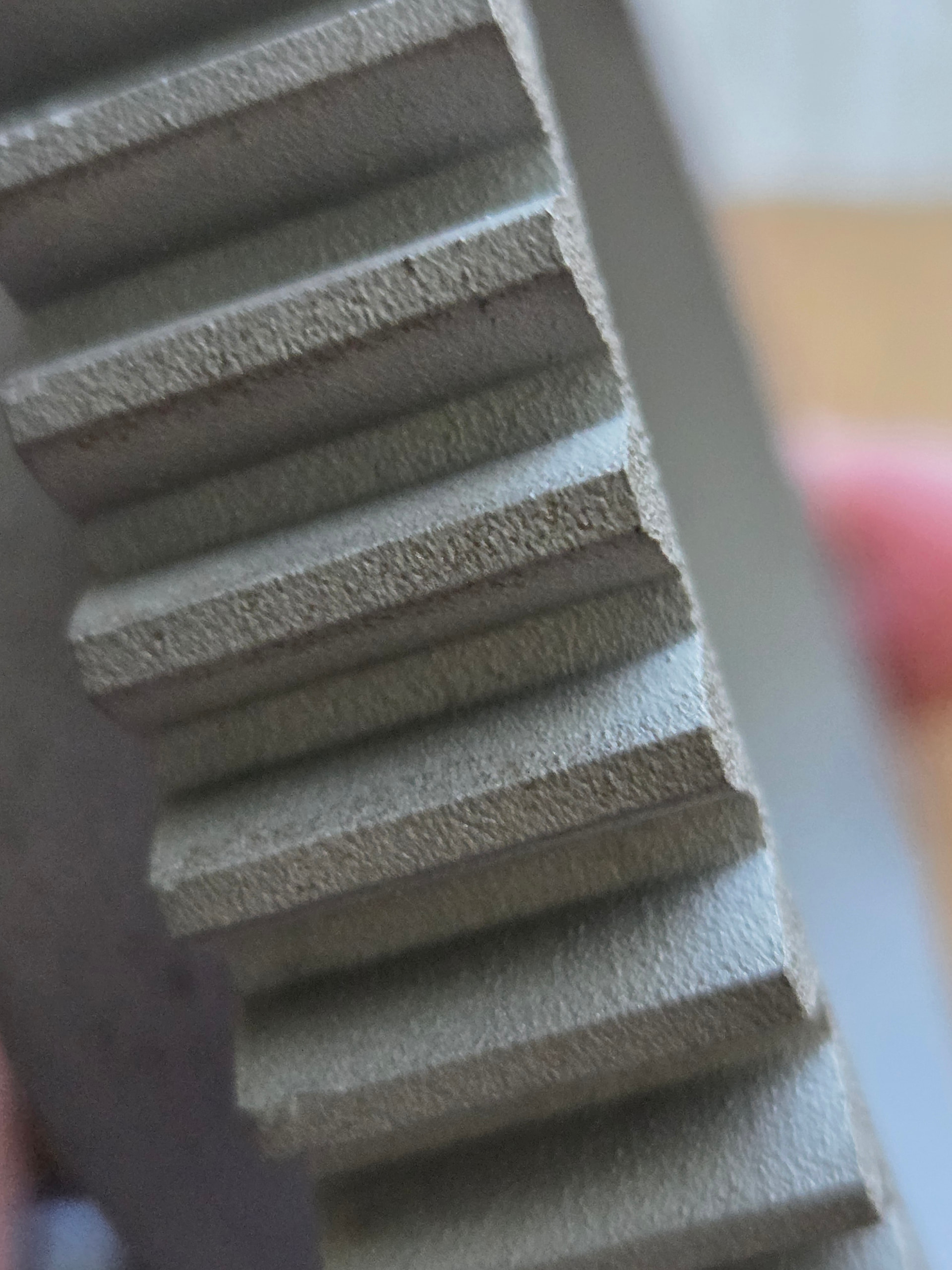

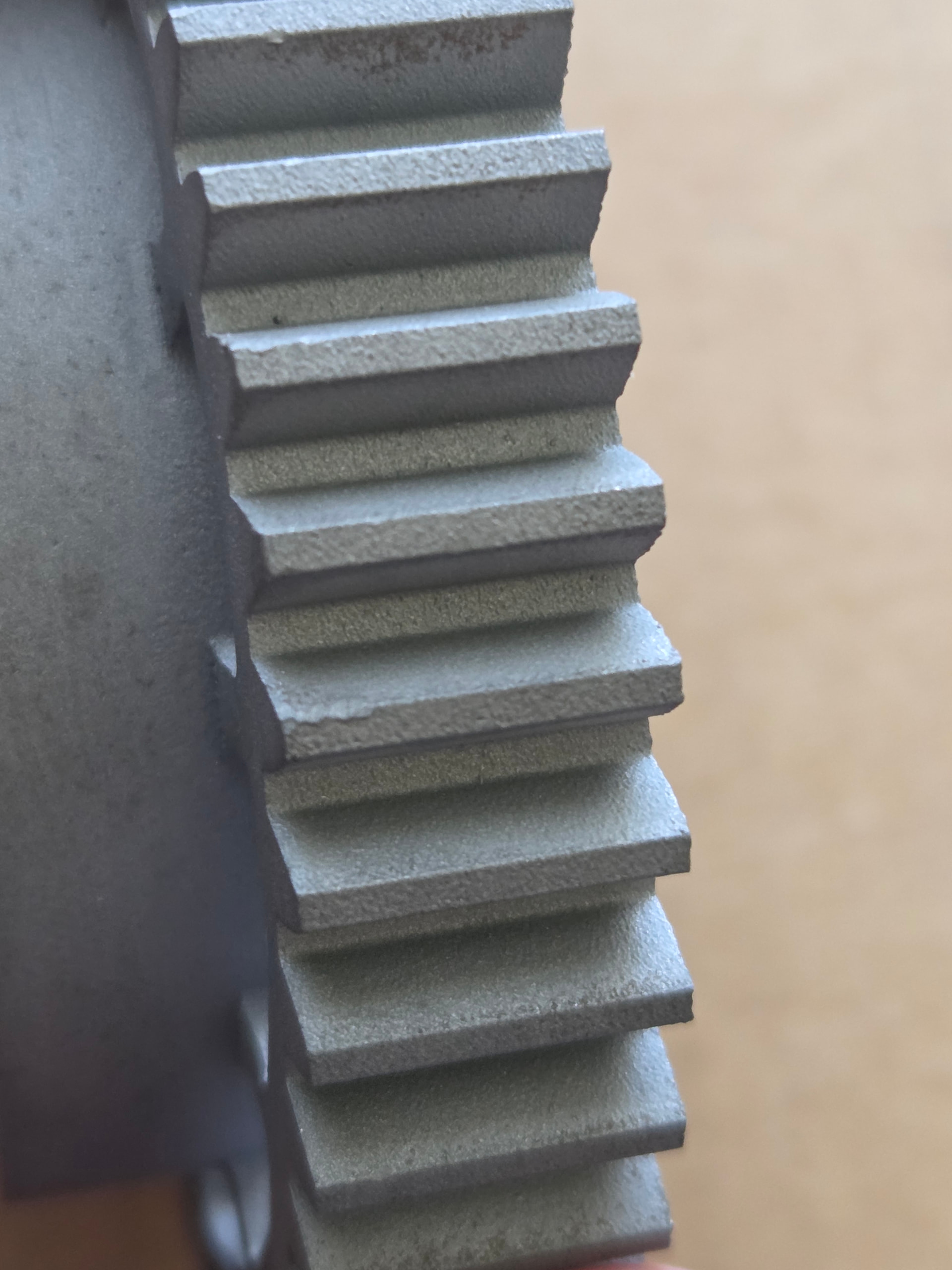

Can we get some close-up shots of the tooth surface quality? I’m still trying to decide how small I can make the teeth on my gear designs and still have them printed with enough resolution to work right lol
Bed face looks to have a bit more texture to it.
Hmmm so I threw these on our Rockwell tester and am getting 26 HRC. That’s pretty soft honestly so we’ll see how these hold up. I do not believe I have the capability to heat treat these further.
I wonder how much of that is just due to the porous surface finish? Idk much about hardness testing, but I’d imagine that could play a role depending on the scale/depth of the porosity
Yes you are correct. I was getting 18 hrc originally. I stoned down the faces to sit flush and it got up to 26. I think I could squeeze a few more out of I stoned it a bit more.
Way harder than POM still :joy:
