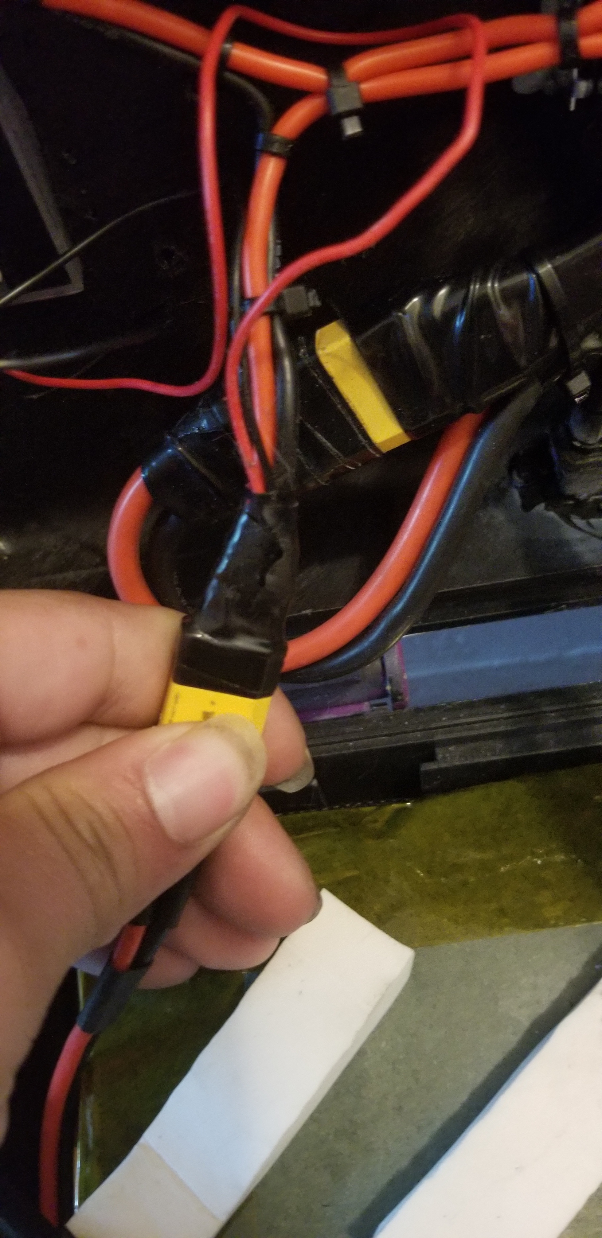

For me, it’s on my led battery. Its tucked in between the connector and the plastic surrounding the connectors. Heatshrinked over each wire and tape for good measure.
My daughter tripped last weekend and landed her hand directly on my iron while I was about to solder them. Result: hospital for bandages and wife confiscated the iron till her hand heals :frowning:
So its in the xt connector but where the red and black wires connect to it. Thats what your saying right
Yes. I wouldnt trust trying to squeeze them in between the Male and female connectors. Vibrations could cause the connectors to slightly disconnect and cause arcs of electricity. Add to that mix wires that shouldn’t be there and you’ve got a plastic burning fire

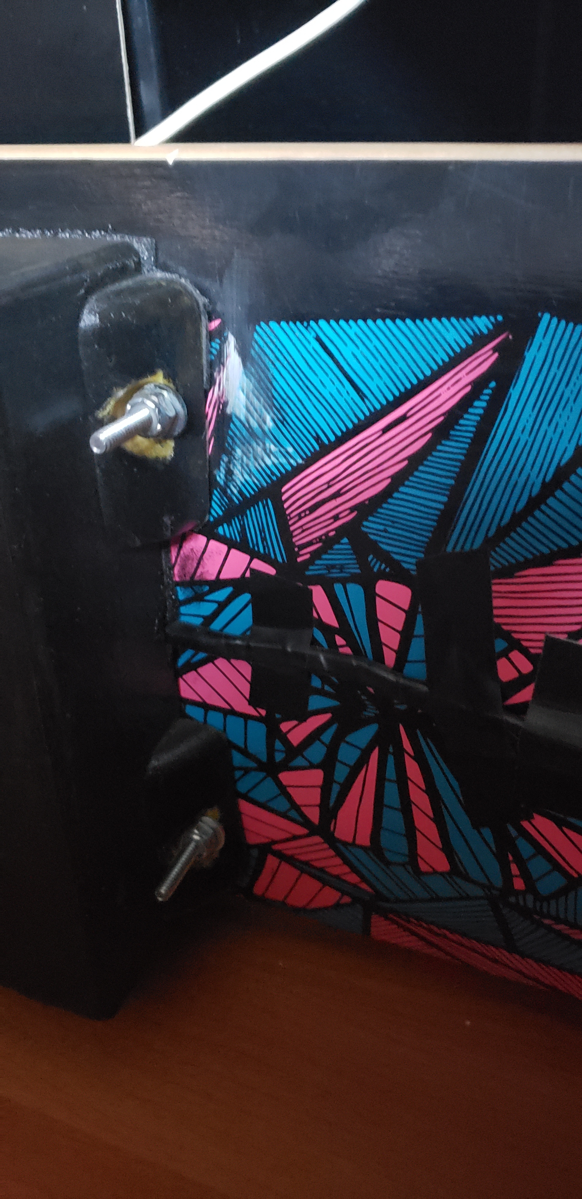

Would it be safe to tap at this point of the wires
Battery is in that box.
Im repainting everything but was going to try without taking off the board cause, well, ive changed deck 4 times in 2 weeks and tired of seeing the bolts up close lol
No, you wouldn’t want that to be sticking out in the open
It is just asking for something to get caught on it, it would be better to have it well insulated and within the case.
