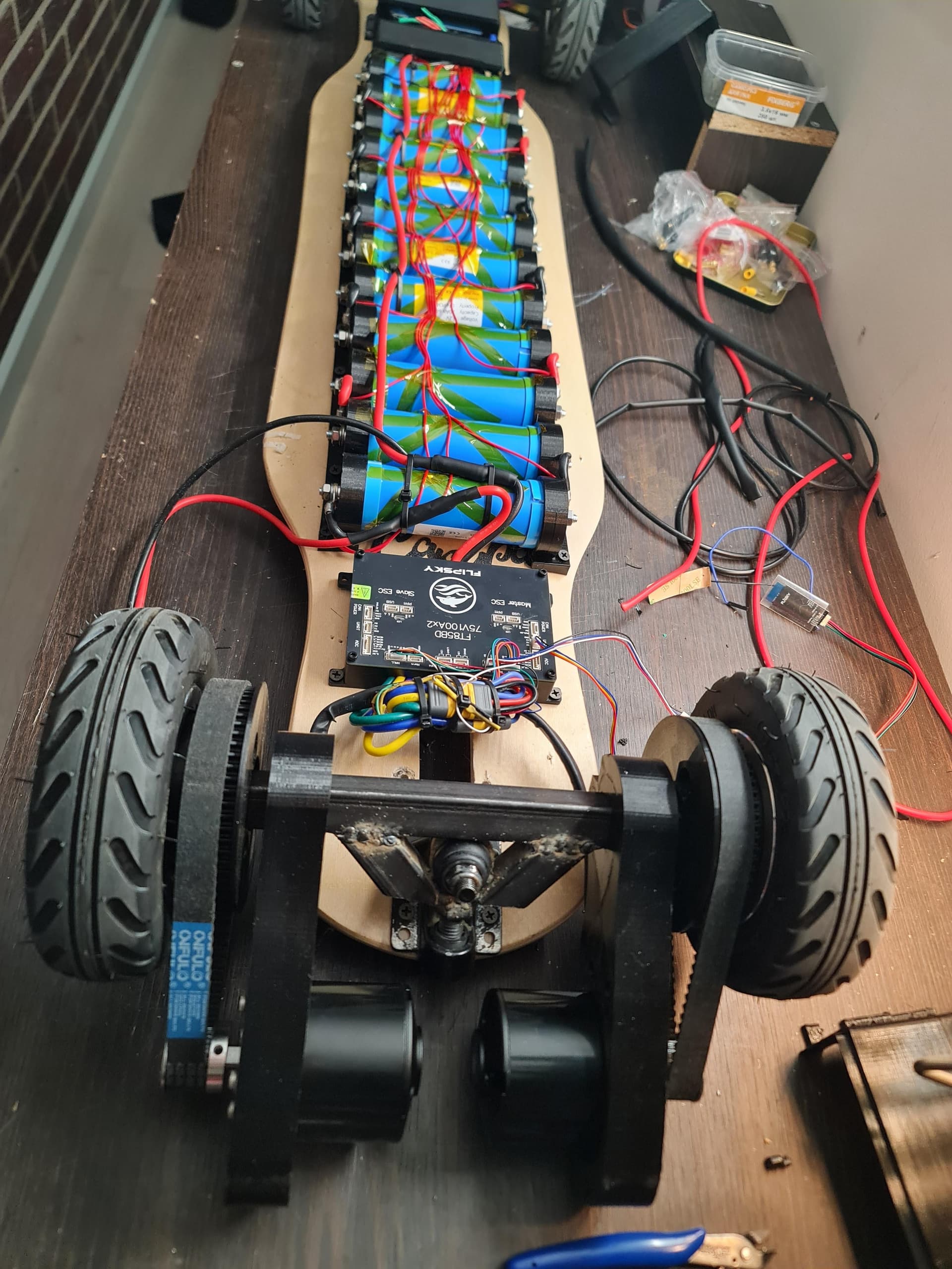

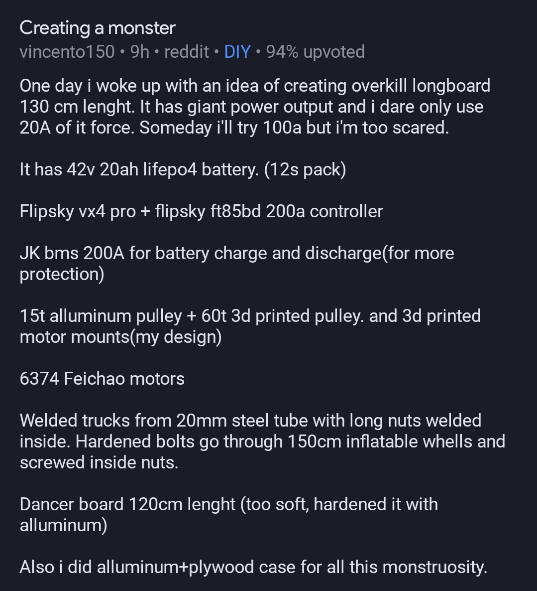

I always wonder what these guys must feel when they see this forum after building their ā€œoverkillā€ board
The appropriate reaction would be stoked because there’s so much information here they can kill it on the next build without stumbling in the dark. Probably depends on the person though.
Probably think we’re psychos for riding such powerful boards. That said, I’m still riding my first truly powerful board with the motor amps turned down to half what they could be, and equal to the battery amps. I haven’t tried for a bit, and I’ve definitely gotten more comfortable with full throttle at the current power level, but I’ve never managed to actually gun it turned all the way up without causing an uncontrolled wheelie/manual or some other mishap. Right before I hurt myself, I was planning to see what I was actually doing for 0 to 30 mph, but I’d guess I’m somewhere between 3 and 4 seconds, and there are people doing it in less than half that.

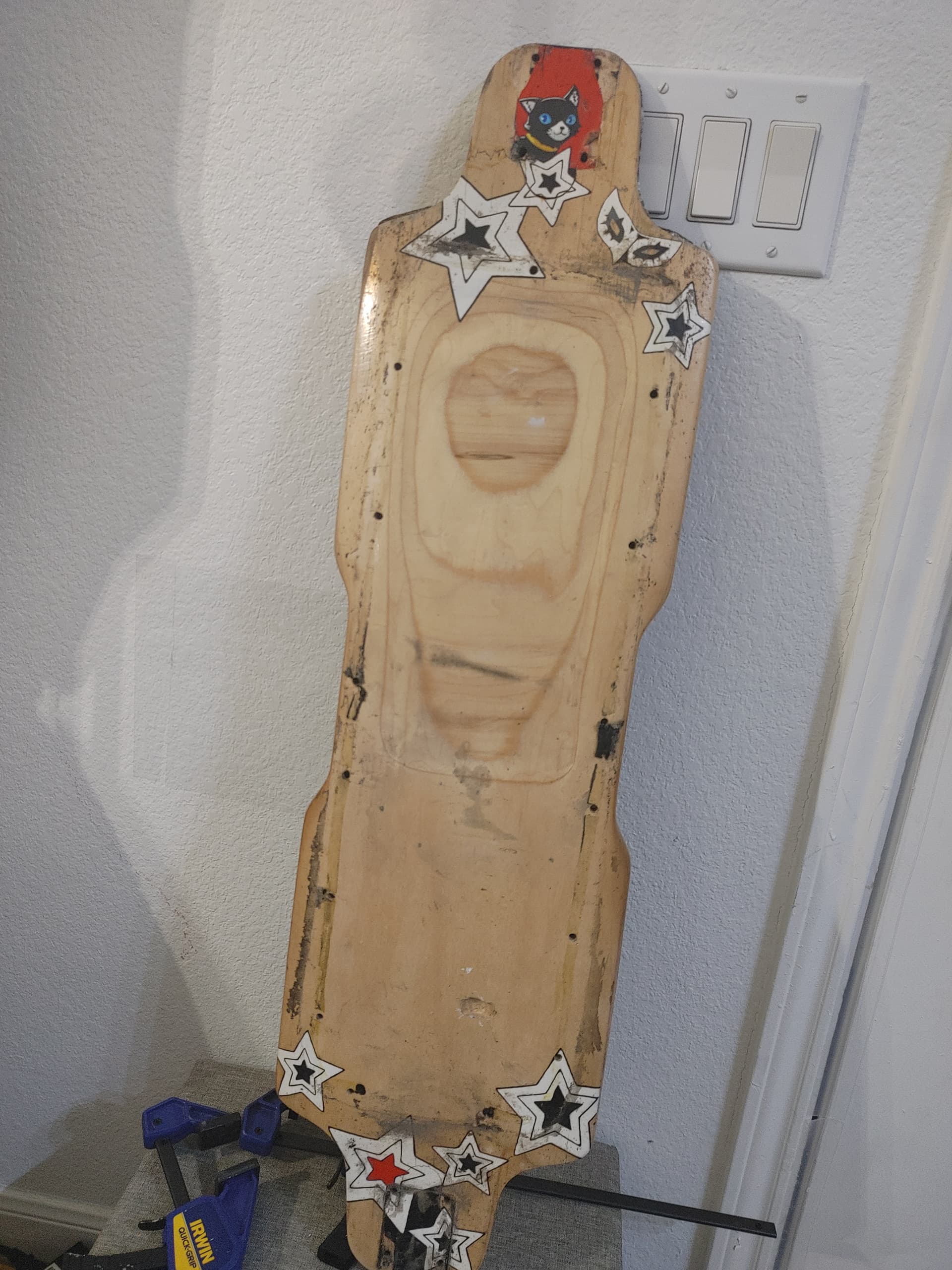

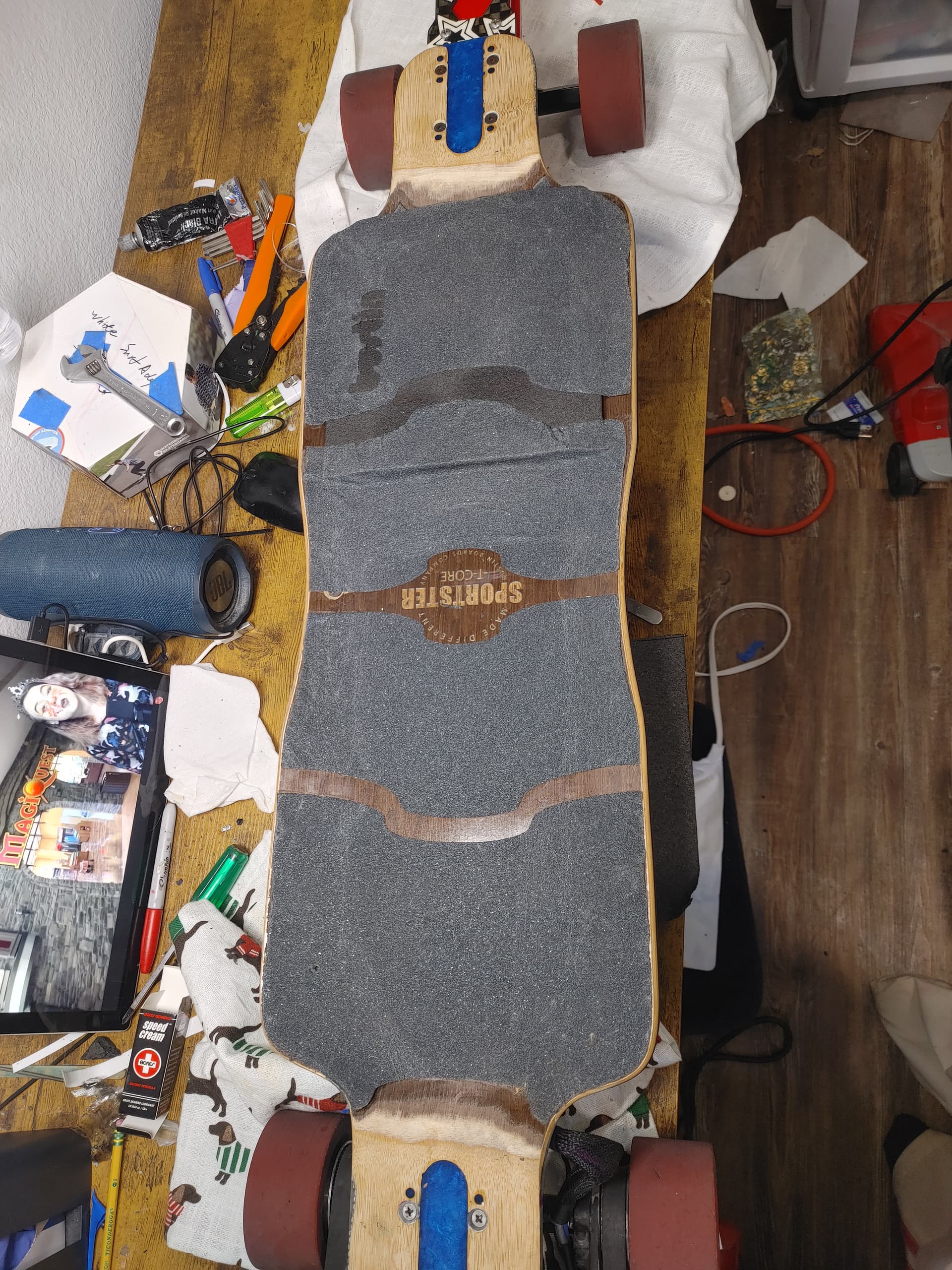

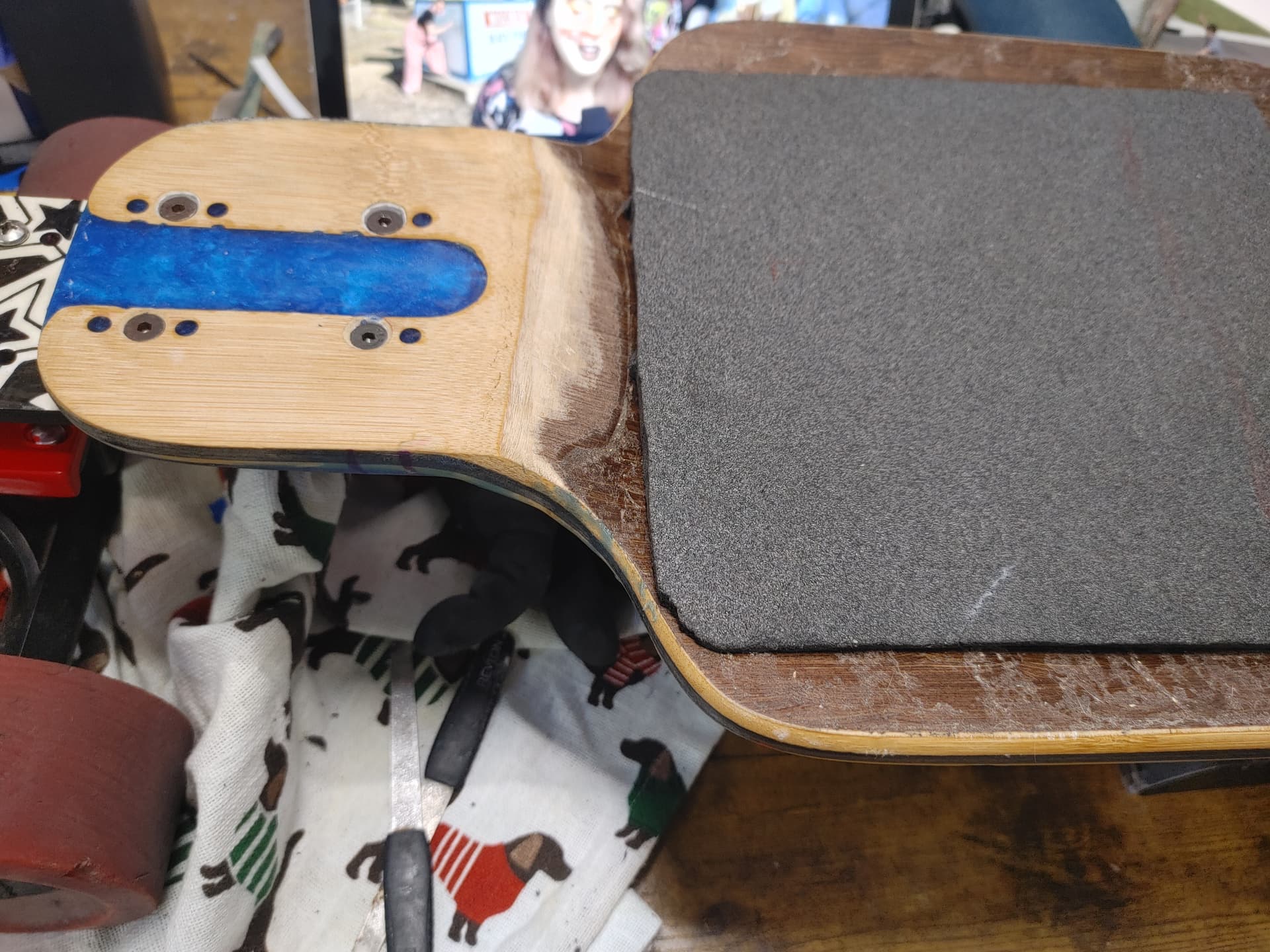

All you need is wood glue and some clamps to fix a broken deck :rofl:
Proof that is safe via animal testing :rofl:
I really hope this is a joke. Put a skid plate on the bottom of the enclosure and wear elbow and knee pads and a helmet for when it breaks again, which will be immediately.
It is a joke. I glued it back up to make removing the enclosure easier and because I painted the deck so I want to keep it in one piece. I need to clean off the road dirt tho
I wouldn’t even risk standing on it indoors on carpet with trucks bolted on.

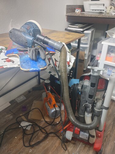

This isn’t actually shitty DIY if you don’t care about your vacumm
If it is your only vacuum then it is shitty diy since who knows how long it’ll tolerate being used for dust collection.
Gotta add strength to your deck with some roadside foam and hot glue :rofl:
I did find the foam on the side of the road and it is held on via hotglue and grip tape. Its there to fill in the extreme curve on the deck bc that caused severe pain in my feet. I’ll eventually fix it with epoxy and fiberglass. Might even top it off with a wood layer or thin veneer if I can justify the extra cost/ if it looks bad under grip tape
I dont understand you. You dont like how far the sportster drops down, so you added tons of fiberglass under the tip/tail to decrease the drop. You dont like the sportster’s concave, so you fill it in with foam and hot glue. You dont like the sportster’s construction and say it cracked without any use.
Why are you using this deck you hate so much and think is unsafe? Kinda seems like you’re setting yourself up for failure.
Because I paid for it alteady and couldn’t return it???Pretty simple imo. Not everyone on here has a ton of extra money to spend on esk8
The deck will go to my second board eventually. I called them out it being unsafe and then lying about the composition because it is something everyone needs to know about. Blatantly lying about a product isn’t acceptable and neither is using at least 2 layers of wood that are already cracked at a stress point.
I had another deck from them where the concave wasnt as severe. The dimensions matched the sportser so I figured the deck was the same. It wasn’t and I didn’t even know the concave would cause pain until I used it. I don’t know how I’d be able to predict that without trying it first.
I don’t get why you’re acting like I knew all that information before buying the deck. The store is at fault for not providing adequate information and specs on the deck
Not that I’d trust their specs when the claimed the deck included 2 fiberglass layers when it is fully wood only
