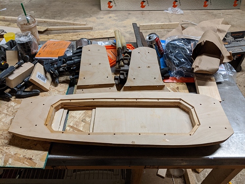

Apr 7
Enclosure space is mostly cut out.
Still need to add slots for custom ESC heatsinks, clean up the profiles, etc, but I’m almost ready for glue-up!
Brief process summary: drilled 1" holes with a forstner bit at key points, and cut between them with a jigsaw. The blade was a little dull and tore up the first layer I used it on but after I replaced it everything went fine. You can see in the last photo the drill bits I’m using as alignment pins to ensure consistent alignment during test fits and such.
Bonus sneak peek of the phase connector area… Still need to deepen the slot but you get the idea :stuck_out_tongue:

Over the past few days I managed to get the enclosure space cut out…
I didn’t want to update until I had wire channels cut in but I think I’m gonna wait till after glue up for that.
Pictures will be in the main post (Apr 7).
Next steps: clean up the profiles, and glue up!

So the weather was nice enough to do some of the epoxy work today.
Here’s a few photos of the pieces after glue-up. These will then need to be assembled and glued together to form the deck, which will then be sanded to the final contours and fiberglass wrapped for maximum indestructibility. I’m using west system 105 epoxy with 205 hardener 'cause that’s what was on hand at the time.

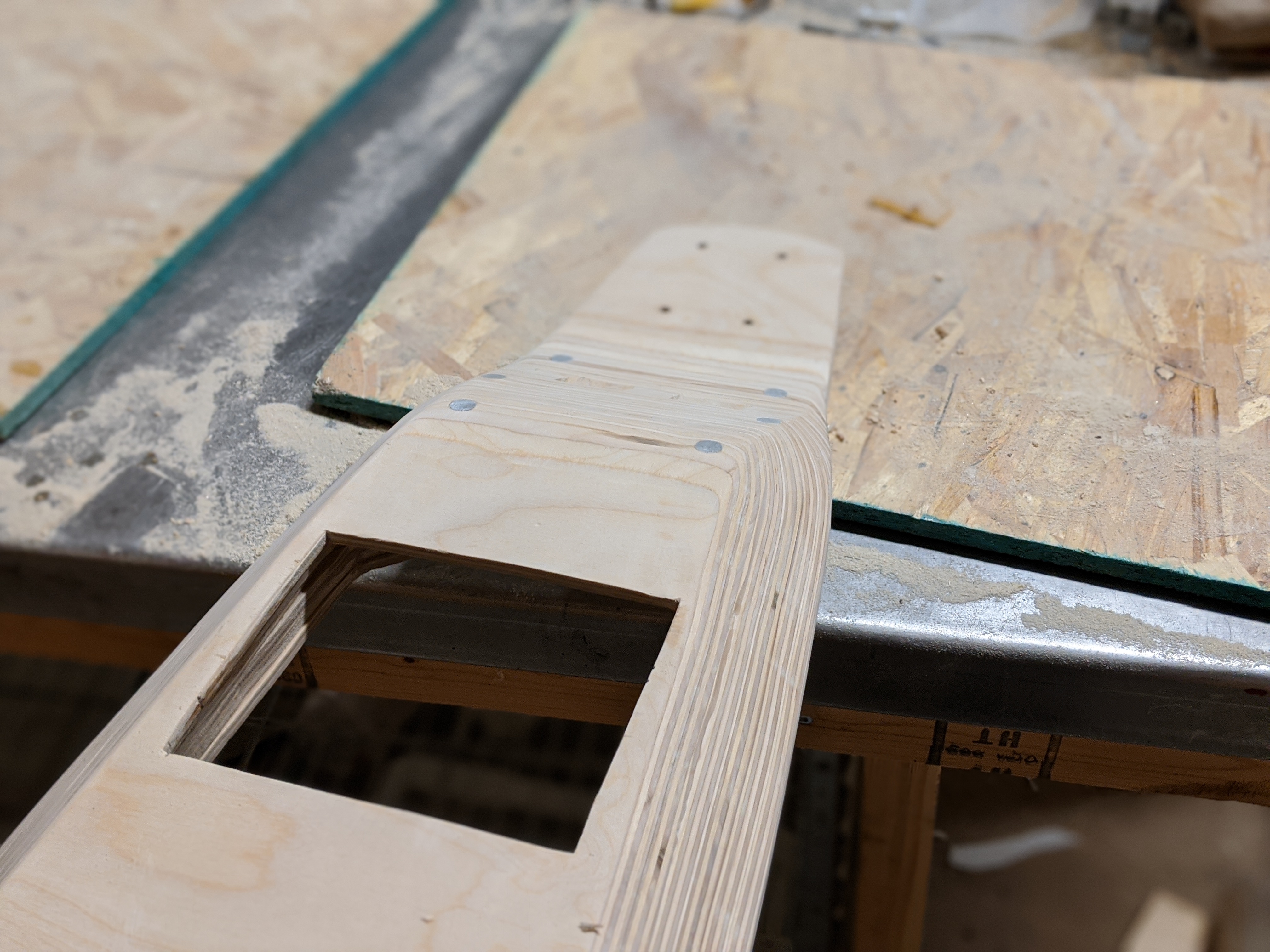

That’s right kids - major deck parts are finished curing. Ready to be assembled into the full deck.i literally did a happy dance after unclamping these babies. Couldn’t be more thrilled.

Are the two parts above the deck the tail and nose?
Also what wood did you use?
Will it show us the meaning of haste when it’s done?
Yeah, the two bits above are the nose and tail. I’ll be glueing them on soon as well as sinking 3/8" aluminum plugs through several holes to reinforce the joints.
The wood I used is Baltic birch, I think there’s about 80 or so total plys in the final deck.

So how did you fix those nose and tail.?
Is there any metal insert?
Excellent questions…
The nose n’ tail were epoxied on to the main body and the small silvery circles in some of the pics are 3/8" aluminum rods epoxied in vertically to relieve some strain from the joints.
Ok I see, be carefull, it may be the weak point of the design
WIll you cover all this with fiberglass?

Ya, all getting glassed soon.
