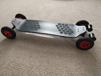

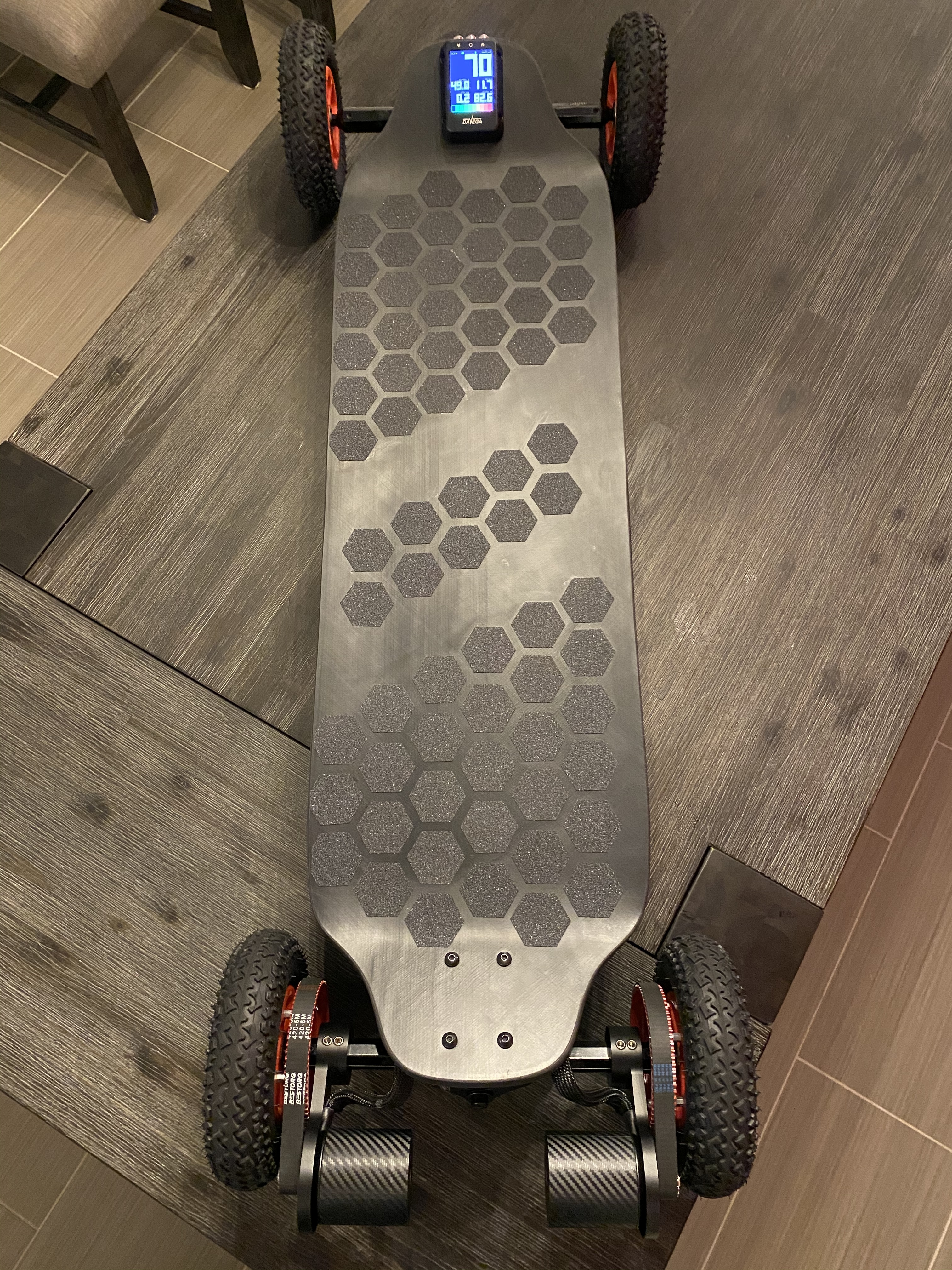

This is my second DIY build. Please feel free to critique and give me recommendations.
View My First Build Here
Alright, so I currently use an Onsra Black Carve. What I loved about that board, which is my first ESK8 board, was the 6" Pneumatics. What I desired was something that could have bigger tires and better range.
After seeing some of the flux builds going around, and other MBS builds, especially the “The Fuck Cancer” build, I decided to go that route and start building.
Parts
  1. DIY Edition Flux Deck w/ Enclosure
  2. MBS Metal Matrix II Trucks w/ Yellow Shock Blocks
  3. MBS 8” T1 Tires/Tubes/and Black Rockstar II Hubs
  4. Propulsion 6374 190kv Motors
  5. ATC 72T Wheel Pulleys
  6. eBoardSolutions Motor Mounts
  7. BKB Xenith
  8. 12s6p P42A Battery Built by @BenjaminF
  9. 12s 5.5 AMP TB Charger
  10. Hoyt Puck
  11. Davega X
  12. RideNebula Anti Sink Plates
Upgrades
  1. Powder Coat
  2. New Enclosure
  3. Deck/Frit/Decal Work

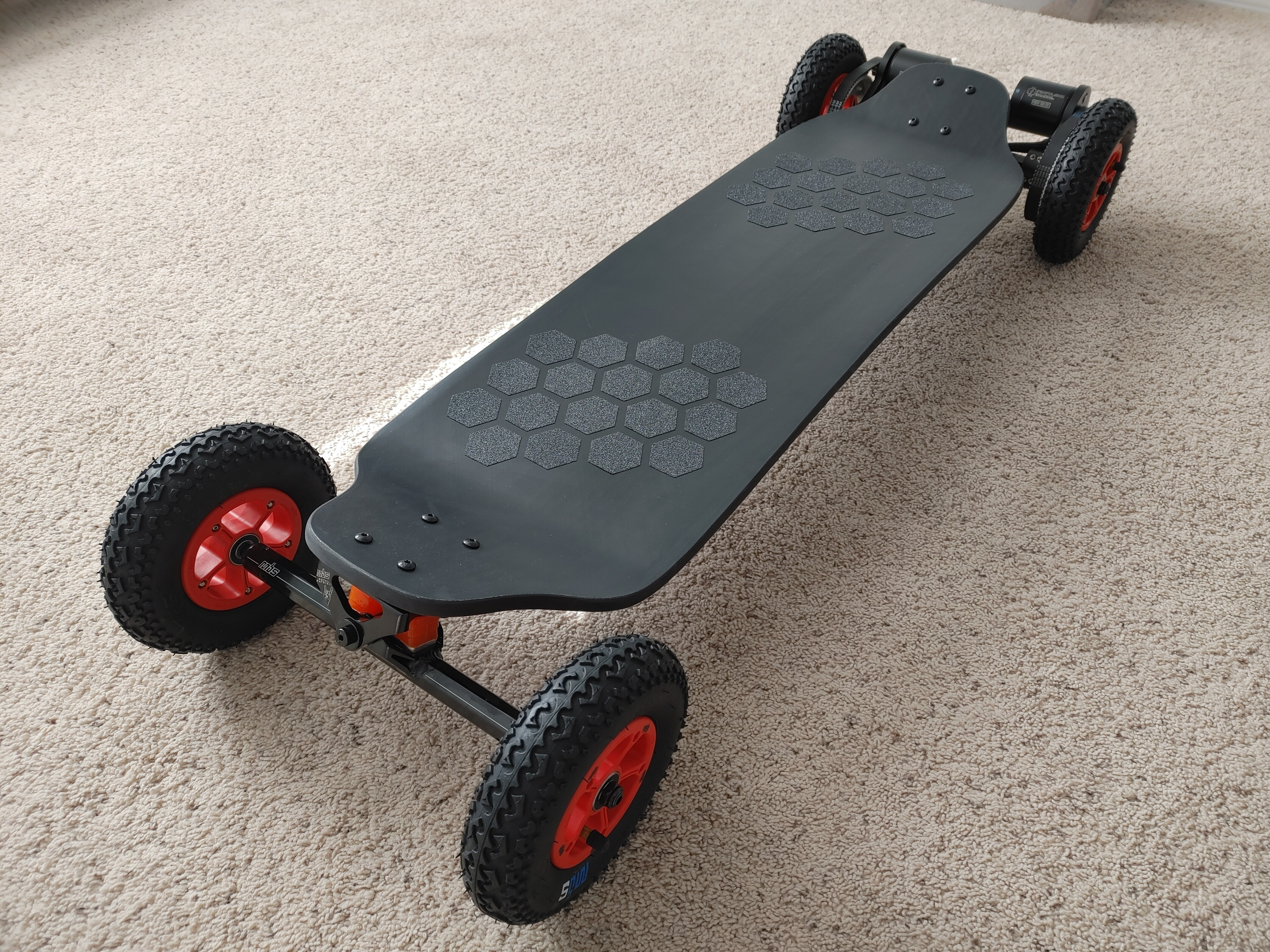

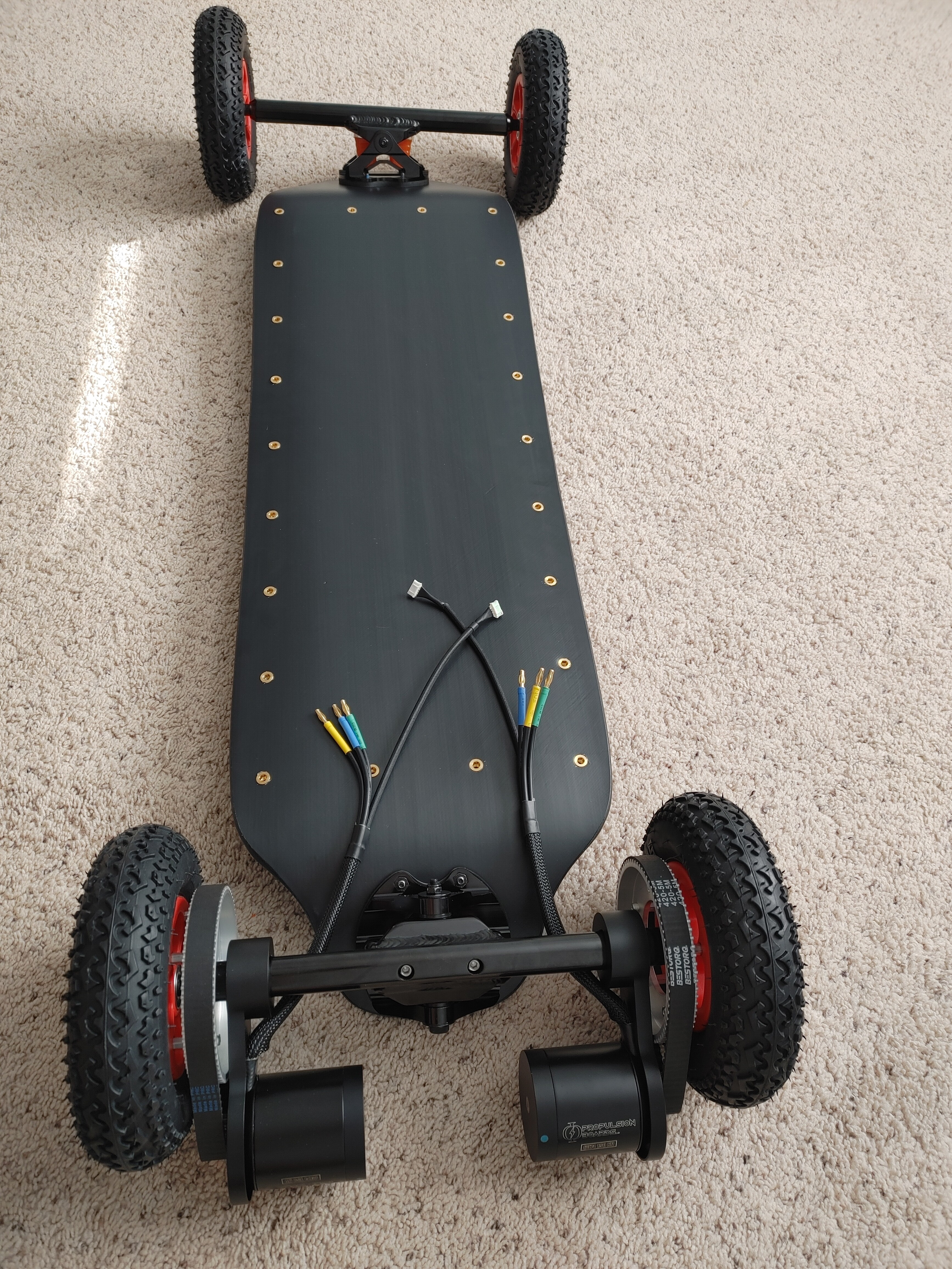

DriveTrain Assembly
Spent few hours putting the drive train together. I got stumped quite a few times being that I’ve never used or seen some of these products before. Primarily the motor mounts gave me a hassle because I was trying to put the set screw through the mount into the truck which isn’t the way it’s supposed to work.(I Think?) Instead I flipped the truck around to ensure the king pin flat head pointed outwards on each side of the board and cranked down the 4 set screws. Fingers crossed I did that correct. Also applied hexagon grip tape.

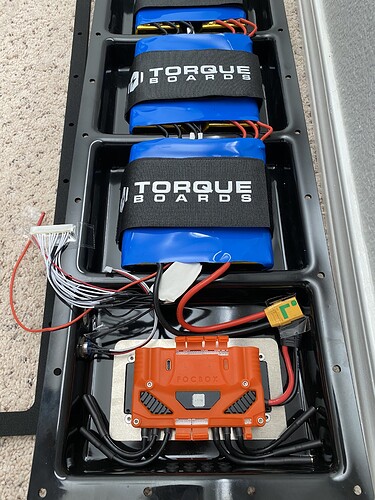

Electronics Assembly
The FocBox was a huge pain in the ass for someone who doesn’t have the experience. Needed to have the XT90 converted and the MR adapters converted. Charger was stripped and converted to the Flux connector. @BenjaminF was incredible in making the battery and getting all of my miscellaneous electronics soldered up right!
Waiting for the Davega X and BMS to put the rest together. Ready to charge the battery and play around with the FocBox after that.

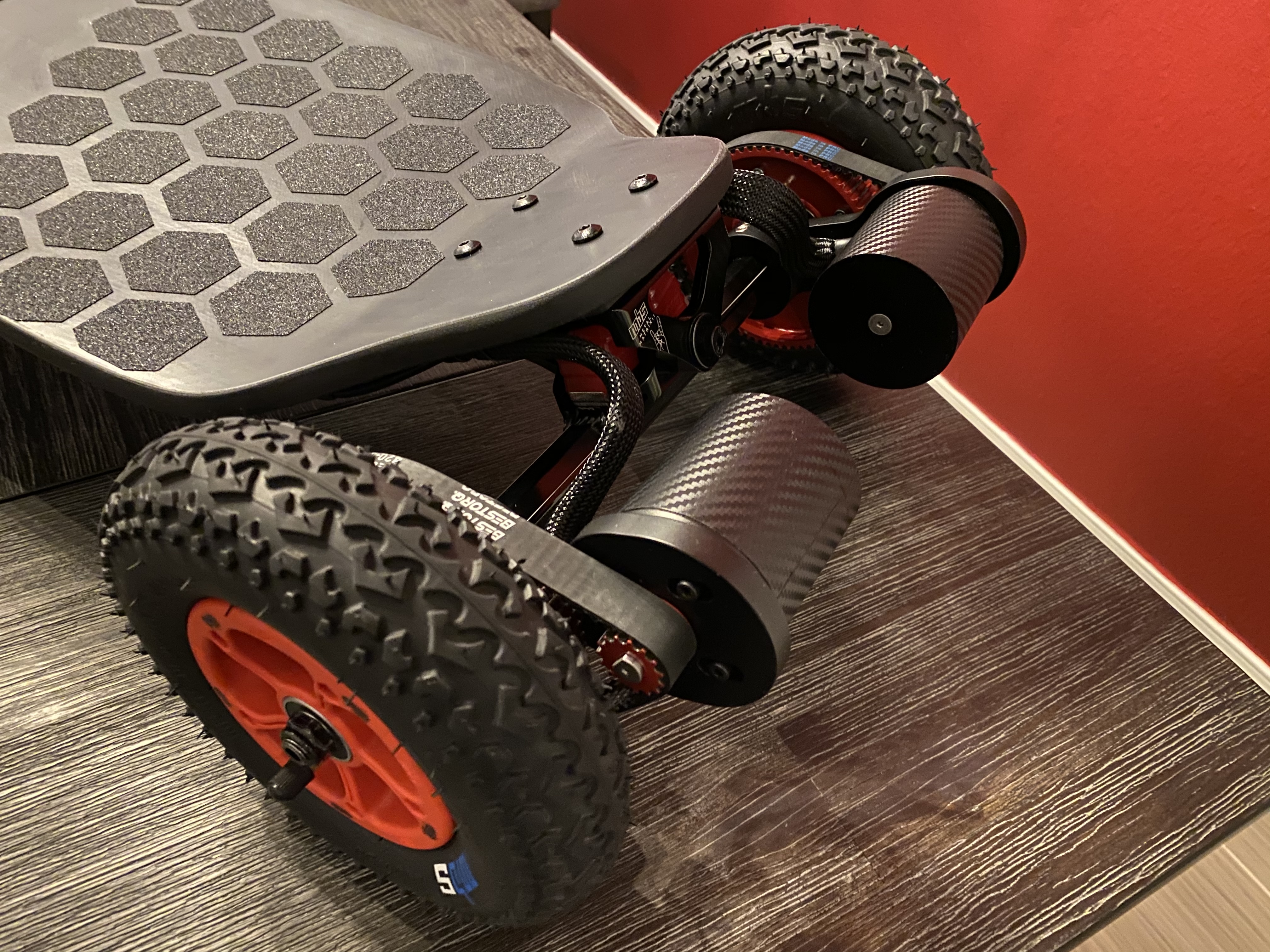

Aesthetics
Dyeing Shockblocks and Spray Painting wheel pulleys and motor pulleys.
CF Vinyl wrapped motors.
Put it all back together and I think it looks really clean!

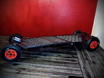

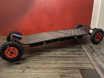

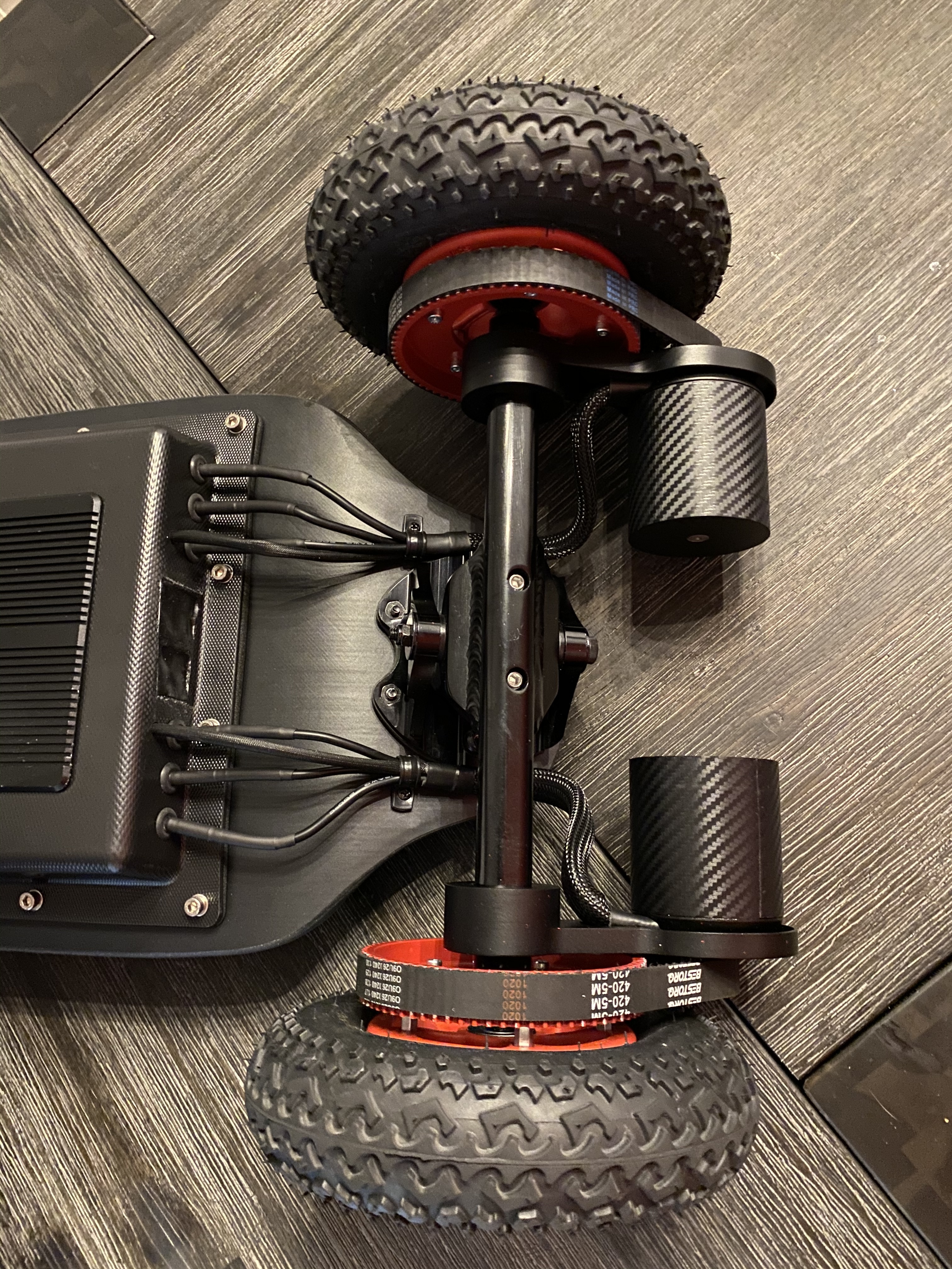

Finally Done! Super happy with how it turned out. I messed up the pre drilled holes, trying to drill them out for larger grommets. Ended up using bondo and spray paint to seal those up. Drilled new holes and was able to get the phase wires through.
Unity all setup:
  1. Motor Amp 75/-75
  2. Battery Amp Max 120
  3. Regen Amp -50

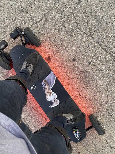

Slowly but surely, starting to piece it together and another list of things I want to buy showed up. :joy:

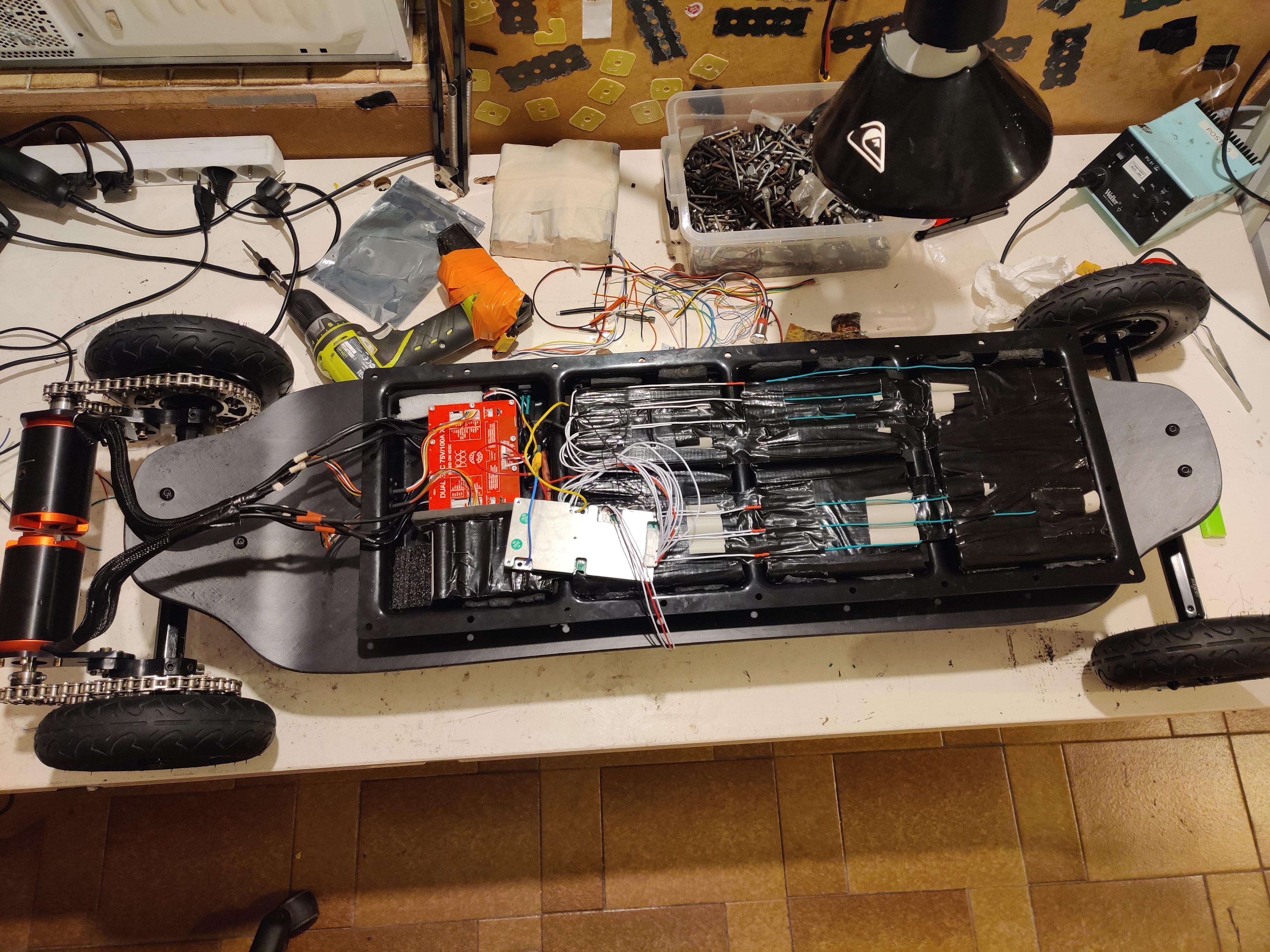

That’s my build.
13s9p is really not that hard to fit because you can stack the VESC (here a Spintend which is not a small one btw) and the BMS.
Don’t pay attention to the duck tape and mess in the wires, it was during the test phase :smiley:
Power is definitly here, 2x 63105 motors for a total of 9000W+ and more than 250A continuous and almost 400A burst from the battery. Currently setup at 2x100A battery and 100A/motor. Definitly more room to play with, especially at this time of the year (cold as fuck in France atm).
Top speed is quite average (around 50km/h) but thanks to the chain drive and ratio, I have plenty of torque to play with uphill.
It looks overpowered but it allows me to push hard if I want without any SAG (i’m far from the maximum battery discharge capacity) or high temperature from neither the VESC nor the motors.
All combined I can cruise for hours (maybe 80km at 30km/h) thanks to the 1700wh or shred it (what I don’t do because I need to master the beast first :smiley:) without any fears for the electronic.

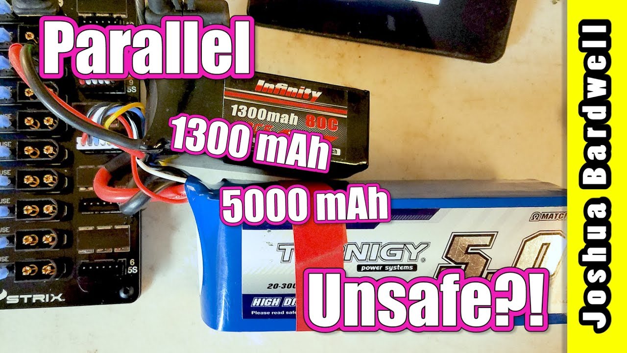

People have been using lipos in parallel, charge and discharge, as long as you treat it like one big cumulated pack its the same.
It’s the exact same thing
The fact they are different capacities is fine, but the c rating of the cells is very different…the c rating of a P42A is 11.25 while the 50E is only 1.96 so per unit capacity you can’t work the 50E as hard
In the way that a chain is only as strong as the weakest link, the c rating of a parallel group is only as high as it’s weakest cell
