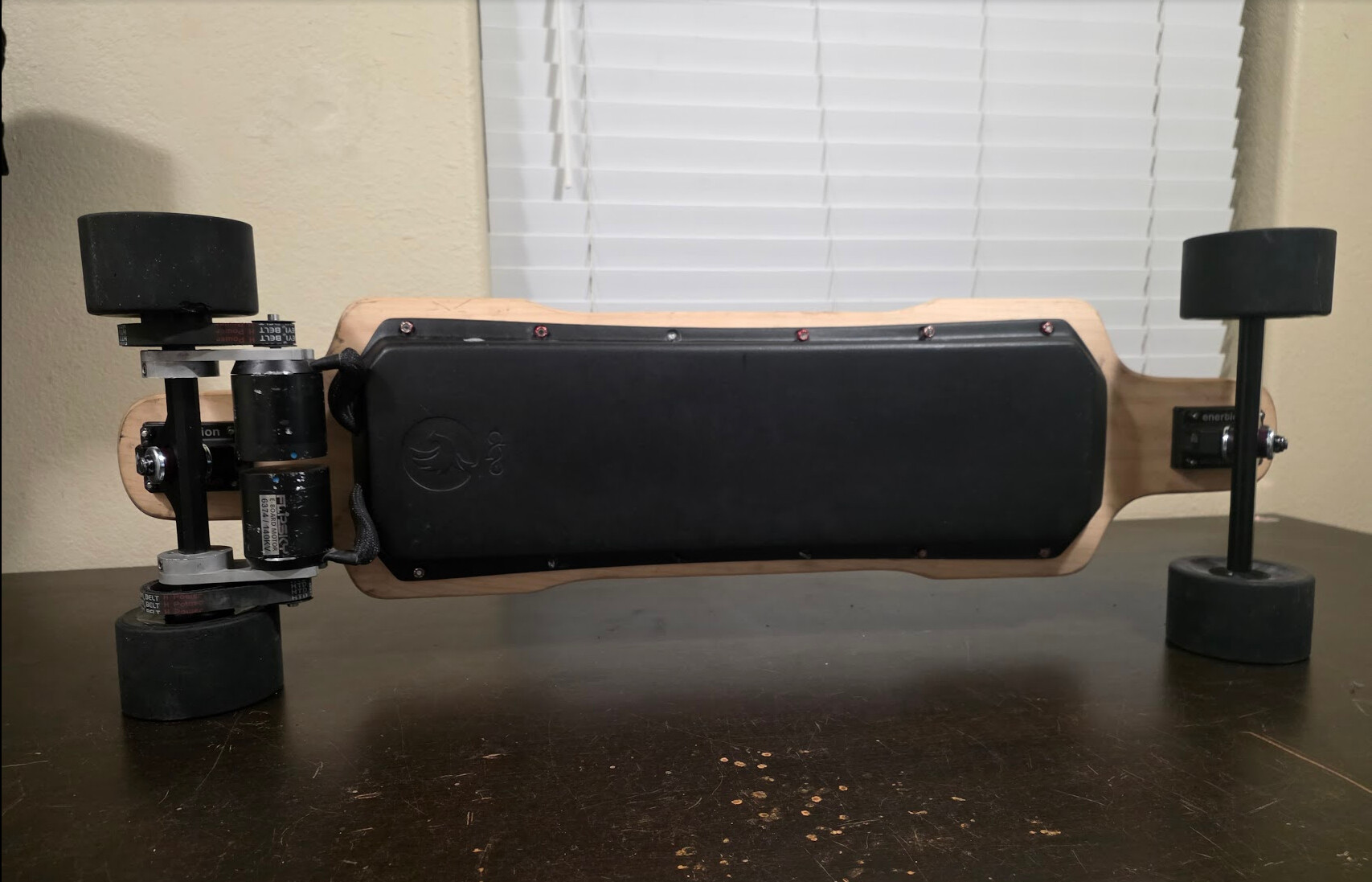

I don’t think there’s a proper way to do a patch job so I’m wary about giving advice. You can wetlay CF cloth with laminating epoxy easily there are some good YouTube tutorials, it’s just difficult to do a pretty job. You might need to sand the enclosure first to get good adhesion. Stiffness not matching might be less than ideal.
I had pretty good luck with skinning a thin and weak enclosure in a few layers of cf, it’s been tough enough to hit curbs and the steep edge of a road, supporting my weight scraping all the way to a stop, and adding an aluminium patch with leftover araldite 2014 there’s 1.5mm deep gashes and it’s still on.
This is a fantastic idea for my cheap ABS enclosure on my Raptor! I’ll definitely be looking into wet-lay cloth with epoxy.
Appreciate the tips! :slight_smile:
I would recommend using glass fiber instead of carbon fiber.
Good to know!
Is fiberglass just easier to work with?
It’s slightly flexible which is often more preferred on a deck that flexes but also it’s transparent to radio, whereas carbon is opaque to radio. Carbon can also short batteries and other things, and glass won’t. The only thing worse about glass fiber, is it’s less svelte.
That makes perfect sense — super helpful, thank you. I actually have another carbon enclosure on hand too. Is best practice just to insulate everything with fish paper in those cases? I honestly didn’t know carbon could short out the batteries.
You can add a gel coat on the inside if it doesn’t have it already, and use fishpaper, both of those work, I would do both honestly. There are other ways as well but fishpaper is really good.

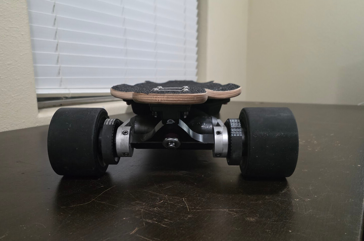

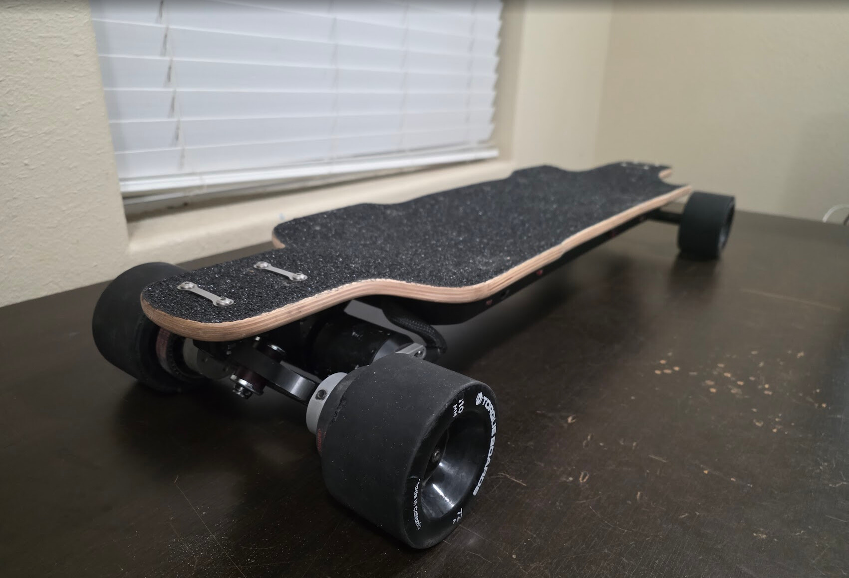

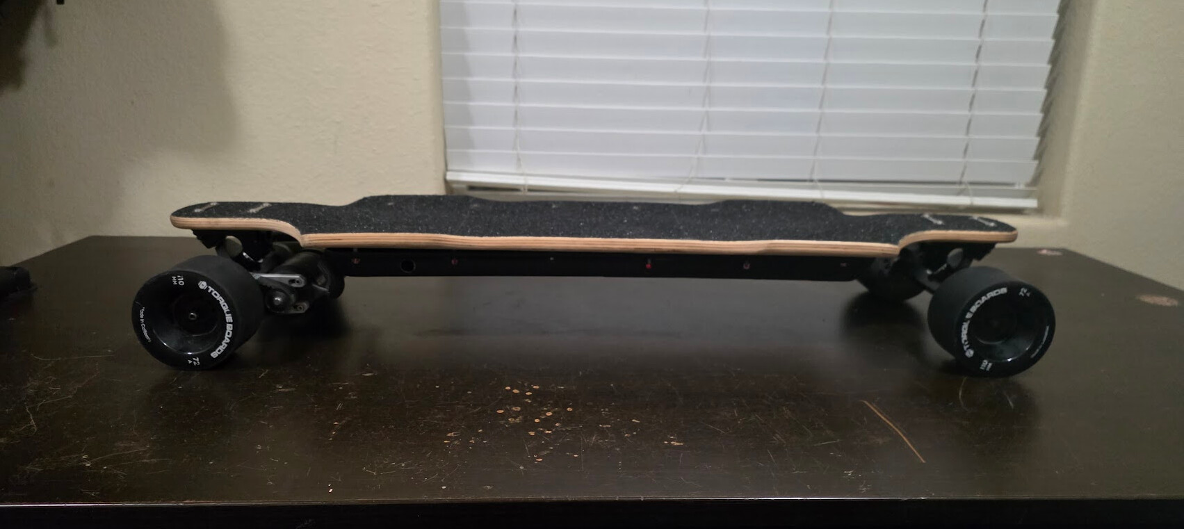

Dude.. that’s clean as fuck
Thank you!! :slight_smile: I’m really liking this deck. Honestly, not bad for a bunch of random, unplanned parts I threw together out of boredom.

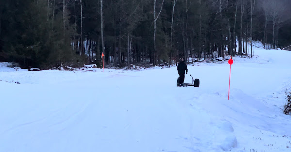

@Evwan are those MBS T2 tires in your snow pics? How are they on snow?
I actually have a pair of the same knobby ones from @jack.luis pics to try out as well when there’s some snow/ice around here.
They’re just AliExpress tires, same tread pattern
Ah I see - How’s the grip? I wish they/T2 weren’t so round profile
Round helps in the snow. You want them to sink in and hit the pavement below. They’re pretty decent all around tires.
If there’s no pavement you wanna use the snowblower tires I got
So for example if the snow is really deep?
exactly. Like if you were to try to ride on a ski trail
@Evwan @jack.luis Ah, good advice - first time trying out winter esk8
Yeah you’re gonna need them anyways since your hanger is gonna drag thru it. I was at the limit today, occasionally brushing my hanger on the snow.
9ā€ mbs offroad work well for me as the tread pattern doesn’t seem to want to pack with snow.
