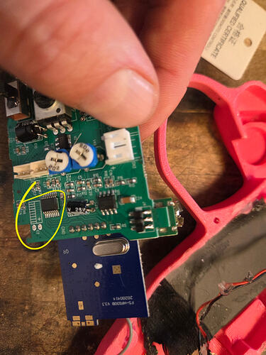

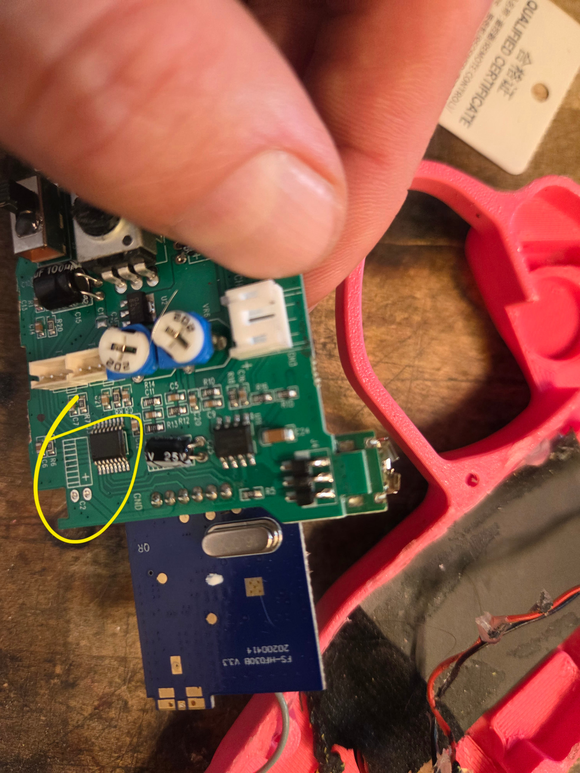

I made it a block out and it started doing the slight acceleration bumps and shortly after I got the fast flashing lights.
I pushed home.
My first thought was to try and replace the battery.
So I opened it up. And in the process broke something off the PCB…
So yeah. This Pink GT2B is dead dead…
I believe my issue with the GT2B may have been caused by a resistor breaking off…
And wild voltage variations…
I expect it happened from being dropped…
So unfortunately my first failed GT2B came happened after way less use than a my first failed Mini Remote.
And way way less use than my first failed Z-mote.
These things are just not made to be robust assuming you are going to be moving at fast speeds with them…
I really really enjoyed the feel of the GT2B…

GT2B have broke when i would crash. but usually the symptom was less signal, cutouts.
with any remote i’d have used the vesc remaping (or a hobby signal monitor) to see if it was behaving weird. jumpy stuff is usually pots or wiring.

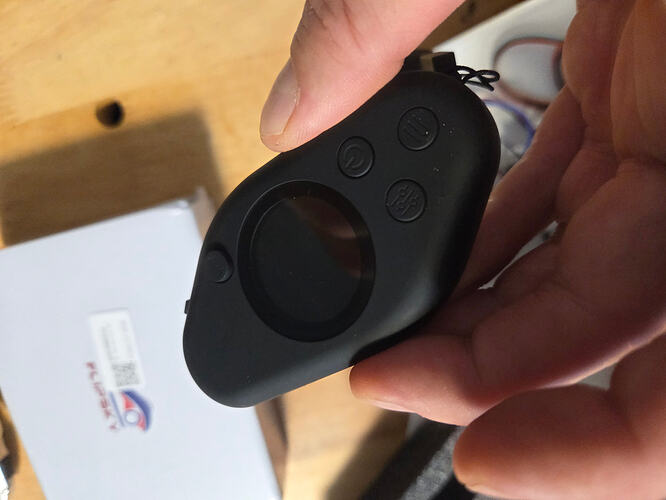

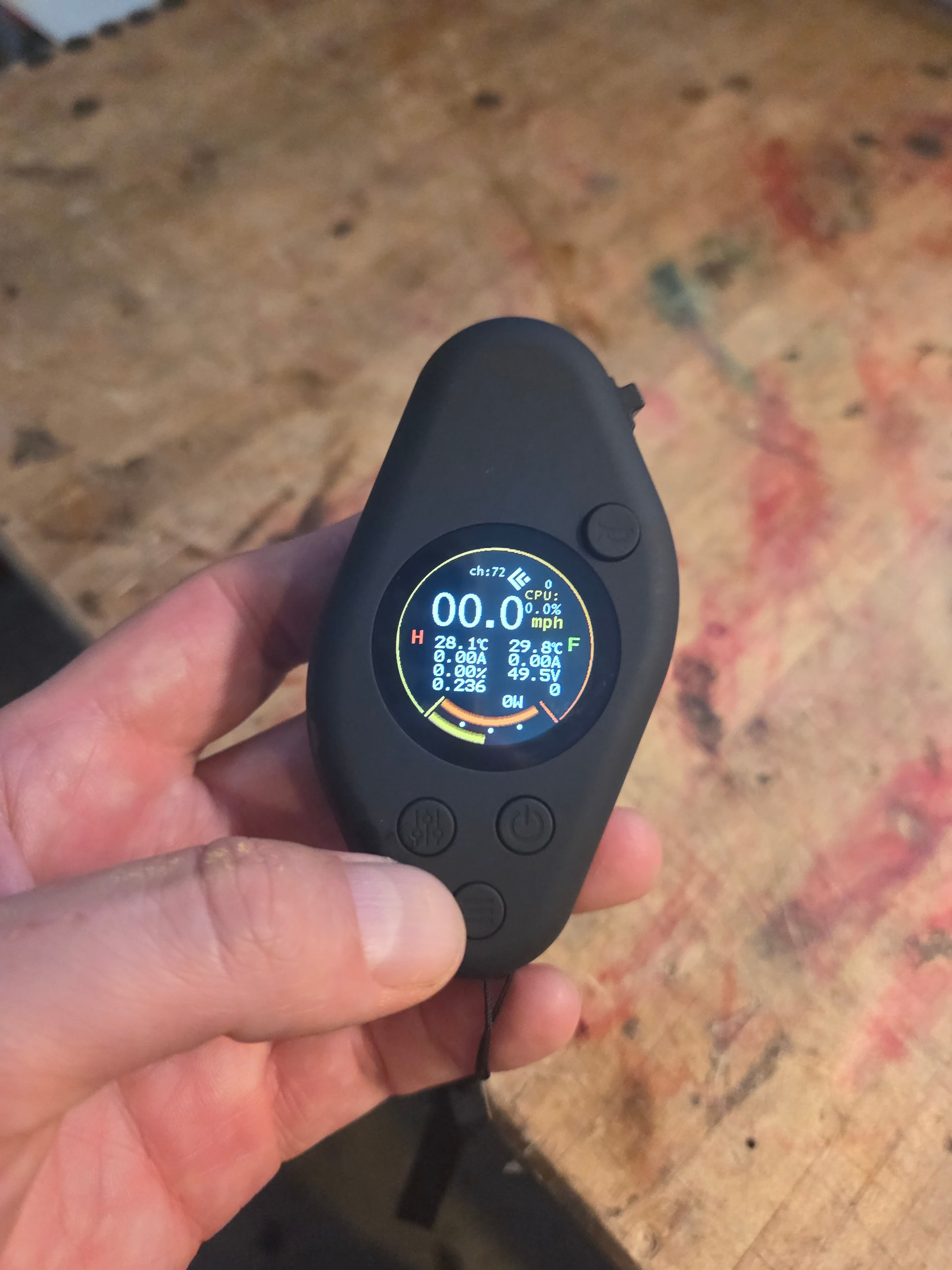

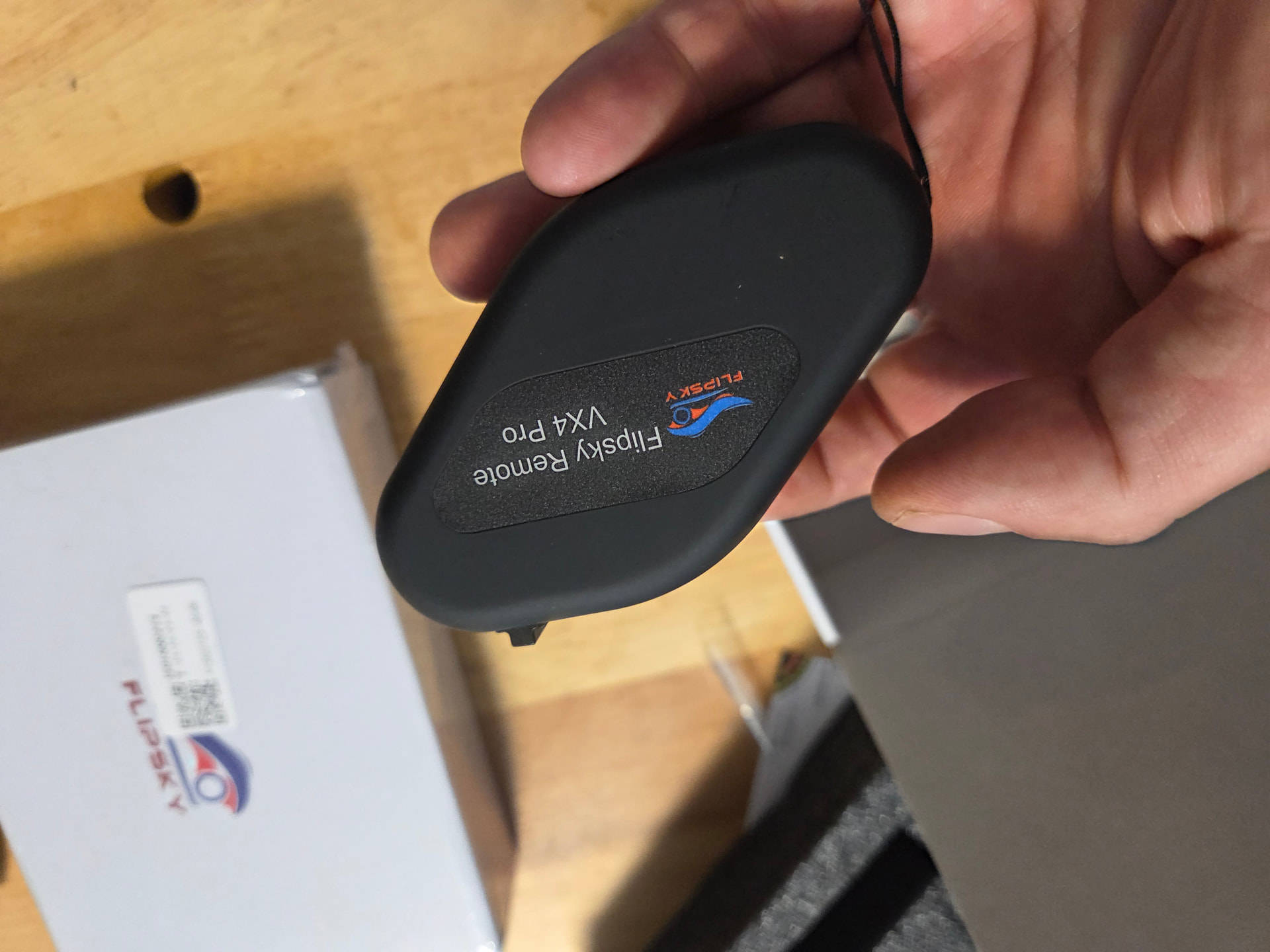

But I already have some first impressions of the VX4 Pro.
1 - I’m pumped to have something purpose made for this. I have used hobbywing and VX1 remotes in the past. But mostly Minis. And recently GT2Bs. I suppose the Z-motes were purpose built. the case made it seem diy…
2 - I’m pumped to have a screen. I never really had one(long time since my Evolve days). Always thought it seemed unnecessary. Having it is nice… it sparks joy.
3 - Having buttons that do stuff. Also a novel thing for me… I think it’s cool.
4 - I was able to set it up. Even though I did not look up proper instructions I made it work. This goes a long way for me. I’m lazy and have a hard time paying attention…
5 - the build seems really solid. Tiny. But firm!!!
Again. All first impressions. Hope I can get used to the thumb wheel…
