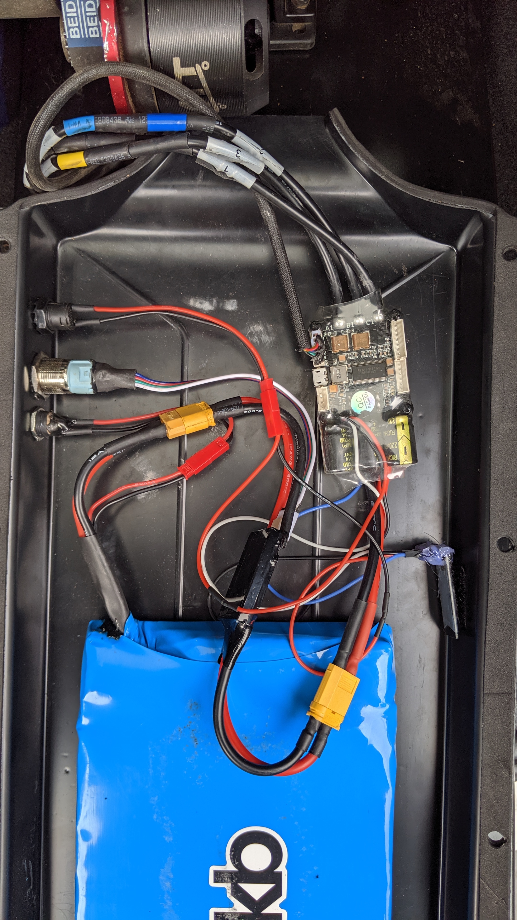

I purchased a DIY kit from Build Kit Boards last month that included some v2 parts, including a kill switch. Everything was great for the first week or so… and then the remote kept losing connectivity when I hit a bump, or sometimes just because. The owner’s communication has been inconsistent at best. I really enjoy this board, but not in it’s current state. Can anyone recommend it suggest a solution? I have a video on my phone showing the issue, but can’t post it here though I attached a photo. (I have more photos)

First thing you need to do is get some 3m double sided foam tape and secure the components. It’s no surprise that you get cutouts with everything bouncing around. The surprise is that it still works.
Second, take isn’t good enough to secure the PPM cable. I’d use hotglue.

Maybe glue somehow got into the pins and causing interference. Or maybe if that’s hot glue I’m seeing you might have melted something(?)
As instructed by the owner of Build Kit Boards I removed the hot glue from the connector, ensured everything was plugged in completely, and hot glued it again, but the problem continues. As @mmaner said it bouncing around is definitely a huge cause as well. I wish I could post the video I took on this thread
If it were me building it, I would secure everything to the deck with double-sided tape and hot glue and then put foam padding around any component that might move, also under the vesc and RX. After all that’s done, use the enclosure as a cover, ABS really shouldn’t be used to carry weight as it’s not structurally capable.

@ryansinatra The primary AS is to turn everything on and off. The second button is to turn on the receiver because the AS causes a weird startup voltage. Pretty sure that’s not the issue.
@mmaner everything (should be) secured with the included Velcro, so that shouldnt be the issue. When he bounced the esc it threw red fault leds for some reason. Consulting the MFG about the issue, but didn’t reply to him in 4 hours With my very “inconsistent communication”

I really have to agree with @mmaner and the others that have commented about the state of the parts in the enclosure. Best practice is using velcro or some other fastening method to attach the components to the deck, using the enclosure as a cover.
The main things I would be worried about are the receiver, which appears to kind of be velcro-d to the side? And the VESC, which seems to just be floating. I mean hell you could use bubble wrap to insulate from vibrations and that would provide a better environment for your electronics. Vibrations destroy things and I always hotglue and fully pad my electronics.

Fully pad things and post some close up pictures and maybe we will get somewhere with this troubleshooting.
