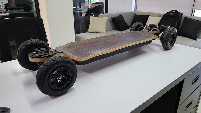

Hello Guys:
I just finished this build and I’m pretty happy with the results and specially with how good it looks and how massive it looks in person.
Part list:
Molicel 21700 P42A 12S4P
e-boosted enclosure
Stormcore 60D
Surfrodz RKP
Evolve wheels, tires and pulleys
Flipsky Vx1 remote
XTLA long mounts

Some random build pictures:
XTLA mounts:
The eBoosted SS enclosure:
The on/off button to activate the Stormcore 60D
Nice demonseed shape:
Ultraboard:
The Evolve AT wheels and tires
The wheel pullies:
The battery capacity meter installed on the nose:
The battery build process:
The ESC:
The motors:

Those single-piece spacers on the axles are dope!
I was hoping to see a picture of the insides, because that enclosure must have a lot of empty space in it, no?
Also it really looks like your enclosure and metal plate are pinching the power button’s wires lol
Also also: no build name?
Doesn’t this get wheelbite? Looks really nice!
No wheelbite at all but you need install the C-clip extenders to move the trucks outwards, looks great that way
I’d love to hear more about these C-clip extenders
Just a fancy name for these chargeport and on/off button holders:
I know, I know the motor wire loom was incorrecrtly routed :sweat: it’s fixed now :slightly_smiling_face:
nice job! :slight_smile:
question: what size evolve tires are those?
Looks like you moved your trucks mounting position forward on the board. I also ended up doing the same thing in order not to get wheel bite with the 100mm BOA’s. My build is waiting on your enclosure I ordered.GEDC0295 (640x427)

Awesome build Alan! Have you had the chance to ride it? How is it?
These are the 7"

Is it your typical modus operandi to put the enclosure bolt inserts all the way through the deck?
I was so happy about how easy it was to not screw up the inserts on the Demonseed since the deck is soooo thick.

Are those C-clip extenders that you used to mount the charge port and to enhance the clearance for the wheels something that you are planning to sell or are you willing to share the design for it?
How wide are your Surfrodz?
I just received the Demonseed 42 deck and I am excited to build on such a large and comfortable platform.
Did you connect your voltage meter to the battery output port (JST PH-2) on your Stormcore? Or just splice into the battery somewhere downstream?
