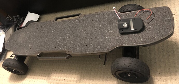

Hi,
Don’t you love it when a build comes together?
I’m starting my first DIY electric Skateboard build. I’ve decided to go all out and make my dream board (hopefully) to potentially prevent the first for always wanting to buy a new board.
Almost all the parts received just waiting for my second unity+, 2nd TB DD and P42A cells to come back into stock on fogstar.
So close but so far
FYI - Anyone looking to buy the Mboards XL enclosure the internal usable space actually works out to be 545mmx152x35mm (40mm with gasket).

Did the wheels fit on the drives alright, or did you have to drill the holes larger?
Cause your parents raised you right or threatened your life in the right ways.
@rusins will need to drill holes it’s annoying as I tried Boundmotor’s airless also which I have on the front of my Meepo mini 2 ER and they didn’t fit either.
I think TB kegel adapters are just made slightly thicker so you can only use their wheels unless you mod the cores. :man_shrugging:t2:
It’s actually the other way round; the chinese wheels have the kegel hub a bit wrong (likely to better fit 3d printed pulleys). Hence why I asked :+1:

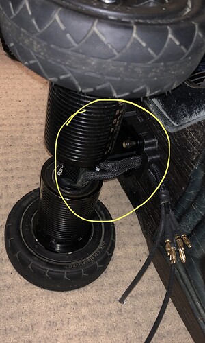

Nice looking repurposed Raptor board! It looks so awesome. Just curious on how you got rid of the wheelbite with the pneumatic wheels. I’m also looking to convert my broken Raptor board. I’m pretty interested in how you swapped out the enclosure/battery holder for the Raptor. Great job on it!
Thanks man. I have yet to put life in it as I am waiting to get the cells to make the 12s6p battery.
With the wheel bit issue I am using TB XL Direct drive motors which are a bit wider than standard ones. This is the deck without any risers at the moment and there is clearance when it’s finished it will have 1/2 or 1” risers on it so there is absolutely no chance of that.
I do have the raptor 2 enclosure but this is too small if If you want an above average battery I have gone for a Mboards XL enclosure and will be putting a custom neoprene gasket in to act like a riser giving me about 60mm depth inside. I don’t think you can get a bigger enclosure on a raptor 2 deck as there is 5mm clearance on the wheel cut outs on all 4 corners. So any wider or longer and it will over hang into the wheel cut outs between the deck and enclosure.
The only thing that is Enertion about it is the deck all the rest is new. I have also purchased a Metr pro which will link to my LLT BMS which I will use to effectively fault report when the board has the last few bits and is complete.
@Dyeezy just to add if you had standard TB DD I think there would be wheel bite however I reckon you would be fine up to 120mm.
Interesting, thank you for the explanation. I really like the direct drive, but wayyy to expensive for me. I’m actually trying to do a belt drive with pneumatic wheels with the Raptor deck. I’m not sure if it’ll work with the wheelbite I’m getting. I guess your trucks’ geometry is different than my TB218 trucks. It is on 1/4 inch risers already. I’m thinking of trying half inch, but I don’t think that’s enough still.
I’m using the stock 10s4p battery, so I doubt i need to swap the enclosure. But if the room is too tight, I might resort to getting the bigger enclosure. The smart bms takes up some room.
The metr pro looks so helpful. Never knew about it, I might look into it, as I have a smart bms and a unity as well. Which one are you getting?
I just got the standard metro pro model that connects via UART as I read the metro pro unity had some teething issues where it is newer. I’m working with 2x unity + and smart Bms is from https://www.lithiumbatterypcb.com/product/13s-48v-li-ion-battery-pcb-board-54-6v-lithium-bms-with-60a-discharge-current-for-electric-motorcycle-and-e-scooter-protection-2-2-3-2-2-2-2-2/
I do prefer the raptor 2 enclosure but was just too small for me.
Would defo look into the metr pro I feel it is essential for DIY. As well as your phone it even works with Apple Watch if you have one.
@Dyeezy also just measured the distance between the 6” AT wheels at it’s exactly 10” so like you said either bigger risers or longer trucks with a bigger wheel base - I think that would be the best option as you will be more lower to the ground and in addition to a wider wheel base you will be more stable. Depending on where you are riding if you go for that option maybe go for DKP?
