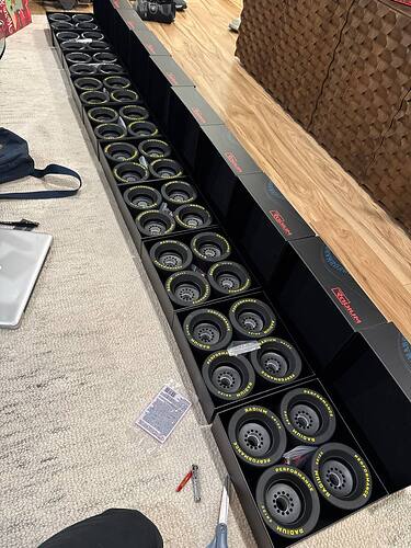

Never seen hardwood and carpet at a warehouse before
You just haven’t been to a nice warehouse
