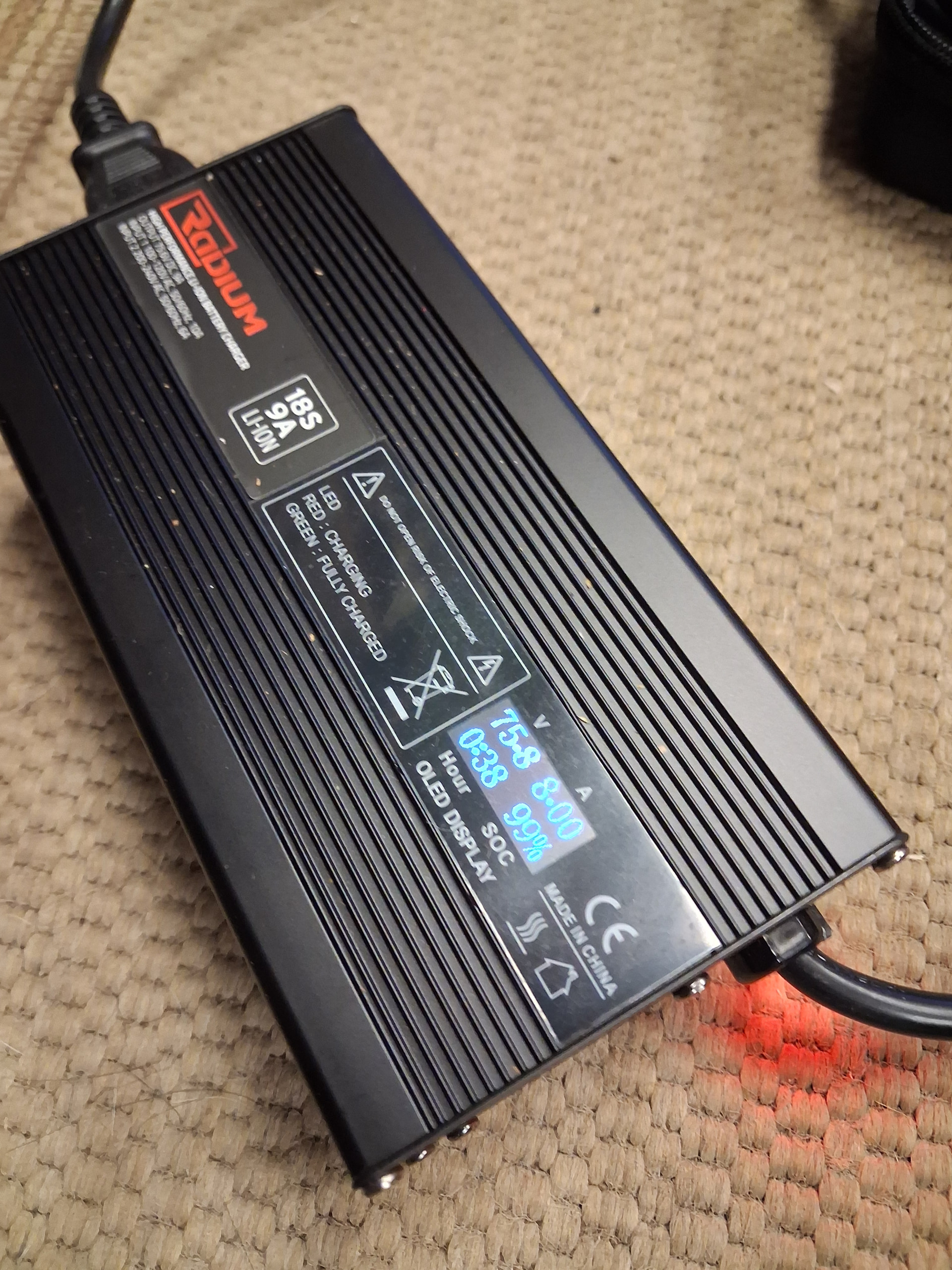

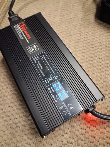

@Tony_Stark should i be concerned about this? Its very slowly ramping down current but already showing 0.2v over voltage and still at 8a…

On the charger, no need to be concerned. After current starts dropping below 9A you’re in the CV part of charge and there naturally is some tolerance but +0.2V across an 18S pack is only 4.211v (0.01V over) per cell and most li-ion charging systems are designed to run up to 4.25v per cell while charging and they naturally fall back under 4.20V when the charger shuts off.

Good to know about the charger, i pulled it after that photo cos i was ready to ride, but i’ll see it all the way through next time and see how it looks.

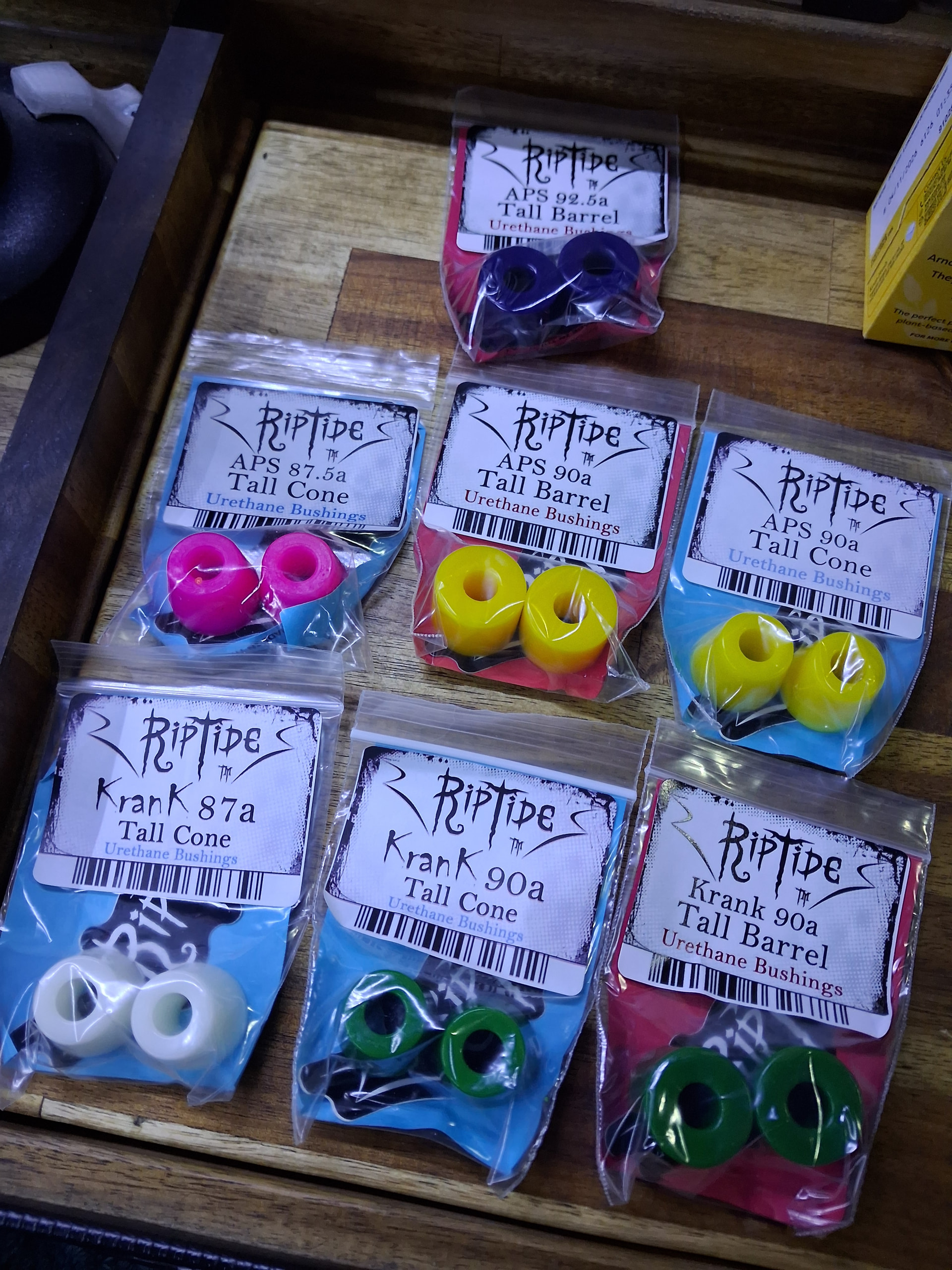

I’m gonna suss out the APS 90a cones front and the APS 92.5 barrels rear and start playing from there. I reckon that’ll be on the limit of being too soft for me but at the upper end of it for the kid.

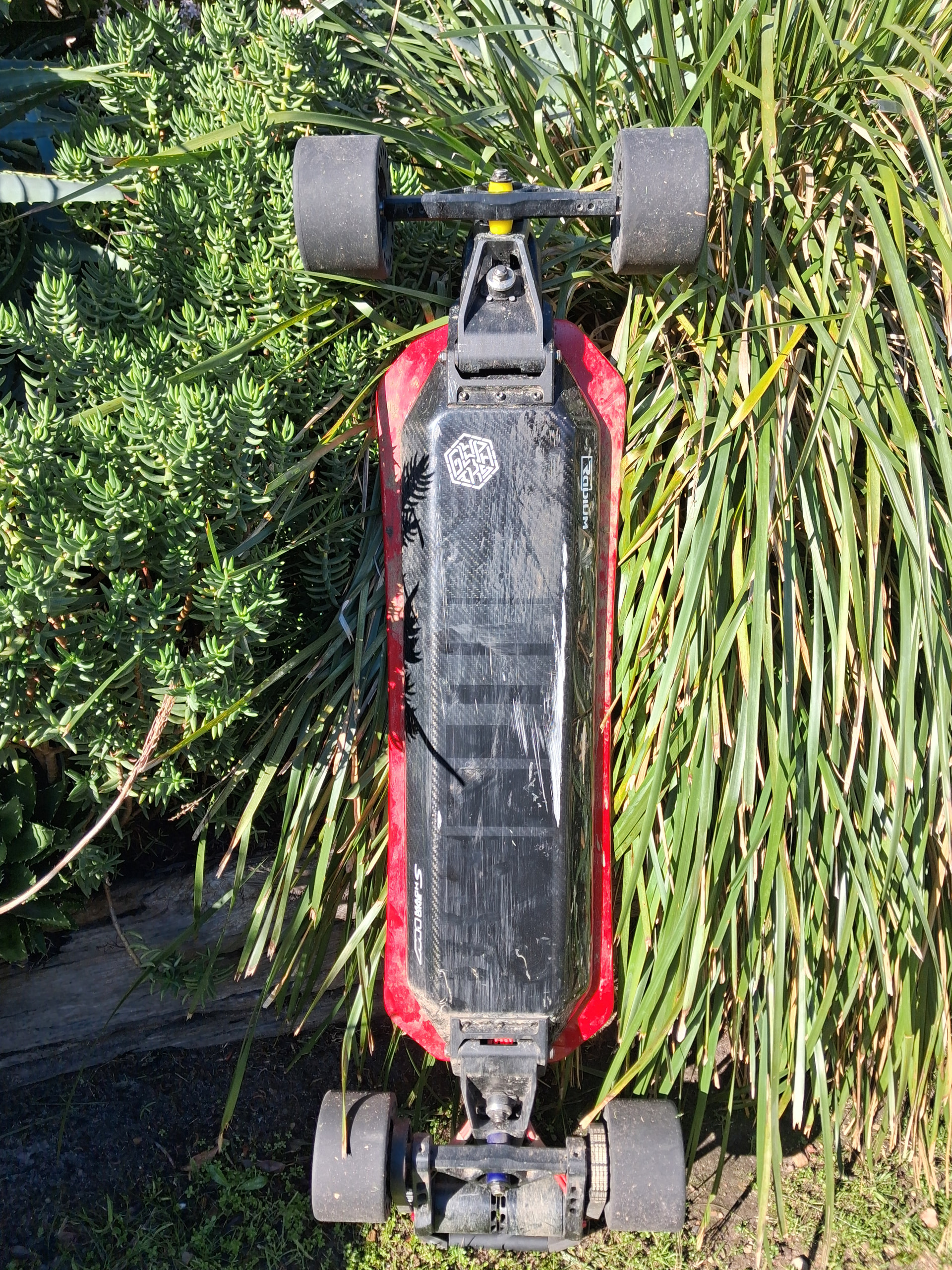

It was only a matter of time. First battle scar!
Looks gnarly but she can handle it! Quick question, do your motors get hot really fast? For some reason the motors are super hot to the touch within even 5 min of riding while my other board’s motors just get warm. Hasn’t been an issue but wondering if that’s normal
No idea to be honest..haven’t had a reason to touch them and its winter here so i wouldn’t expect them to be overly warm anyway.
Unless they are too hot to even touch, they’re likely not hot enough to warrant concern
