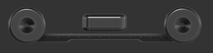

Renders of Phase 4. Here’s what the whole board will look like (bindings will of course be added).
Here’s the stainless steel subframe. As far as assembly goes, it needs to be bent into shape, then 2x3 M8 bolts hold the truck mounting part together. The triangular part on the bottom will be welded shut. And of course gonna add a couple bolts to mount the deck, just forgot to model it.
With place in the bottom for a couple cells, so I’m probably going to be running a 20S5P in the end.
Here’s the thing unfolded.

Made some refinements to the design and increased length as I realised I currently have more deck real-estate than what I remembered, so needed extra length.
Bad news, now it doesn’t auto-quote, meaning I probably went over some standard material size limit or something.
Deck is changed out for a 5mm/6mm aluminium sheet, thick enough so that it can countersunk M6 screws, while being flat so I can build up concave exactly how I want it.
Figured I don’t want to chop the Hellhound as it’s such a nice deck, but also don’t have anything on hand with the right dimensions so might as well get an aluminium one made. It’s actually not even that expensive.
Variable ride height adjustment range
Doubt I’ll use the lowest set of holes for anything other than taking some photos but we’ll see. In the lowest setting it would probably be the only board on the forum that has better clearance when ridden upside down :sweat_smile:
It can fit 4x G300 and 20 cells in the belly pan. I’m definitely going to be utilizing those 20 cells. G300 fitment is just for future proofing since the chassis is about as future proof as it can get on current tech. Also there’s mounting holes to move the 2x D100S down here, not sure if I’m going to bother repositioning them but the option is there. I’d need to see if the extra height I’d gain by repositioning them can result in more cells in the enclosure or not. If it can it’s worth the effort.
Bellypan for protecting the electronics - not required for strength. Considering making this from ABS instead of steel for cost and weight saving. And I have a bunch of 3mm ABS anyways.
If no G300 is being used the belly pan can be as shallow as it is in the middle of the deck - that’s probably how I’m going to be making it if I end up doing ABS. If it’s made from steel some scrap material needs to be used to bridge the gaps that inherently come from the folded sheet design and then it’s adds strength as well.
Now the design is more or less final. Although won’t be ordering the chassis until I’m back from esk8con.

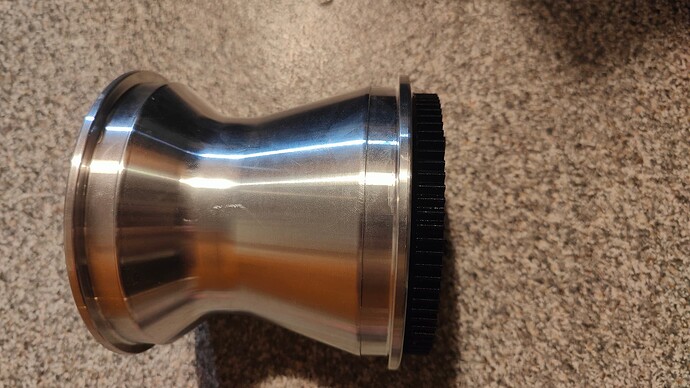

These 5" rims with 115mm internal width, the BRP hubs I am getting, and a custom made adapter piece which I’ll need to get machined somewhere.
Next up I’ll need to buy some tire grease, so that I can actually put them on the rims.
After that the next obstacle will be the hubs and adapters. If all goes well the hubs should be finished in 7075 for esk8con, not sure about the adapters yet - the budget is first spent on flight tickets and such… The kart tire project is not going to appear in Vegas unfortunately.
But! I’ll be 3D printing the hubs and adapters for test fitment soon, just to make sure that I get the tire offset perfect when the adapter will be made from alu. And also because I really want to see just how ridiculous it would look.
Reminds me of giant tires @Swol_Moon ran. Look forward to hear how it goes lol.

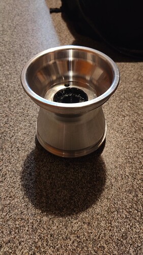

Prototypes 3D printed, fitment is good! Some considerations: the hub adapter will sit about 2-3mm closer to inside if my printer wasn’t as shit at bridging over supports as it is, the gear would be just about level with the hub now. So I’ll probably move the relevant face by 2mm to have any actual clearance, as I can’t afford to move the gear further out, then the innermost bearing would stop taking it’s centering loads.
Valve access is shit - the rims need to come off the hub to be able to adjust pressure. And it needs to he released specifically at the BRP interface. It was designed like this in order to be able to have the rim as close to the inside as possible.
However, due to it needing release at the BRP interface specifically, I’d need two sets of adapters machined if I want to be able to swap to different kart tires on race day, as I’m not going to be taking tires on and off the rims all the time. So another set of rims and hub adapters will add to the cost. Still considering if I need two sets though. Would definitely be good if I end up cording a set mid race or get a puncture - and the rubber is super soft so it wouldn’t be hard to get a puncture. Plus of course this allows me to bring two slightly different compounds and I can do head to head comparisons between them… Within a few minutes.
First one is on the rim! God damn that was a workout.
