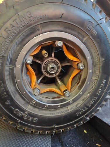

There’s quite a bit of work left but most of it will be left after the Montrevel race. Till then it’s only getting swapped to the 8x3 Carlisle slicks and a new set of PETG rim spacers as the original PLA set finally failed. Not from use though, but from heat. It was left in a dark blue car in the sun at 35-37C ambient for a full day… It warped pretty badly from the heat

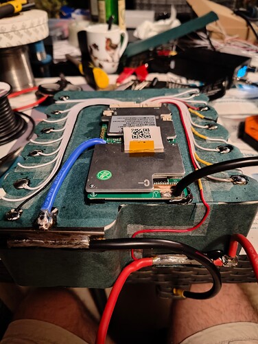

The battery build for that:
The finished heatsink and vesc wiring

Looking good on my 9x3.5s as well. It’s going to get one of the fresh 8x3 sets though!

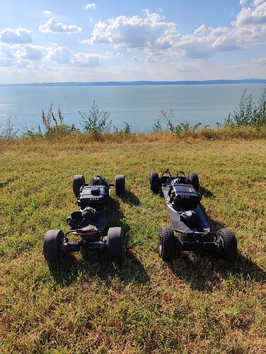

And some balatonkarika updates: it was a 200km+ group ride event we attended with a small race on the first day. The race was mainly onewheel focused but esk8s also had a go. Sadly the timing was messed up. The esk8 race was on a rubber running track, really narrow, not a whole lot of stuff could happen. I was the fastest by far which was expected. I was surprised by the medium grip of the wide slicks on the rubber surface. I suppose higher pressures might have helped again but I was lazy to experiment. There were some pictures taken on a nice camera as well but those haven’t found their way to me yet so I’ll upload them later. Then I had a go on the onewheel track as well which was an off-road track, much more fun.
The slicks kinda worked. Real slippery but enough grip to have a bit of fun without competition. On the loose parts they didn’t sink in which was a plus.
The trucks handled super well offroad as well, taking the edge off the harsh bumps and they were stable when landing jumps. Did a few small ollies off some small ramps, no crazy jumps though

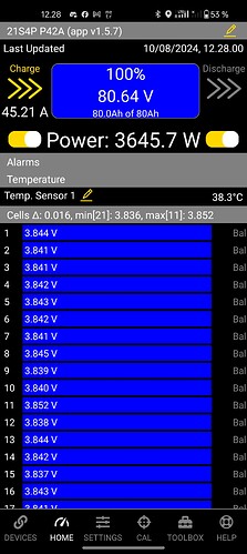

Some fast charging half way to catch up
Joke
Was “only” charging at 30amps other than taking this pic because P42A don’t like more than that :crazy_face:
