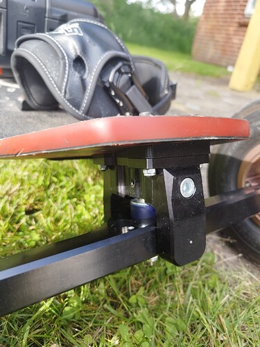

So today I finally installed the angled risers:
Drilled kingpin access holes front and modified the back to accommodate the angled riser
The new max lean:
And I went for a short test ride
The 25/10 angles feel insanely good. I still have great turning and it’s super reactive. The lean is monstrous. I fell in love with the setup again.
Unfortunately the rear feels a bit too reactive with the current bushing. And I brought the wrong hex key with me so I couldn’t adjust the bushing. Also forgot to charge the board after yesterday’s ride…
So I am charging at 15A now to get out for another ride where I tighten the rear down a bit more.
I have a feeling though that I need to bump up the duro to 95A with the rear tall chubbies, a little extra tightness probably will not be enough. And I have a decent amount of preload on the bushings right now so I am pretty sure they wouldn’t be happy with much more preload especially longer term.
Is this the new truck angles with the angled risers installed?
Yes these are the final angles. 30-5 dewedge and 15-5 dewedge

Interesting. How does the turning radius feel with the rear truck angle being so low? I’m assuming your crazy lean angle compensates for that and provides a tight turn radius.
Yes the lean angle compensates for it all. Getting used to the extra lean took like a mile of carving, first it felt like it didn’t want to turn but after the adjustment period I still have all the turn I need and I have more lean. Angles as low as this I think only work if you have grippy tires which allow you to lean in far. Probably the bindings also help here.
Worth noting that I am not running the stock lean stoppers on the setup, so I actually allow more lean than intended by Tito. I don’t think I would be happy with the turn with the stock lean stopper setup at these angles.

Okay the 93A krank tall chubby 92.5A aps tall chubby combo feels really good on the rear. So no need to buy a set of 95A aps.

Couldn’t resist taking some rough measurements of the lean angles hahaha
30 degree truck lean before hanger hits the deck (stock lean stopper would be 25).
Legs lean 17 degree compared to the ground. Pretty deep hahaha
And my ankle is 45 degree ish from vertical. That’s actually super nice.
Also kinda interesting how little space I have under the Haero deck at full lean :sweat_smile:
