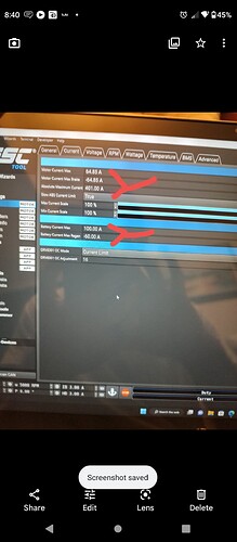

I think I configured vesc tool except I don’t know what to use for these settings. The absolute max current was set when I calibrated it so I don’t know if thats too high. I don’t want to fry anything.

Vesc firmware treats the unity like two escs (one per motor).
If you want 100 battery amps, you have to set 50 per side. If you want 80 phase amps per motor, you have to set each motor at motor. To access the other side you can either do it from the CANBUS menu bottom left or the can forwarding button right sidebar.
I fucking hate that 45A rating.
You’ll get the best results keeping p42a at about 25A in my opinion. You can push to 30A, but the sag is real.
For a 5p pack at 25A per cell, you’re looking at 125A total, 62.5A per side.

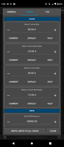

I tried lowering the absolute max to 200a but when I went to save a pop up window said the value was truncated (lowered) to whats allowed or something then it changed it back to 400a. Wtf?
Since the android app wont save adjustments i will have to open the enclosure every time to make adjustments. That sucks.
Do these settings look safe?
25A for what setting? 62.5A for motor max?
Don’t do this unless you know what you’re doing. Just leave that number alone.
Not for a setting in VESC Tool, for a calculation you make.
No, he’s talking about a battery.

Try
motor max 80A (each motor)
motor min -60A (each motor) (low speed brake strength)
battery max 40A (each motor) (or 62.5A as @glyphiks said)
battery min -17A (each motor) (high speed brake strength)
absolute maximum current (don’t touch)
max erpm (don’t touch)
In the advanced section, lower “Fault Timeout” to 85ms and set “Duty Cycle Max” to 95% and “Duty Cycle Current Limit Start” to 85%
Then save.
Then, do ALL OF THAT (except the helmet) again for the other motor.
When numbers are negative, they have to be negative.

Mboards instructions said all builds should use 80,000 erpm. Should I recalibrate and leave the erpm at the original figure? I think it was like 100,000. Same with absolute max. It was around 401A.
Oh I know they aren’t safe. Ive been riding for 4 years and always gear up. I meant safe so I dont fry the hardware.
That’s an erpm limit. 80k erpm is the “limit” for older v4 hardware. A normal 12s setup isn’t getting near that. Leave it at 100k
Disregard MBoards, and leave that setting alone. They don’t know what they’re talking about.
