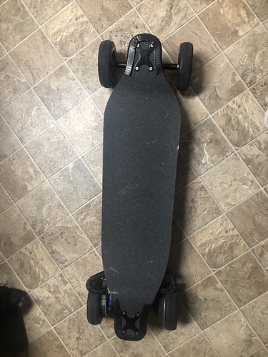

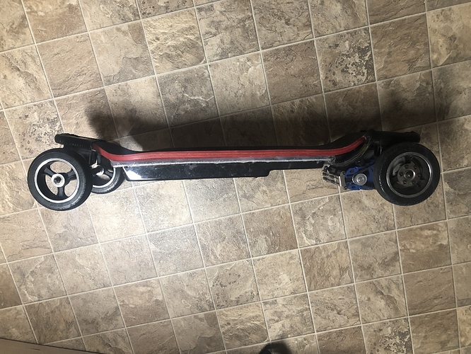

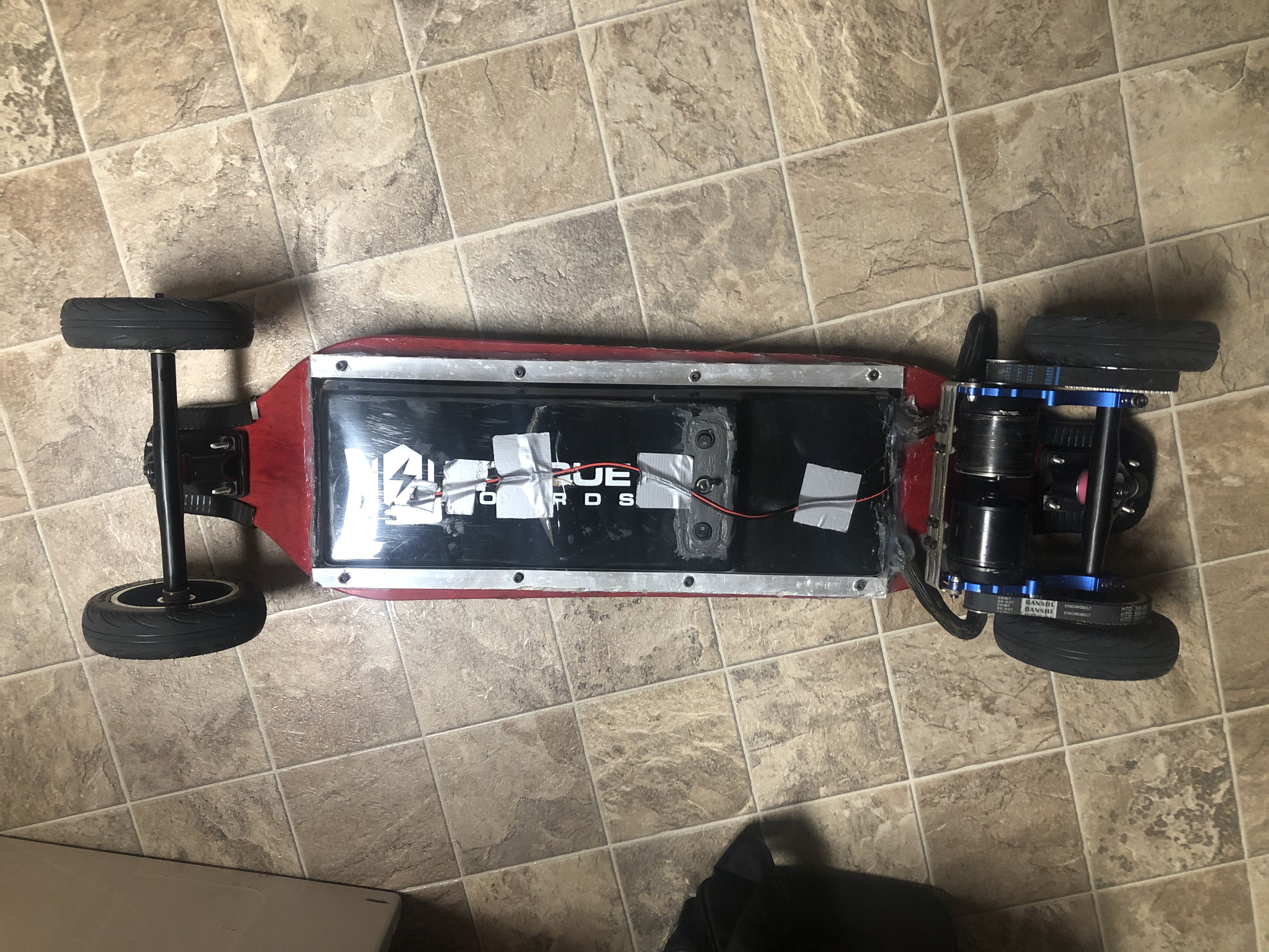

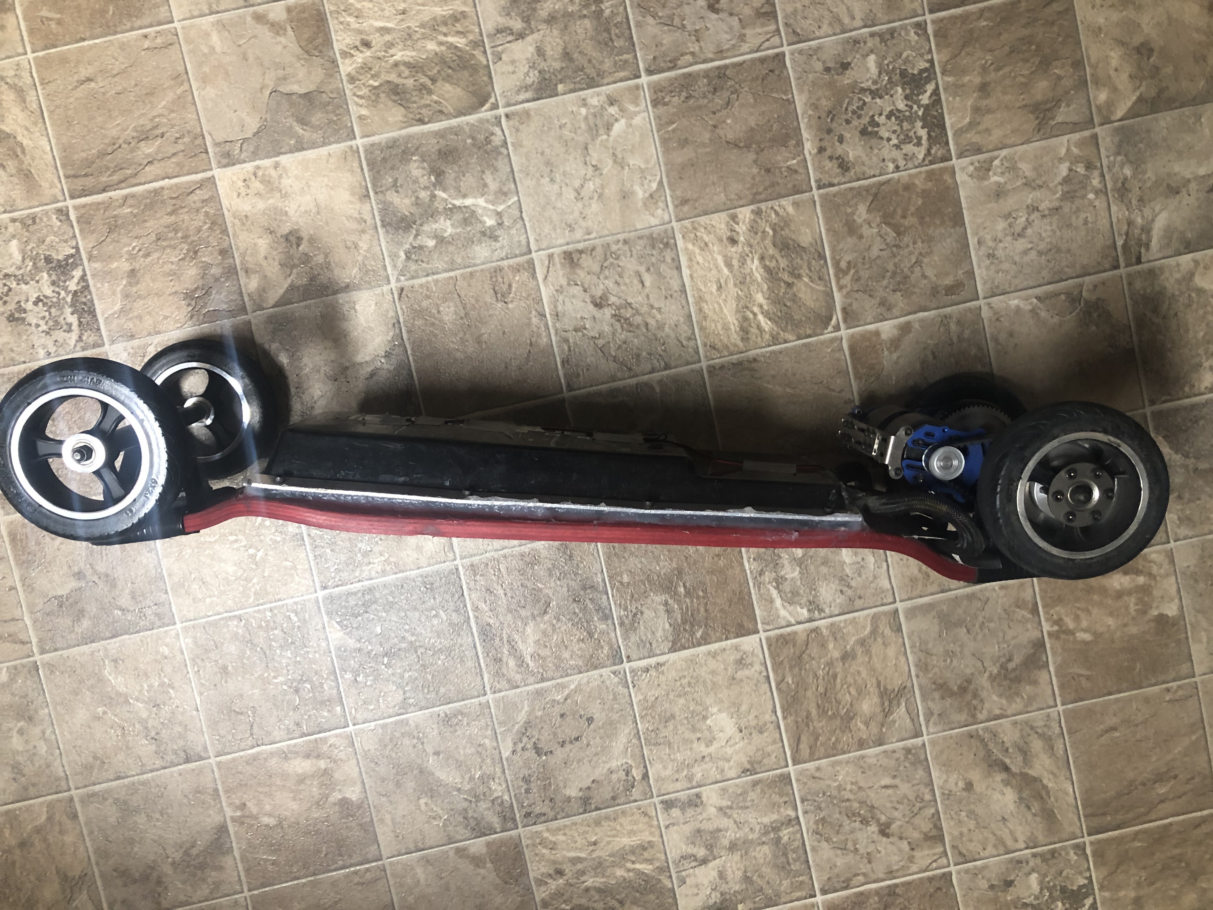

If you have some pictures of your build that will probably help diagnose things as well

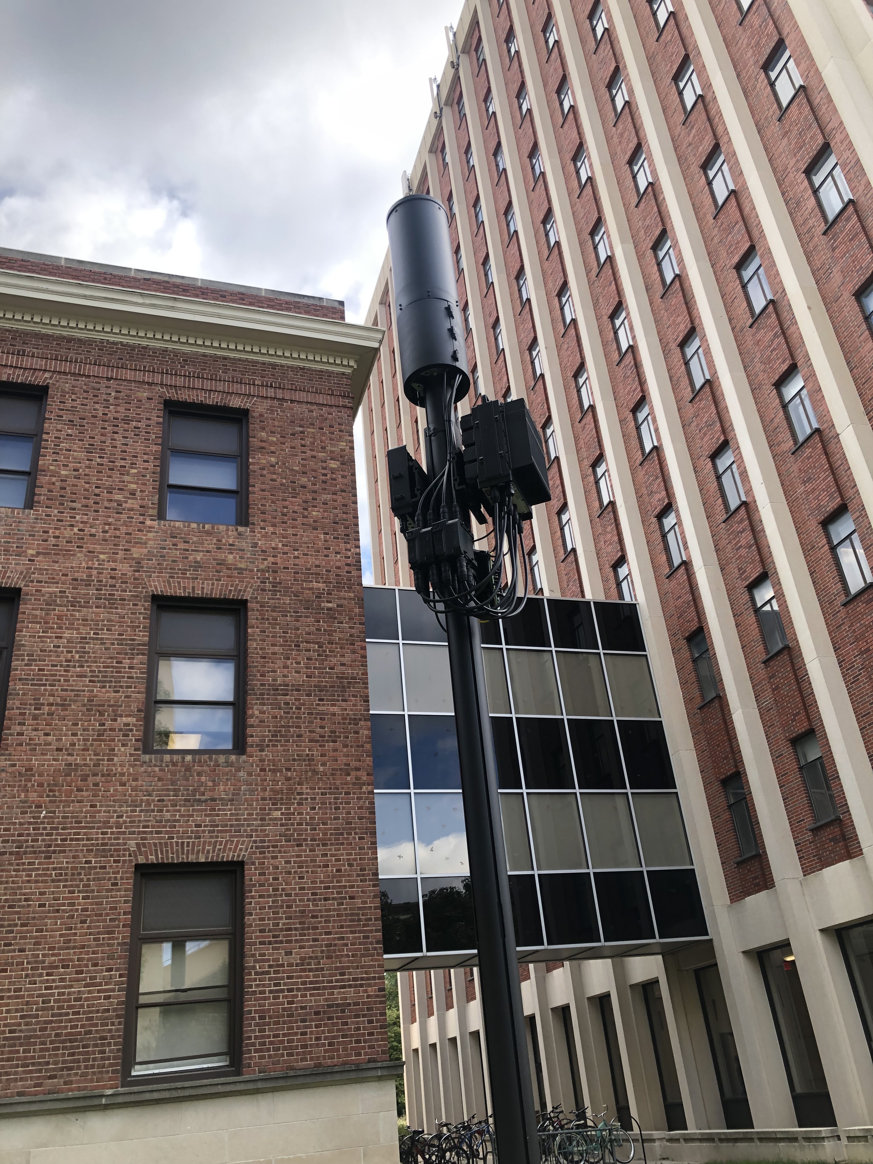

I am using the mini remote. The one with a wheel on the side of it. I think my university has started to install 5g cell towers on poles all around campus so that could be an issue.
I can upload pictures of the exterior tomorrow but I am not quite sure that is going to help much. I will remove the enclosure this weekend to take a look at the inside.

So I definitely figured out the issue after some testing. My board only cuts out on campus and this is because of 5g cell tower poles there are everywhere. There is always one within line of sight. Which is needed for full 5g abilities. Whenever i am near one of these poles I lose signal for a second and it fluctuates on and off. I am not sure if there is a solution for this? Is there a receiver to combat 5g cell towers? I am not certain they are 5g cell towers but they sure do look like it.
