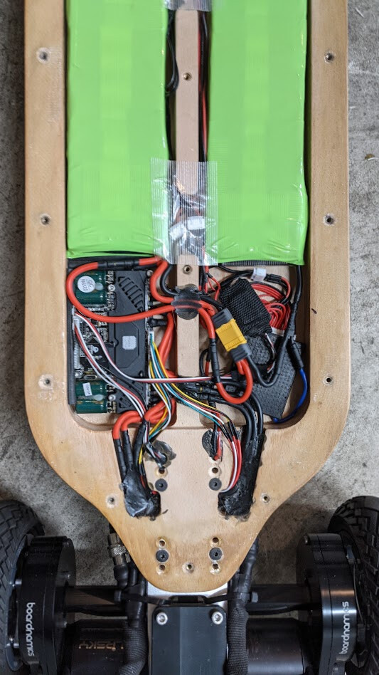

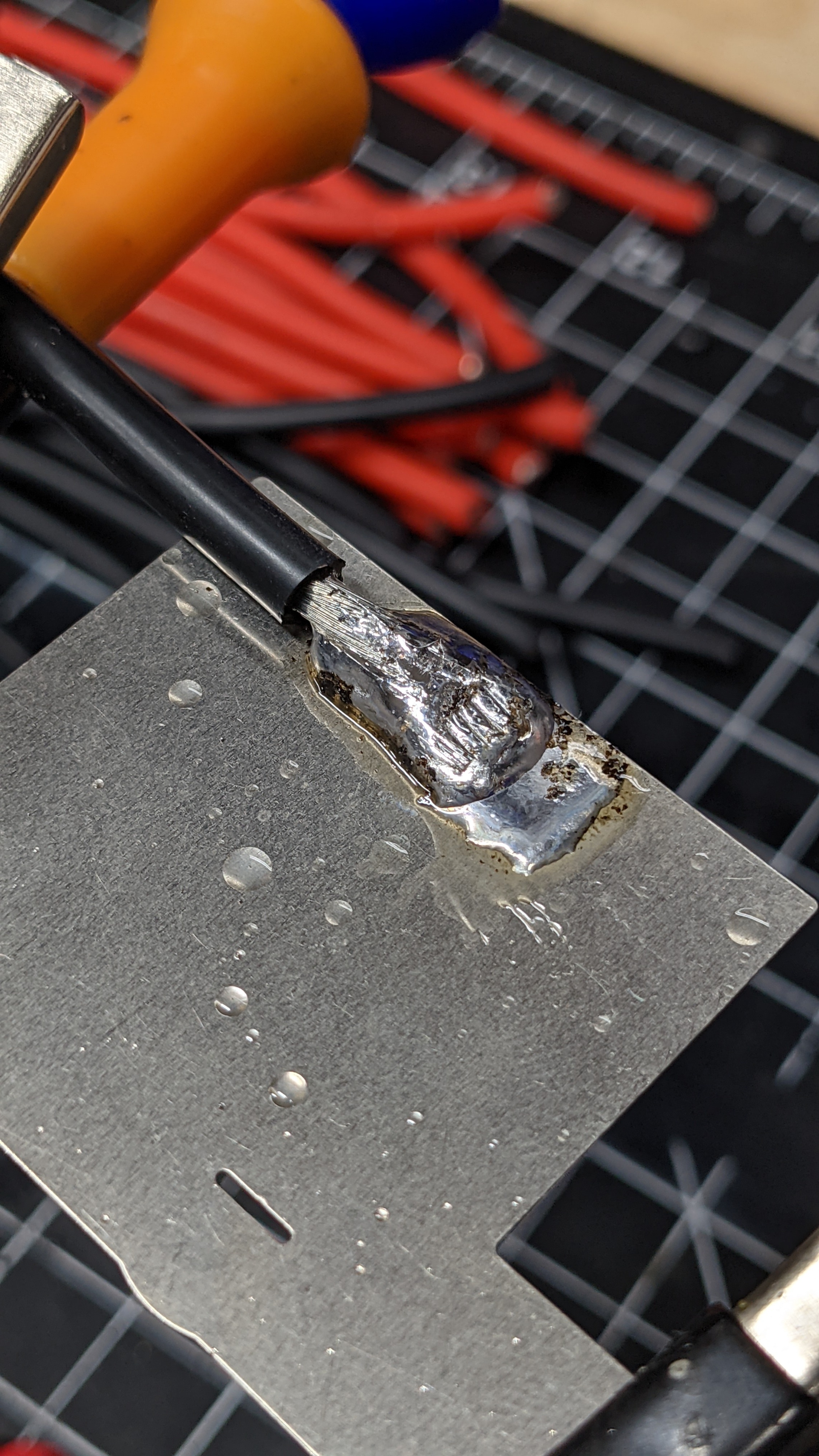

I finally started the battery
After welding I will fold the nickel over itself and then wrap it all again with fishpaper. The packs will connect to each other in am S-shape. I’ll have to make a parallel connection at one of the ends for balancing.
Folding nickel idea came from @BenjaminF , thanks for that

And here she is with a drivetrain no wheels

She’s done!
